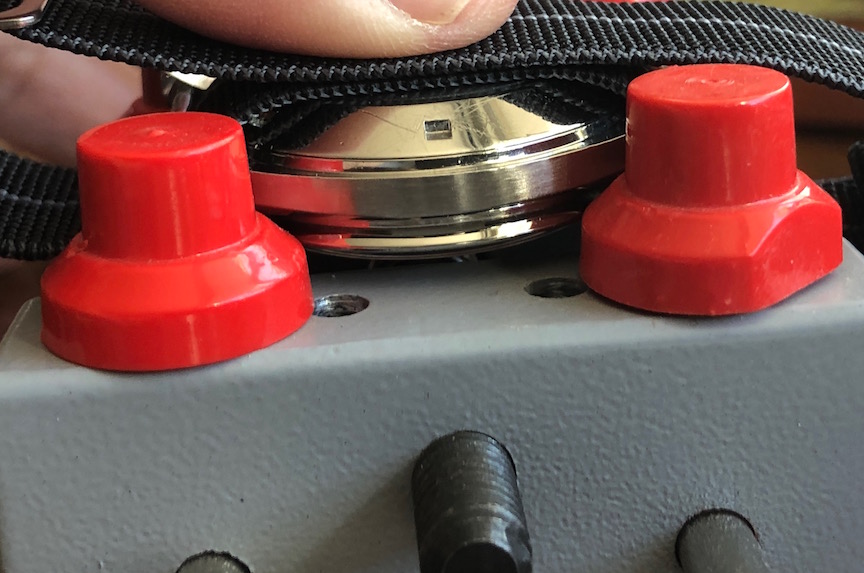

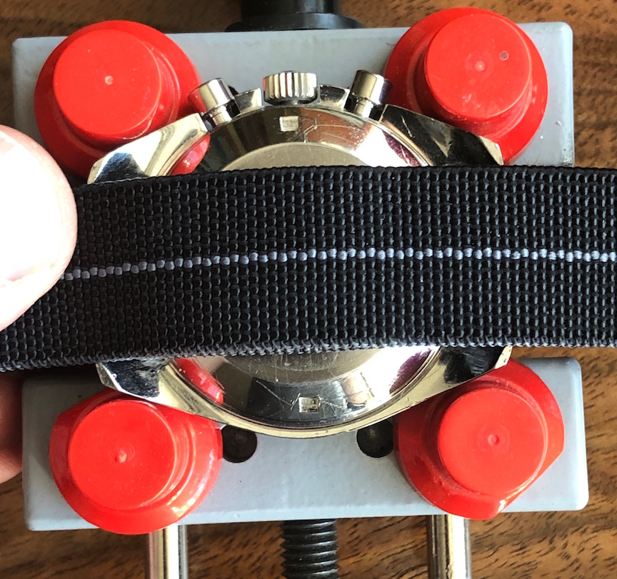

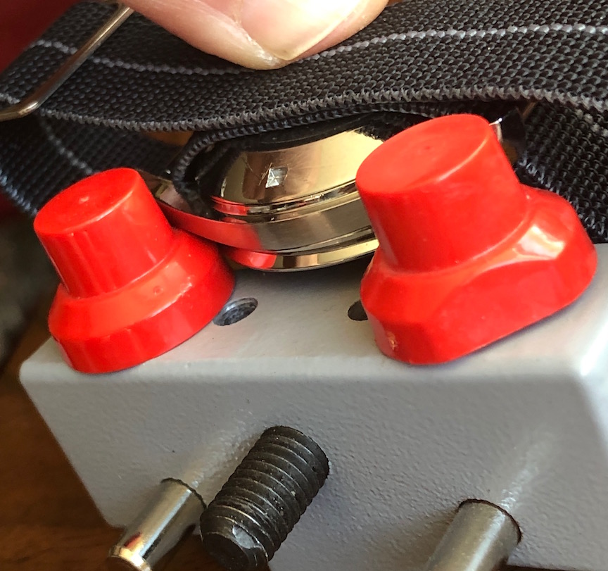

I assume you're talking about a case holder, not a movement holder. The photo I posted (twice in this thread actually) shows one with plastic pegs (red-colored), and the case is held by the pegs, not the metal frame. Which one did you buy? If you bought the one I showed, the pegs are adjusted so that the case rests on the bottom parts of the plastic pegs, which flare out, so it doesn't come into contact with the frame.
Interestingly, you can see that at some time in the past, someone apparently did not use a holder when attempting to open (and close) this case. 馃槈
Yes, case holder (not movement holder)--sorry wrong terminology. The one I got is not large enough for a speedy, it appears. It fits my smaller watches as shown in your pics but my speed crystal hits the metal... guess I need a larger one. Thanks!.
You can just mount the watch higher and slip a scrap piece of thin upholstery leather under the crystal. The lugs don't need to rest on the flared part of the pins. I think leather is better than using a rag.

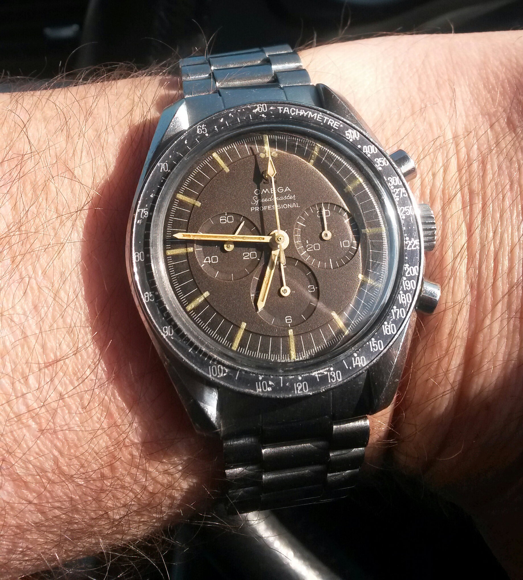

Which brand is that one, BTW...?
As you can see, it's an "Omeeeeeeega"!....馃榾 it has 6 locating points on the case back, needs a @Pahawi opener in skilled hands..... and is not to be 'fakked about' with...馃榿
