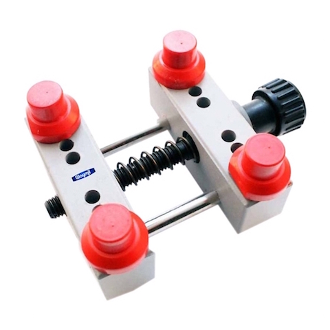

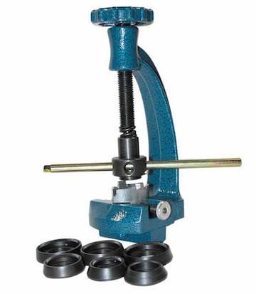

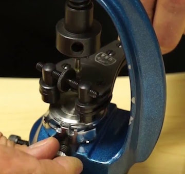

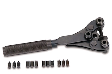

By having the correct tool I assume you mean this

Well I took a stab at it with a less valuable watch and, voila, easily done. However, I don't have the movement holder yet and three other watches I have with screw backs are too tight to attempt without a solid base. I have ordered a base and will give them a shot when it arrives.
