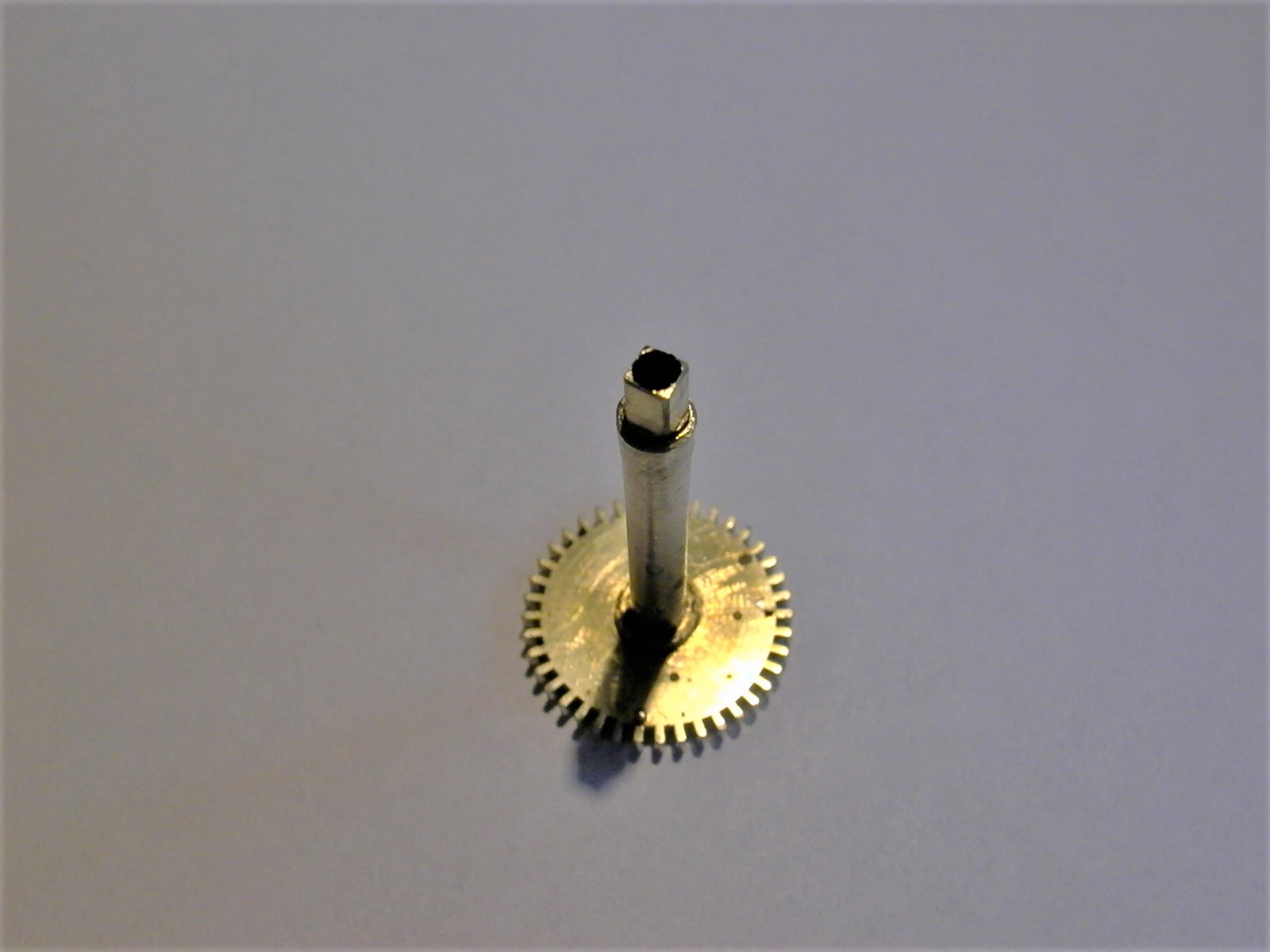

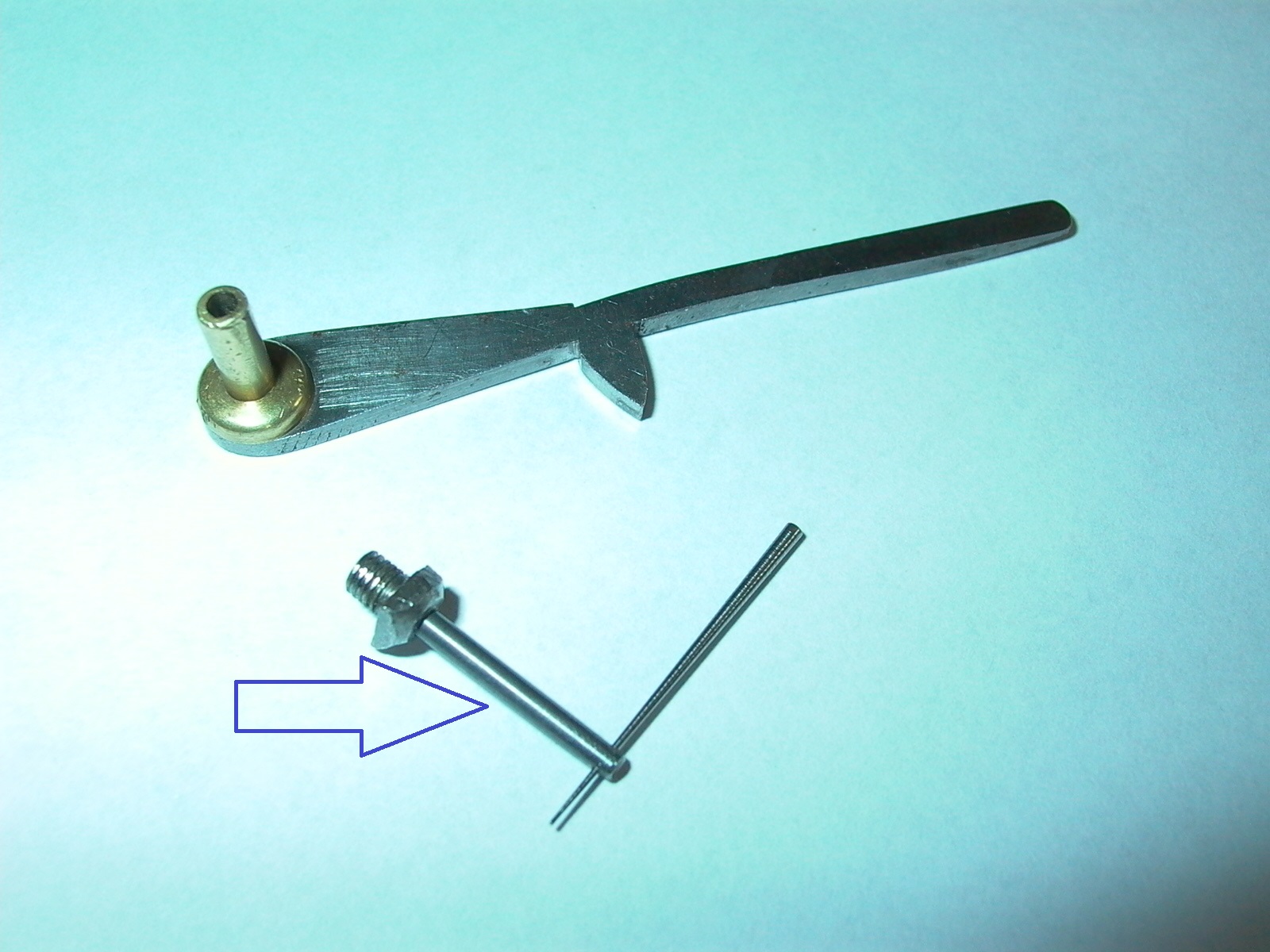

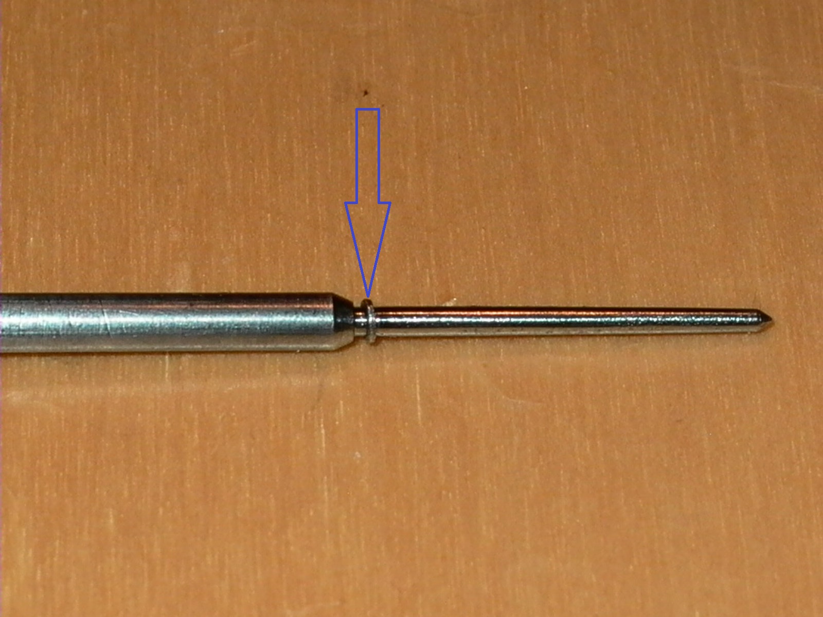

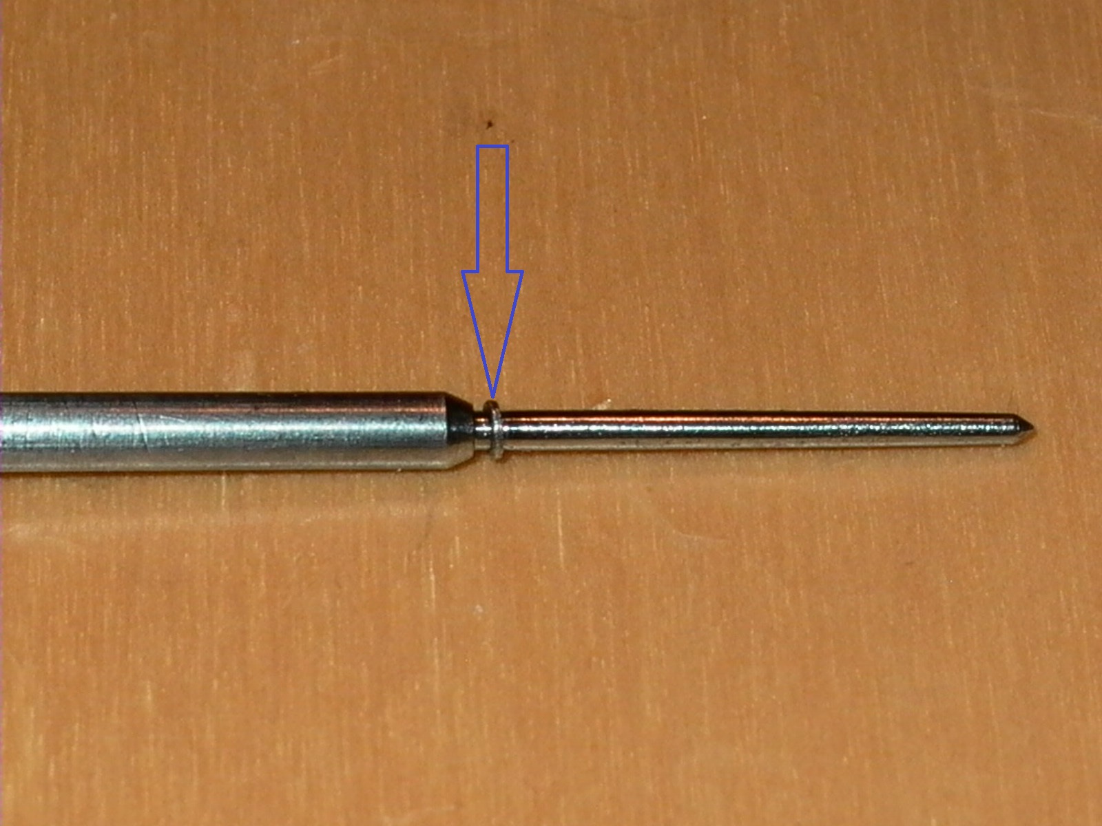

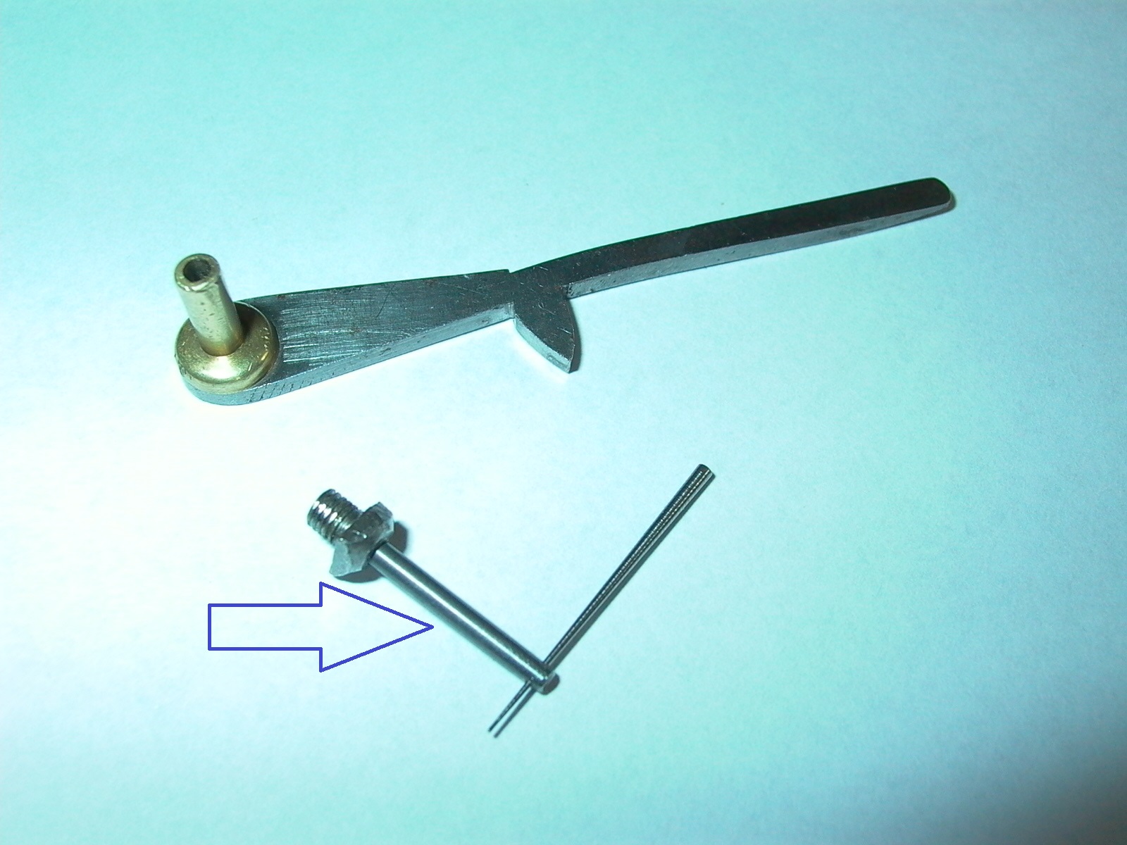

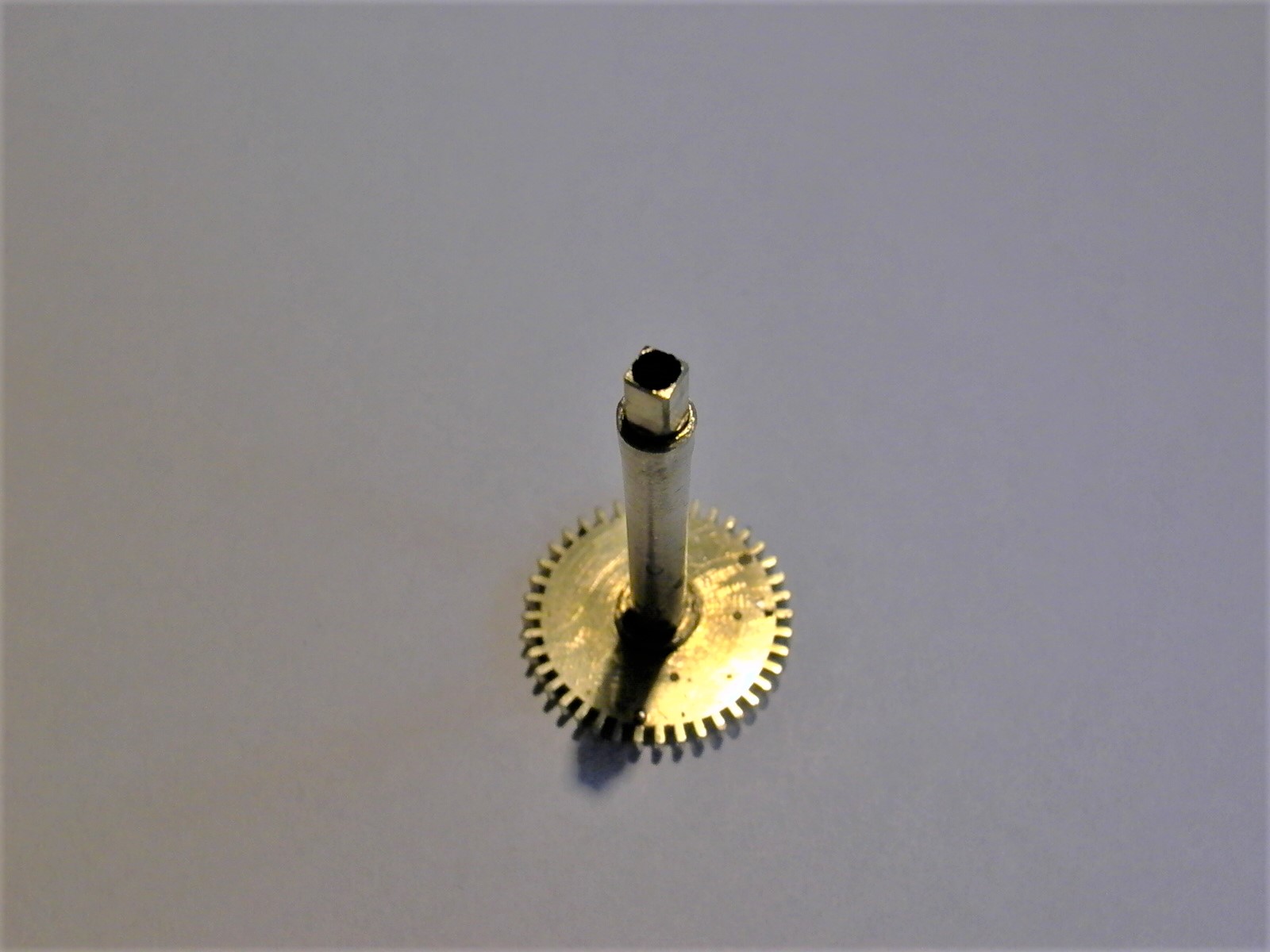

One reason for our discussion might be that we come from different ends. You are a professional and deal mostly with "modern" stuff, where there is an option to replace parts by new ones or nos instead of repairing worn components. That is of course the best option. I come from the vintage end and in most cases there is no chance to replace parts. You must make new ones youself (or have them made, $$$$$ if you find somebody). Here are some recent examples, I just recently began such documentation. Admittedly a bracket clock and insofar rather easy, it is from about 1800. But I have also made escapement parts for vintage pocket watches and know e.g. how to adjust a spring detent to work correctly.

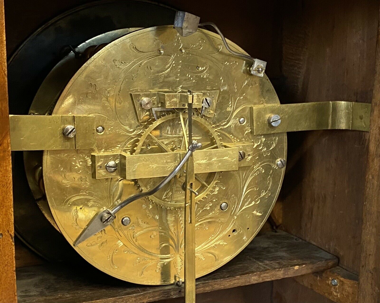

The first is an escape wheel arbor, which carries a sweep second hand, the arrow points to the part, which runs in the hole in the front plate. The second is a post, which was broken. The foot is the original one, the actual new post shrunk into a hole drilled into the foot. The third a hollow square for the minute hand, which had been cut down by some bodger for whatever reason (sweep seconds were completely missing) The round part of the square also shrunk into the enlarged hole in the minute pipe. The general maxime in this field is to save as much original substance as possible. Finally, I do not know the english name, but look and tell which one is new and which one original.
The missing second hand needed to be made also, including pipe. Finally just for your delight (hopefully) a view on the escapement.
Cheers, Bernhard
