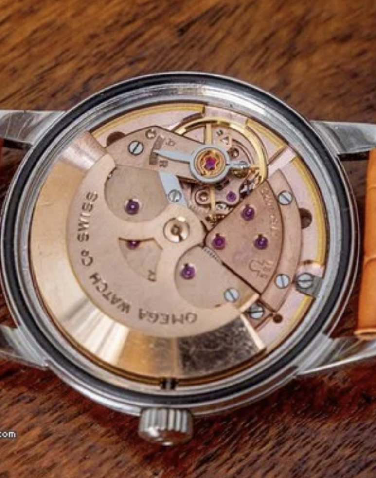

Service: Serviced during 2021. New mainspring and the automatic winding mechanism had a compete overall and lower automatic bridge was replaced. New Omega crystal and gaskets
Time Deviation Dial Up: +5 s/d
Amplitude Dial Up: 235
Beat Error Dial Up: 0.3

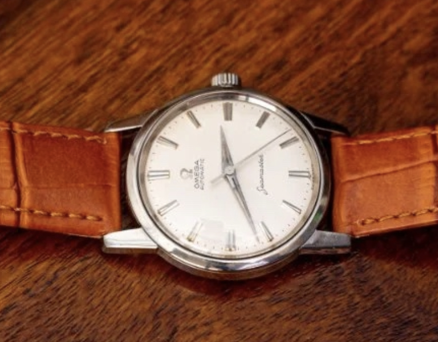

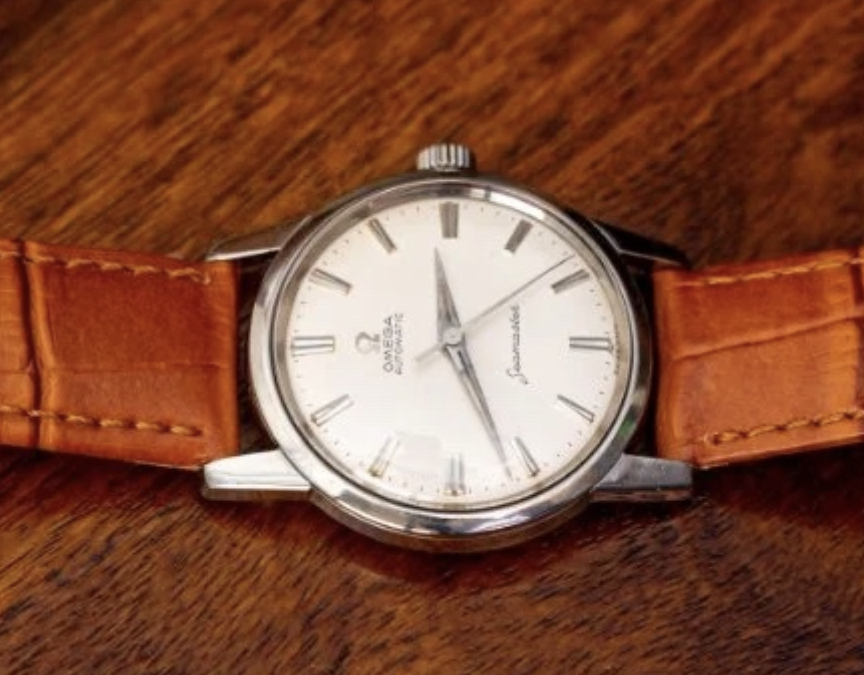

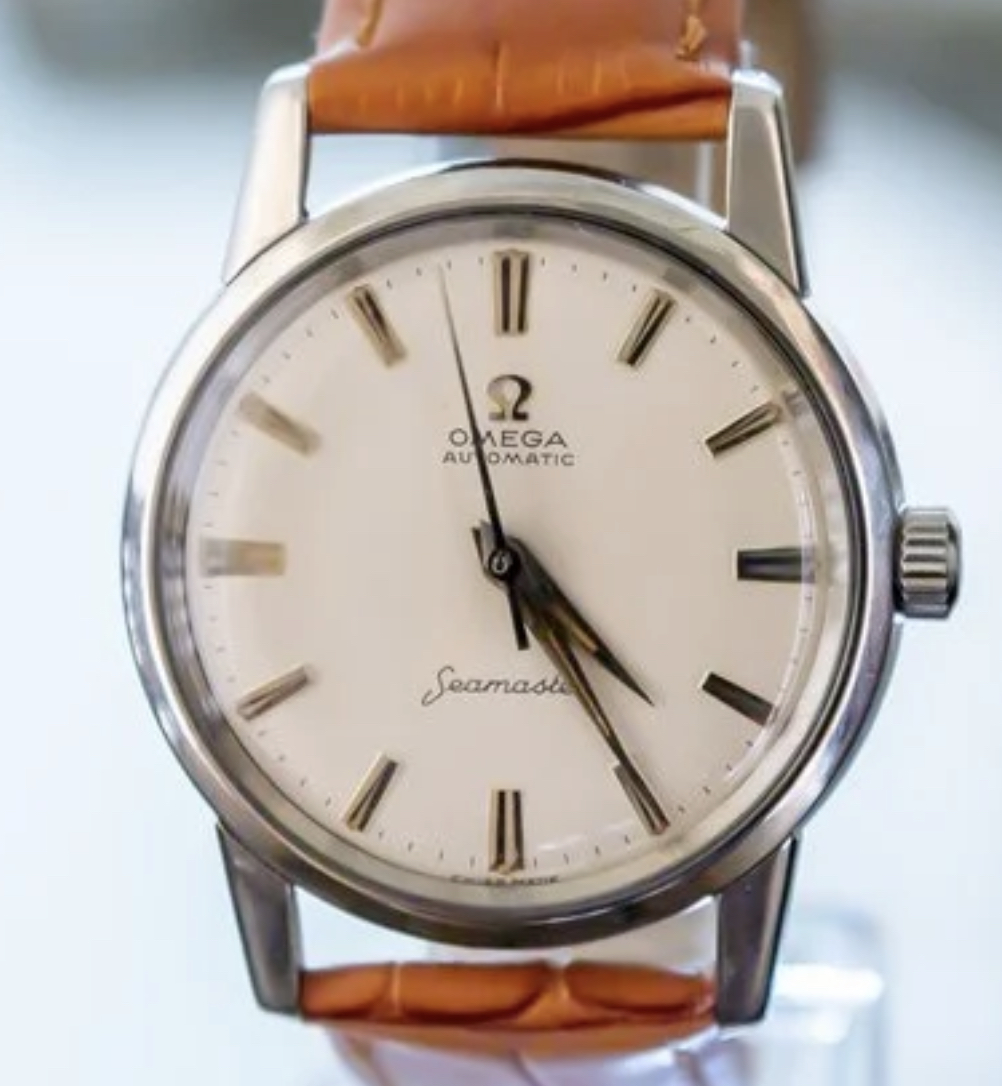

things I am worried about:
- is the crown correct?

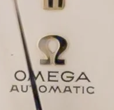

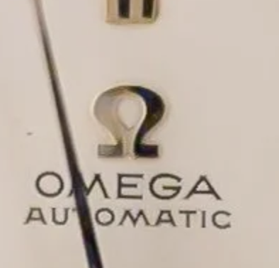

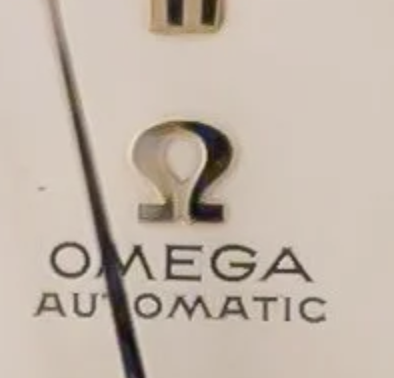

- It looks like the logo either has glue behind it or the feet are “touching” haven’t seen this on others...

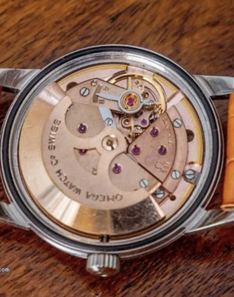

- no “waterproof” text on case back
- just your general opinion....!!

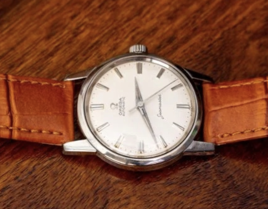

The dial text appears to be original to me. I believe the crown is incorrect. The case should be screw in caseback but cannot assess if its correct as you have not provided us with any pictures.

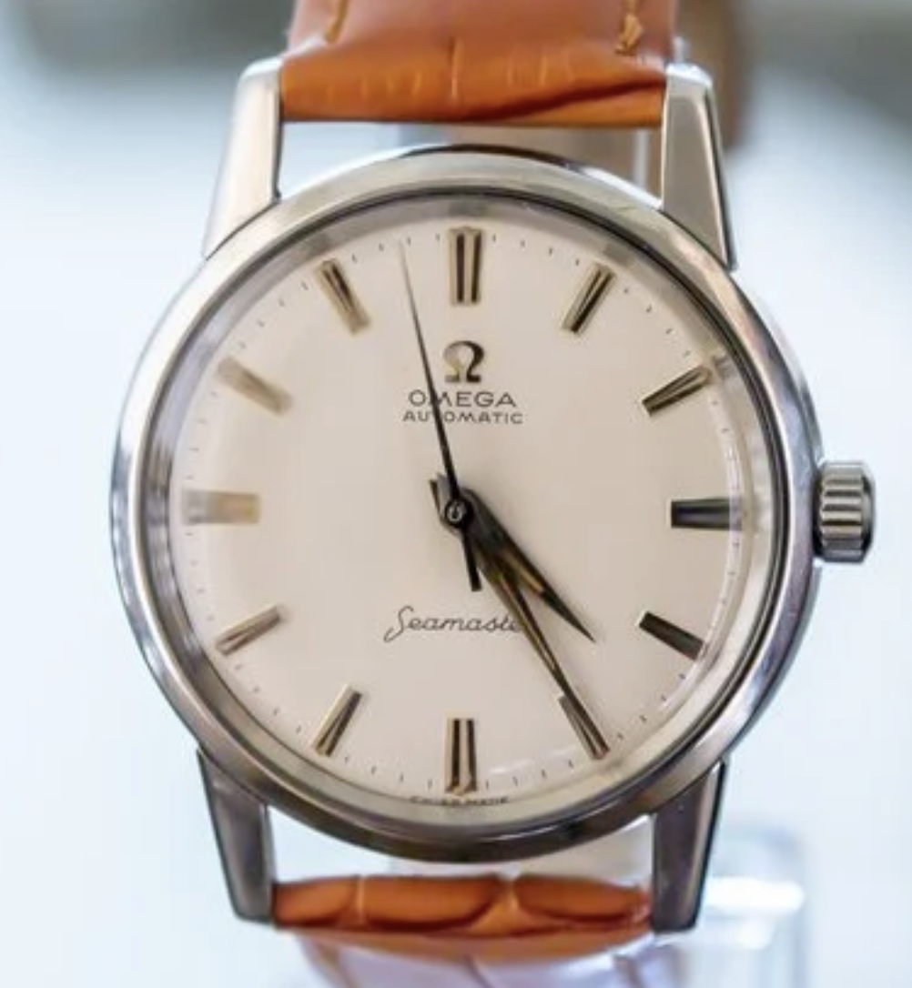

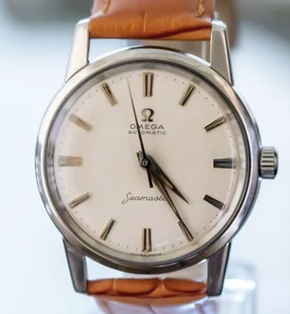

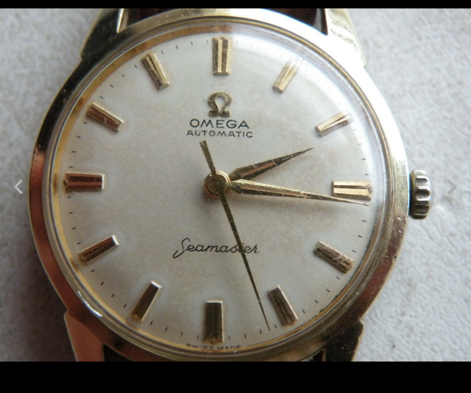

Can you assess it from this photo? 😀

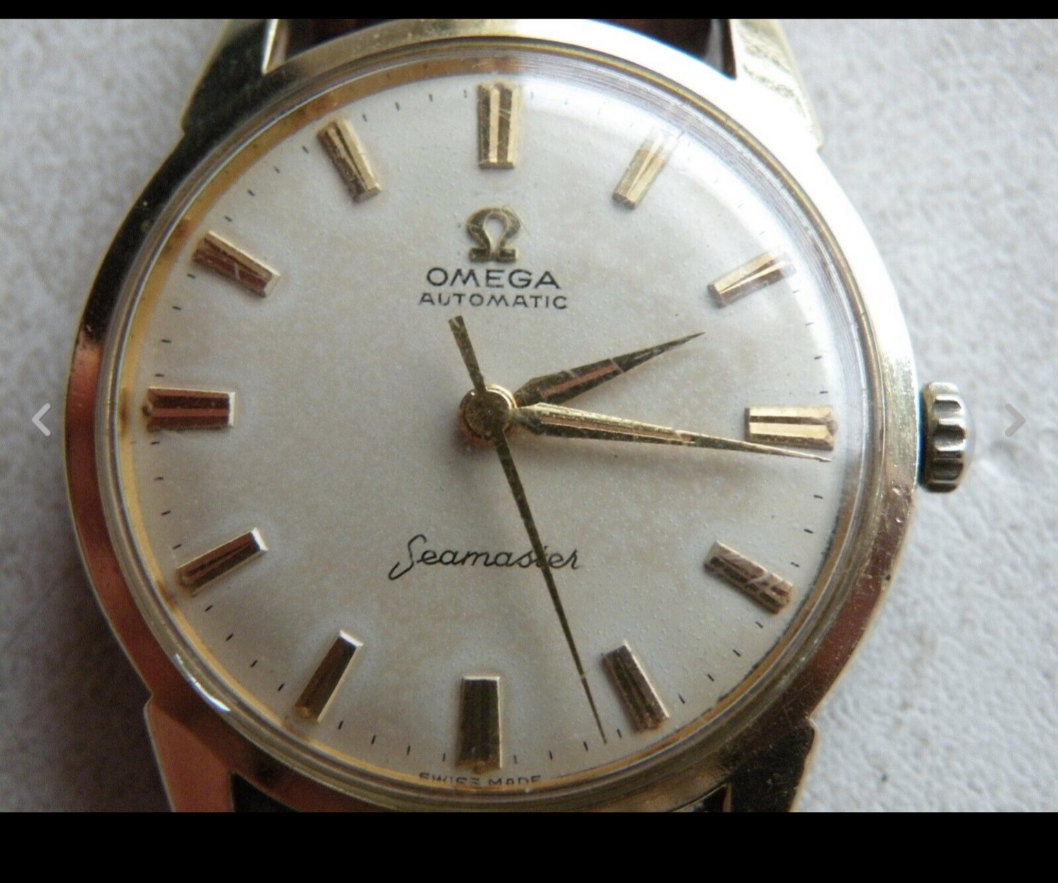

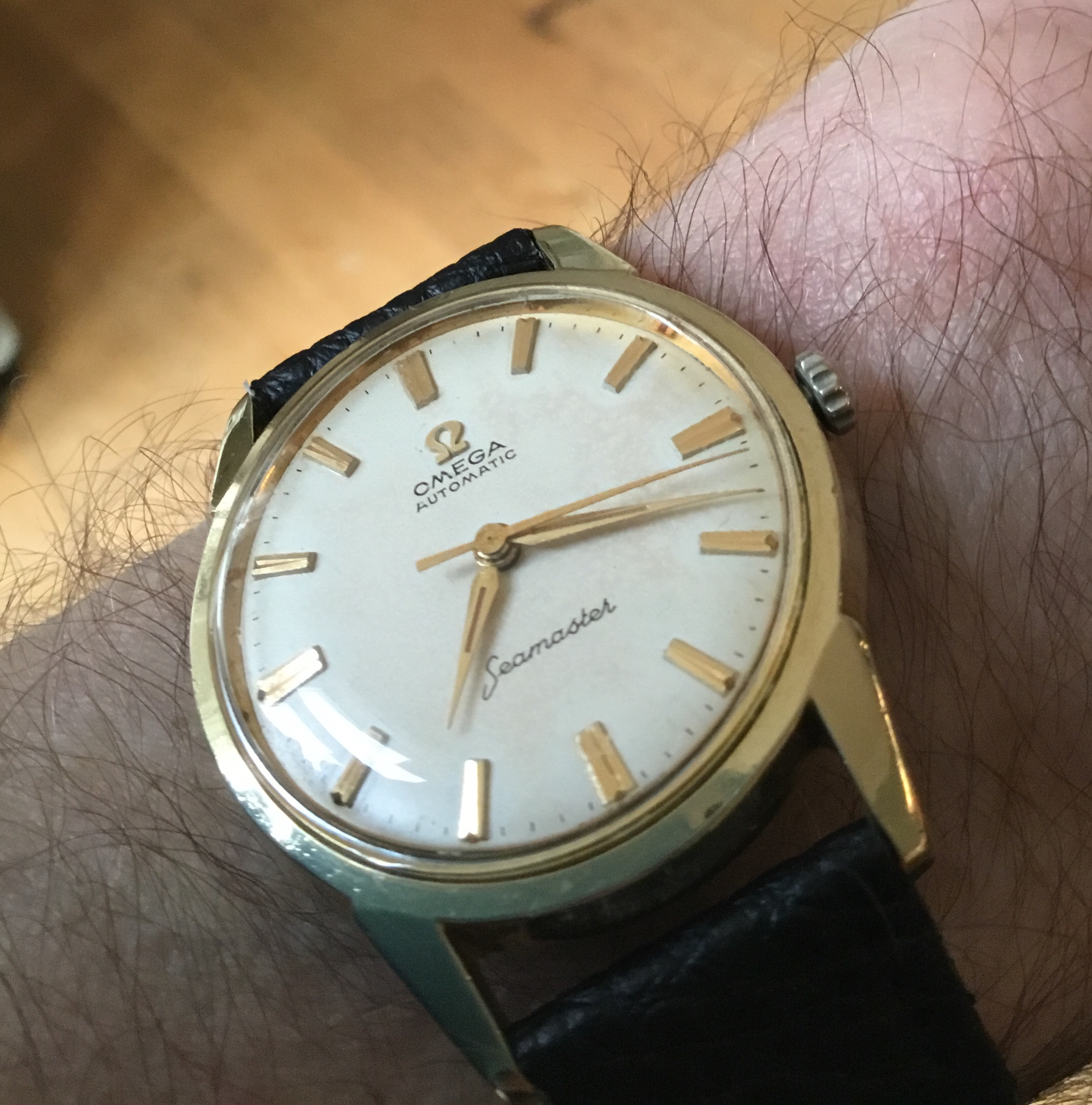

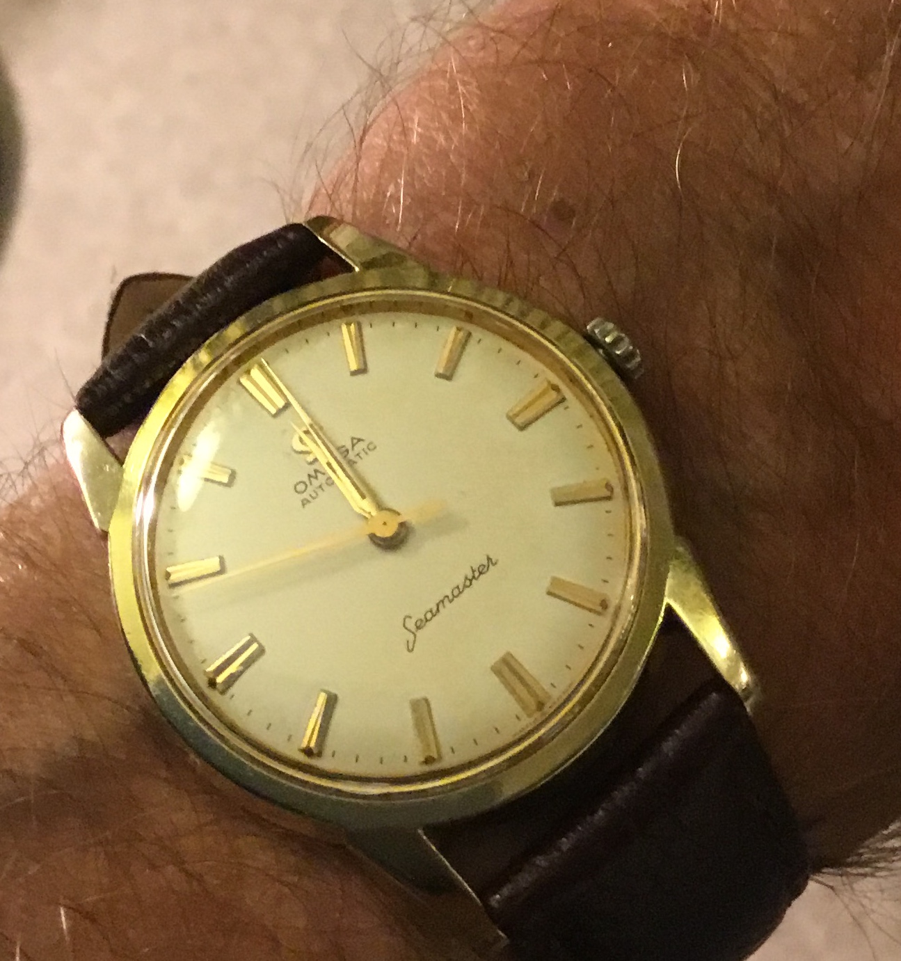

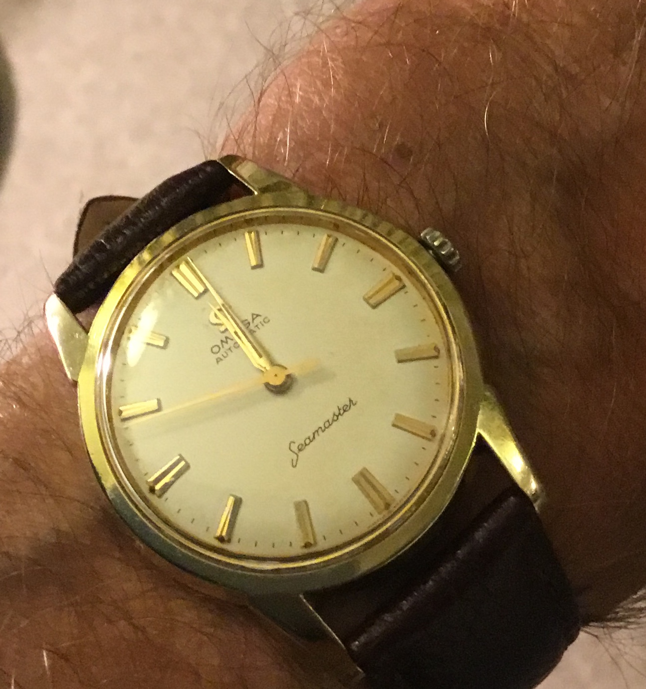

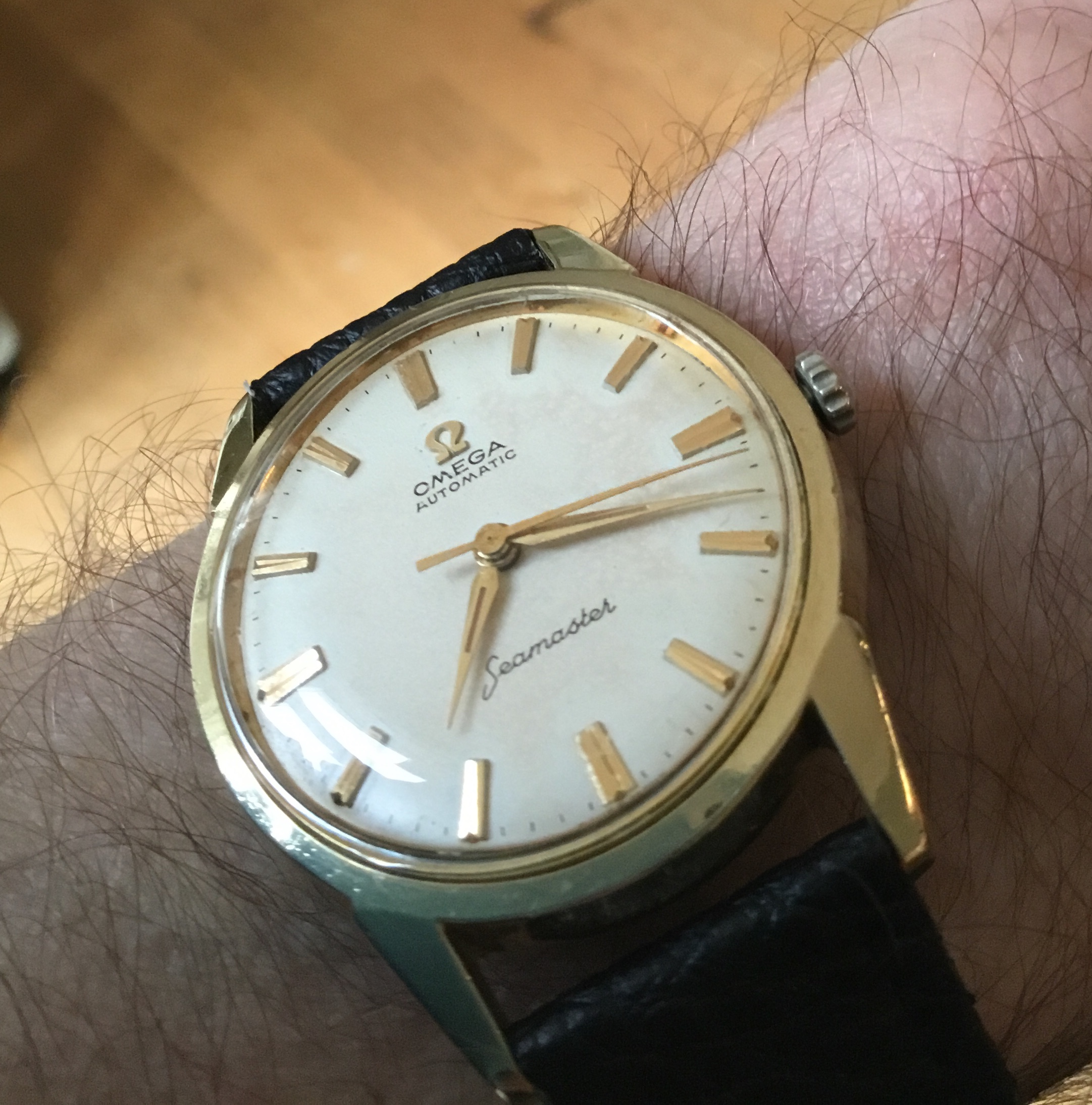

This is my gold capped 14704, also with a cal 591 movement, which I post for comparison purposes. I think I recall that it’s a 1959/1960 serial.
Compared to the one you’ve posted I suspect that your crown has been replaced. I believe mine is original.
You’ll also notice that the hands are different. Mine are Alpha Lance hands, which I’d expect to see on this model, whilst yours are Dauphine. I’m sure both were used and are on various Seamasters of the time. The fact that the hands are clearly ‘original' doesn’t necessarily mean that they’re original to this watch.
I also wonder about your dial. I’ve no reason to suppose it’s been redialled but your seller merely says 'in great condition' rather that ‘original' and you clearly have suspicions based on the shadows around the logo.
If it is original, I think the dial photos may have been edited and lightened.
Finally, although these are lovely watches, they are a 1950s design and wear marginally smaller that some of the earlier 50s models (eg 2757) or mid 60s models (eg 166.010 or 165.002) which is fine if your fiancé has skinny wrists like me but might otherwise be a problem.
I agree with @Syzygy about the price.
Finally, does the seller accept returns? If your fiancé doesn’t like it, then you may not want to pursue it.
Good luck - it’s a lovely idea for a present and well done for finding OF and asking before you buy.

Thanks for your inputs everyone! Your remarks on the wrong crown made the seller decrease the price with 100

No major issues are jumping out at me, but, like the OP, I am wondering what is going on around the applied Omega logo. Perhaps it is an artifact of the photo, but it really looks like some sort of foreign substance.
