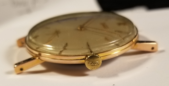

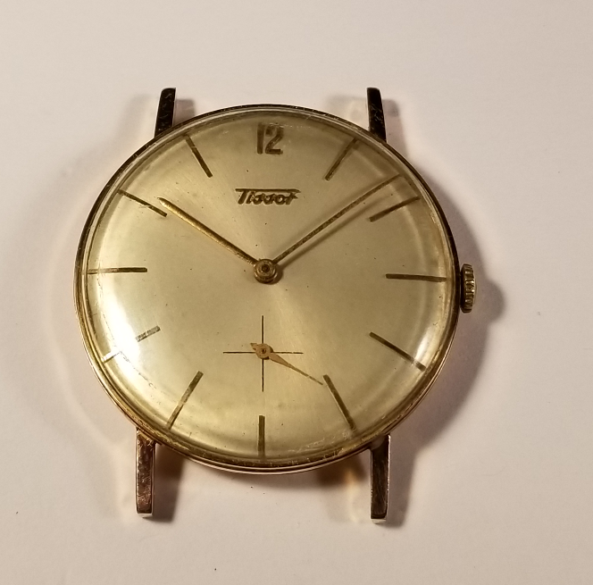

Here's a snapshot taken after a light crystal polish and a case wipedown with a soft cloth:
Still had the signed crown:

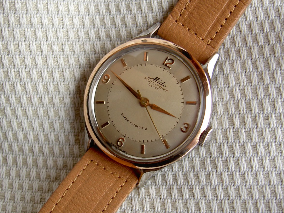

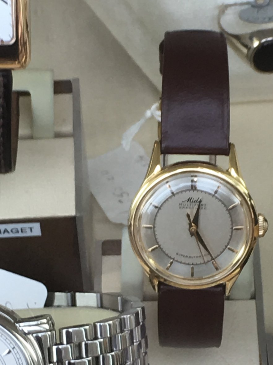

On the subject of shiny watches, I'd recommend that these are ignored, unless you know exactly how the watch in question should look. Have a gander at the wonderful "Mido Catalogues" thread and see three examples of, basically, the same watch:
wp_20171123_15_13_48_pro-jpg.701719
Compare each and you'll see that one is completely untouched, one has only had a very light polish and one has suffered the wrath of the polishing cloth on a regular basis...
