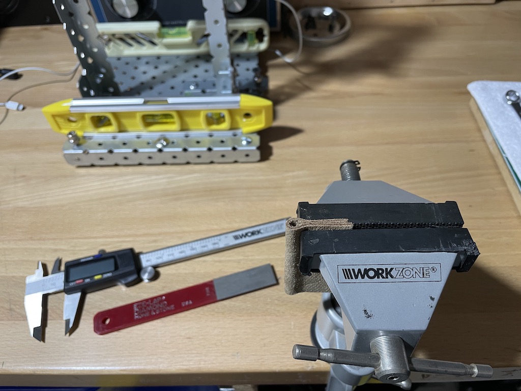

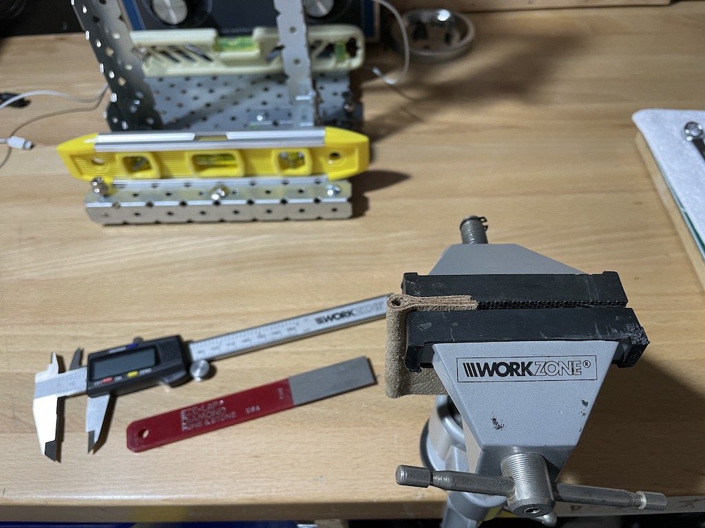

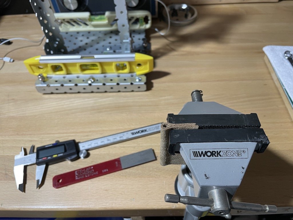

Use a jewelry vice (with padding) and a metal file and do it by hand. Don’t use a Dremel, or you will likely remove too much. Take your time, check often. I’ve done this a few times with 20mm end links to get them to fit a 19mm lug size. Only time I ruined one was using a Dremel. Took off too much too quickly.
better to do it slow than fast, unless you know what you are doing.

I have also done this with a hand file, especially if it's only 0.5mm per side.

Use a jewelry vice (with padding) and a metal file and do it by hand. Don’t use a Drexel, or you will likely remove too much. Take your time, check often. I’ve done this a few times with 20mm end links to get them to fit a 19mm lug size. Only time I ruined one was using a Drexel. Took off too much too quickly.

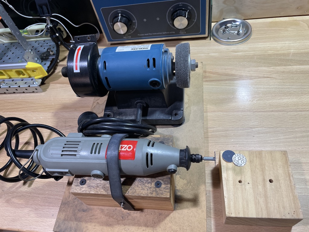

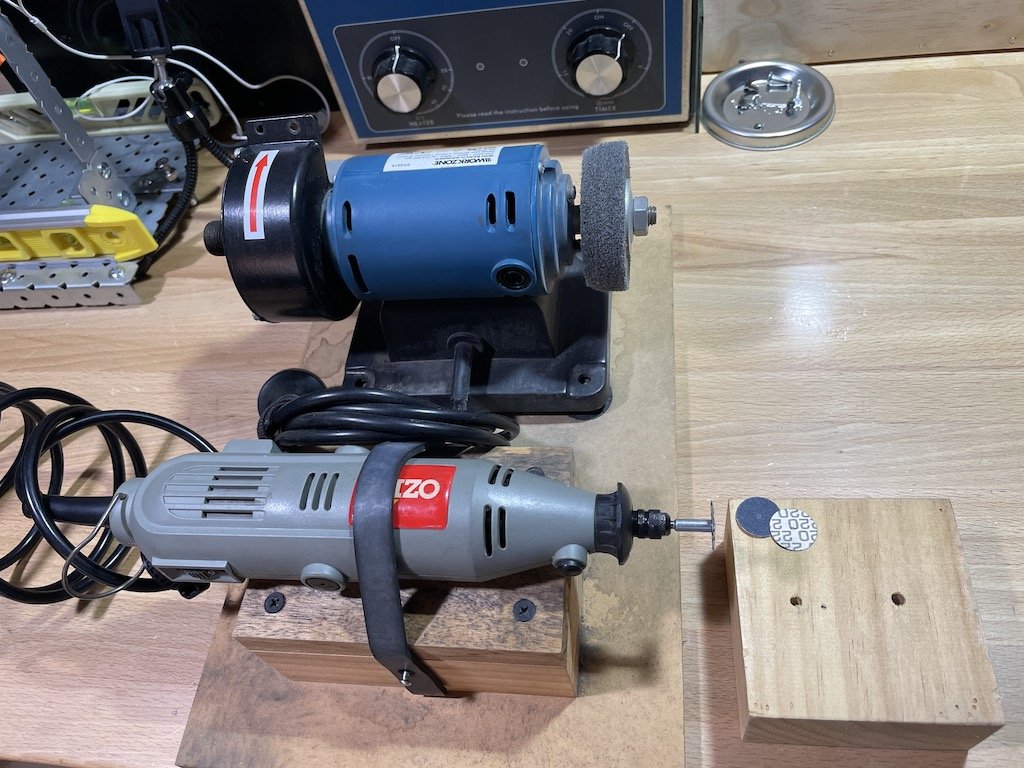

Unless you have a very steady hand I wouldn't recommend using a Dremel. If it's your only option, use a paper grit disc (240/220), not a cutting wheel and mount the Dremel so you can use it like a bench grinder. Have a hand support (wood block) so that you have full control of the work.
The safer way would be with a diamond stone and a bench vice.
