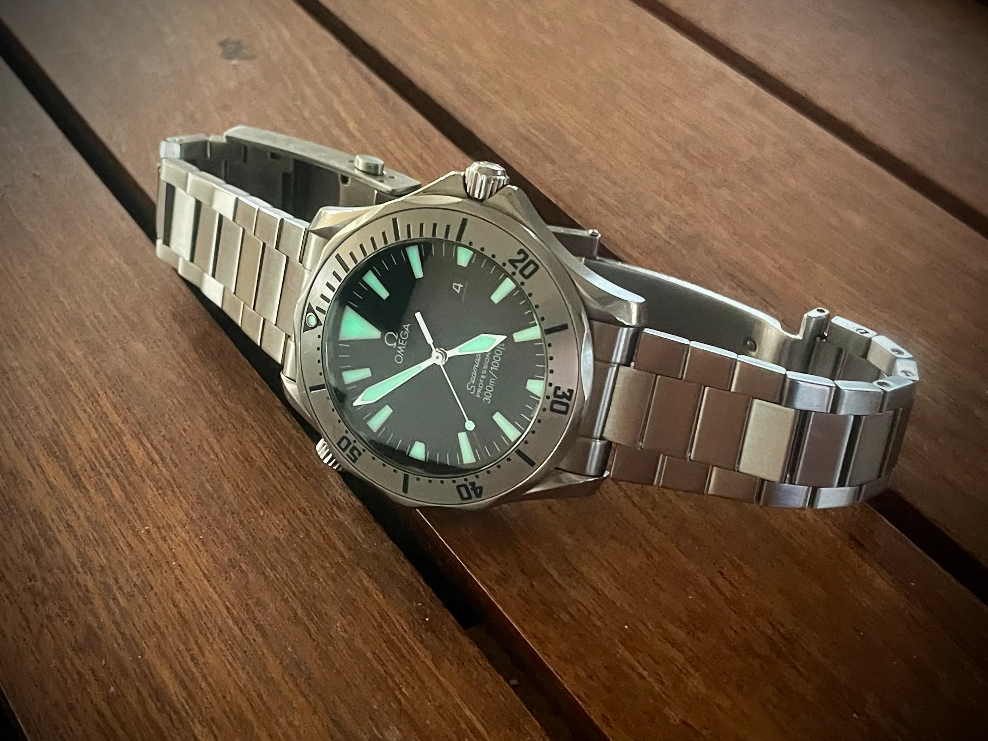

Hi all,
I have an Omega 2264.50 with the Plan Pro modification (PO crystal/bezel/seconds hand). The modification was done over a year ago, and it ran wonderfully the last 12+ months. Just a few weeks ago it lost ~2 minutes and it then proceeded to run fine again without the battery end of life indicator. About a week ago it again lost 1-2 minutes and then proceeded to run fine.
Where can I send this watch for service? I worry that Omega will not work on a modified watch (I completely understand), and the watchmaker that did the mod will not touch an Omega quartz movement. I am located in the US.
Thanks in advance.

Quick update: No response yet from anyone willing to take a look, but trying to look for a pattern I noticed that if the watch loses time, it happens on Sundays. Sundays I go swimming in cold ocean water followed by a warm shower. The internet is divided over dive watches in hot showers with shampoo, but I don't have a better hypothesis, so for the moment I'll keep the watch on for activities where I want/need it (scuba/swimming), while avoiding steaming water and shampoo.
3,938
8,525
Opinions are divided on this, facts are not. Does your watch pass a pressure test?
Secondarily, How cold are we talking? Cold can impact a quartz watch function. I wouldn't expect this to be the case here, but if your watch is properly sealed I would expect lower temperature to be a potential culprit. But if it is, you're back to replacing the movement.
