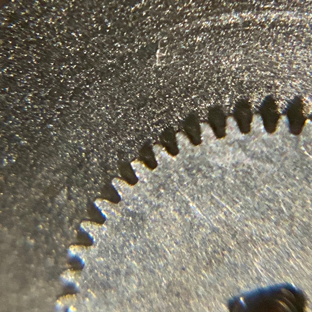

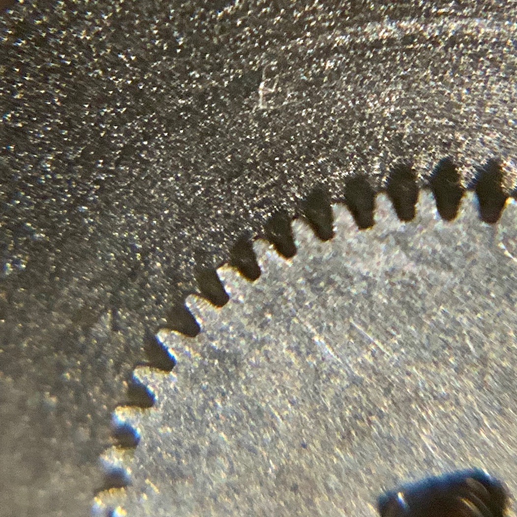

So to summarize the technical points, I've heard the movements are not 100% identical and the SW200 had some ratchet wheel issues before they modified the ratchet wheel with the SW200-1. There are sporadic and anecdotal reports of continued ratchet wheel issues in the SW200-1.
Less quantitatively, it seems like Sellita suffers from the plight of marketing. While no one, including Archer, has admitted to an aversion to Sellita here I have noticed comments, most recently in the thread regarding the recent Massena Labs release, that higher price points cannot be commanded if a Sellita is used. If all other aspects were equal, it seems using an ETA7750 vs a SW500 allows for a higher price point because the perception is ETA is better.
Me - I like Sellita's. I haven't had any issues with them yet and searching for recent issues seems much more sparse compared with 2008(ish) time period. I'll admit I also like their independence and support of microbrands. Unlike ETA they're not under Swatch Group and they will willing sell movement and parts to anyone. Pretty cool in my opinion.
And for what it's worth, here's the best picture I could capture of my SW300-1 ratchet wheel. I only have an iPhone and 10x loupe - so go easy on my photographic skills.
I'll clarify for you - personally if I had a choice between a watch that has a Sellita movement in it, and one with an ETA movement, all else being equal I would certainly take the ETA. It isn't related to "marketing" but confidence in the design. The ETA's are proven long term, and Sellita isn't. It's not any kind of "hate" or "disrespect" for Sellita, but a simple practical decision that I think a lot of people make in the very same way. Some are willing to pay a premium for that peace of mind, and frankly I probably would as well.
Really? I never would have guessed. 😉
Not sure what you mean by support of microbrands. But as for Sellita's independence, you do understand that they don't make everything, right?
Swatch still supplies Sellita with parts, because Sellita themselves can't make the entire movement. So the last time I read anything firm about this, Nivarox FAR was supplying the balance assembly, pallet fork, and escape wheel. Sellita had no plans to make those at any time in the foreseeable future, so I doubt that has changed. If they were, I suspect they would be making it known to everyone and anyone who would listen, because that's a big deal. I would suspect they are also getting their mainspring from Swatch as well.
Note that Sellita are not unique in this regard, and roughly 90% of the Swiss watch industry does the same...
Cheers, Al
