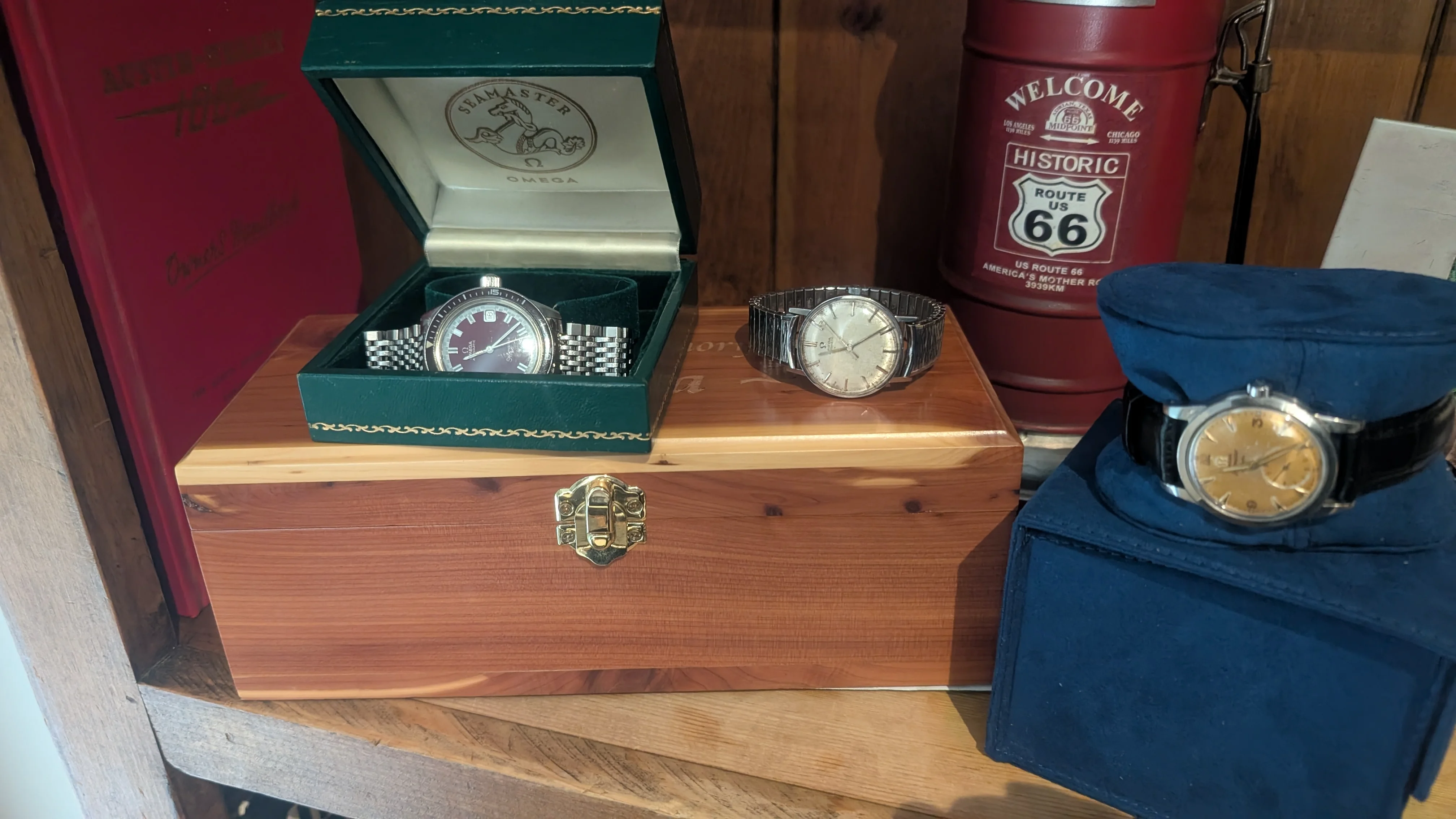

As my collection grows, I find myself asking questions, and enjoying learning about these vintage Omegas. I decided to put full manual winds into each of these today., 1950,1960,1970. I'll monitor the reserve power. I did notice each watch seems to have a different number of Crown turns from a stopped position. Has there ever been a standard or is each model different? Thoughts?

If anyone is interested, I decided to put a (relatively) full wind into my 3 vintage watches to test the reserve. Here's what I got.
Movement #
342 = 38hrs. *1950
552 = 42.5 hrs. *1960
565 = 46.25 hrs. *1970
