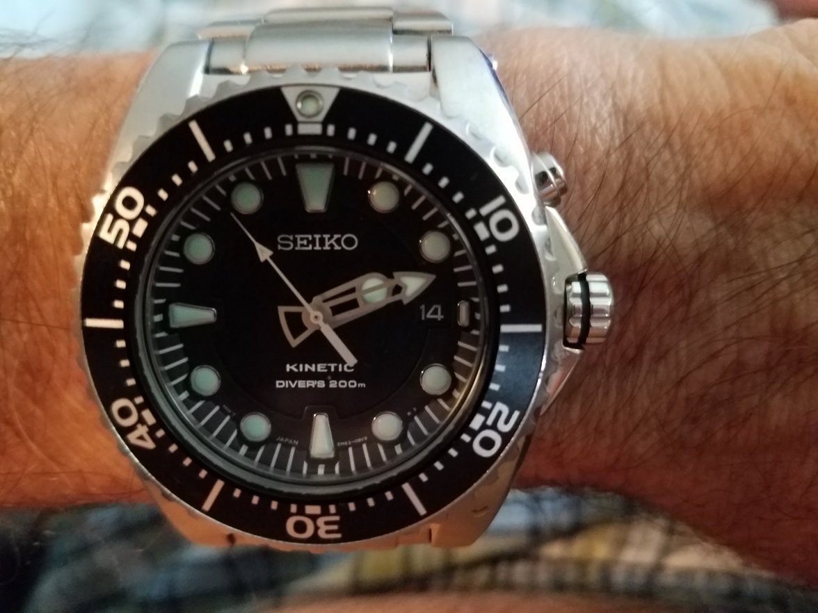

@LuckyLes has it pretty much right on in my experience. But don't let that stop you. There's always room for one more. Here's my ska371.
have fun
