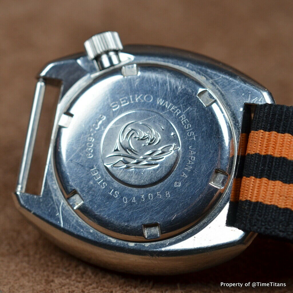

Seiko 6309-7040 -- caseback says 7049?

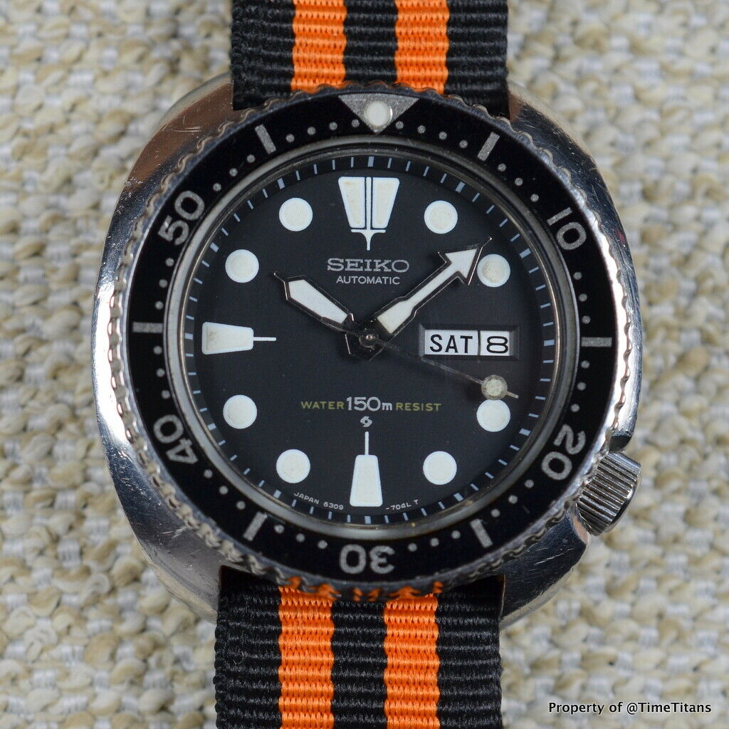

Which brings me to the below. I am fairly (somewhat?) confident that the dial is original, however, do you guys think the minute and hour hands look suspiciously clean compared to the second hand? General thoughts?

The hour and minute hands don't scream aftermarket to me but maybe they are getting much better at replicating them. Could be that the second hand was replaced at some point with one from another watch. Most concerning to me is that the top of the case has pretty much had all the brushed finish polished away.

Oh good eye, didn't catch that. Man, it's getting extremely difficult to find these in good condition.

For sure replacement hands.

Balance. The bezel is wonderfully aged. The dial has similar signs and good patina. The hands should tend to follow and typically on the suwa versions to have some small signs of corrosion, which is good to see. But here they are too perfectly shiny on the metal and spotless on the lume (zero marks or blemishes compared to the plots on the dial). So for sure replaced.

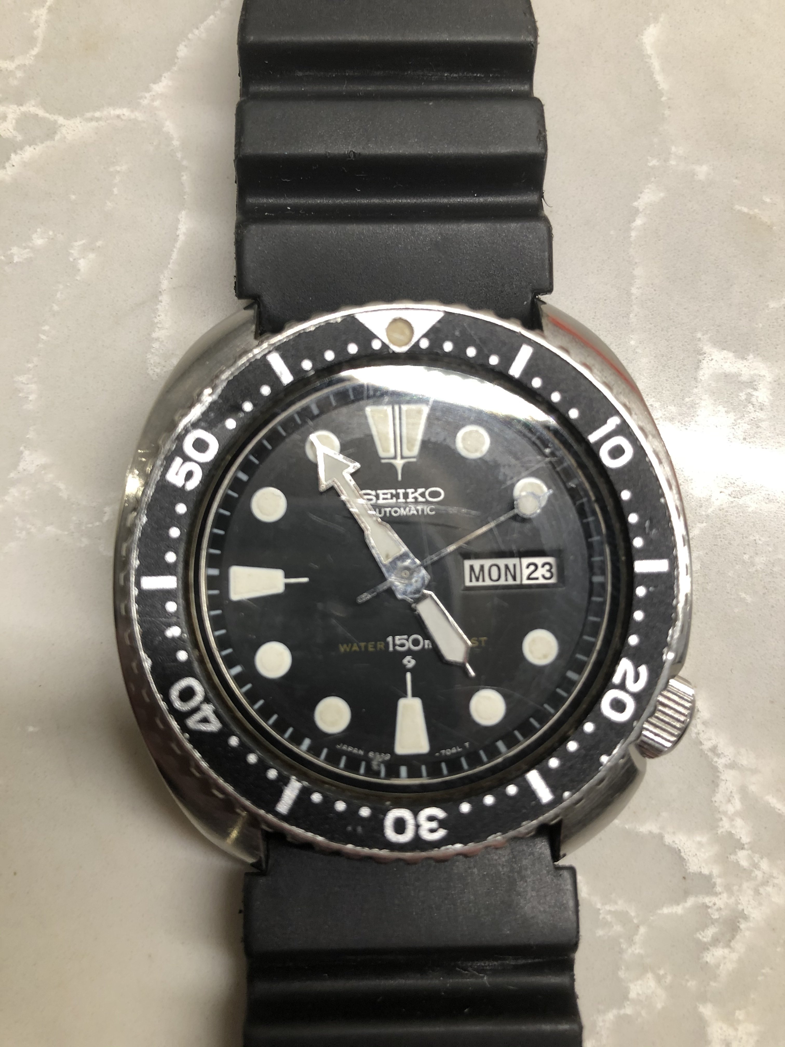

How do the hands look on this piece? Original?
