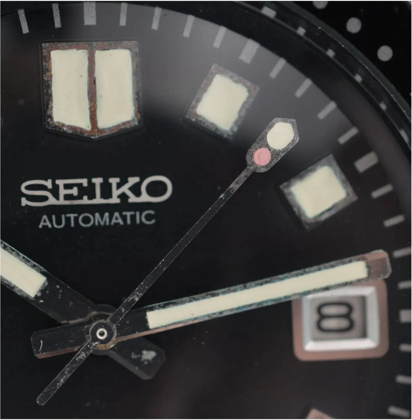

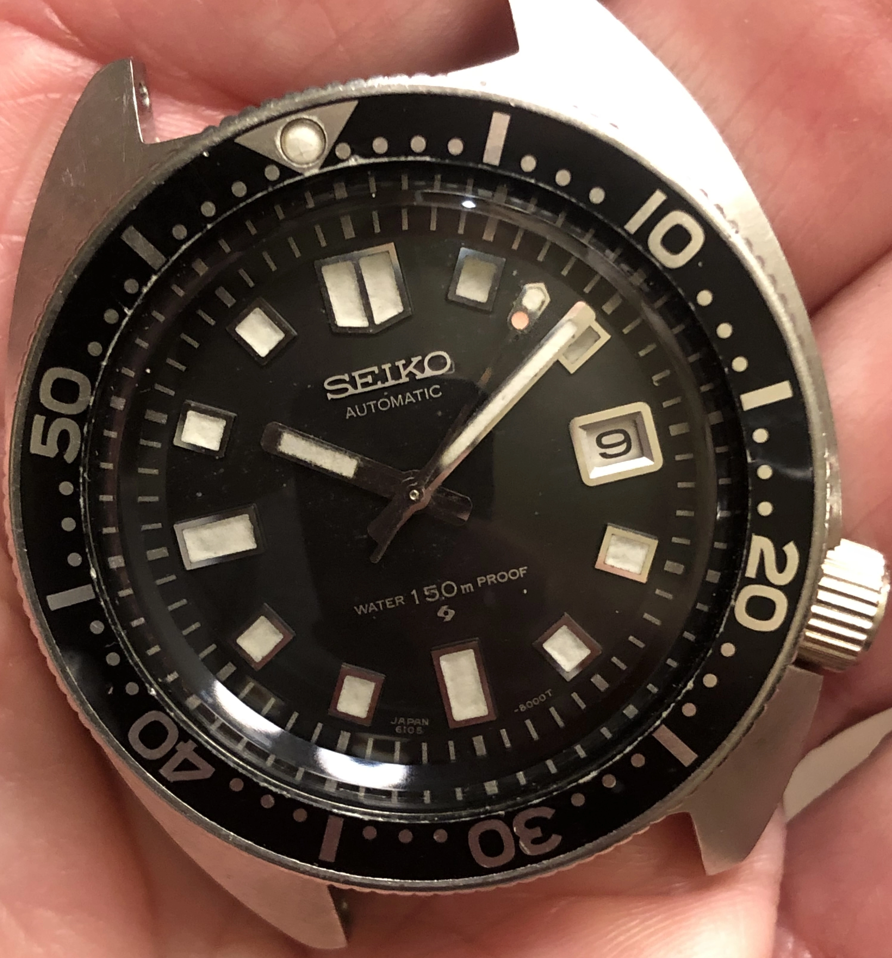

I was hoping for a sanity check on the lume on a 6105-8000 Slim Willard I'm looking at (also for my general knowledge). Everything seems original and honest with the watch but the high magnification closeups of the dial make me wonder if there has been a relume at all or is this how these watches came in the late 60s?

It's been a very long time since I was studying these daily but I'd err on the side of relume for this one.
Originals, to me, look like a true quality job; flat and the lume fill sits slightly lower than the plot surrounds. This one looks fully filled.
Colour wise, I believe that a tan/biege lume is accepted as original on some range of these, as opposed to the more likely green.
For the price that these now command I'd suggest caution and patience.

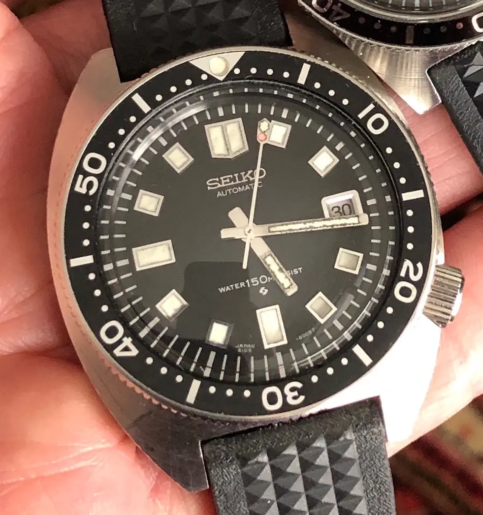

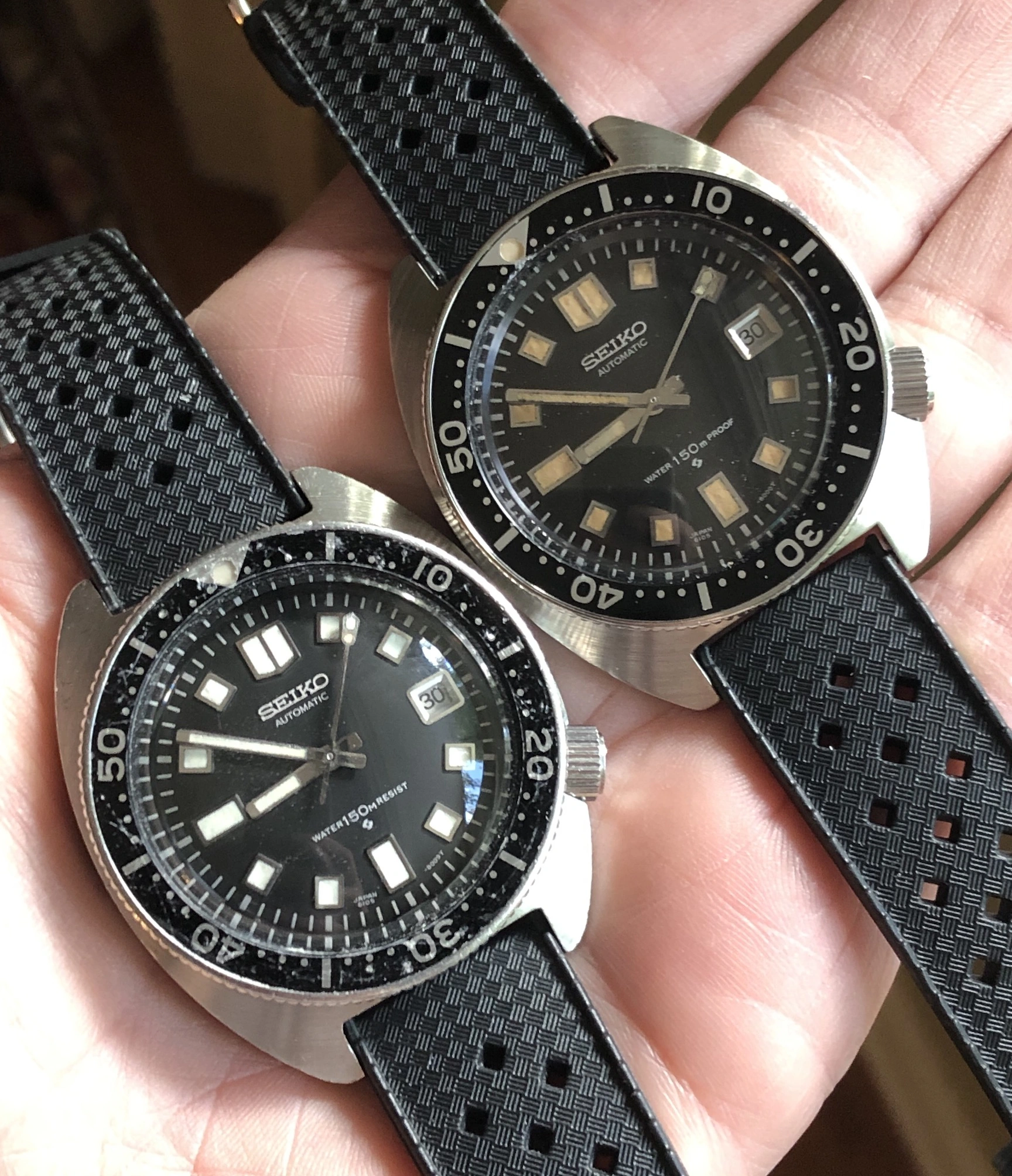

Often relumed because of mold. Daini examples have highly radioactive tan lume. The typical Suwa watches are green, but look very light in crappy iPhone photos like this one.
Better photo of the Suwa.

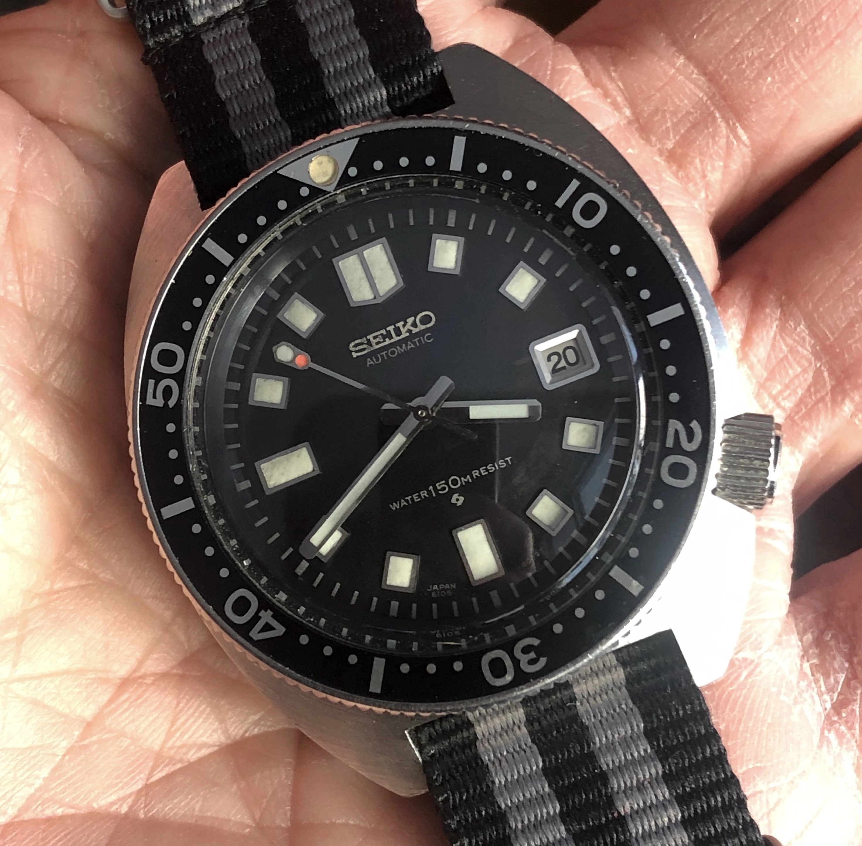

Here's another resist dial. Can't find a good photo of my proof dial at the moment.

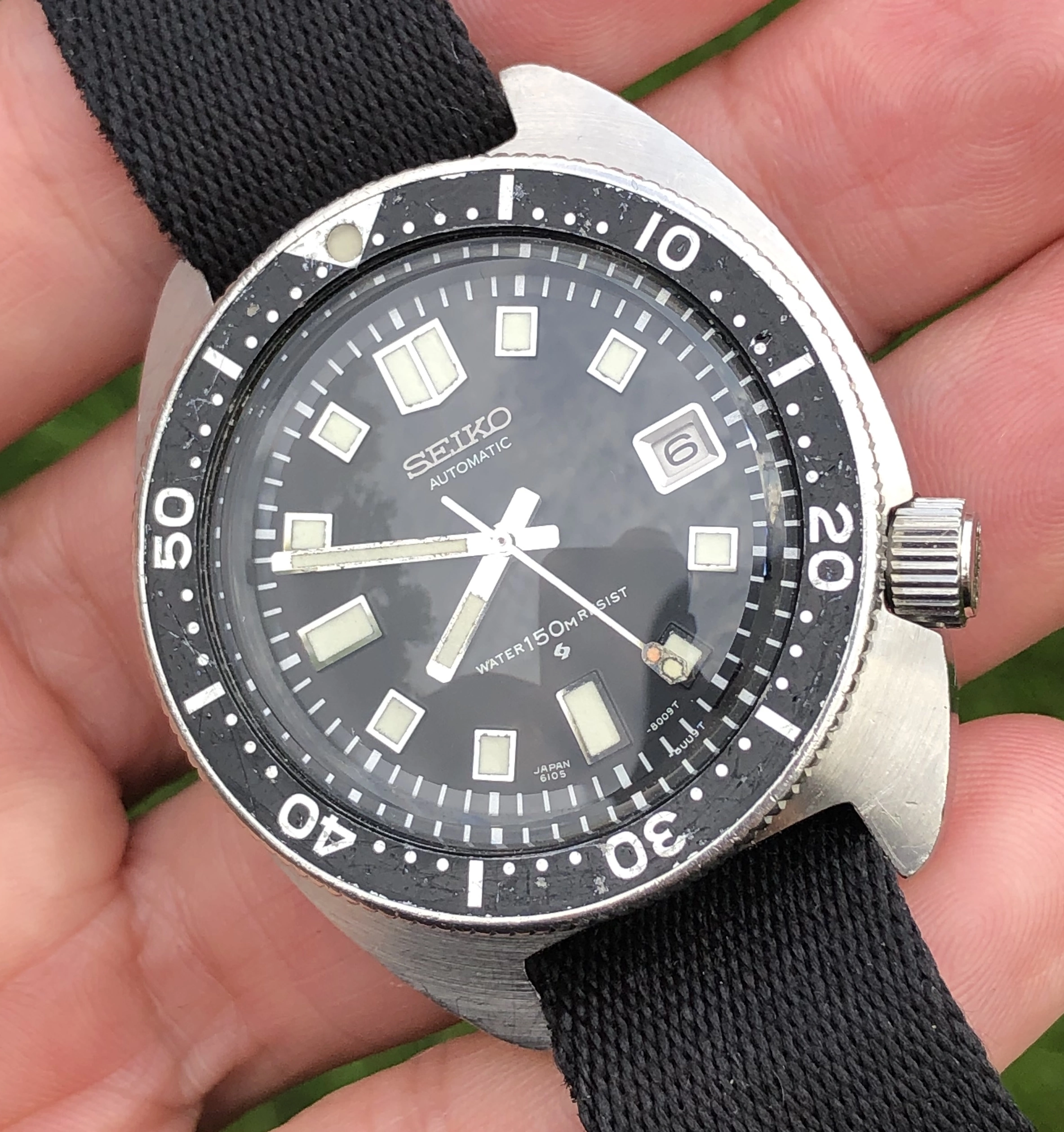

Here's another. Original dial but relumed / aftermarket hands.

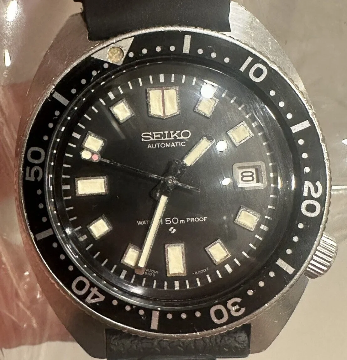

Here's a proof. Lume looks about the same to me. Recessed in the lume pots, kind of a wavy texture.

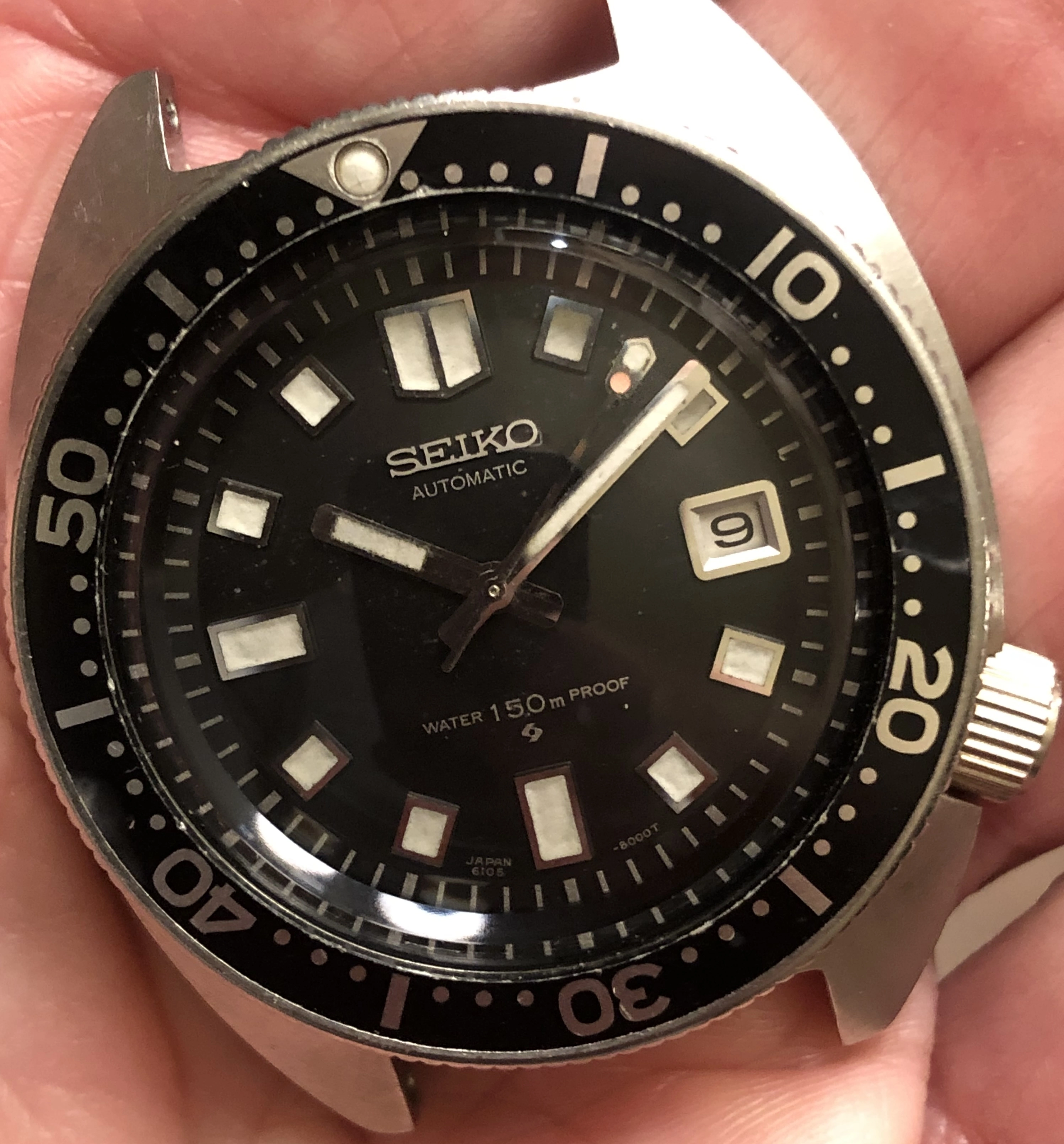

I like these much more than the -8110, they are my favorites next to the 62mas. Unfortunately, I only have three left, all different variations with no duplicates, so I don't have one to sell at the moment.
Fantastic collection. The dark lume seems like the rarest of them all? Interesting discussion on why it’s more radioactive and Suwa vs. Daini build

The Daini are probably the least common. Legit resist/proof examples are also pretty uncommon, but it is difficult to distinguish legit from franken. Seiko did not use radioactive lume (even tritium) for domestic production as it was not allowed in Japan. The brown lume on this reference and others is not just radioactive, but very hot, and from the Daini factory. They were presumably made for export, but the details are murky.

That's interesting. I didn't realize they did radium lume for the export market.

Getting back to the OP’s question, that looks like a relume to me. The color is a bit on the tan side for a Suwa dial and the original Seiko lume was a bit coarser grained than this looks to be. The metal surrounds on the plots show some wear and corrosion, but the lume doesn’t - usually, if you see some corrosion of the metal you’re going to see some darkening at the edges of the lume unless the lume has been replaced. FWIW, some of the better dial restorers out there (not naming any names) will refinish the lume plot surrounds with a little matte lacquer before reluming; this seals the metal against further corrosion.
Also FWIW I’ve seen more Daini movements in 6105-8009s than other 6105s. No idea why the Daini watches were sent to the NA market, but that seems like it was the case. I have a pretty nice Daini -8009 I picked up a while back; the dial wasn’t so great so I had it relumed in a fairly deep tan.

Appreciate the info. It didn’t quite feel right, this thread confirms for me.
I passed on the watch, on the hunt for a different example. Good ones are hard to find!
