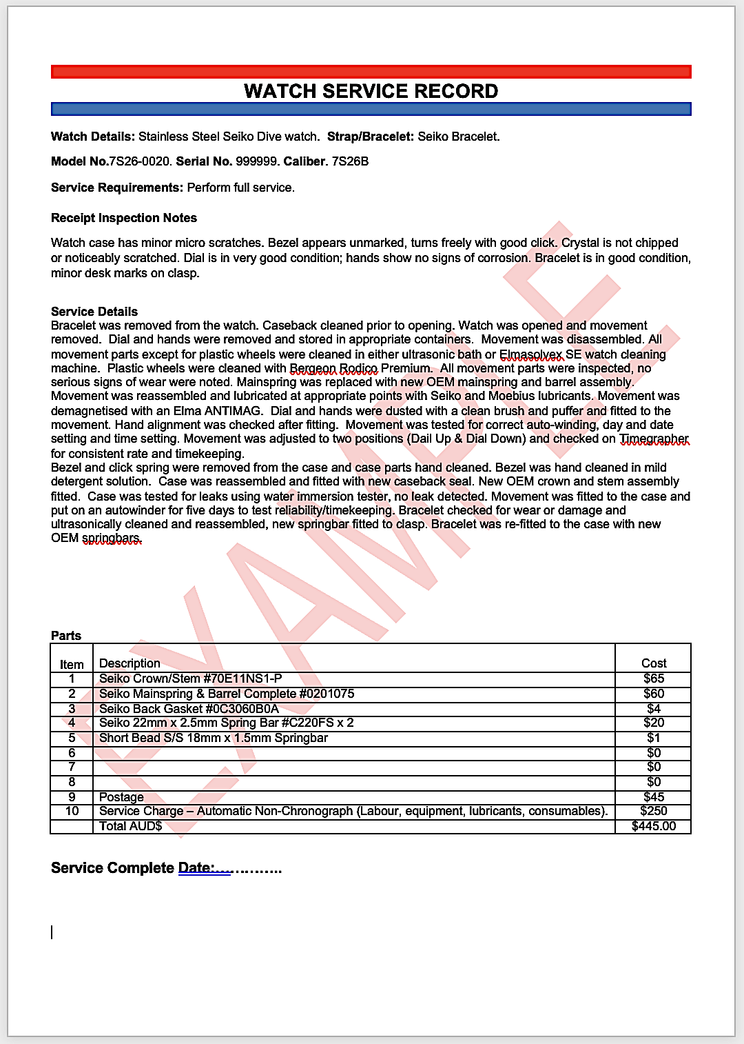

Some watchmakers provide a report on the servicing, sometimes with photos of the process.
At the very least, you should get a description of the service and documented test results.
Unless you are standing over their shoulder you have to rely on trust.
I provide something like this (Note: I'm not a Professional watchmaker).
