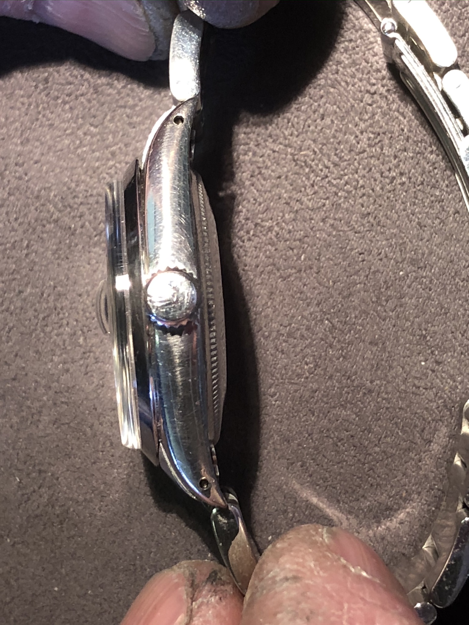

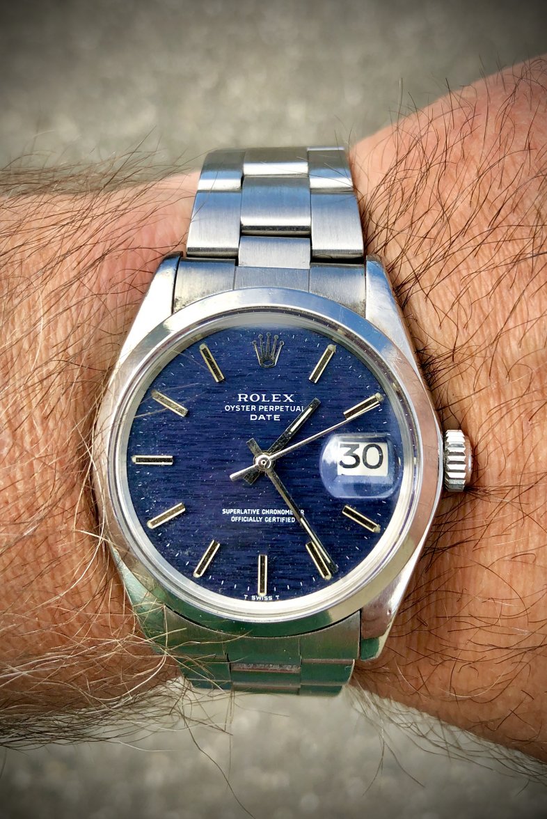

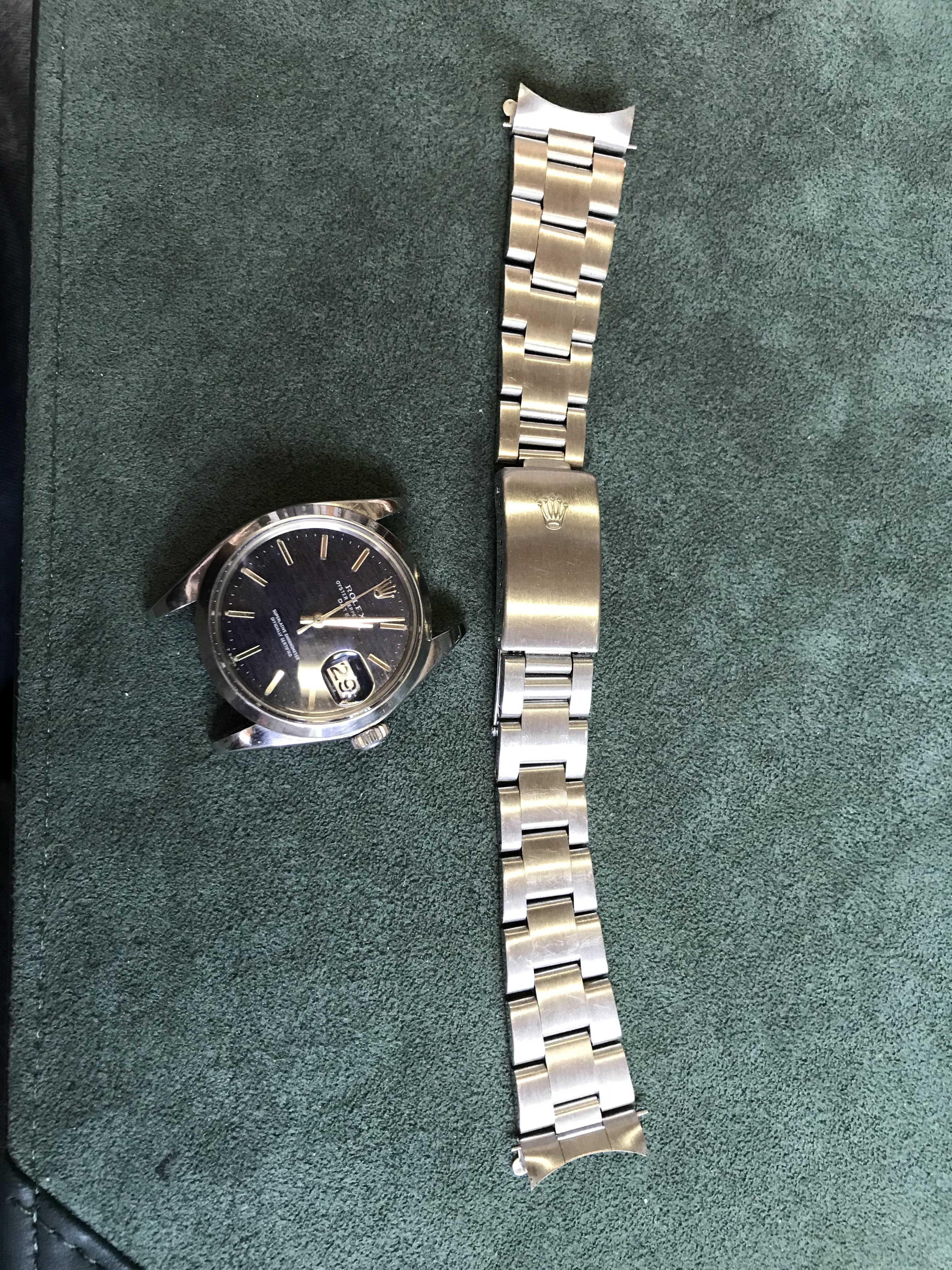

Hello All, I am looking at a 1970 Rolex Date 1500. I have focused on Omegas and do not much experience in Rolex. Watch has a fresh Service. Original Blue Linen Dial. Original bracelet in apparent good condition. From my untrained eye, it looks to be unpolished. I don't know a lot about Rolex and seek input from members. It is being offered at $2,500 by a friend. No box or papers. Any guidance is greatly appreciated. Is the price reasonable? Please comment on condition. The blue linen dial is really stunning in person.
24,825
55,217
The bracelet is obviously not original (it's a later solid link bracelet for sure, you can date it using the clasp code if you care). The case looks ok, but sleeve polished. Some typical blue-dial degradation around the lume plots, which is actually reassuring. The price is no bargain for a 1500 in general, but it's not outrageous given that the dial is desirable. It's always nice to see the numbers between the lugs (serial and reference) and inside the case-back (reference and date), to make sure everything is consistent with no replacement or service parts.

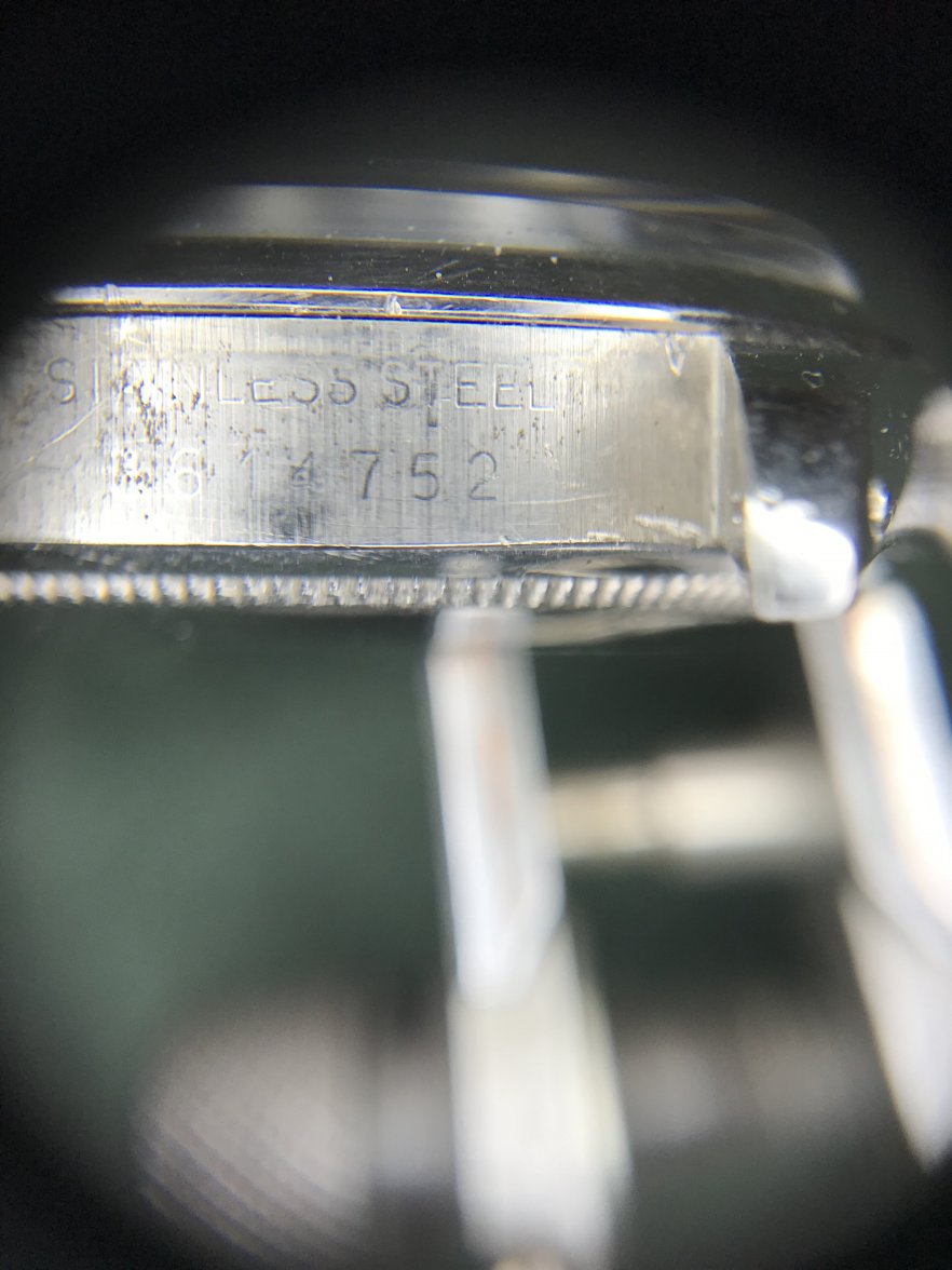

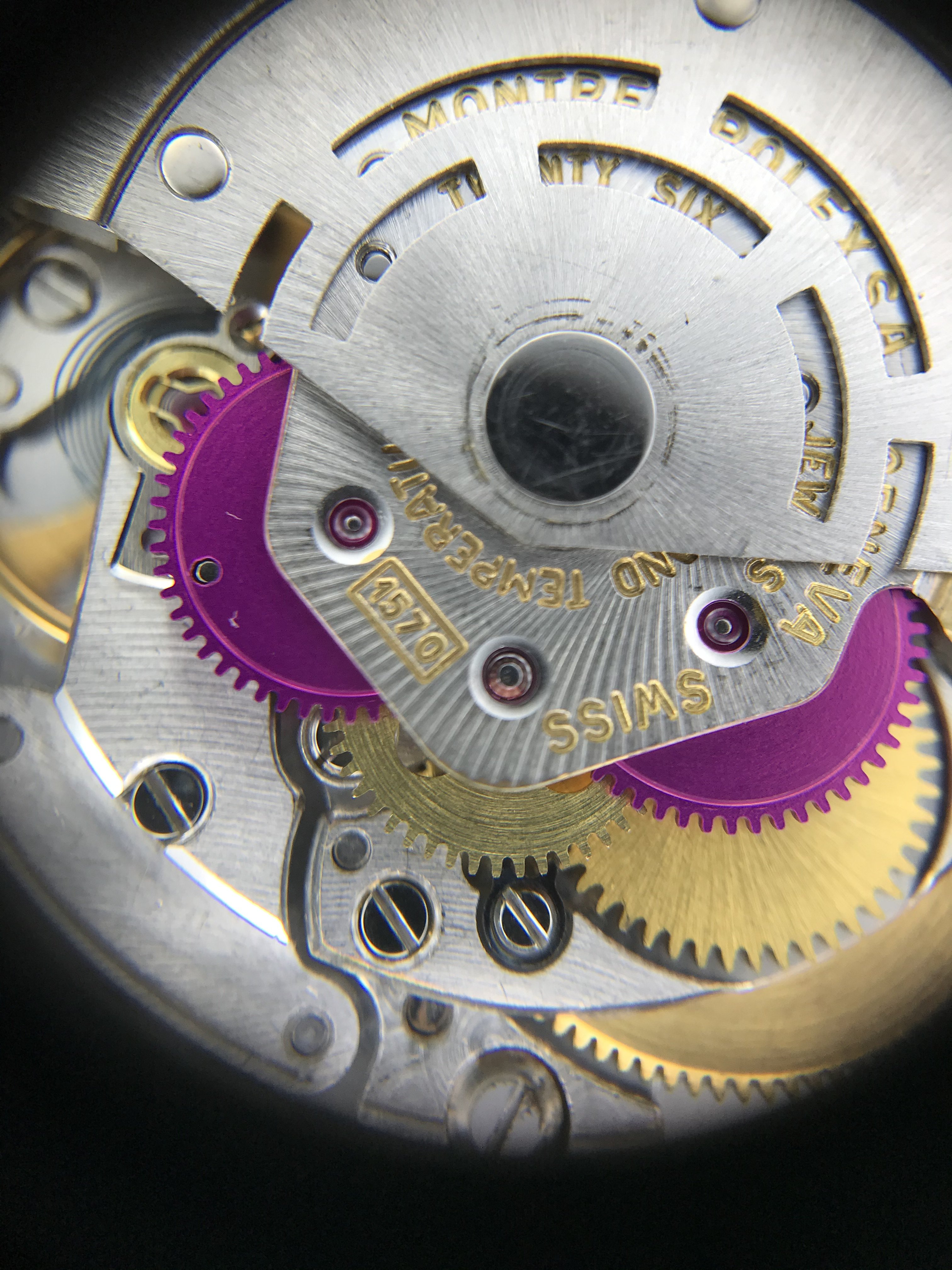

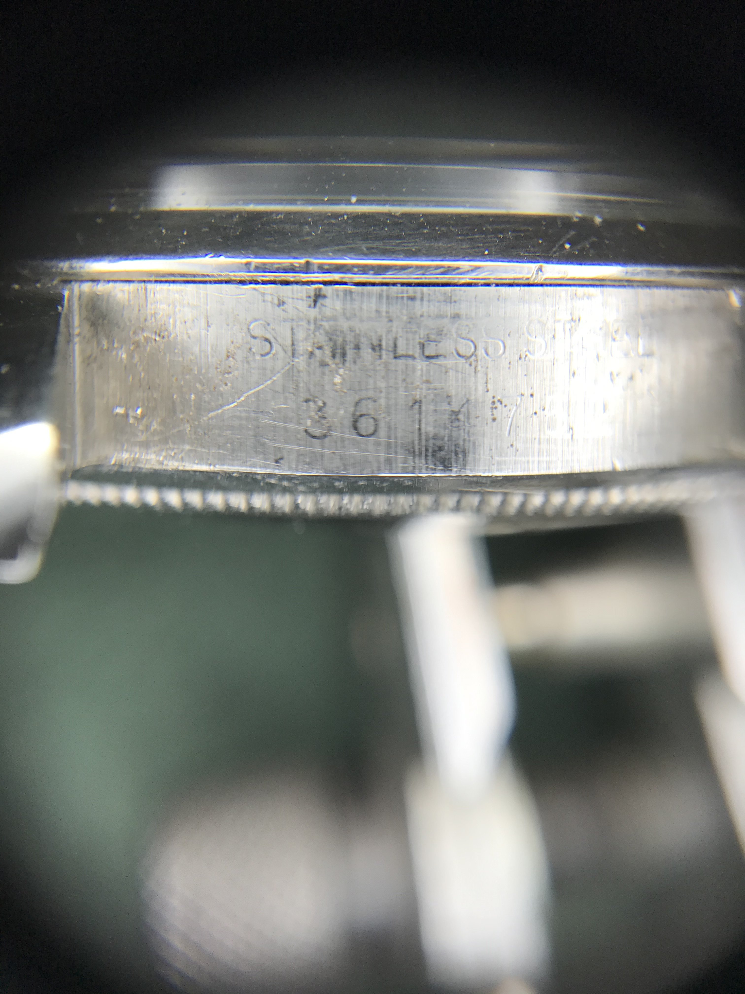

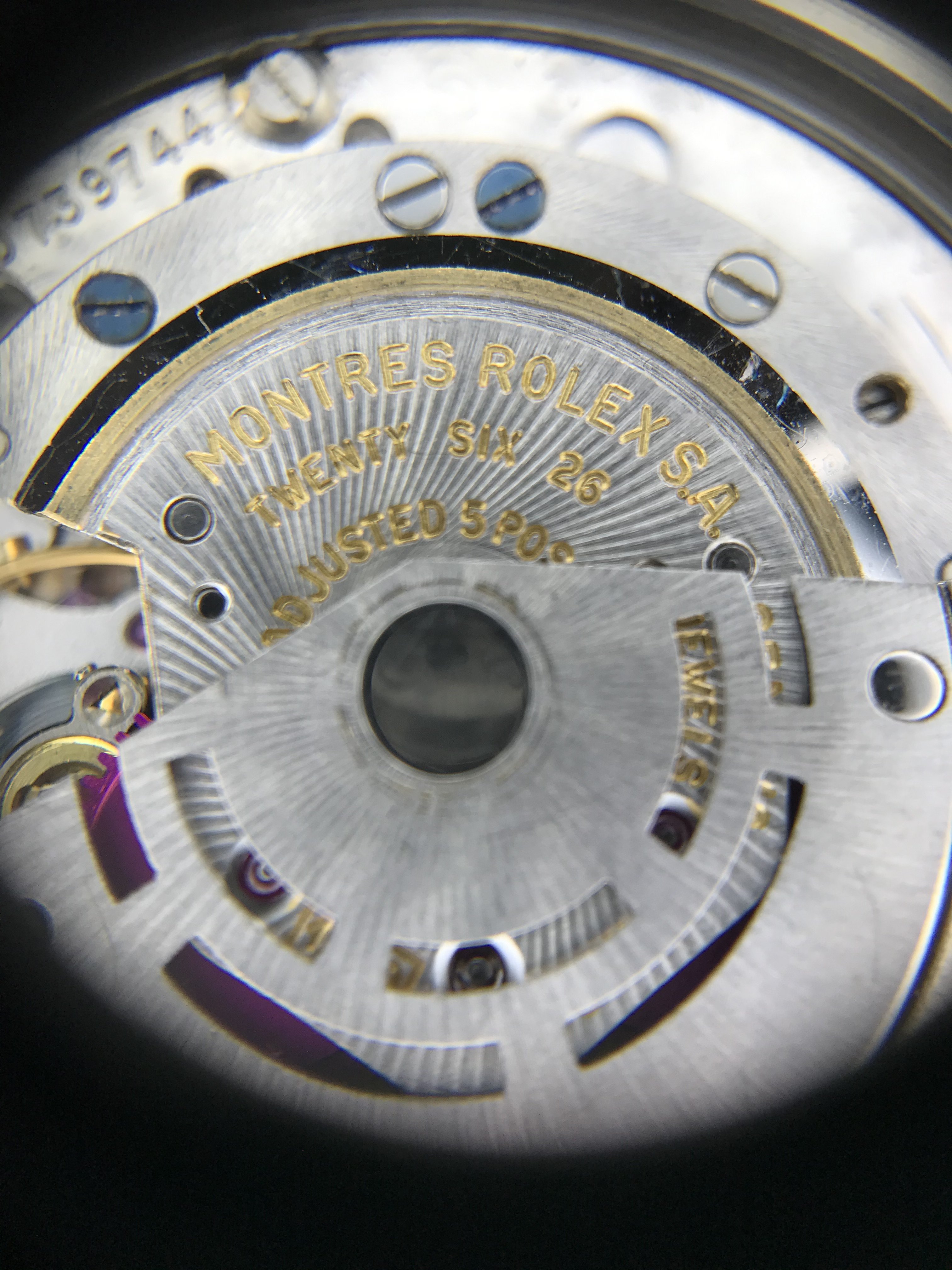

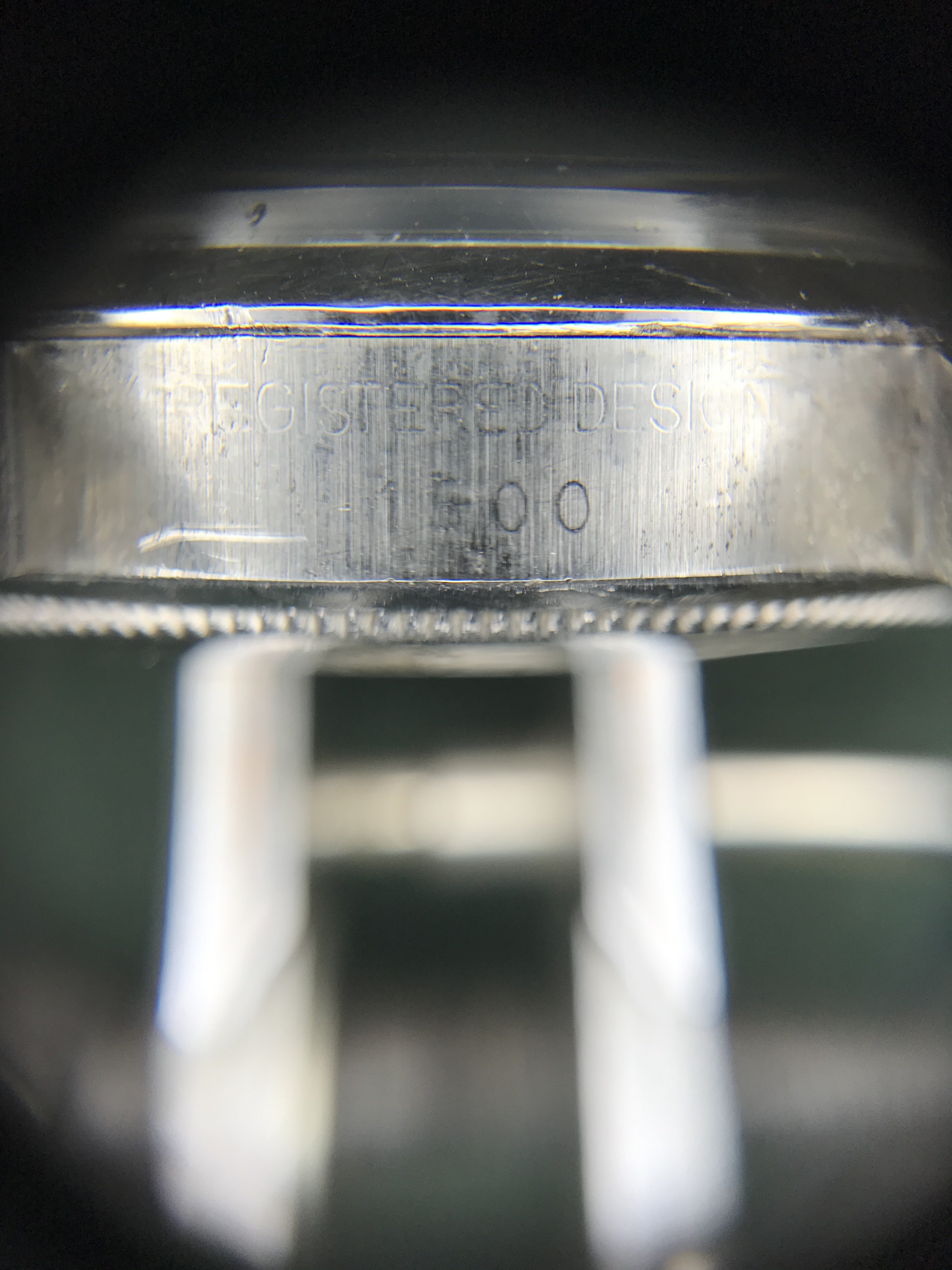

Thanks Dan. Here are photos of the lug numbers and case back. It is about the same size as my c-case Constellation and I am pretty happy with the size on that one.

It's likely that the case-back was swapped at some point. 3.6M would more typically have a 1972 case-back. 1971 would be unlikely. 1970 would really surprise me.
1970 case-backs would typically have serial numbers in the 2.5M-ish range more or less. These numbers are never exact with Rolex, but this discrepancy is pretty large compared to the usual. Again, my opinion.
Still, if you love it, don't over-think it. It's still a nice watch with an unusual dial, and even if the back is swapped, it's not the end of the world. Maybe just get the price down a bit in case you decide to sell at some point.

@impalla62ss that’s a good looking dial 👍 your thoughts on case size? as others have mentioned, watches appear much larger on photos.. nice catch, enjoy!
1,193
6,193

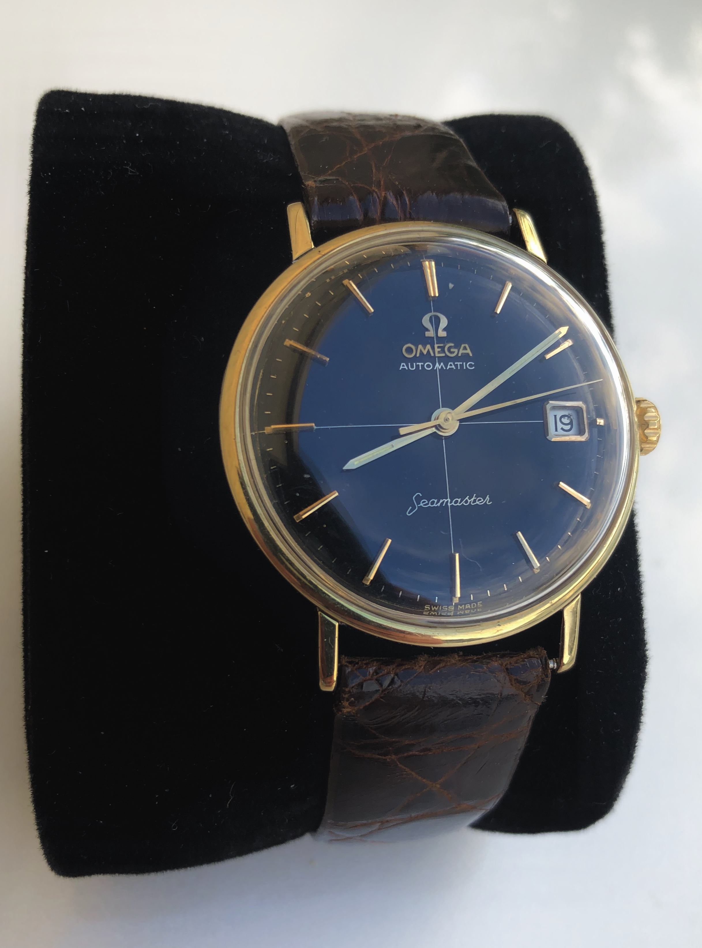

I am really into vintage. It is the same size as my Omegas and it wears bigger than my C-Case Connie. As long as it is not a 28mm Seamaster size I am good with the smaller sized vintage stuff.

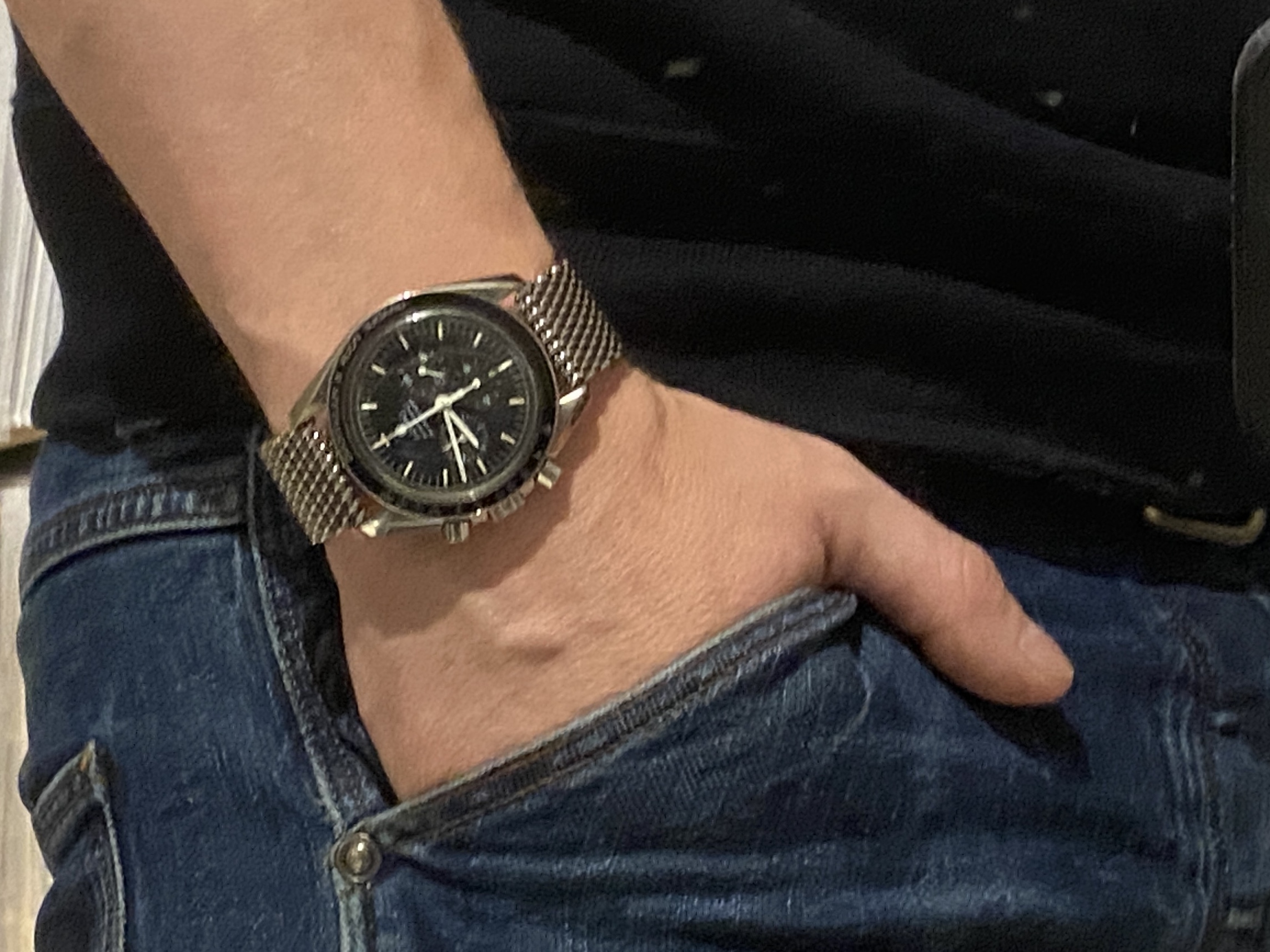

I wear my 34mm OP (along with other 34mm vintage Omegas) and also wear 42mm Speedies and divers. Both sizes look fine IMO. Never understood the need to limit yourself to only a certain watch size. Hard to take pictures in a way that shows the real size but:
