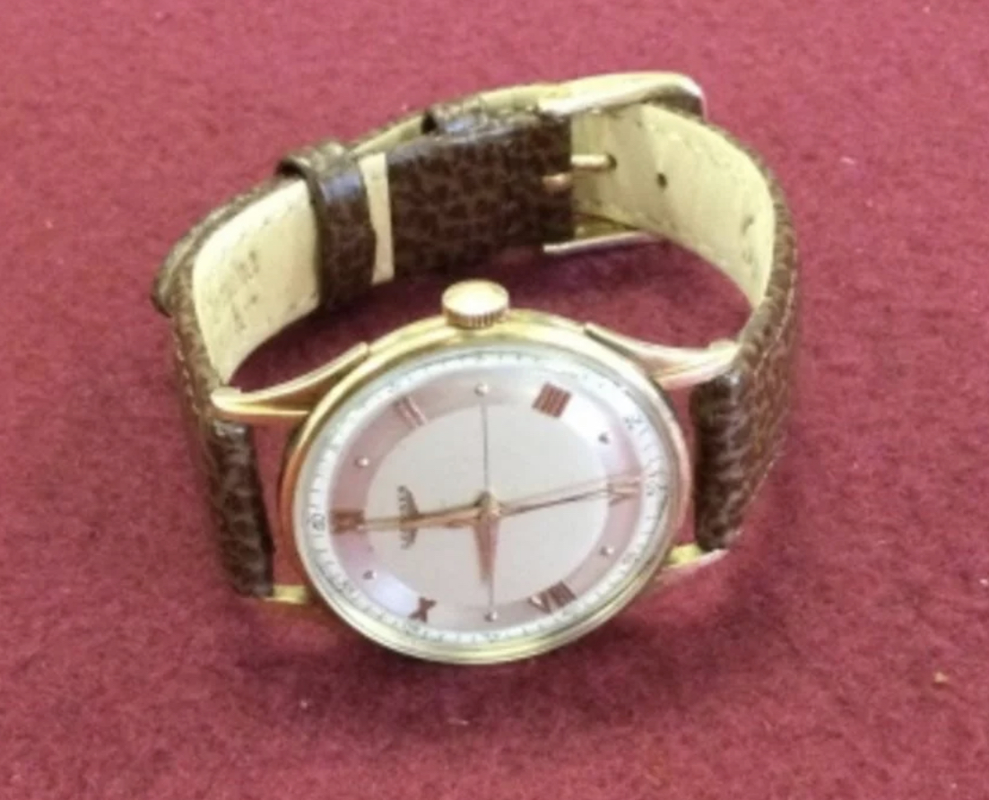

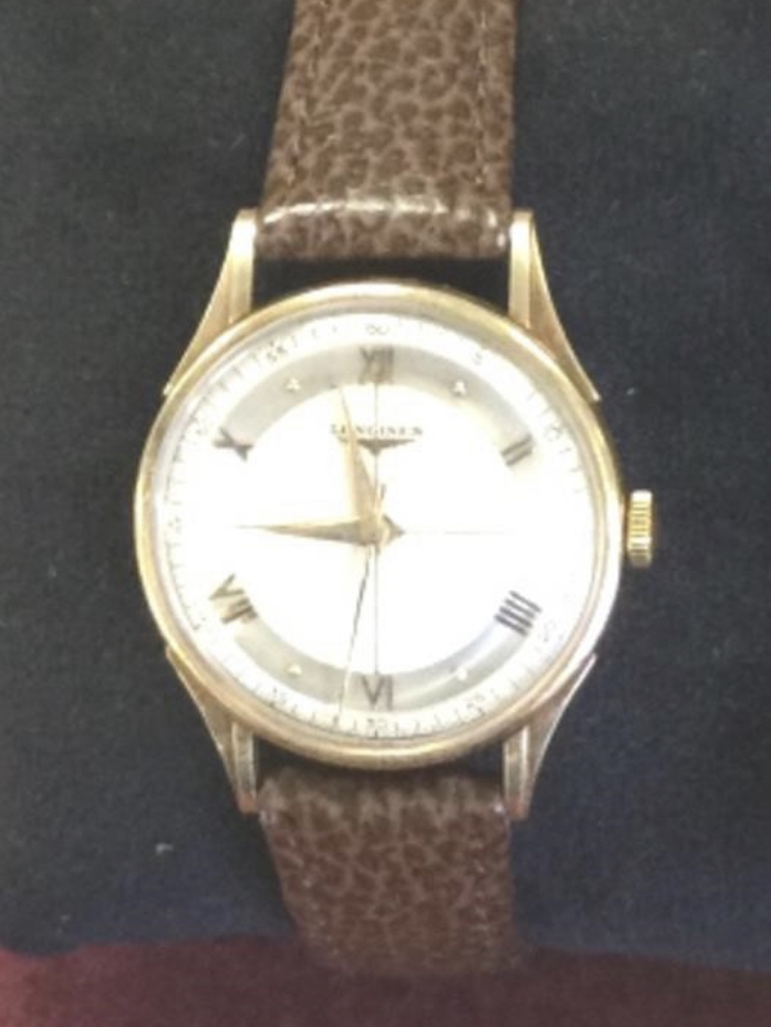

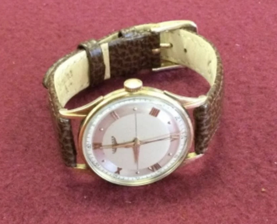

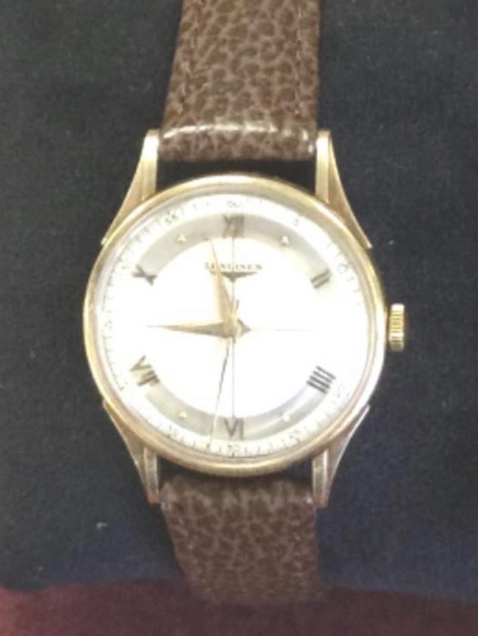

I’ve been on the hunt for a vintage scientific dial Longines for quite some time now. Recently, I noticed that one in solid 14K gold was coming up for auction as part of an estate. The photos provided were poor, but when I called I was assured that the watch was running well and in fantastic condition with an original dial. I asked for a photo of both the dial and movement, but the very polite and seemingly knowledgeable older gent on the other end of the line (who happened to be a watch/clock collector with over 300 pieces) wasn’t sure how to attach them to an email.

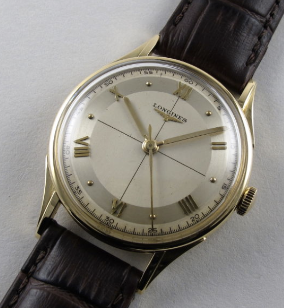

All the scientific dials that I’ve seen have the applied romans overhanging the darker band on the dial but the ones on this example fill the band… does this suggest a redial? I’ve attached the photos that were included on the auction bellow.
I’m a bit embarrassed to admit that I won the bid even though something didn’t feel quite right. Have I been duped?

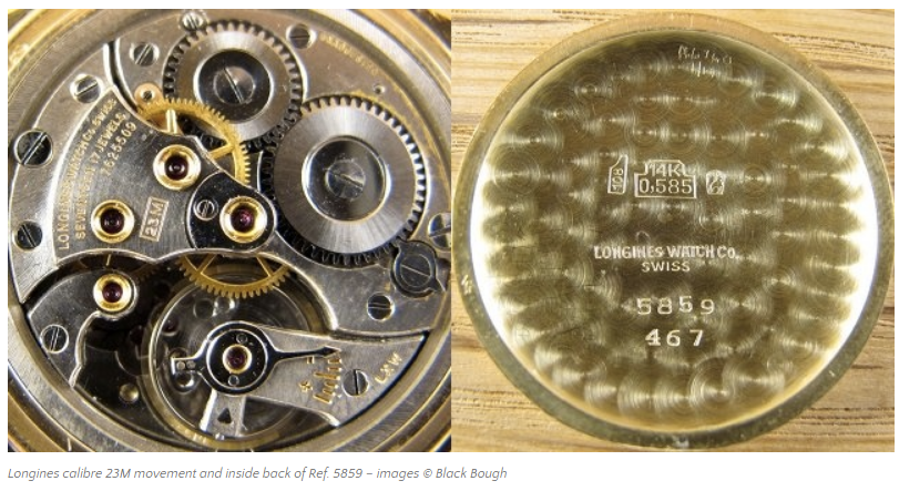

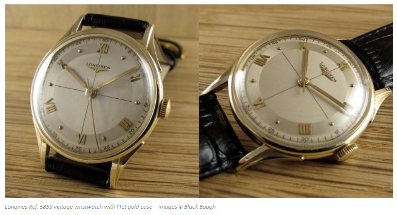

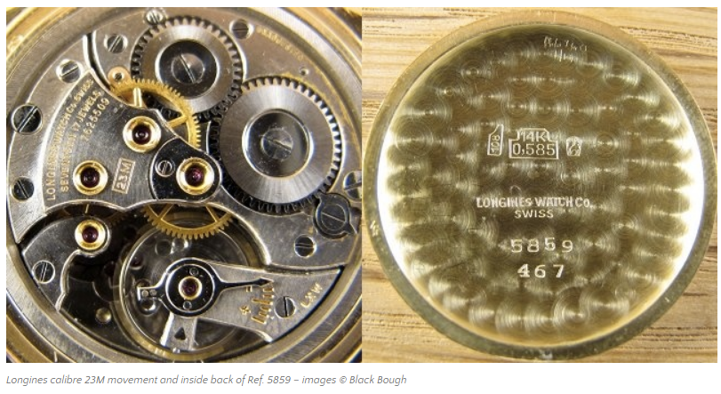

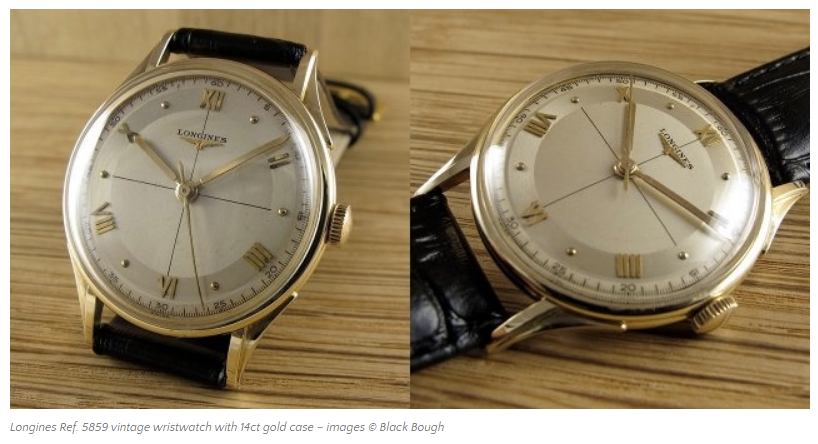

Cannot properly judge the dial based on these photos. Here is an example (reference 5859, caliber 23M) where the Roman numerals do not extend beyond the circular brushed ring. As a side note, I am not sure why these dials are referred to as "scientific dials".
https://www.blackbough.co.uk/product/longines-ref-5859-gold-vintage-wristwatch-circa-1948-wwlttdd/
https://www.blackbough.co.uk/longin...re-14ct-gold-wristwatch-with-three-tone-dial/

This is extremely reassuring, thanks!
236
913

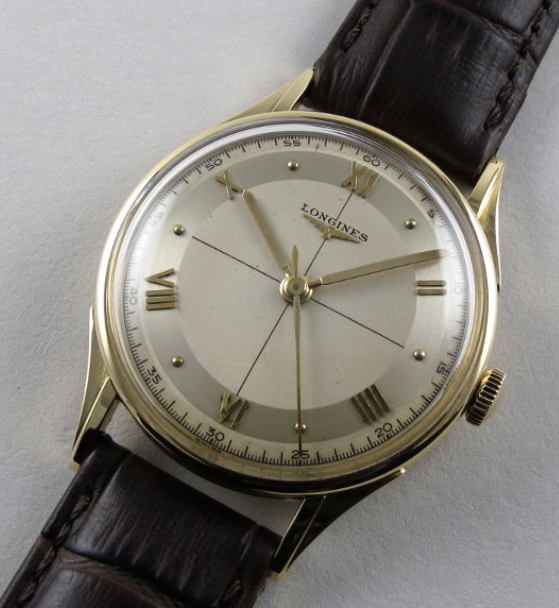

imo this variant looks particularly pleasing, perhaps the thinner concentric ring adds to the class. Believe both variants are authentic

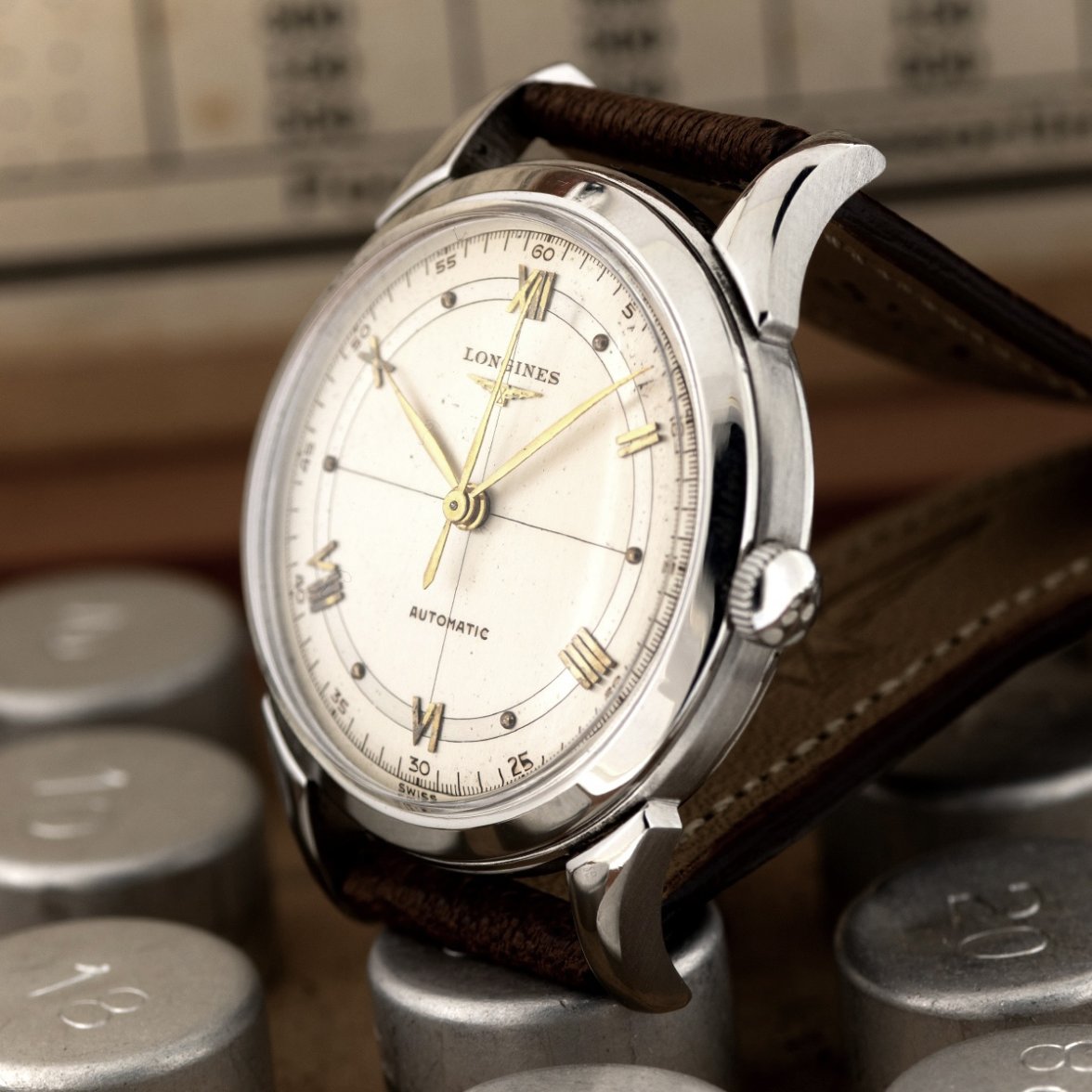

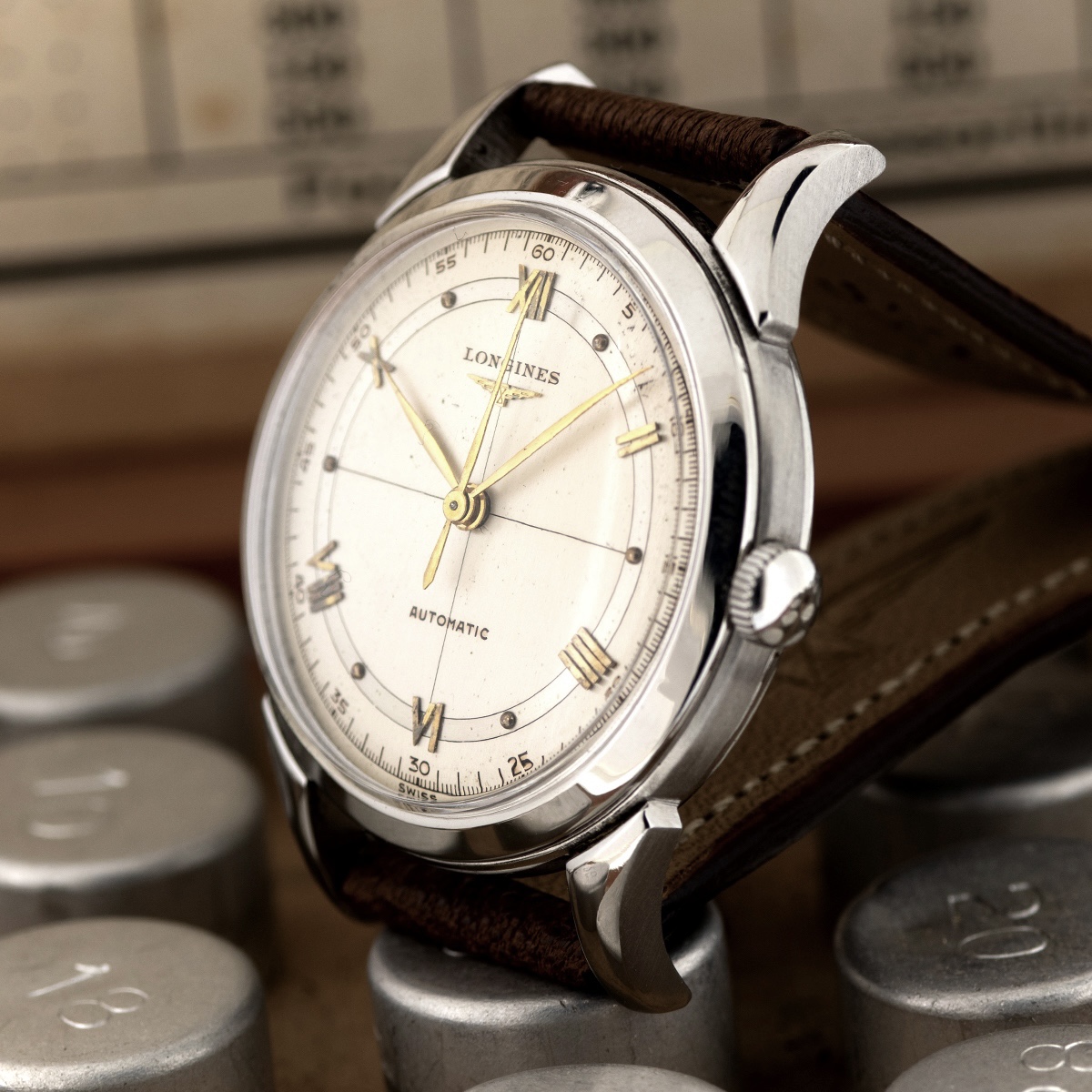

Have you received an extract from Longines' archive? I am surprised to see this dial in a steel case.
Yes I have received an extract: Ref 6006 was originally delivered in 1954 to Belgium
2,829
4,945
Thank you for the response. Most examples I have seen were delivered to USA and cased in gold.
