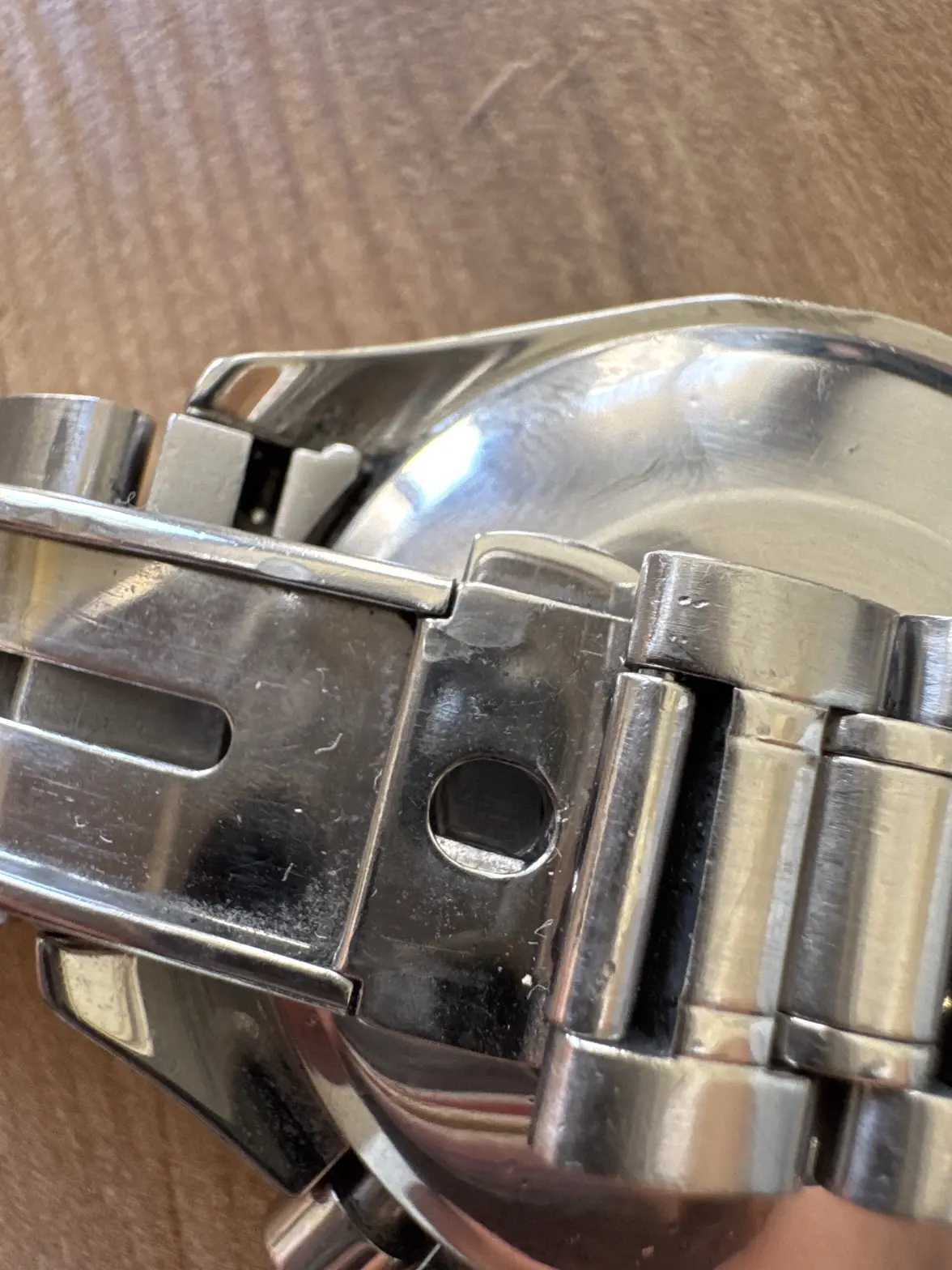

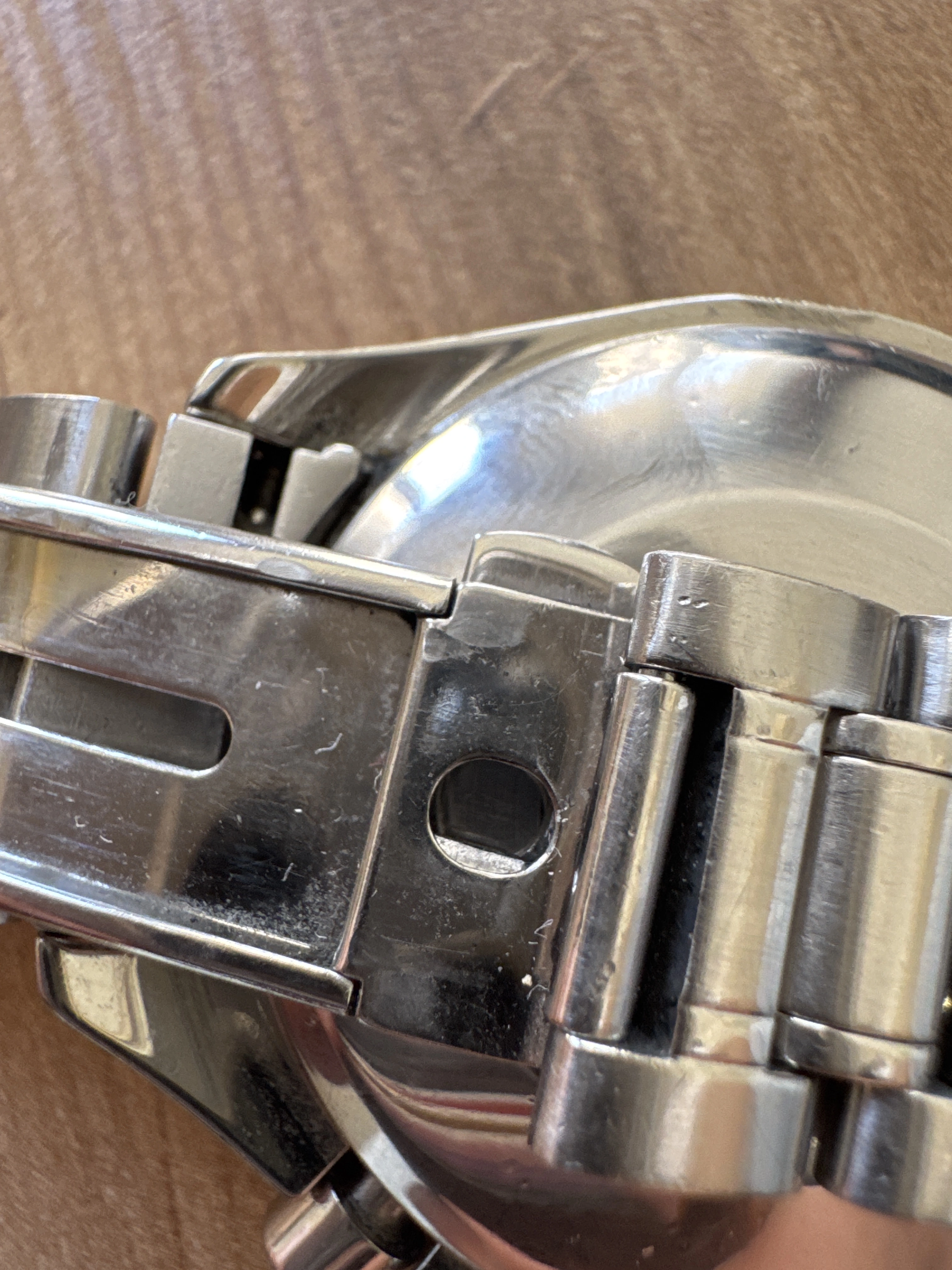

D Posts 2 Likes 0 dbjifc ·Mar 29, 2025 Hi there! My Omega Speedmaster has a 1562/850 bracelet clasp that doesn’t properly close anymore. There seems to be something wrong with the thing you press to open the clasp, it seems to be loose in some way making the clasp open on its own sometimes. Does anybody know the fix for this?? Thanks!!
Posts 30,187 Likes 77,936 Archer ·Mar 29, 2025 Most likely a broken spring inside the clasp. They can be replaced.
D Posts 2 Likes 0 dbjifc ·Mar 29, 2025 Archer Most likely a broken spring inside the clasp. They can be replaced. Thanks friend! You know where i might find these?
Posts 30,187 Likes 77,936 Archer ·Mar 30, 2025 D dbjifc Thanks friend! You know where i might find these? You can look for part number 085ST0058.
