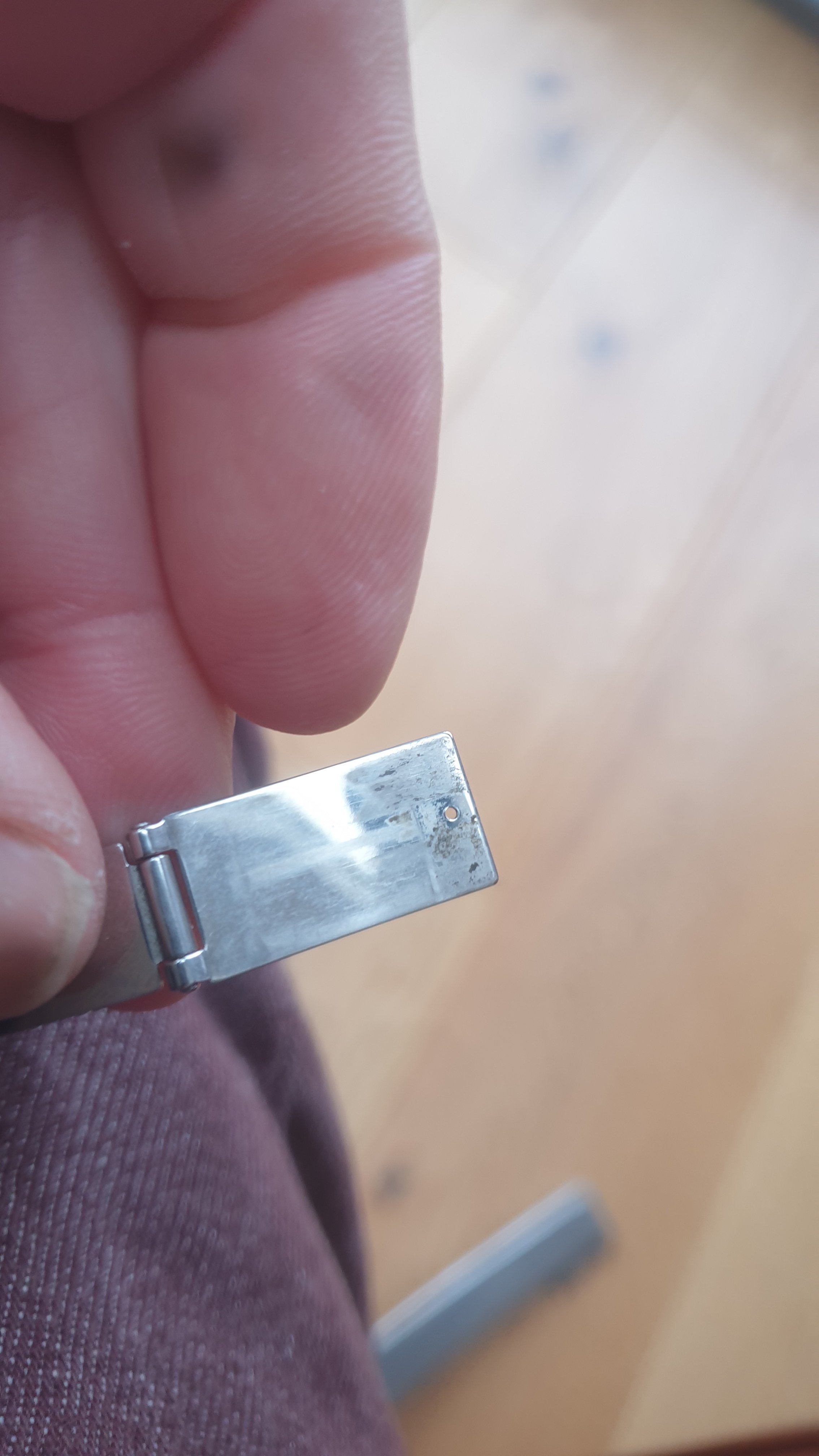

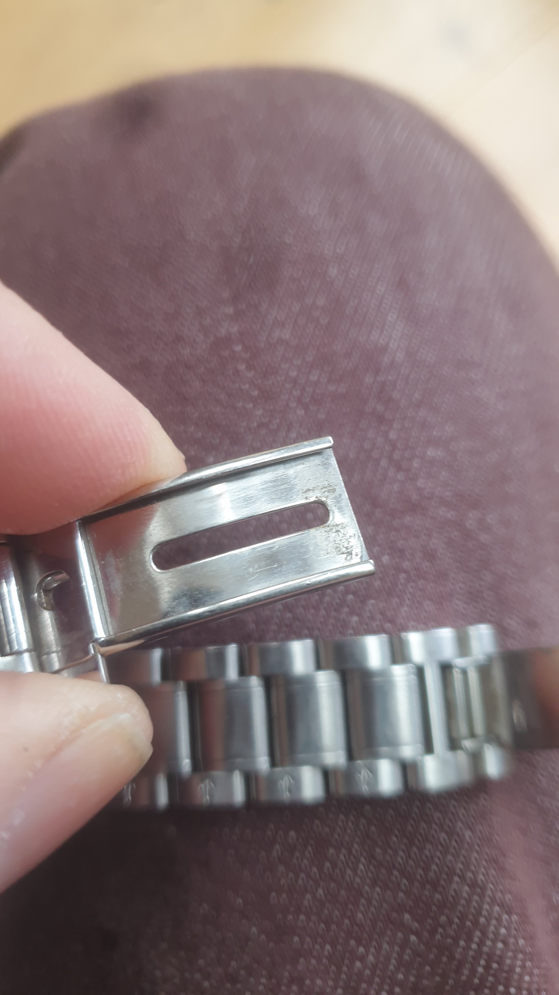

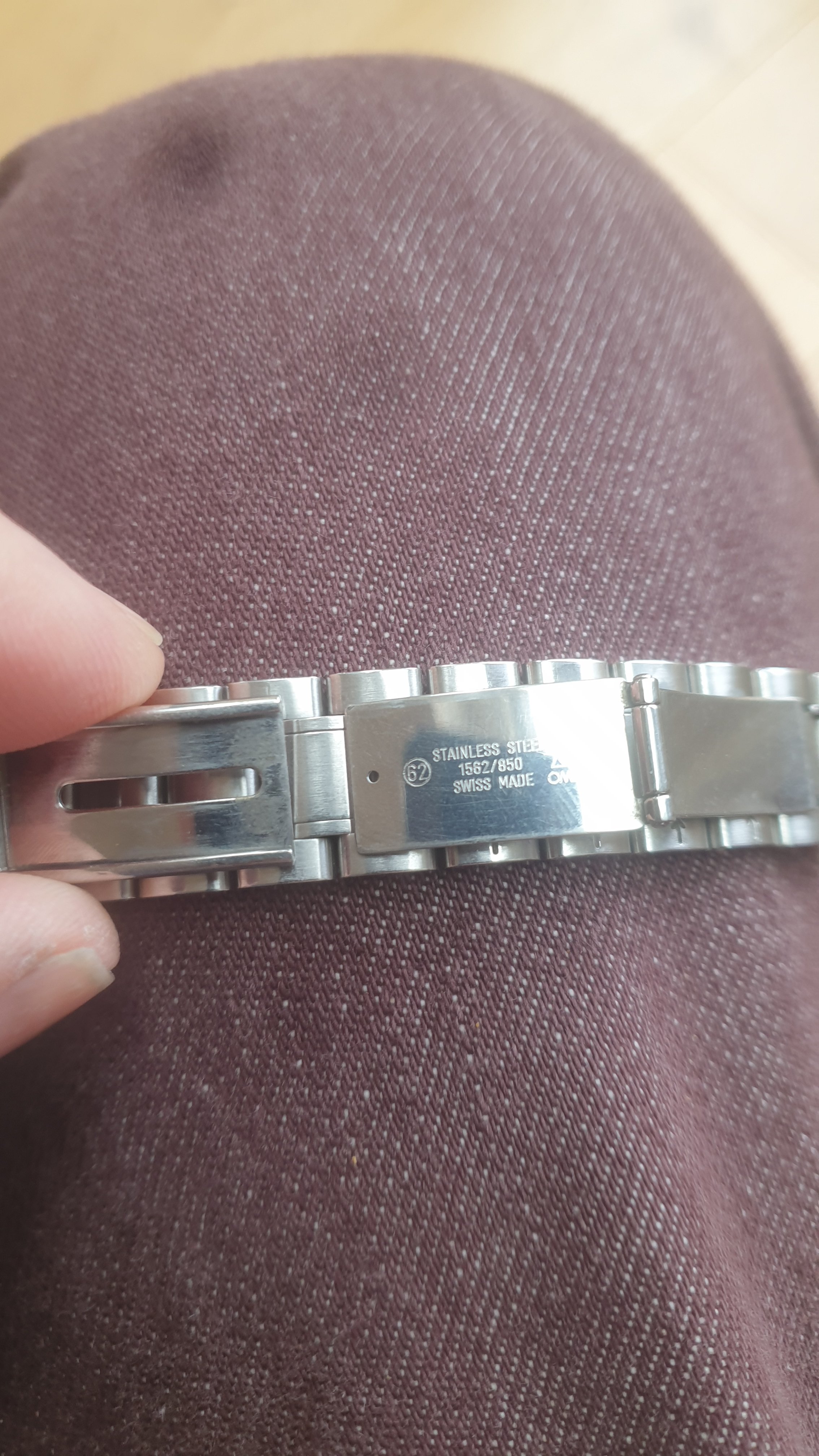

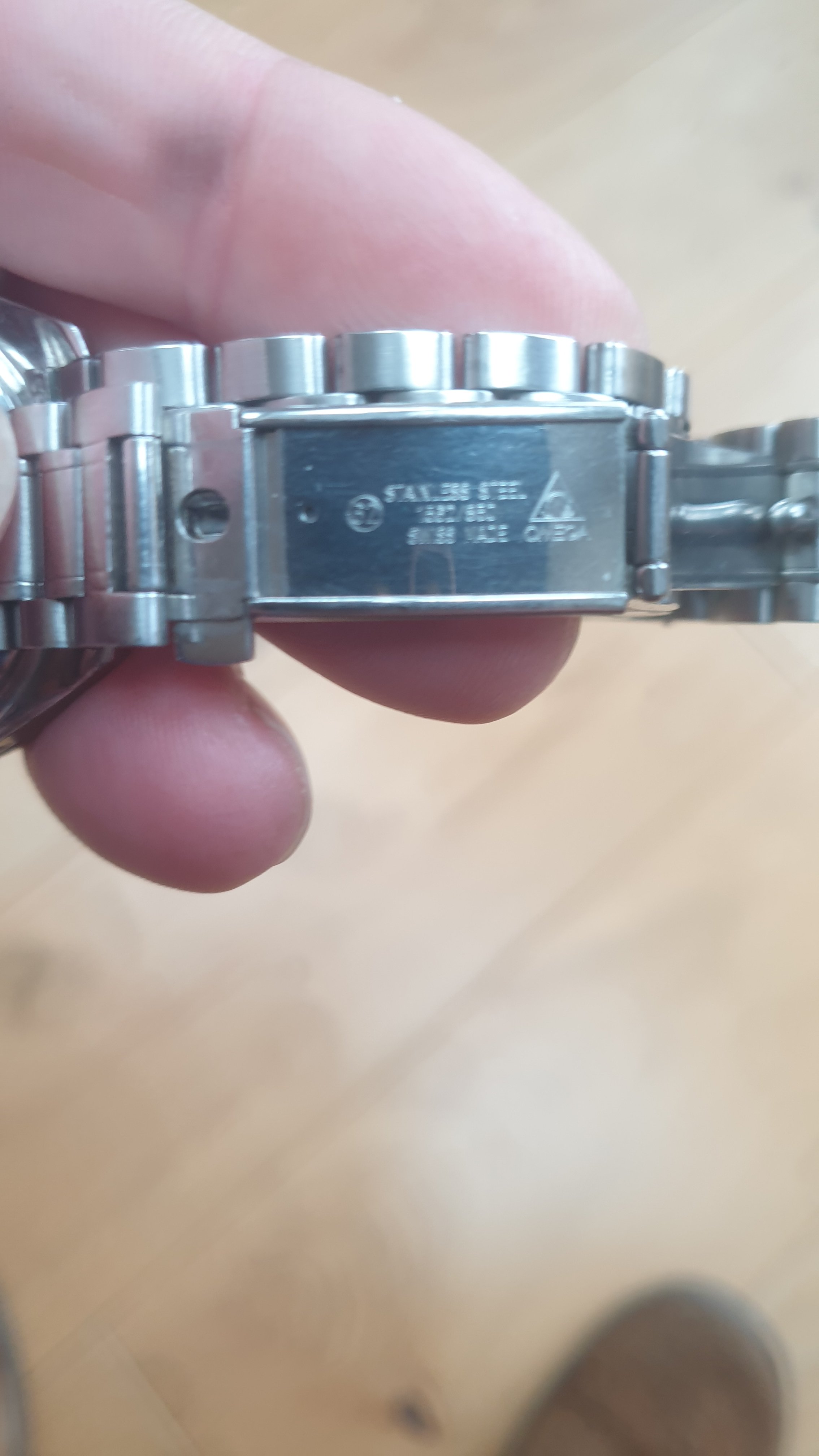

Hi, hope someone might be able to advise me please if it is possible to replace or repair the inner clasp on a 1562/850 bracelet. Is it possible to just replace the sliding pin mechanism or do I need a complete new part. Photos enclosed. Many thanks.

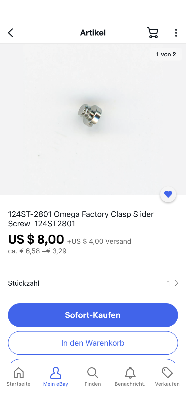

I think you just need to replace the pin alone, which is sliding in the slot. If I remember right is is a pin with a thread and a tiny screw.
If you do not get a pin maybe a watchmaker with laser welding can fix that for you.
kind regards Max

Thank you very much . I certainly will purchase and see if it works.
