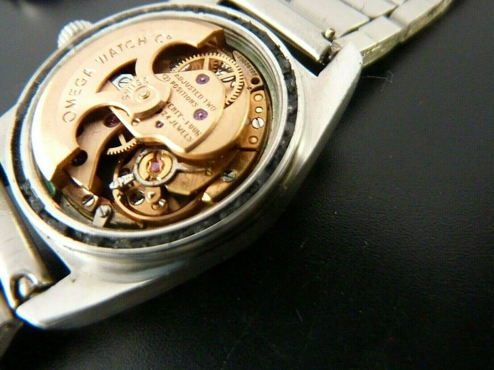

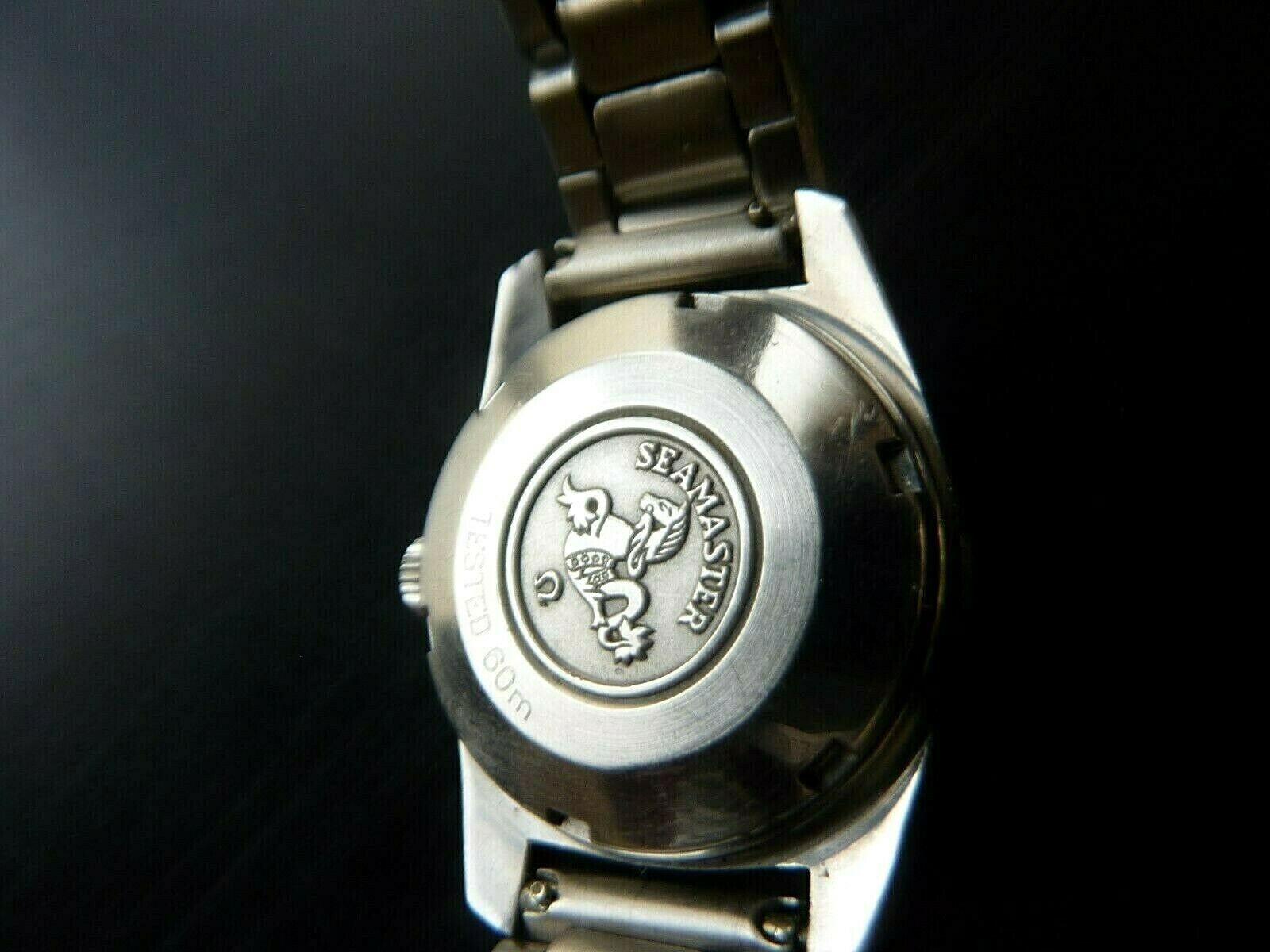

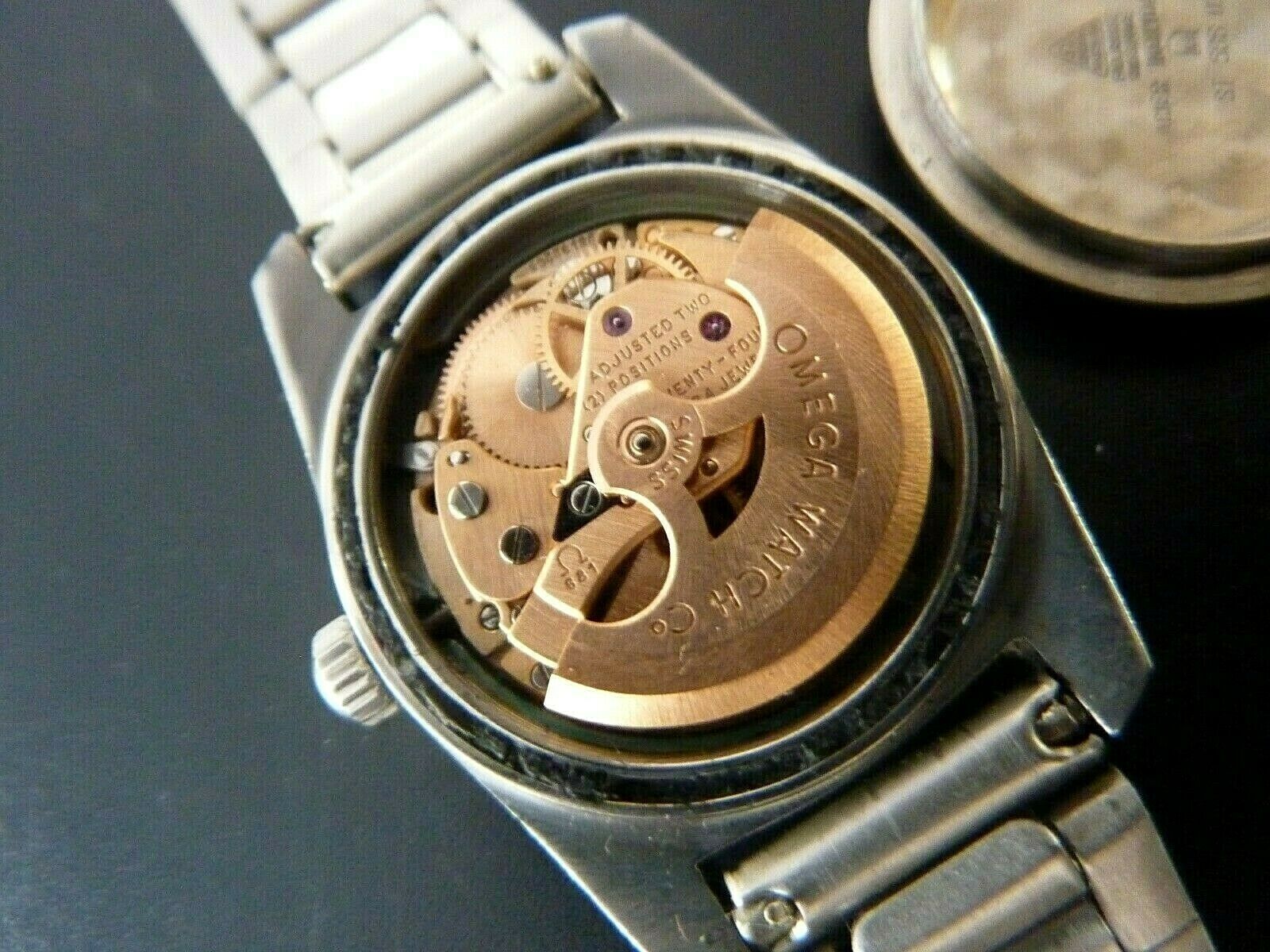

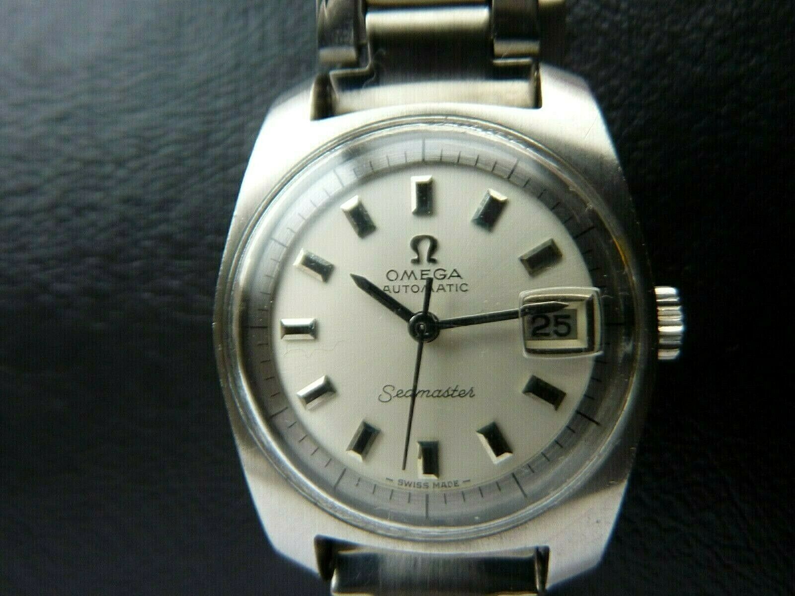

Hello -- I am on the hunt for my first Omega. I've been looking for a C-Shape Constellation (which I've done some research on), but in the process just stumbled on this watch, a ladies' automatic Seamaster with a 681 movement, which is being offered for $500. This watch looks good to me, but I know nothing about Seamasters--and would love to hear what members of OF think of it. I've asked the seller for the serial number. Thank you!!

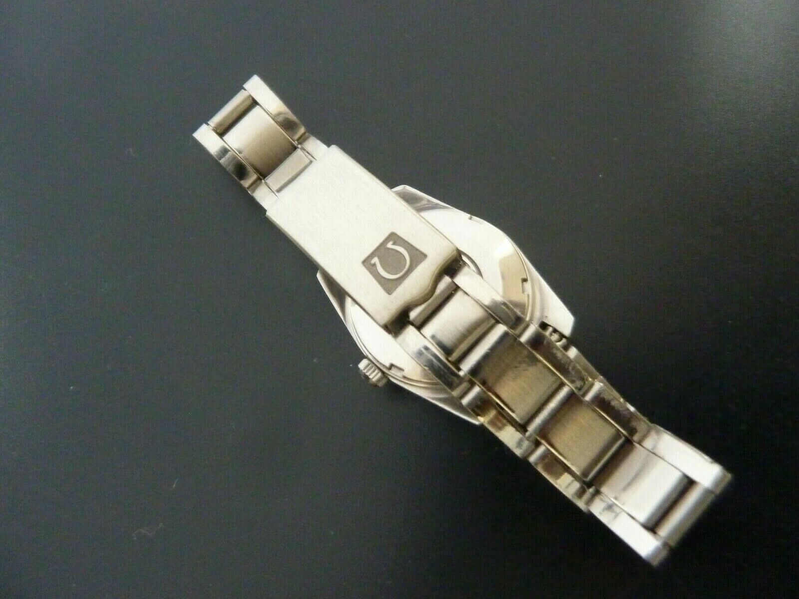

Looks nice, price maybe high. The case gasket is going bad: this one will probably need a full service before use, keep that in mind. Also make sure the bracelet is big enough for you, tracking down additional links is usually a hassle.
So much this. Omega rarely carries vintage bracelet links.

Excellent advice! I just sort of assumed it would fit—as if all women are the same size lol. And thanks, I was wondering about the crumbling black stuff. The seller claims it’s been “overhauled,” but guess I’d better ask what that means.

It is likely BS here: a proper overhaul/service does not leave a crumbling gasket on the case...

These ladies Omega’s are normally a steal compared to their larger male counterparts (smaller watches are out of vogue at the moment). That said, this seller is a little unrealistic, if that were a full size Seamaster I would say $500 was a very fair deal- this one should be around $250-300 tops. The cost of service however is the same regardless of size- parts is parts and labor costs the same, so always factor in the cost of a service unless the seller can provide you with actual written documentation from the watchmaker of what was done and parts replaced. “I had my guy adjust it” is not a service.

Thank you! Would you say that a ladies Constellation of the same era is slightly more valuable? The Seamaster movement (681) is adjusted to two positions whereas the 682 in a Constellation I am also considering says it is adjusted to the usual 5 positions and 3 temperatures. So it would seem to be a better mechanism, hence worth more?

50 years after they walked out of the factory, you probably won't notice the difference in timekeeping. Better have a clean seamaster than a worn constellation.
A constellation should be more valuable but as women's models, both are not really "hot" right now, so not sure if there is a real price gap.
