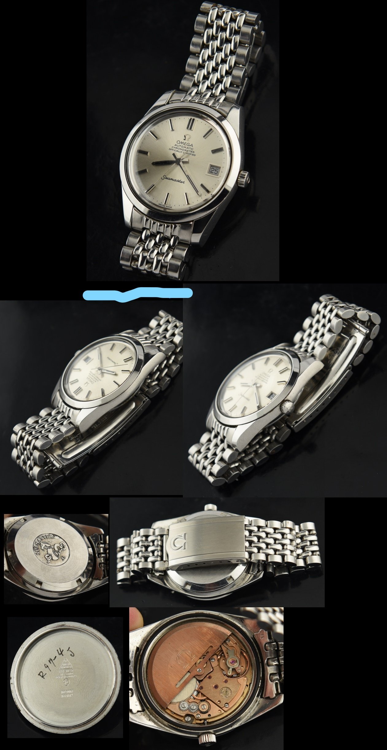

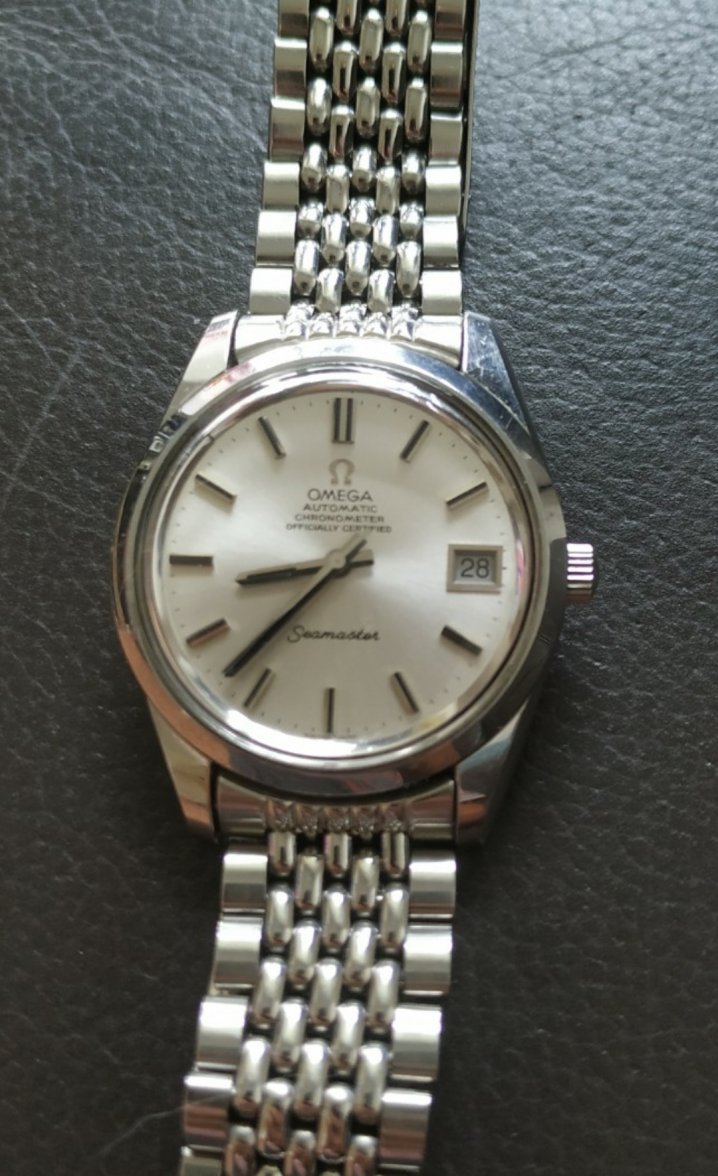

If it has a 1012 caliber it has the wrong dial, 1012 is not chronometer rated.
Price is bricks & mortar store x 2.
6,832
10,502
this is a double reference case back reference.
So it could be a 168.0061 chronometer version.
however, the pics aren’t good enough to see the movt cal.
If it is a 1012, then it is either the wrong dial or wrong movt.
6,832
10,502
There are some of the chronometer version on the net with those thick hands.
With a couple appearing on OF
(Doesn’t mean to say they’re correct though)
