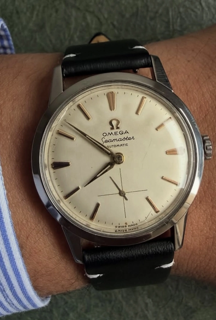

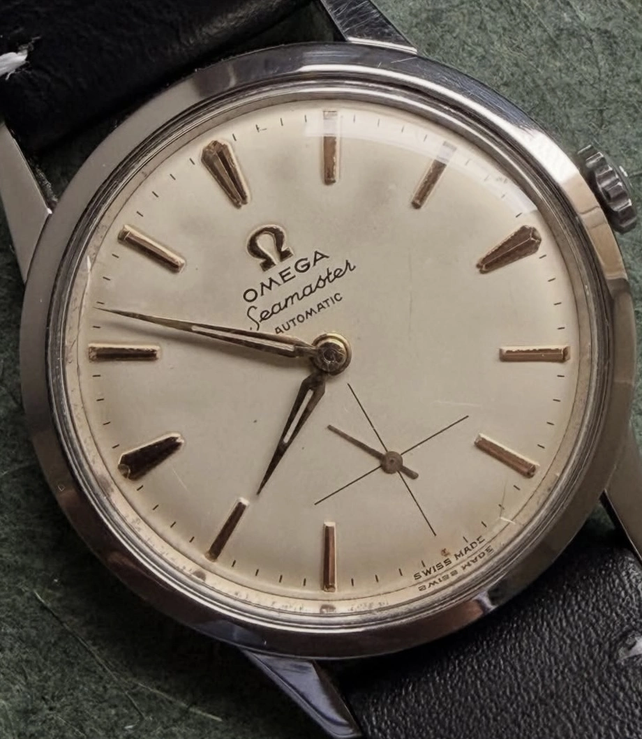

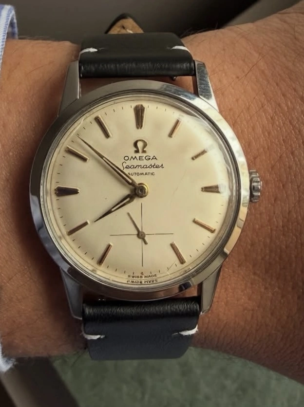

I am considering purchasing a vintage Omega Seamaster from a local dealer here in Brazil, but I have some concerns regarding the authenticity and matching of parts. I would appreciate your expert eyes on this piece.
Seller's Information:
  • Model: Omega Seamaster
  • Stated Reference: 14767-61
  • Asking Price: Approx. $850 USD
  • Description: Described as being in "excellent condition" with an original dial.
My Concerns:
Reference vs. Movement Clash:

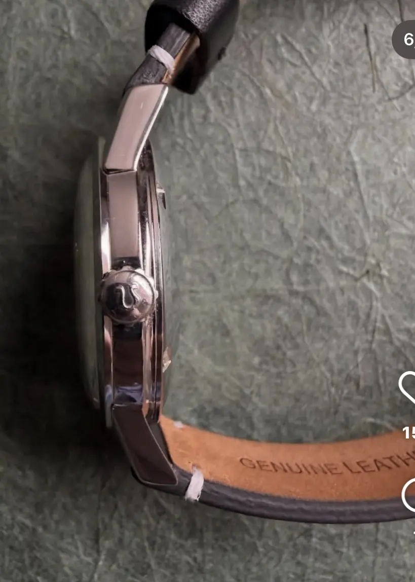

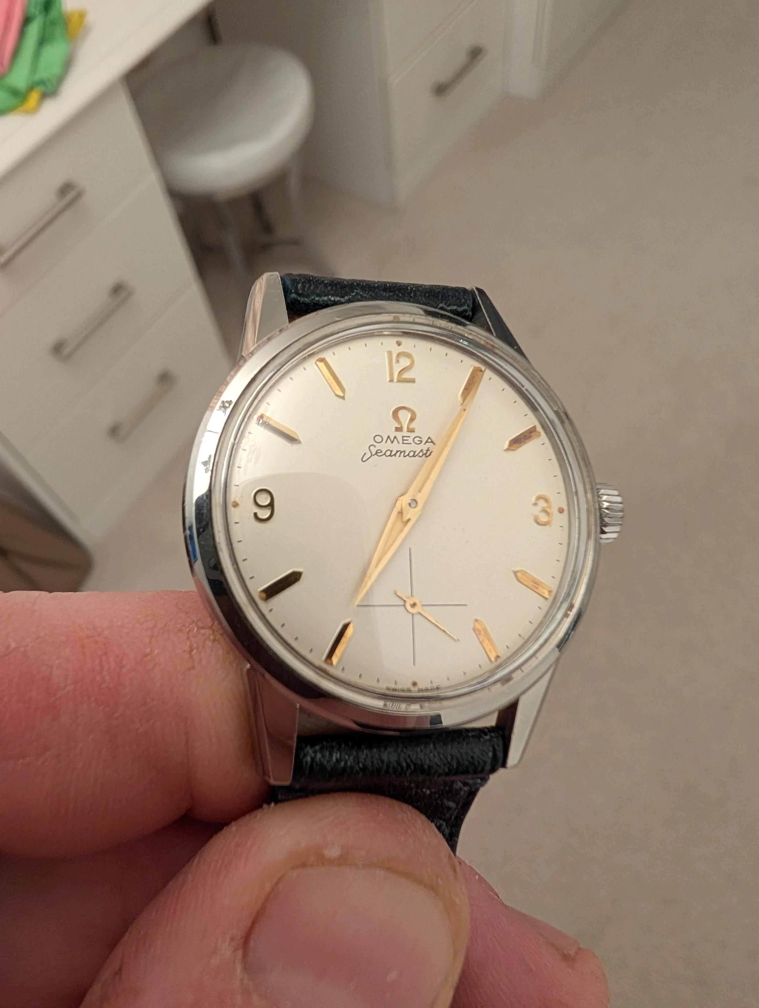

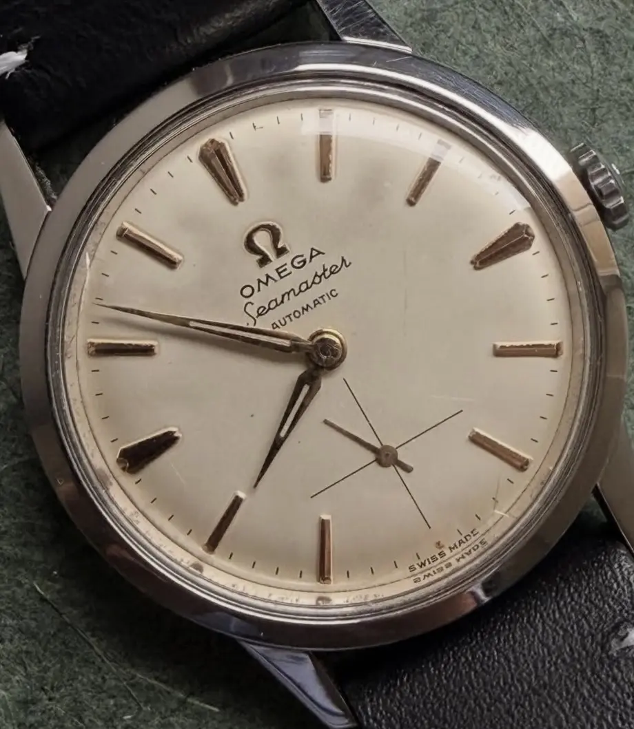

The seller states the reference is 14767-61. From my research, the 147xx references usually house center-second movements (like the Cal. 552 or 562). However, this watch clearly has a sub-second dial and a movement that looks like a Cal. 491 (or similar 49x family). Is there any historical precedent for a 14767 case housing a bumper/sub-second movement, or is this a definitive "marriage/frankenwatch"?
  1. Dial Originality: The dial looks remarkably clean for its age. The "Seamaster" font and the crosshair look crisp. Does this look like a high-quality redial to you?
  2. Case Condition: The lugs appear to have been polished, losing some of the sharp chamfers.
Unfortunately, I do not have a picture of the inside of the caseback or the movement serial number at this moment, only the photos attached.
I am looking for a nice vintage piece to wear, but I want to avoid buying a watch put together from parts.
Thank you very much for your help!

I don't how you carried out your research but doing an online search for Omega 14767 -61 I mostly see sub second models with 491 movements.
The hands have been relumed but otherwise but the dial itself looks original to me
Serial number 14 million is for mid 1950s so OK
The crystal might have to cracks but seems to be Omega signed
More feedback to come! 馃榾
Agree, the movement appears to be consistent with the reference.

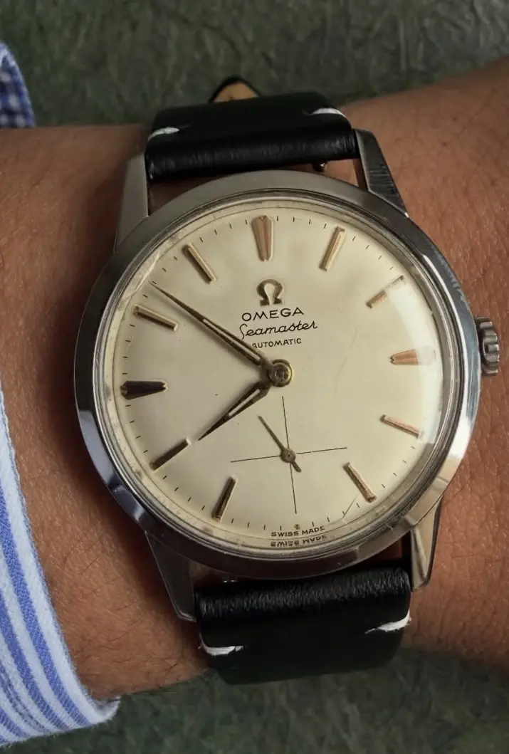

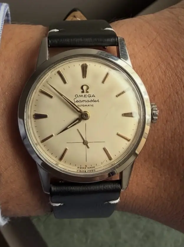

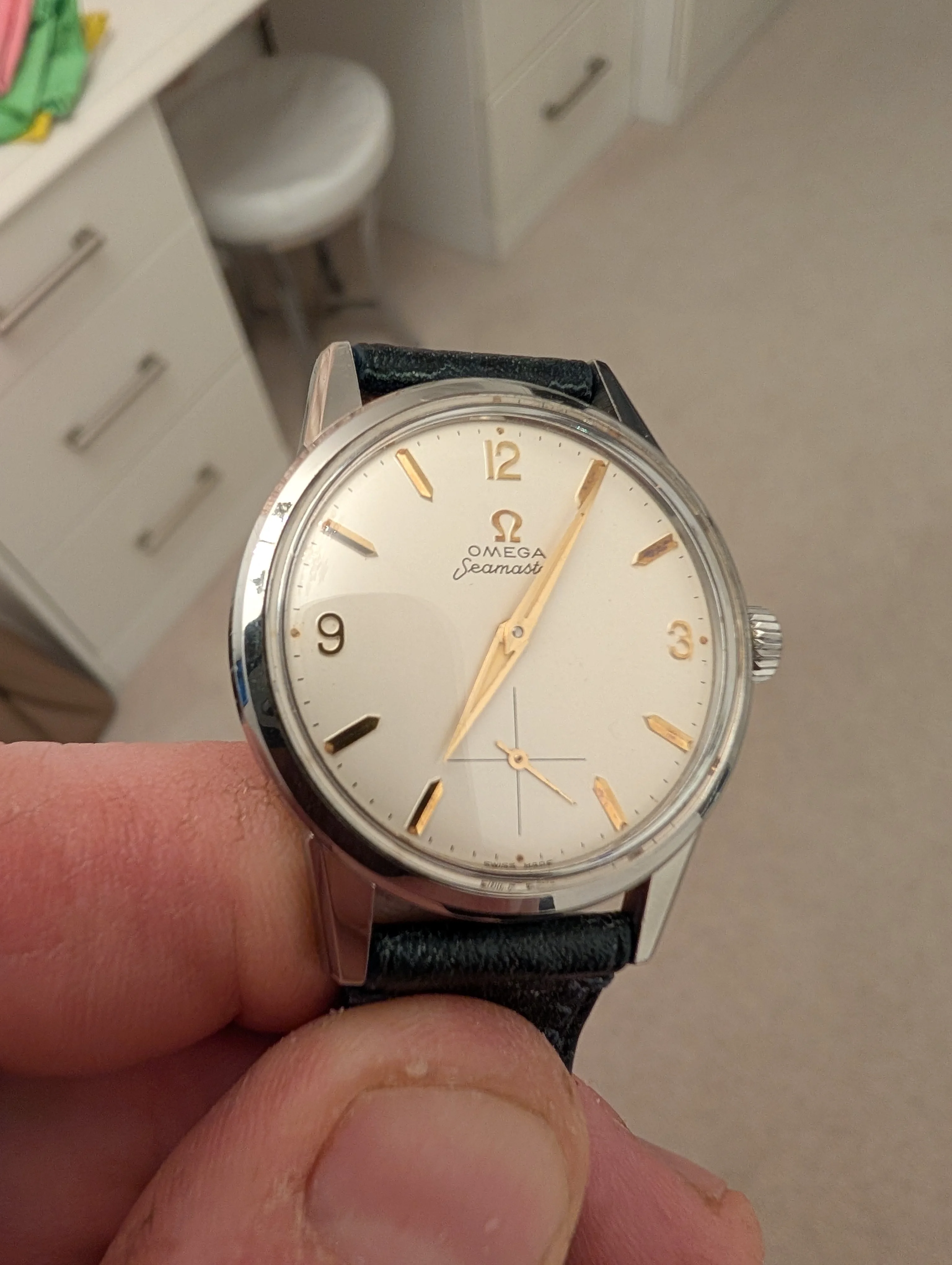

That's my omega same reference as yours same year also. mines got different hands to yours mine has got the omega symbol etched in the centre of plexiglass
