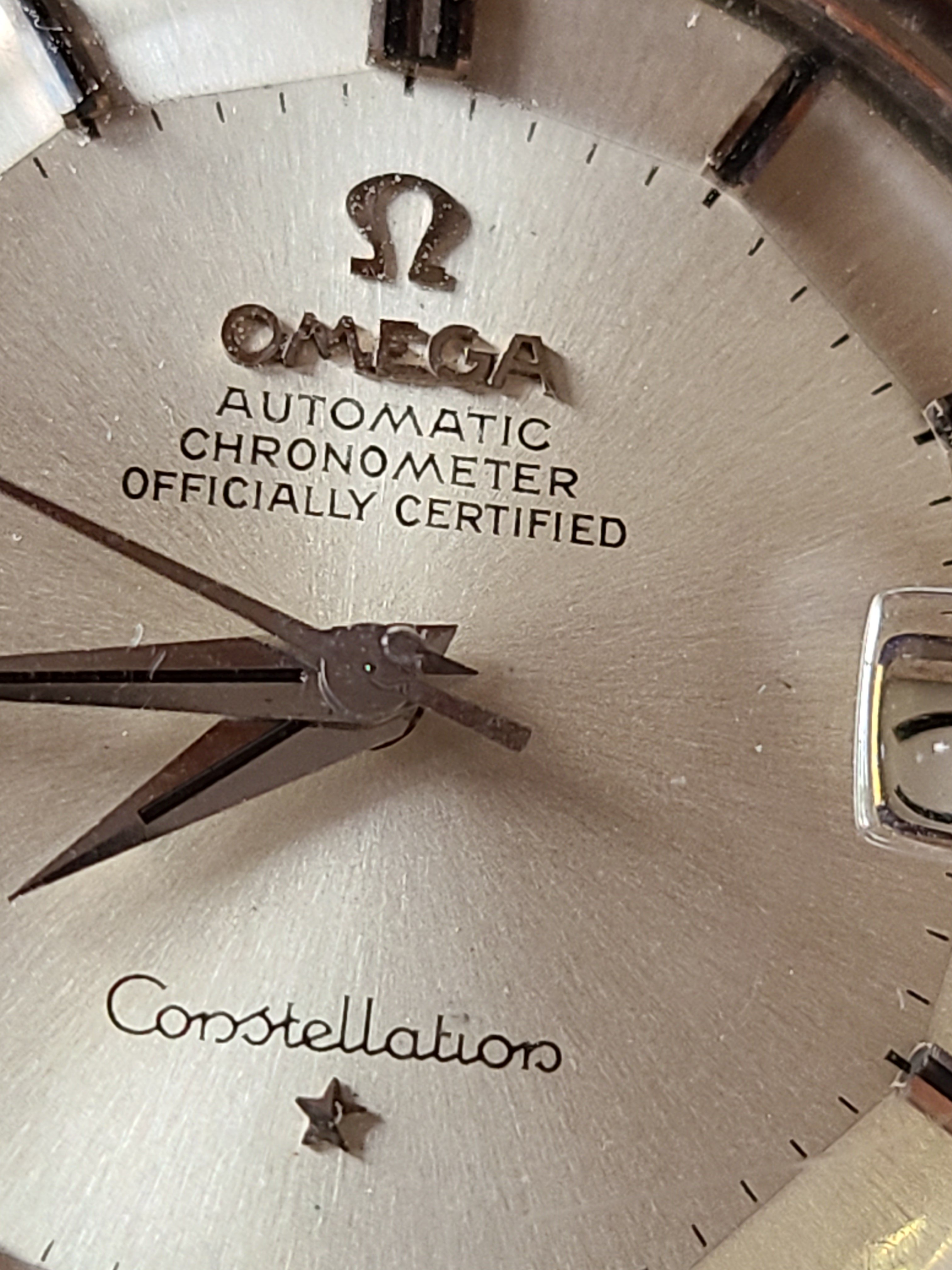

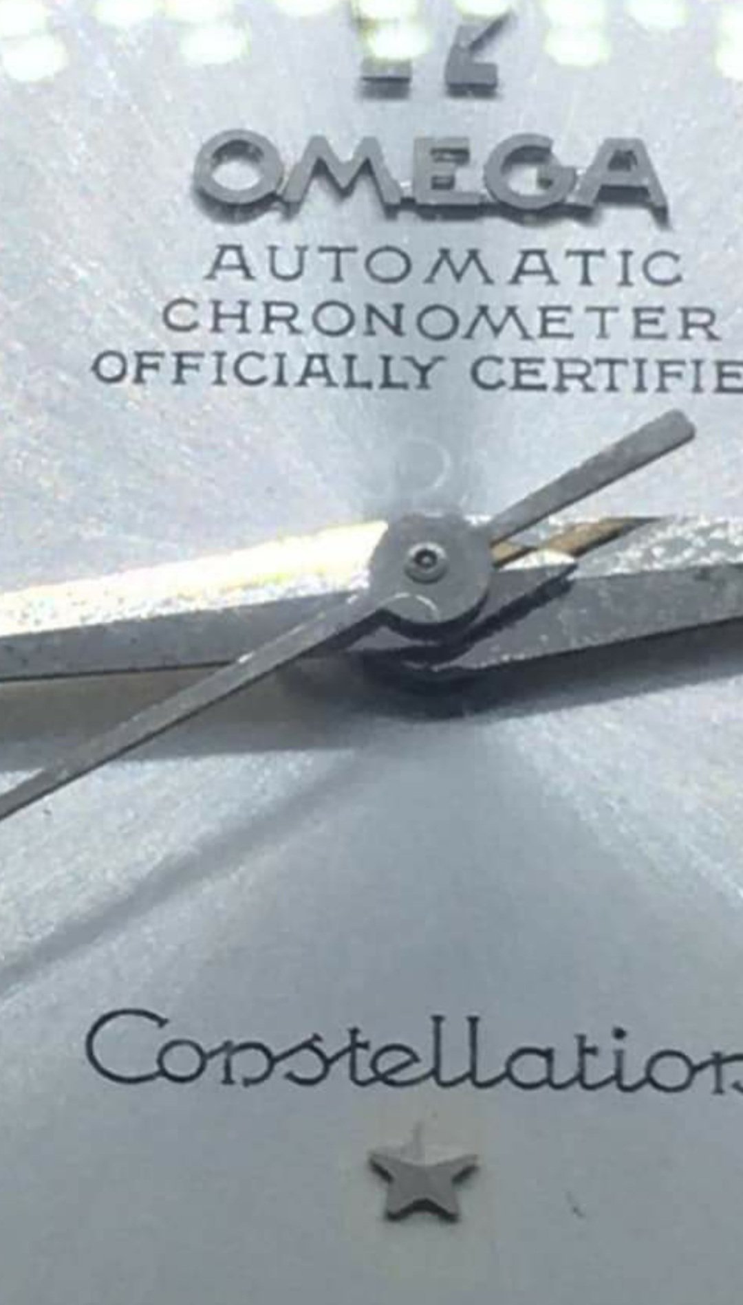

If you can tell the omega logos on these crystals which one is fake, which one is authentic, you are ok to go.
( I am not talking about the sec hands and the dials)
I had no idea that they faked the crystals.....I'll need to stay on the lookout for that. I can definitely see a big difference between those two photos that you included.

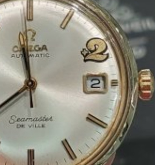

Sorry to divert this thread slightly but what is it with the 2 oc marker on the watch? Just noticed it and strange no one else has mentioned it
232
247
Glad you asked, I was wondering about it too😁
9,424
14,856
Yeah. I would say the lack of a crystal logo is the least of your originality worries there!
3,358
8,502
TV channel?
Probably belongs to the same group that has an air- freight business with a flying dog logo.
I can definitely see the difference. Buying a signed crystal on grey market sites is challenging as the title of the listing will say "signed Omega Crystal", but the photos they incorporate are useless as they are zoomed out pics most of them.
The watch was a gift to the OG owner for some award won. I believed he worked in a hospital/ Healthcare field but not too sure.
3,358
8,502
A well-known search engine find most results for +2 awards are Rotary Clubs. Seems to be a world-wide thing.
