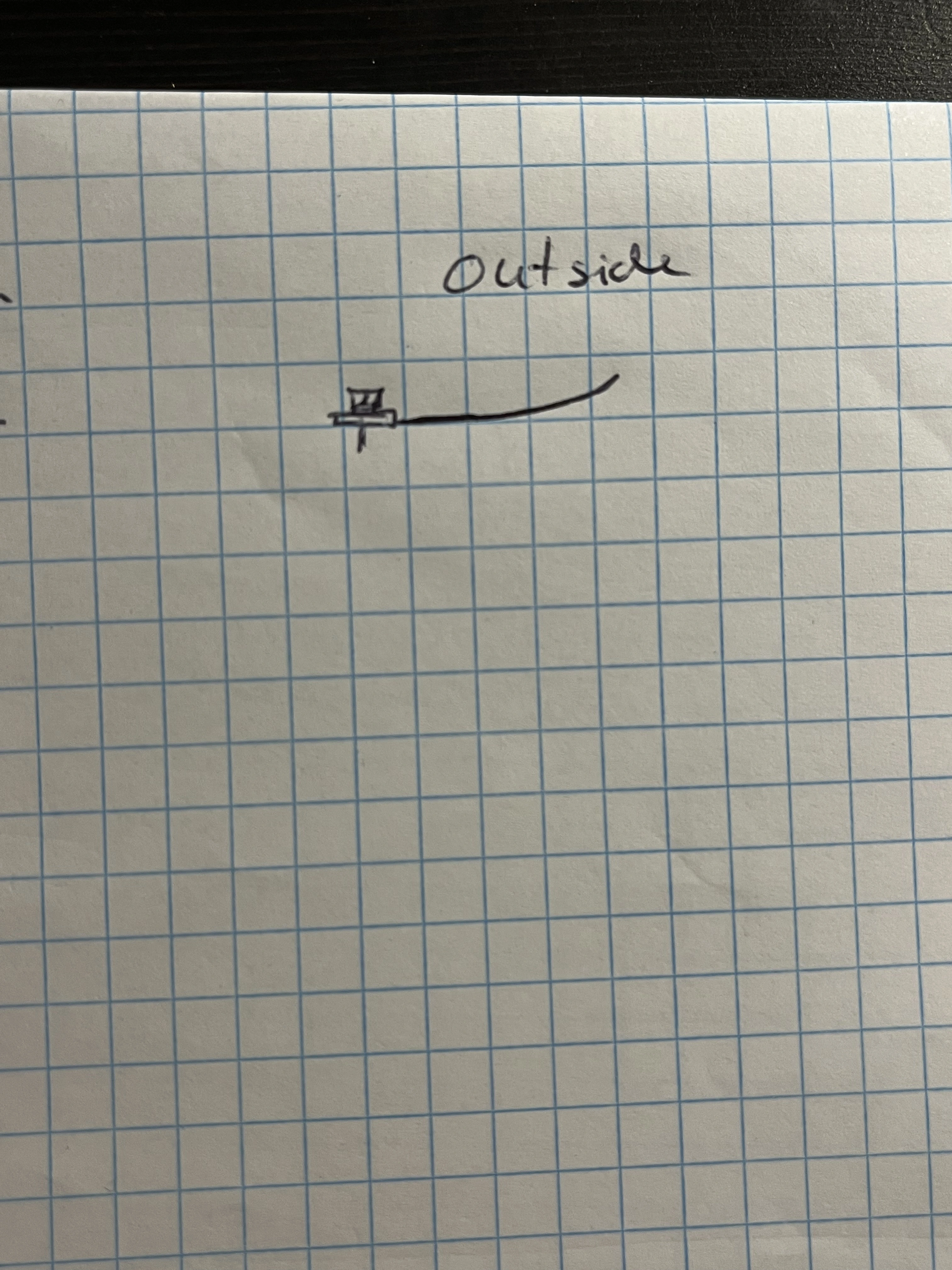

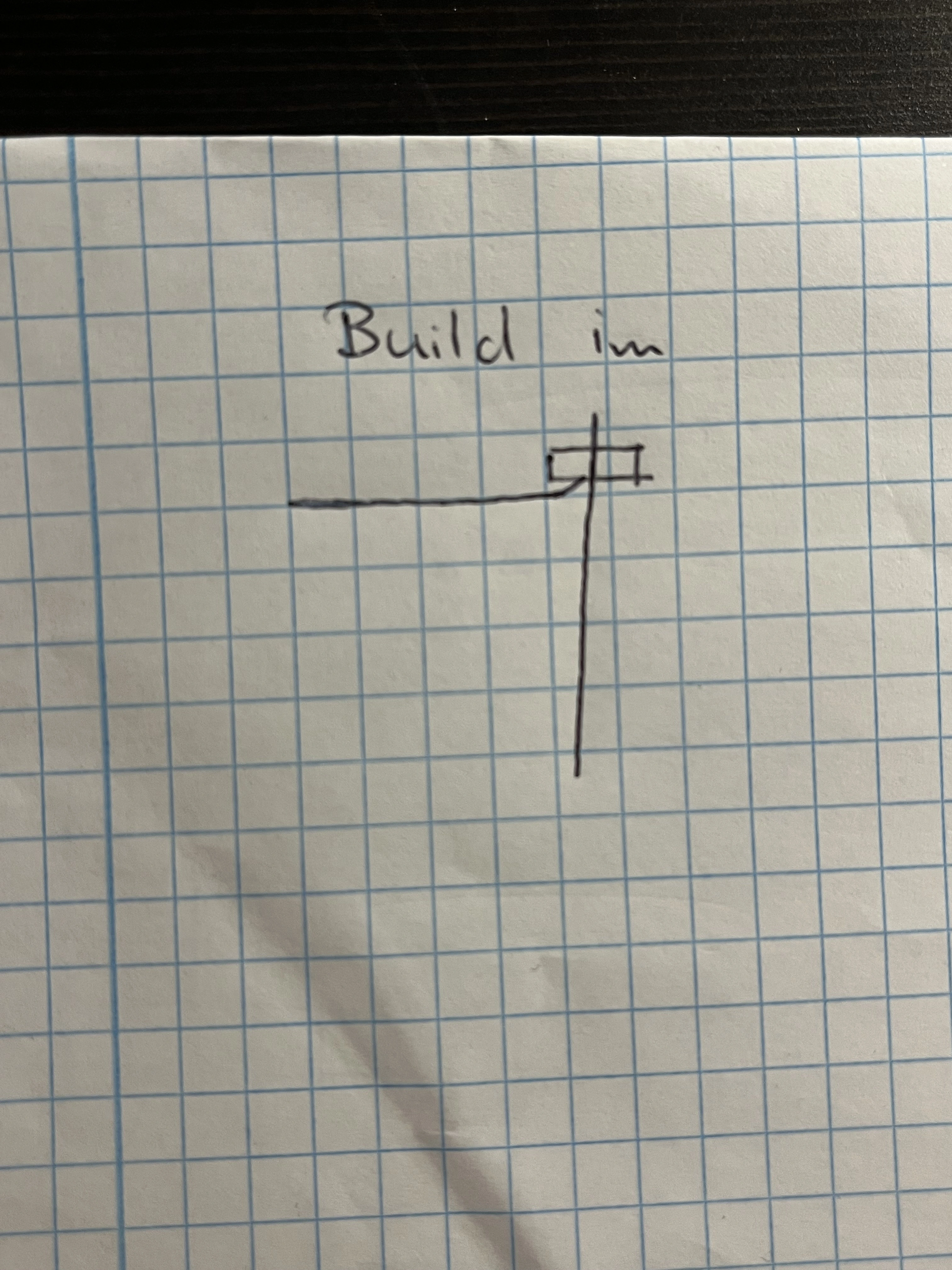

Hello, and thank you for the many replies.
I've just checked, and it seems that the spring is bent under the gear, pushing the entire seconds wheel and pinion upwards. (See the slightly exaggerated drawing below.) To be honest, I found it a bit strange that the spring was pushing from underneath, but it arrived like this without this problem (the owner never mentioned it and can't remember).
Now, in reply to the questions:
@Endshake: I didn't apply any oil between the spring and the gear.
@redpcar: I assembled it myself. I'm a watchmaker, but this is the first time I have serviced this calibre.
The question now is whether the spring should be under the gear, touching only the pinion, or whether it should be pressing from the top.
I will bend it flat so that it doesn't touch the gear, and I will report back.

It should sit flat against the bottom of the pinion, and push the pinion against the jewel. Just confirmed looking at a 613 I have with a screw off back 😀

Correct - it presses the pinion up into the jewel.

Hi everyone,
Good news! It’s fixed 😀😀
I also noticed that it works better when you put the spring on the left side of the pinion. This may be because the rotation is turning away from the spring rather than pushing into it.
Thank you so much for all your help!
