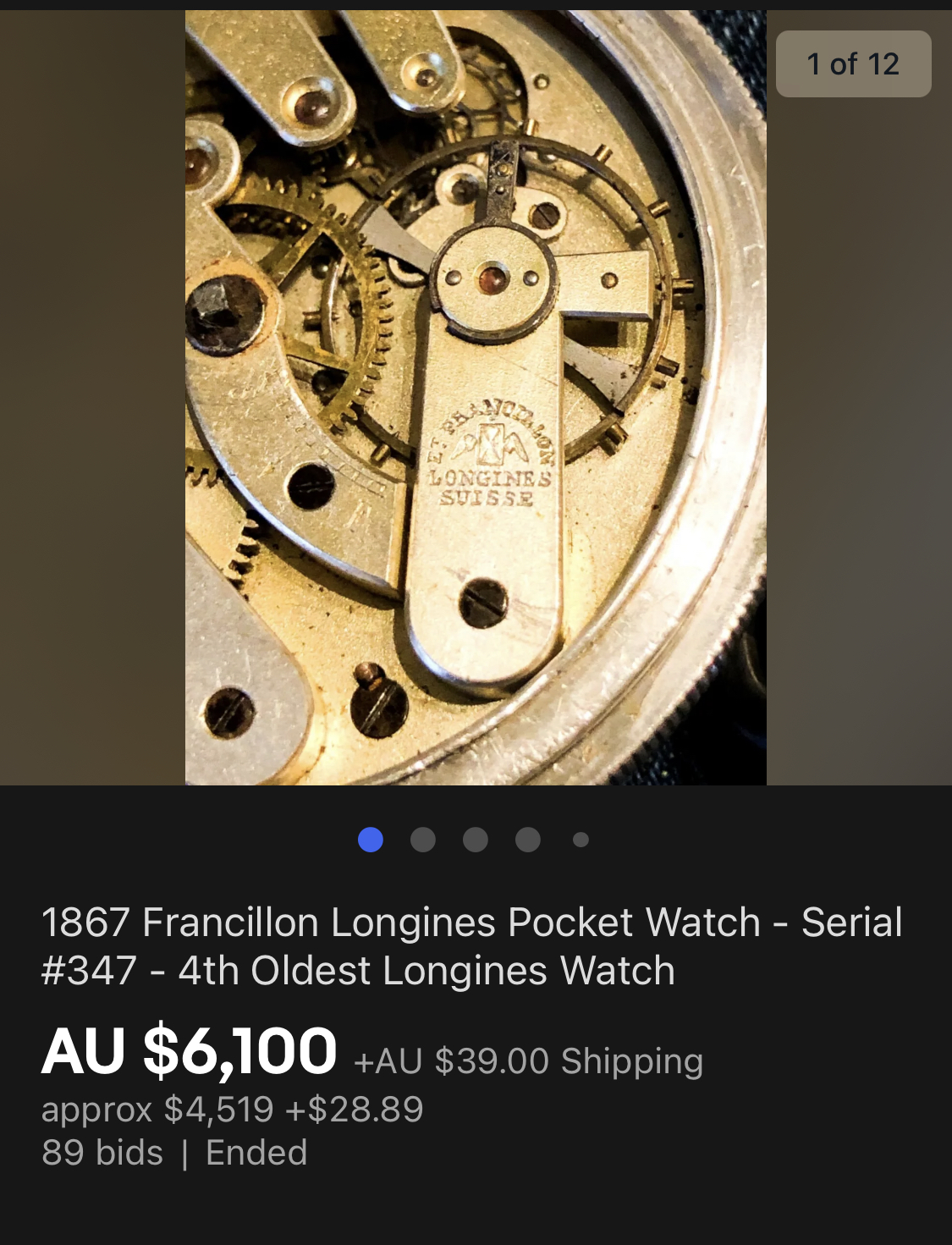

Thank you Seiiji for these wonderful pictures! In conclusion this means that the watch 347/3223 is for sure not the fourth odest in existance - as described in the Ebay auction? Case and movement dont match?

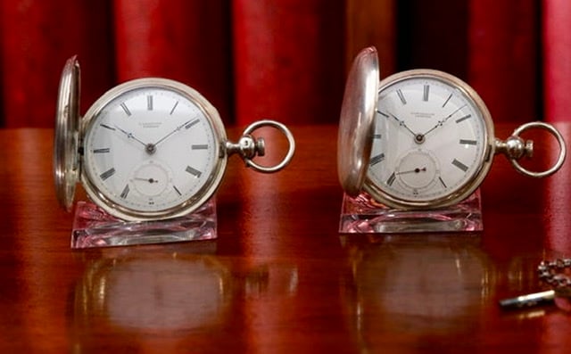

Very interesting read and cool that another AA4 has been found. Note that dials differ. Does the case look like yours Seiji?

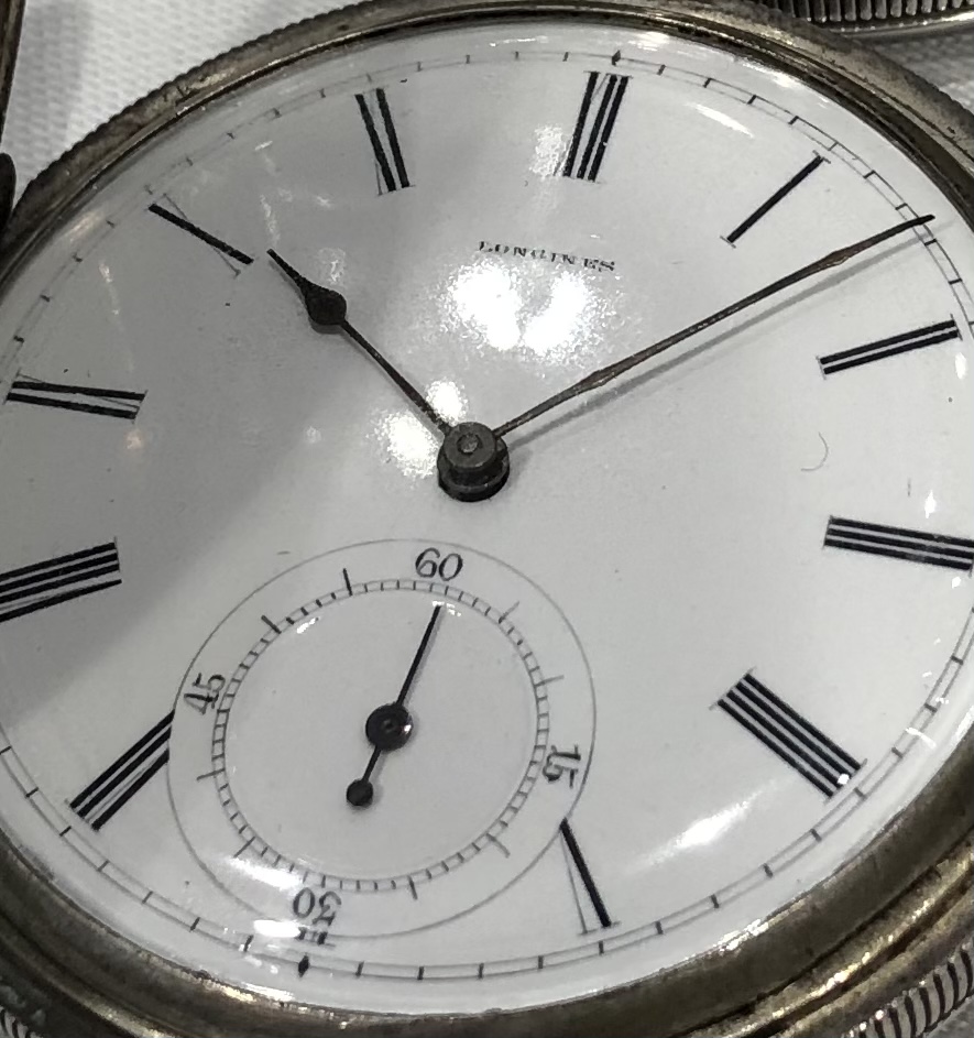

3166 Dial. Note, 3166 is all matching.

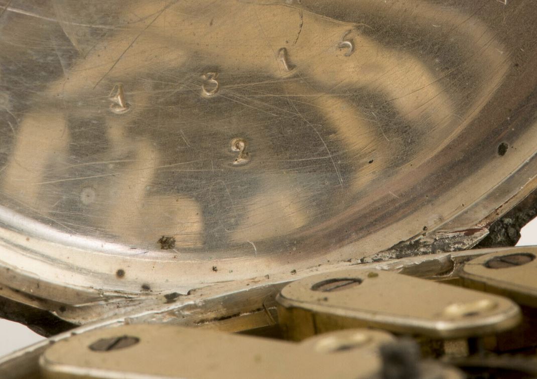

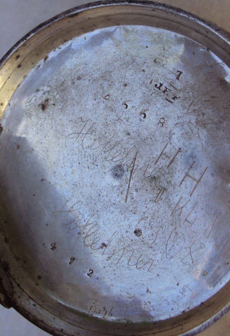

In addition to being marked "3166", the case of 3166 is also marked "1316" and "2" on the cuvette (see below). So some numbers match, and others do not. This is also the case for 4668 (see further below). In addition to being marked "4668", the case is also marked "412" and "7" on the back. Is it not possible that the "347" marking on the case of 3223 is equivalent to the "1316" and "412" markings on 3166 and 4668, respectively? This could explain the mismatch, though not the apparent omission of a "3223" marking somewhere on the case. However, accepting such an omission seems just about as reasonable as the explanation that the original case of 3223 was lost and a case from the same era was found to replace it.

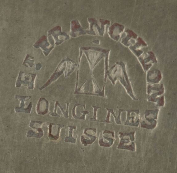

3166 and 3223 share same movement number and logo positions on bridge. The movement is many years newer than the case.
If the movement of 3223 is many years newer than the case, then is it not surprising how similar the markings on the cuvette are to the apparently original case of 3166 (see my previous post)?
Another question I have is about the absence of a winged-hourglass logo (see example below) on the case of 3223. I know that 183, 300, 335, and 3166 all have this marking on their cases, whereas 3223, 4668, and later examples that I have seen do not.

"DirtyDozen12, post: 1819837, member: 11789"]In addition to being marked "3166", the case of 3166 is also marked "1316" and "2" on the cuvette (see below). So some numbers match, and others do not."
Longines serial #4668 is not an AA4 Longines movement or AA4 watch. No pictures of the movement is provided to show what type of movement it is. No dial or full case is provided.
Hello DD12, you do not have the knowledge of how these AA4 were marked. This is the correct way for all AA4 to be marked.
Firstly, you have misunderstood what I wrote if you think I implied that the markings on 3166 are incorrect. I merely stated that not all of the numbers that appear on the case of 3166 are "3166", there are other numbers too.
Secondly, based on a sample size of fewer than 10 examples, you are claiming that you know how "all" AA4 cases are marked?

Sorry about misreading your post. Limitations of not having an interactive conversation. I am not claiming I know anything. But I suggest you look at other Longines hunter cased pocket watches of the era. There is no special rules for only AA4 about how they marked the hunter cases. There is a scheme used so they know if any of the parts are replaced on the hunter case. With the exception of the rare typos, the rules are usually consistent with hunter watches of different calibers of the era that look entirely original.

Last year I spent some time researching early Longines pocket watches and it is clear that cases were being supplied by multiple makers. Generally speaking, the numerical markings across different makers had similar conventions but there is variation. The fact that the case of 3223 does not have a "3223" marking anywhere is certainly atypical. However, barring this omission, I think that it is reasonable to believe that the case could be original to the movement and dial for three reasons: (1) its resemblance (notably the cuvette) to the case of 3166, (2) the very good condition of the dial (which would be somewhat surprising if it had been orphaned), and (3) the low likelihood of finding such a case as a replacement.

If you believe the case is original, then the current eBay price could be 1/10th the price of it's true value. Longines bought the parts for 561. Not even a complete watch for more than $5000. Bernard had to make some of the parts. 3223 is a complete watch that needs a hair spring, balance shaft, and overhaul.
10
5
It is always hard to value these very early watches so that sort of insight on 561 is helpful. I was watching the listing with the believe that it may be solid value if it remained under 5k.

It reached a fair price from what I know of these watches and private trades and offers.
looks as though the buyer didn’t pay and he/she has relisted it. Seems to be a lot of that on eBay these days. Gives me a second chance anyway!
