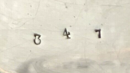

I see that 347 has been found. Seller on online auction has listed it. Also appears to be an AA4 Francillon like yours
16
17

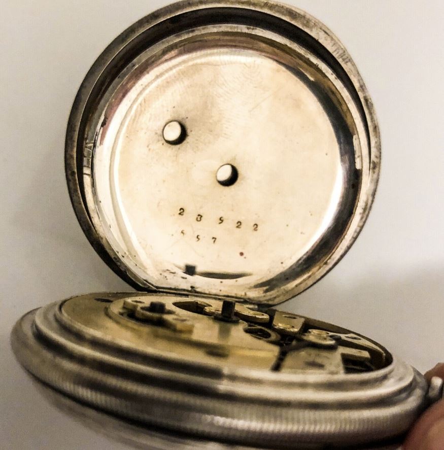

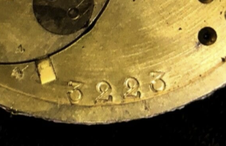

I m wondering that case number (347) and movement number (3223) are different on this one as shown on the pictures in the description. Is it possible that movement and case do not belong together? All other early watches seem to have idebtical numbers?
2,804
4,886
I had the same questions and asked the seller if he had received an extract from Longines' archive, unfortunately not.

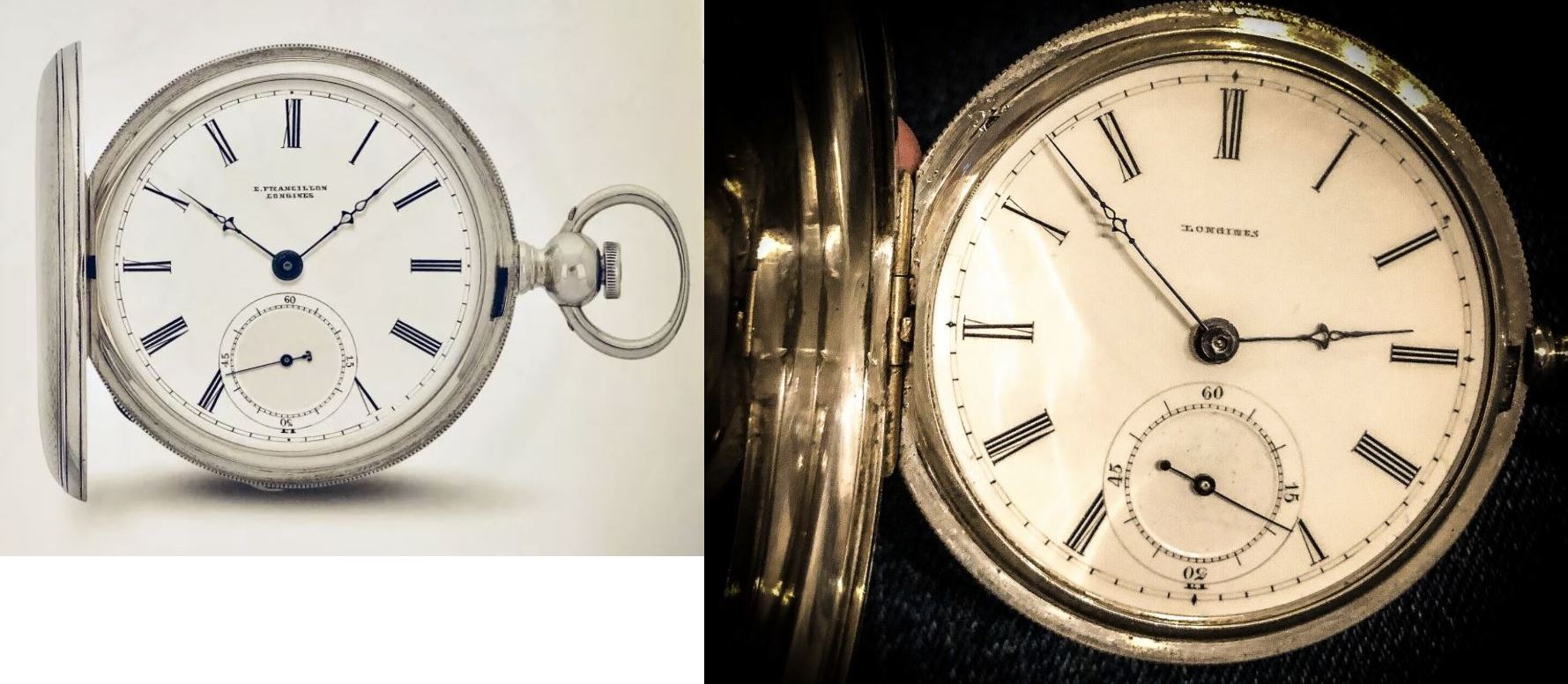

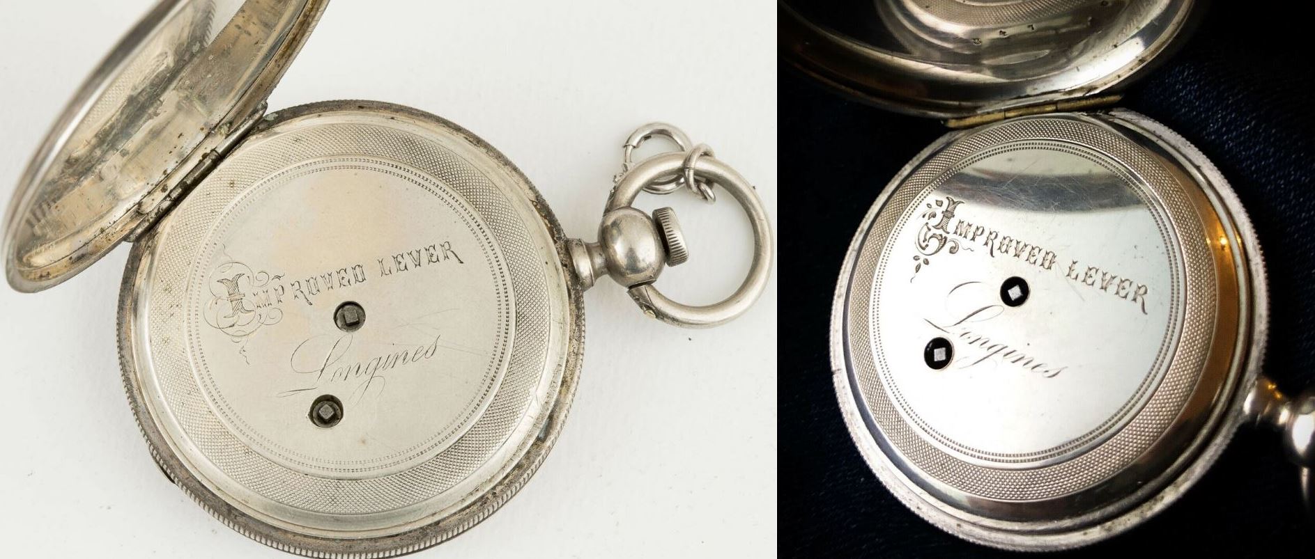

According to the style, the case is not obviously incorrect. Below is the cuvette of another AA4 (left) beside the cuvette of the watch in question (right).
Furthermore, the condition of the movement, dial, and hands does not seem to suggest a difficult life in which they were without a case for some period of time. Apart from a missing regulator arm, the movement looks to be in good condition. The dial might have a few hairlines but the edge is in very good condition. At least the hour and minute hands seem to be stylistically correct. Below is another AA4 (left) beside the watch in question (right).
I do not know why the mismatched case and movement numbers but I am inclined to believe that the serial number is 3223, as seen on the dial side of the movement. Below are photos of another early Longines with multiple numbers on the case. The number that turned out to be the serial number (as per Longines' archive) was the one that matched the number on the dial side of the movement. In other words, I believe that the number on the dial side of the movement should take precedence over any case numbers and be taken as the serial number of the watch.
2,804
4,886
P.S. I only referred to one instance of this but there are countless more.

3166 and 3223 share same movement number and logo positions on bridge. The movement is many years newer than the case.
