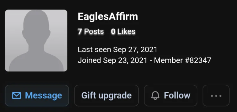

Don't expect an answer, he only managed to visit the first 4 days from signing up;
Thanks for the reply! Figured it was a long shot!
