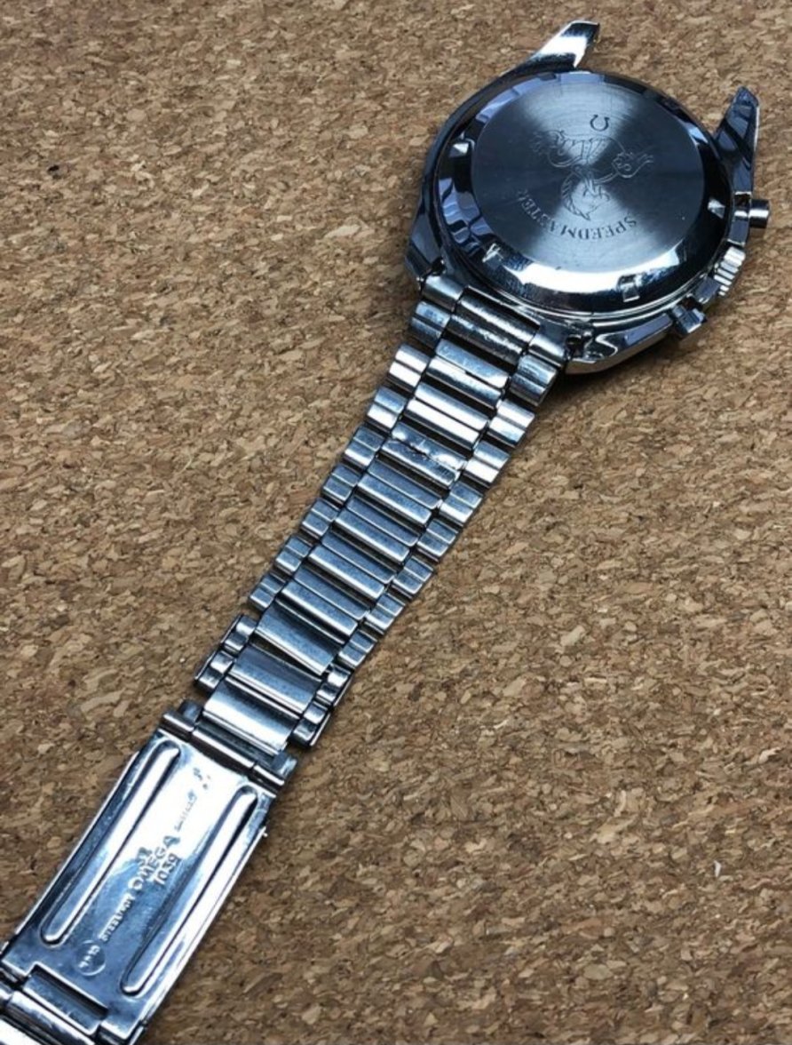

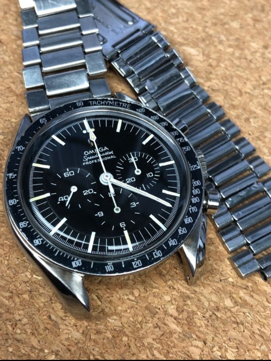

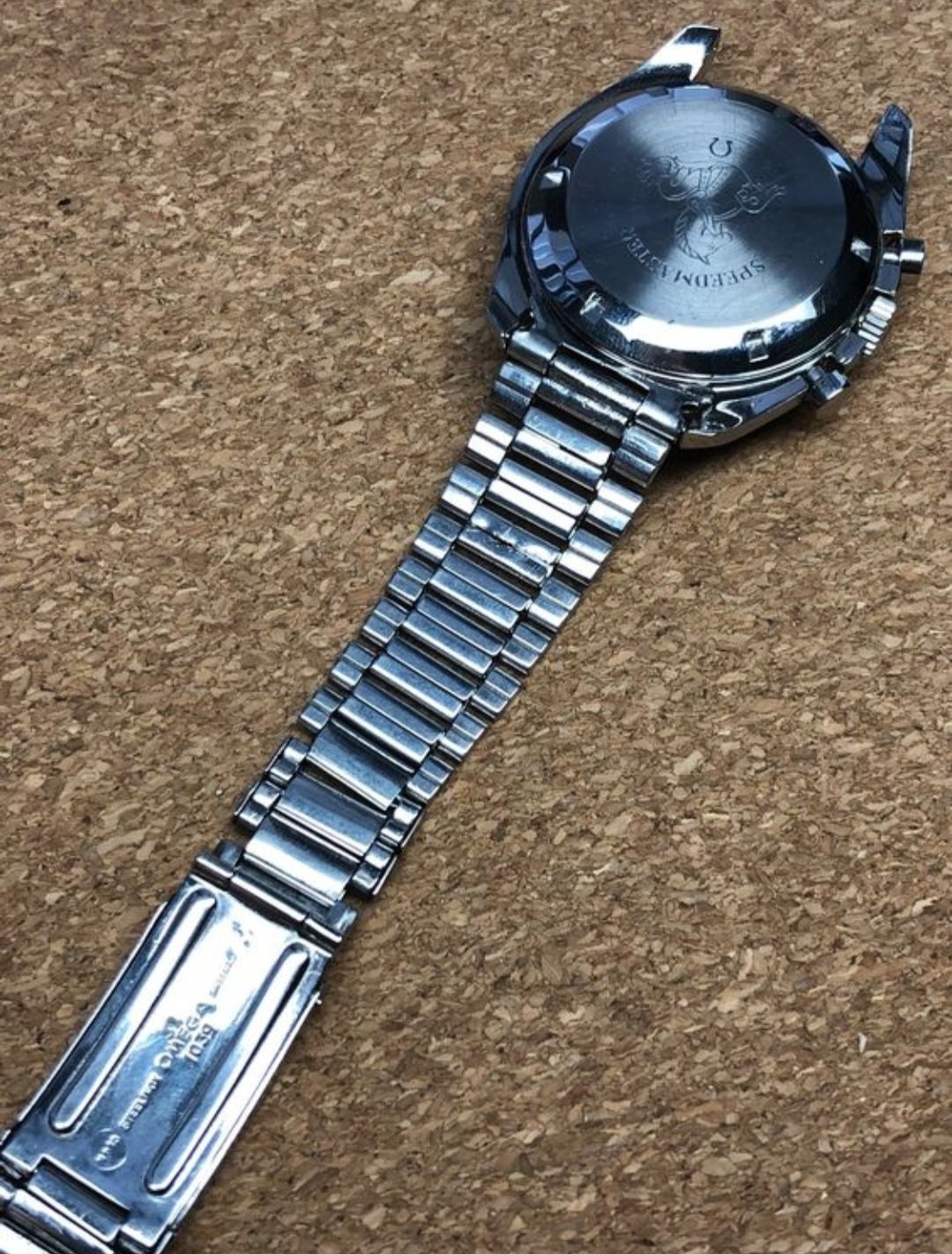

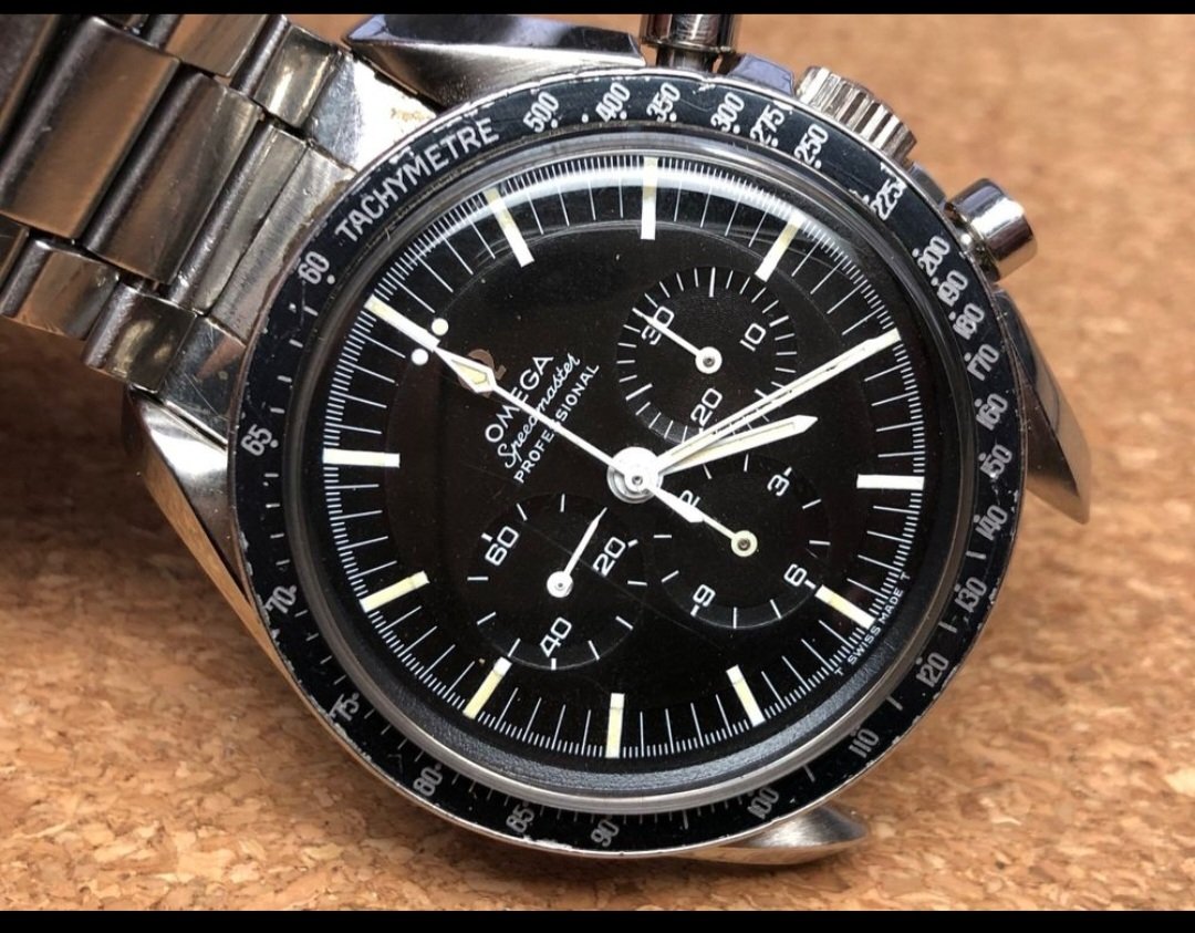

Don't buy an extract.
Probably a good advice. Wouldn't help much anyways. What is your theory? The seller seems like a nice guy. He told me he bought the watch from a private person.
What are the experts views on the case?

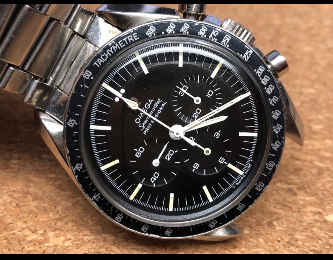

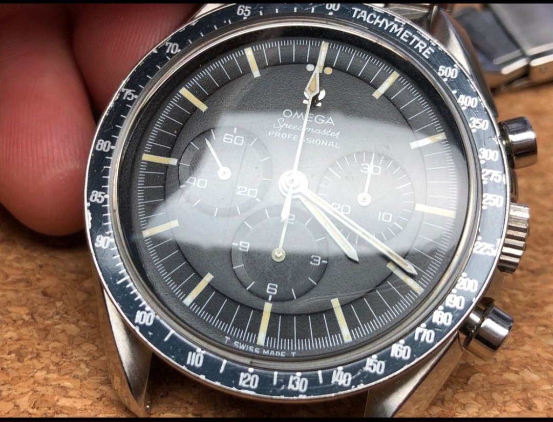

The things I noticed is that it has short pushers were the tubes probably have been replaced (not fat anymore). The wide spaced T dial could be correct for a late -65.
Overall the case and the case back look like they haven't seen much polishing.
Hands are correct for the period but losing some of the lume (maybe I should get them stabilized or relumed).
24,837
55,260
My theory is that someone assembled the watch out of parts, which isn't uncommon. If you have the watch serviced, there's certainly no harm in stabilizing the hands from the back side. Looking at the photos, I also noticed quite a lot of lume loss on the dial markers. So overall, I think this is best viewed as a nice watch to wear, and not a watch to restore or over-analyze.

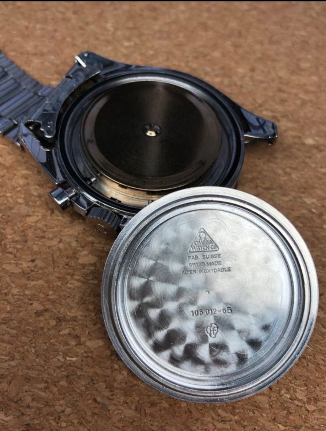

Wide spaced T dial isn’t correct for any -65.
I think this is likely a 145.012-67, with a replaced caseback and bezel. The mid case, dial and movement all align with a -67.
The bracelet seems slightly early but could be correct.
Of course it could also be a complete amalgamation of parts.

Roger that. What you have there is a -67 or -68 as confirmed by the serial with an incorrect swapped caseback. As you say the better of the scenarios. The dial lume colour and loss is typical of a 145.012 vs the earlier 105.

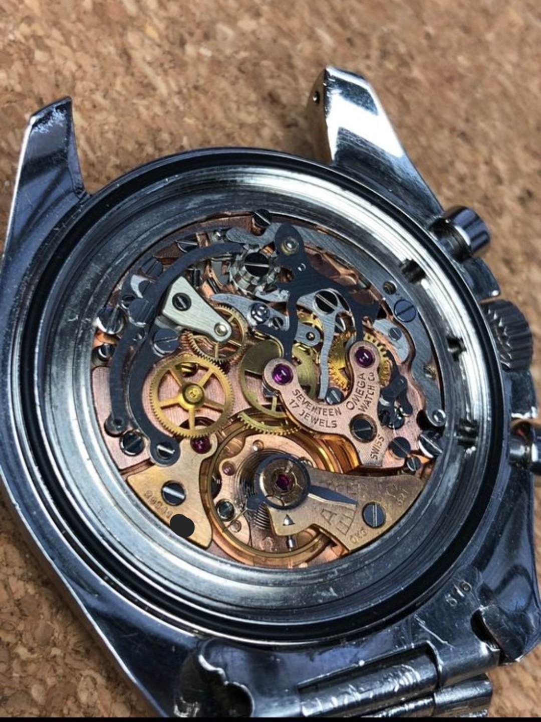

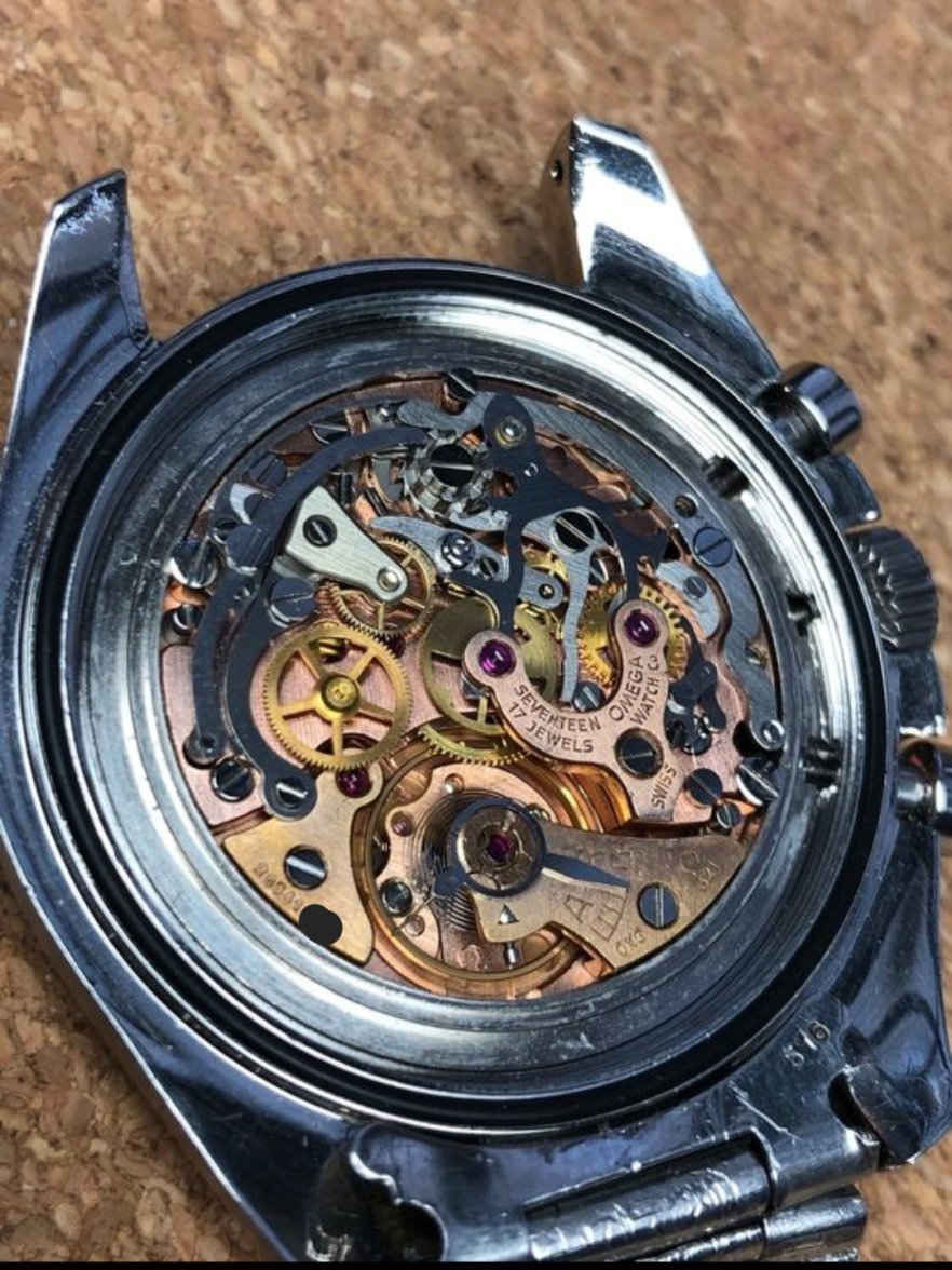

Just a heads-up, the balance cock and escape wheel cock are unlikely to be original to the movement, given the color difference between them and the 3/4 plate. Also, the OXG on the balance cock is an American import code for Omega, and I've always seen it paid with a mention of adjustment/unadjustment on the escape wheel cock. It's likely that those two parts were not from the same watch, and in my opinion, there's no telling without an extract whether the serial is even for a Speedmaster should the above be true.
I'm not sure whether the midcase is for a 145.012. It seems to have been fitted with the thin-stem service pushers meant to be used as replacements for earlier 105.012 friction-fit pushers.
Regardless, it's still a fun watch, and I'd certainly enjoy wearing it as a daily if I were in your position.
