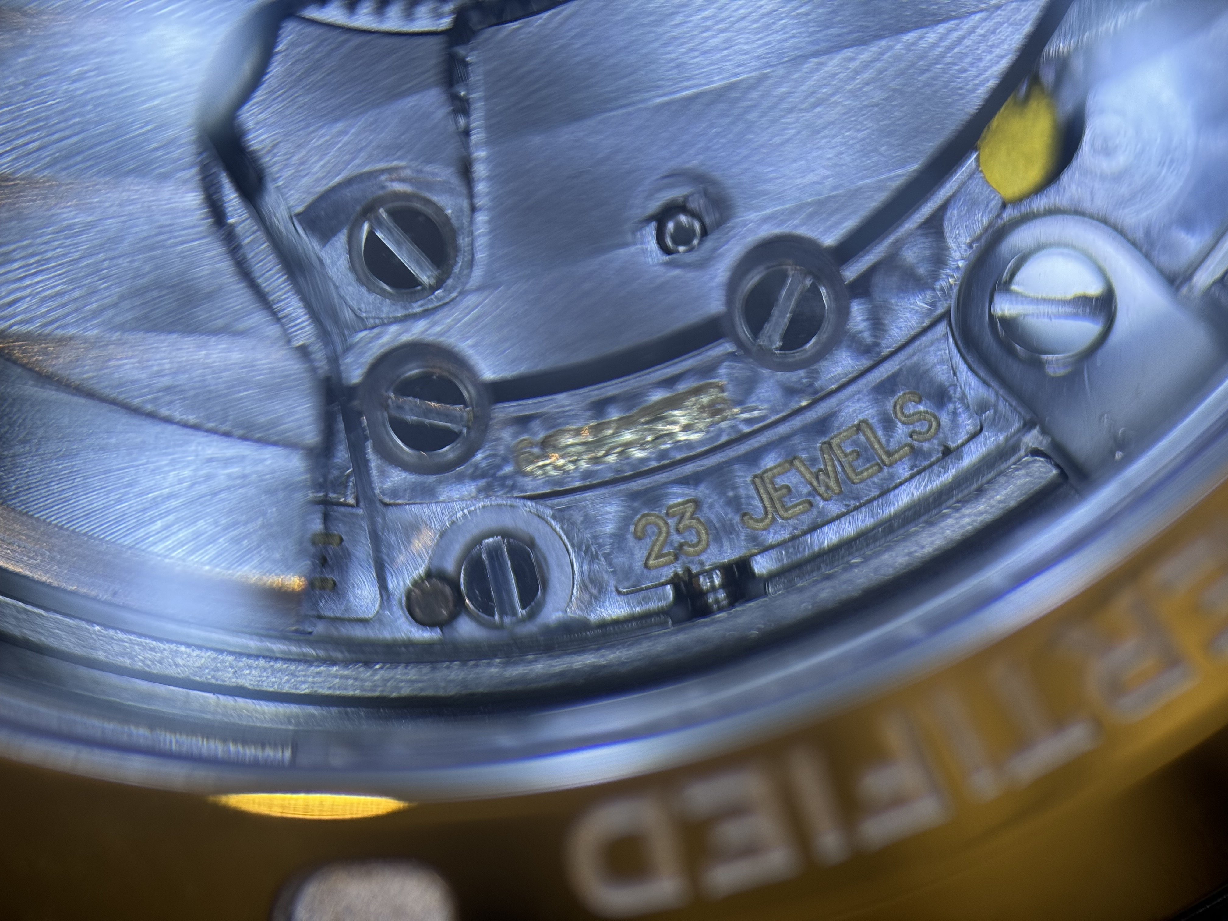

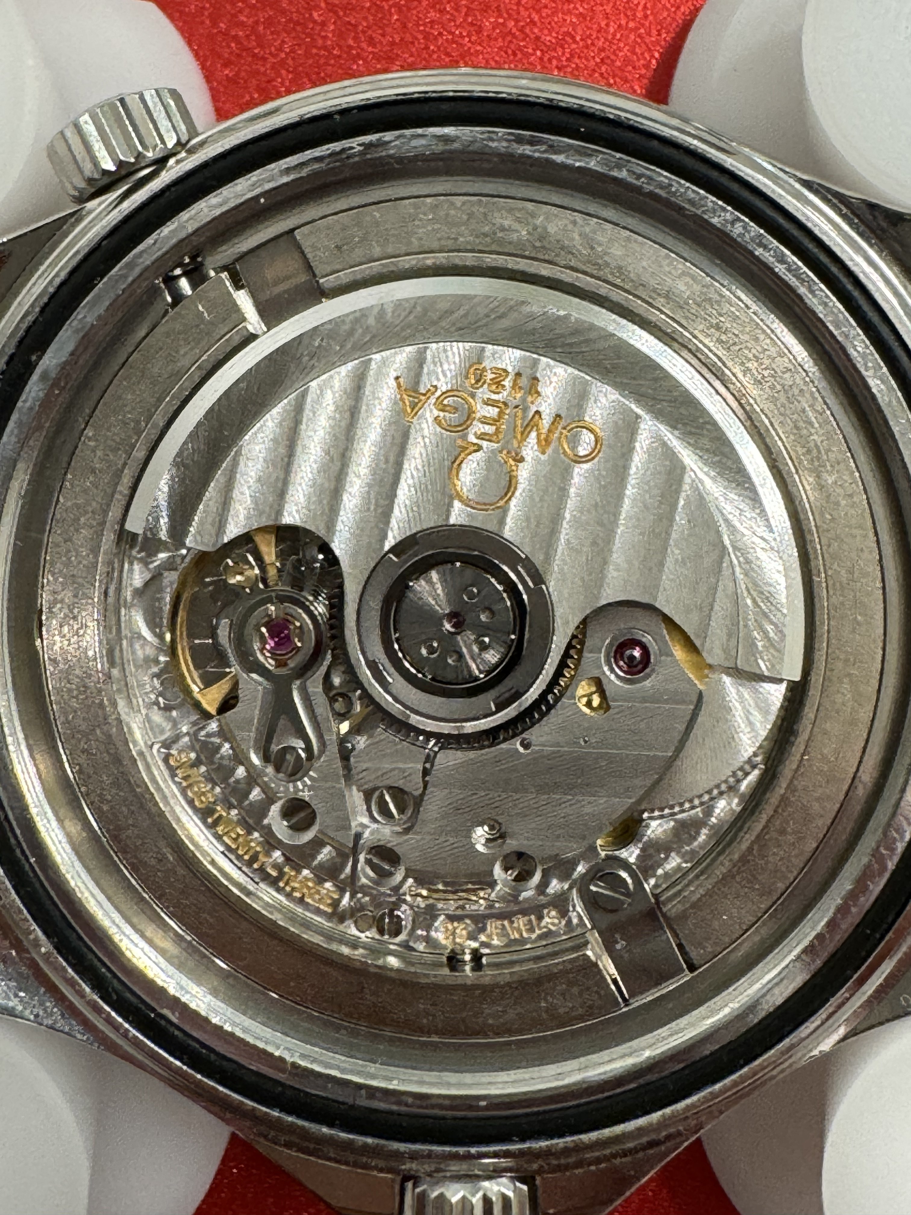

Hi OF, I purchased a Seamaster Diver 300M (2531.80) a little over a month ago from a dealer on Chrono24, and all had been ok, but I finally opened up the caseback the other day and noticed that the serial number appears to have been scratched off of the movement?! (Caliber 1120).
The watch was described as having just been fully serviced and running perfectly with "all original parts", and since it's not exactly a reference known to have movement swapping issues (to my knowledge), I guess I overlooked asking for a movement photo.
So my question is, why would the serial have been scratched off? Could it have been to hide the fact that the movement was swapped, perhaps not even from the same reference? And do you think it is cause for concern? And/or cause to complain to the seller? Thanks in advance.

Not uncommon on gray market watches.
Ah so are you saying that perhaps the movement is still original but the serial was scratched when it was first sold as gray?
13,494
31,815
That would be my educated guess.
18,843
39,190
Probably done by the original vendor who received the watch from the manufacturer/distributor.
When they want to flog it to grey dealers they remove the serial so it cant be traced back to them.
Manufacturers aren't big fans of the grey market.

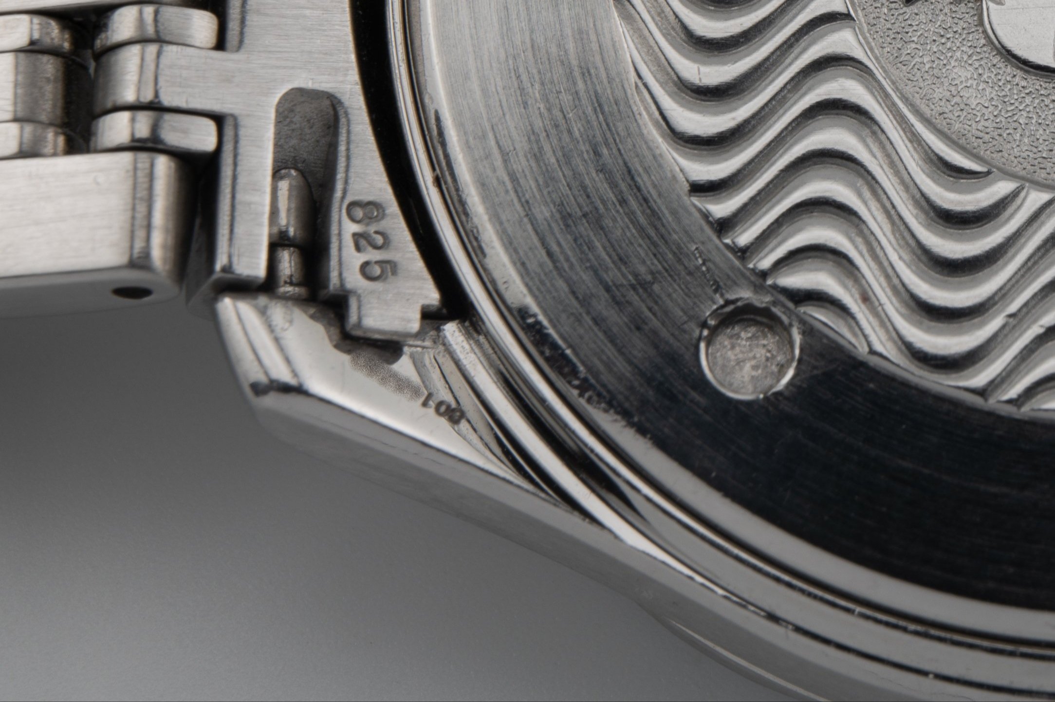

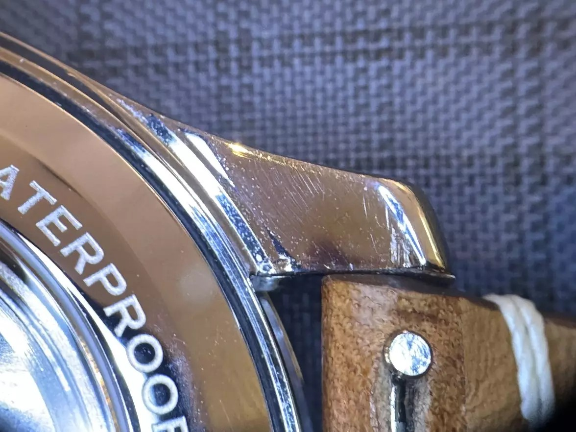

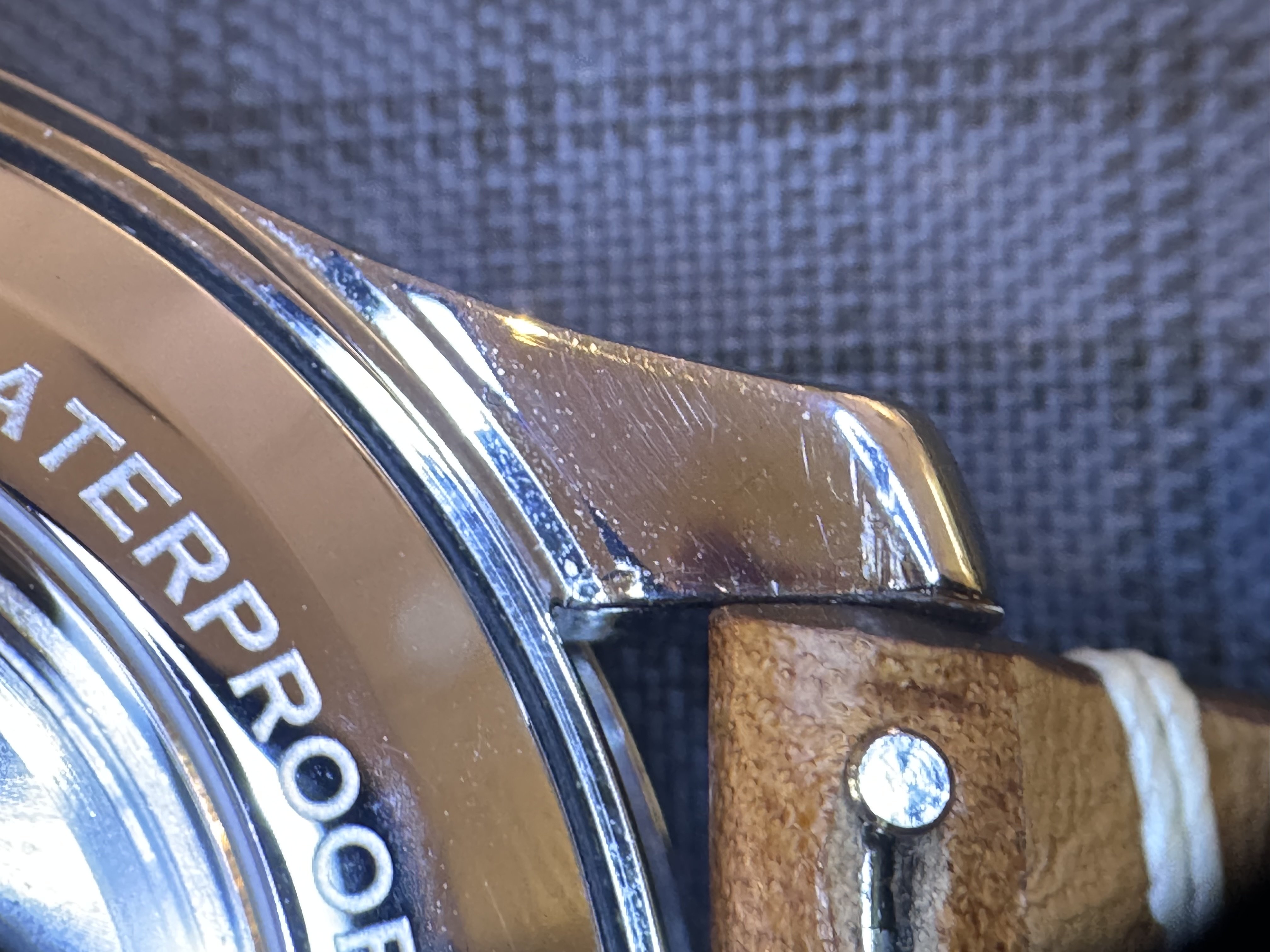

Is there still a serial visible on the rear of the lug? If so then I would suspect a movement swap since it would make no sense to remove it from one place only, if not and both are absent then it's more likely a grey sale, yes.

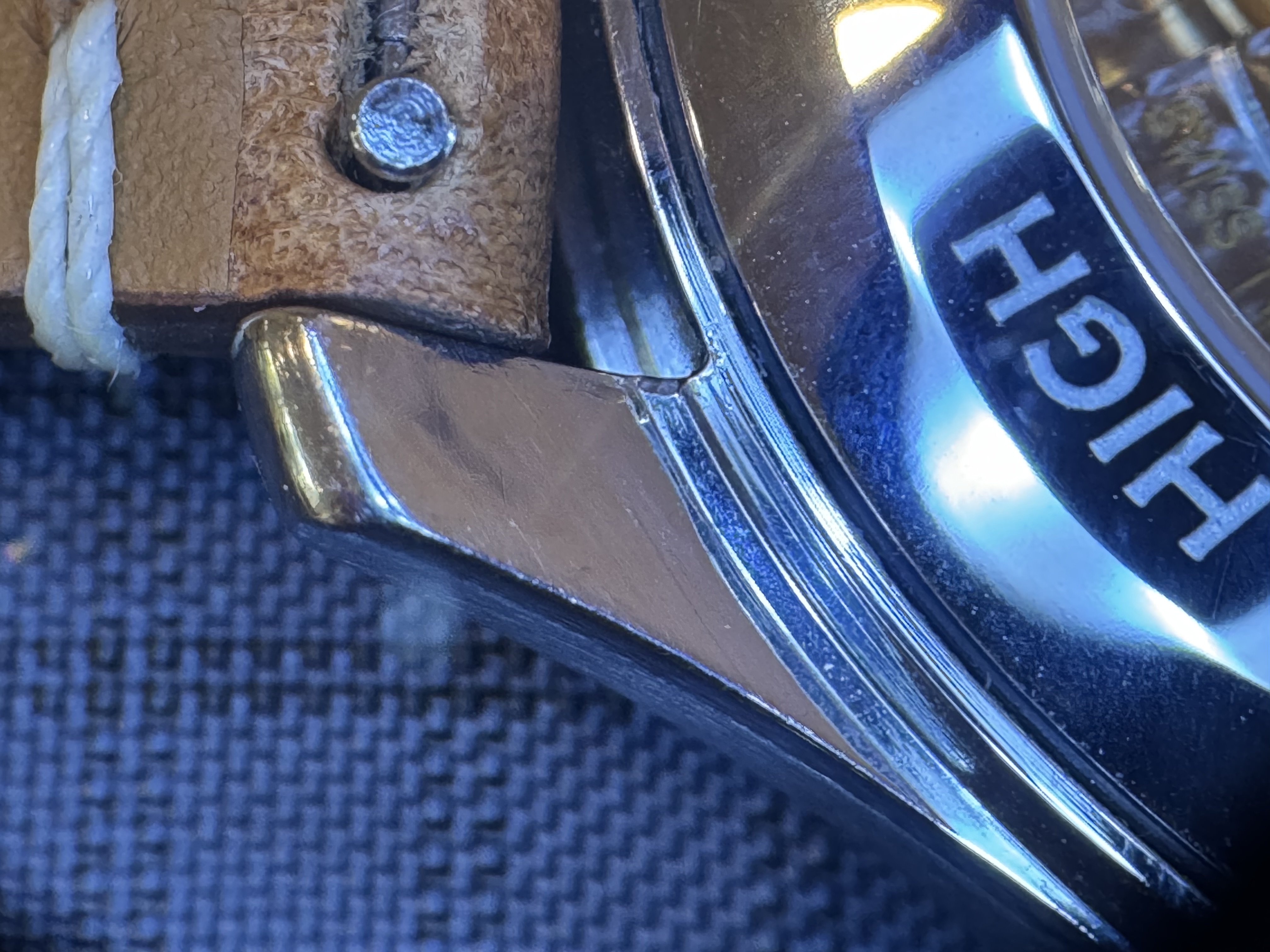

I don't see any serial on any lug rear, are you sure that's expected for this reference?

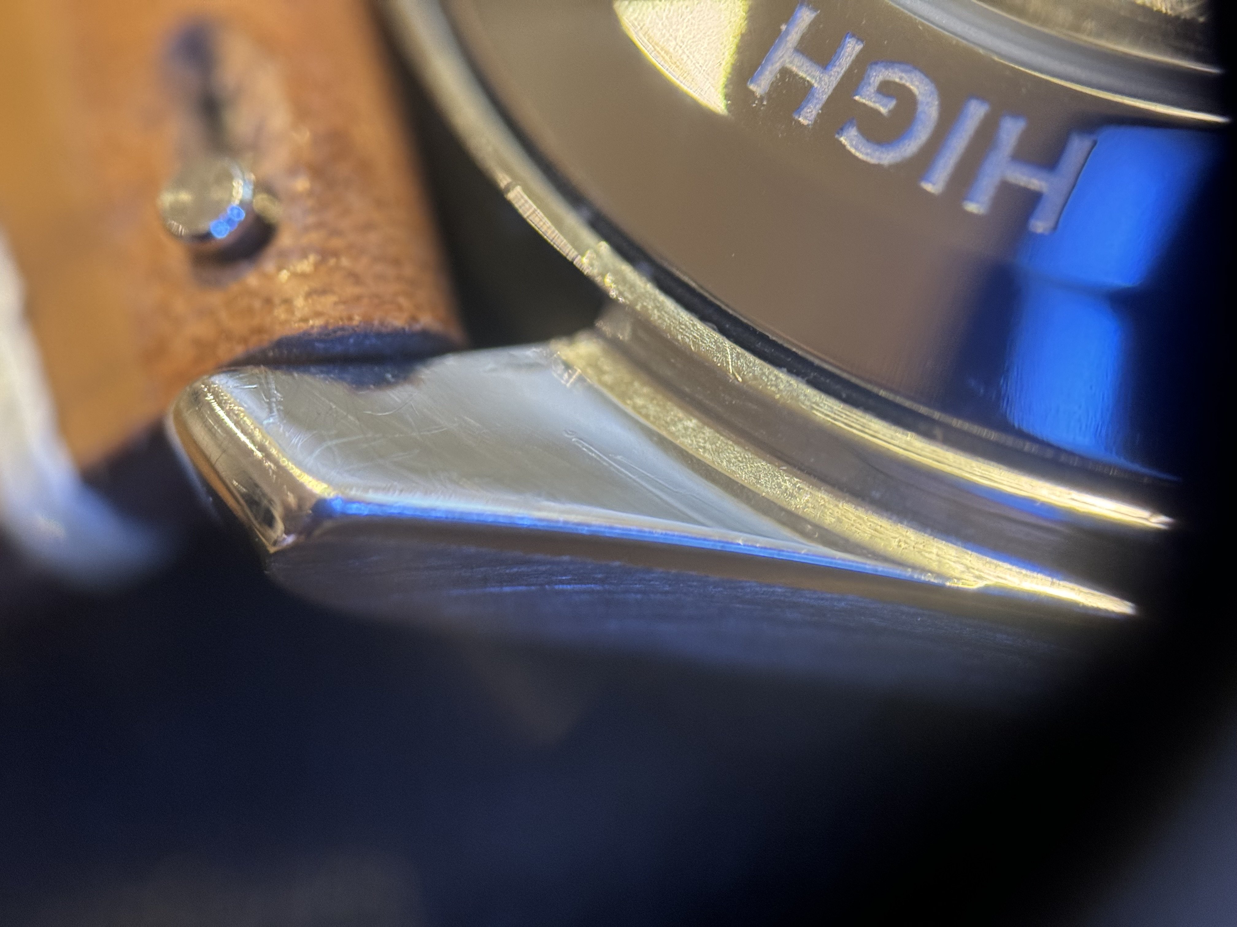

720
2,109

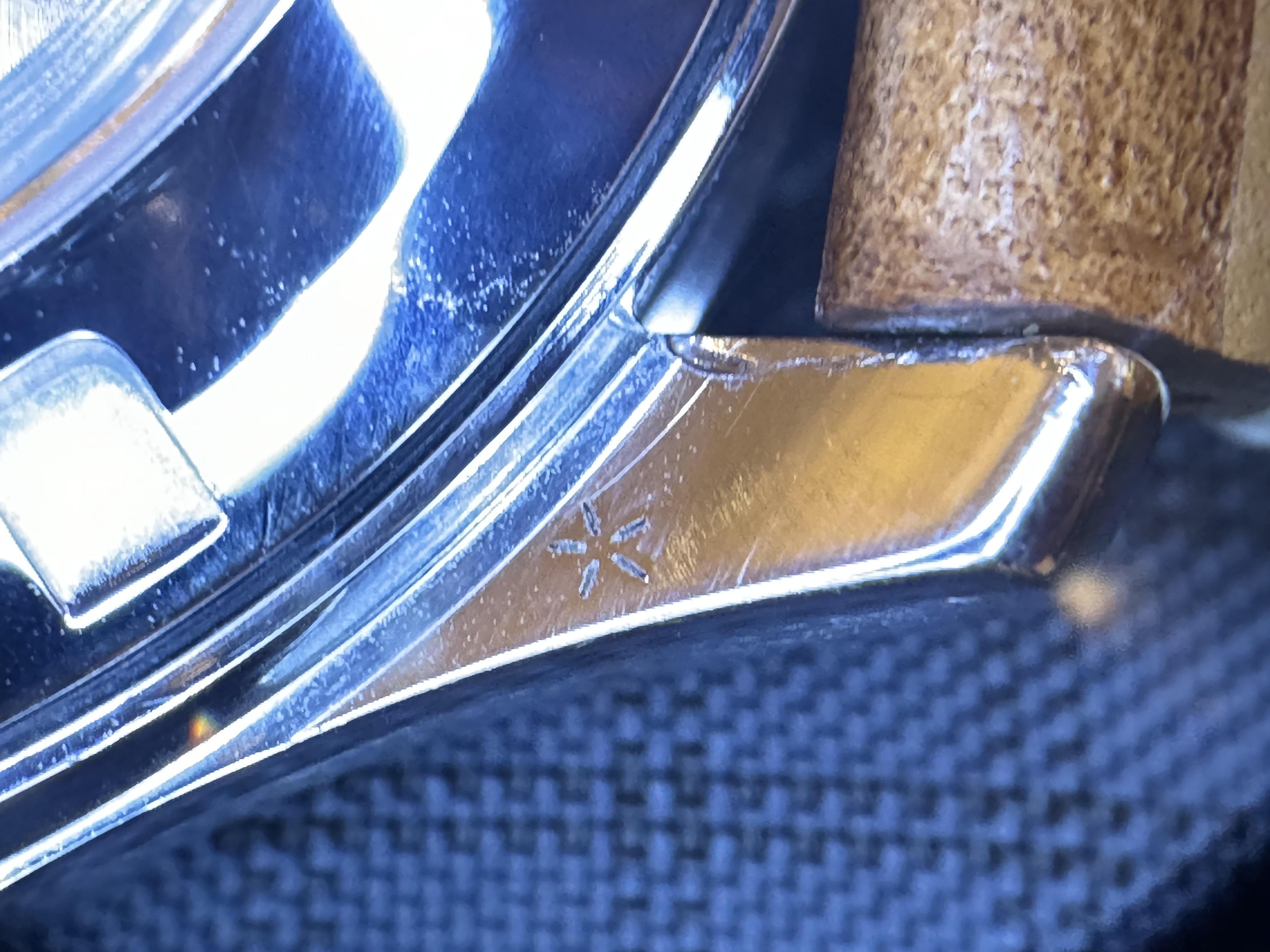

It should be on this lug I believe. Maybe they polished it away? It certainly looks like it.

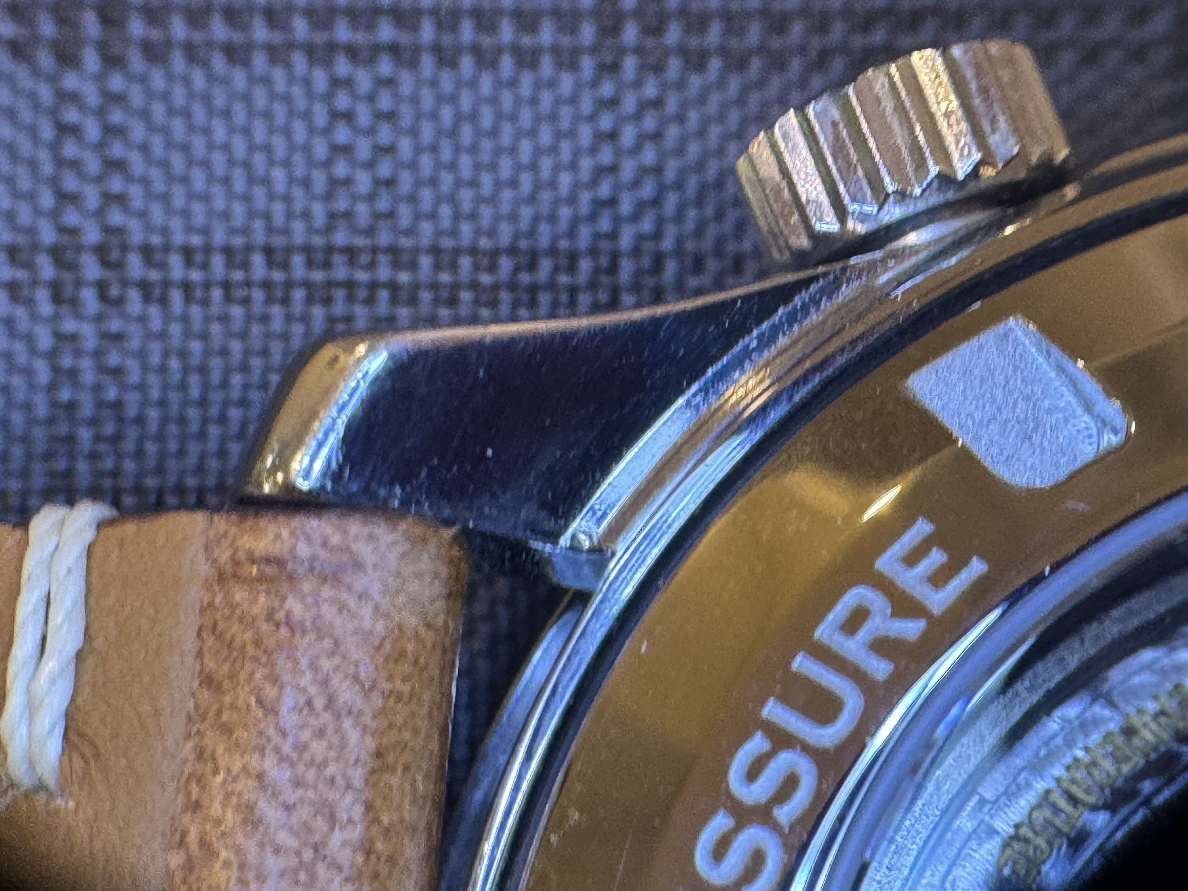

The star stamp on one of the lugs is a quality inspection thing that Omega does. It means it was selected randomly for inspection.
524
1,130
One of the first things I check on neo-vintage SMP300's on Chrono24/Ebay is for the serial number to be present on the lug.
In any case (no pun intended), your case looks in great condition. Does not look like it has been polished much.

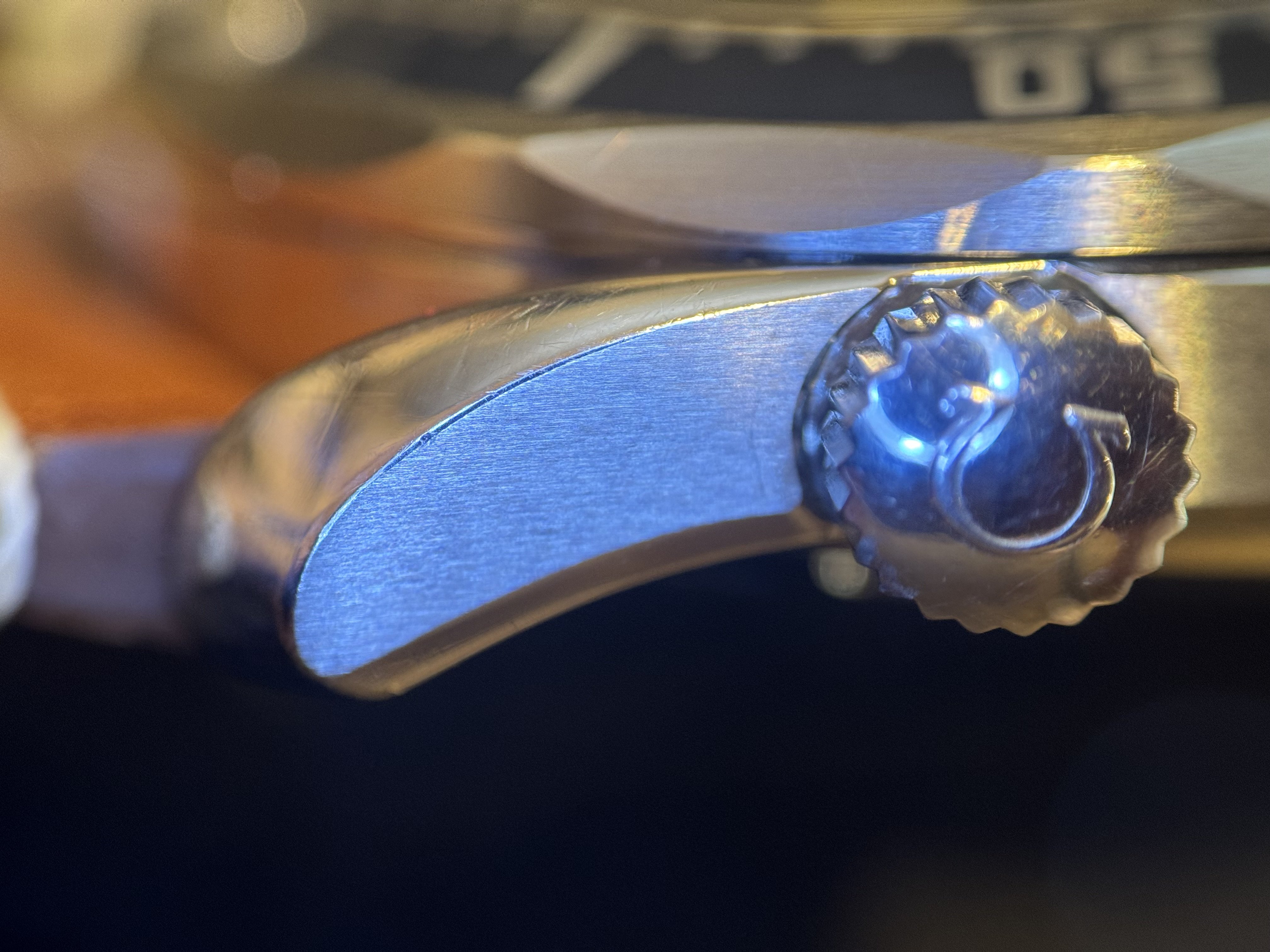

It did include the bracelet. But other than the missing serial, the case/lug doesn't really look like it's been polished, or does it?
