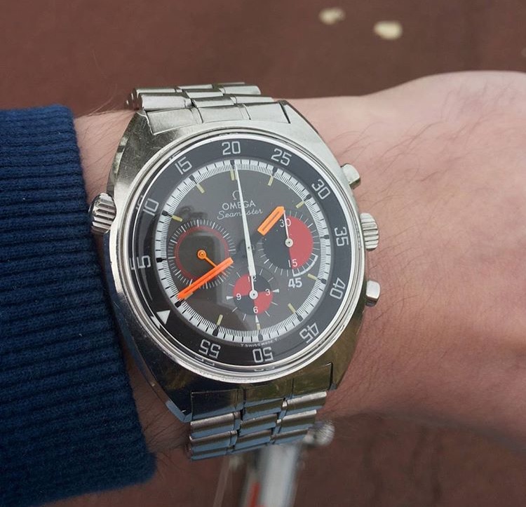

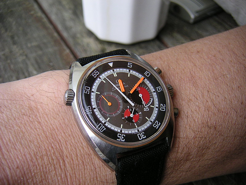

Have been trying different bands/bracelets on my Soccer Timer to find the right overall feel. Purchased this vintage BOR and I think the combo is really nice!
