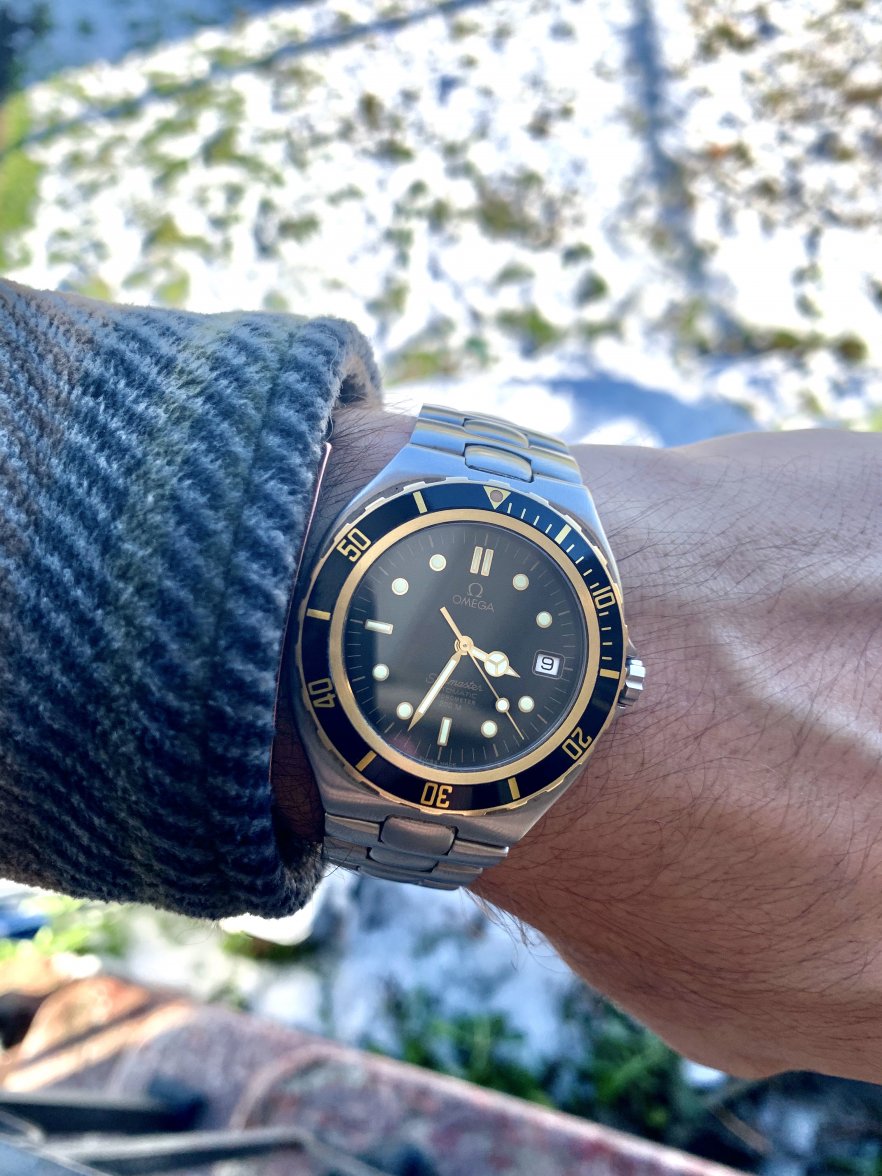

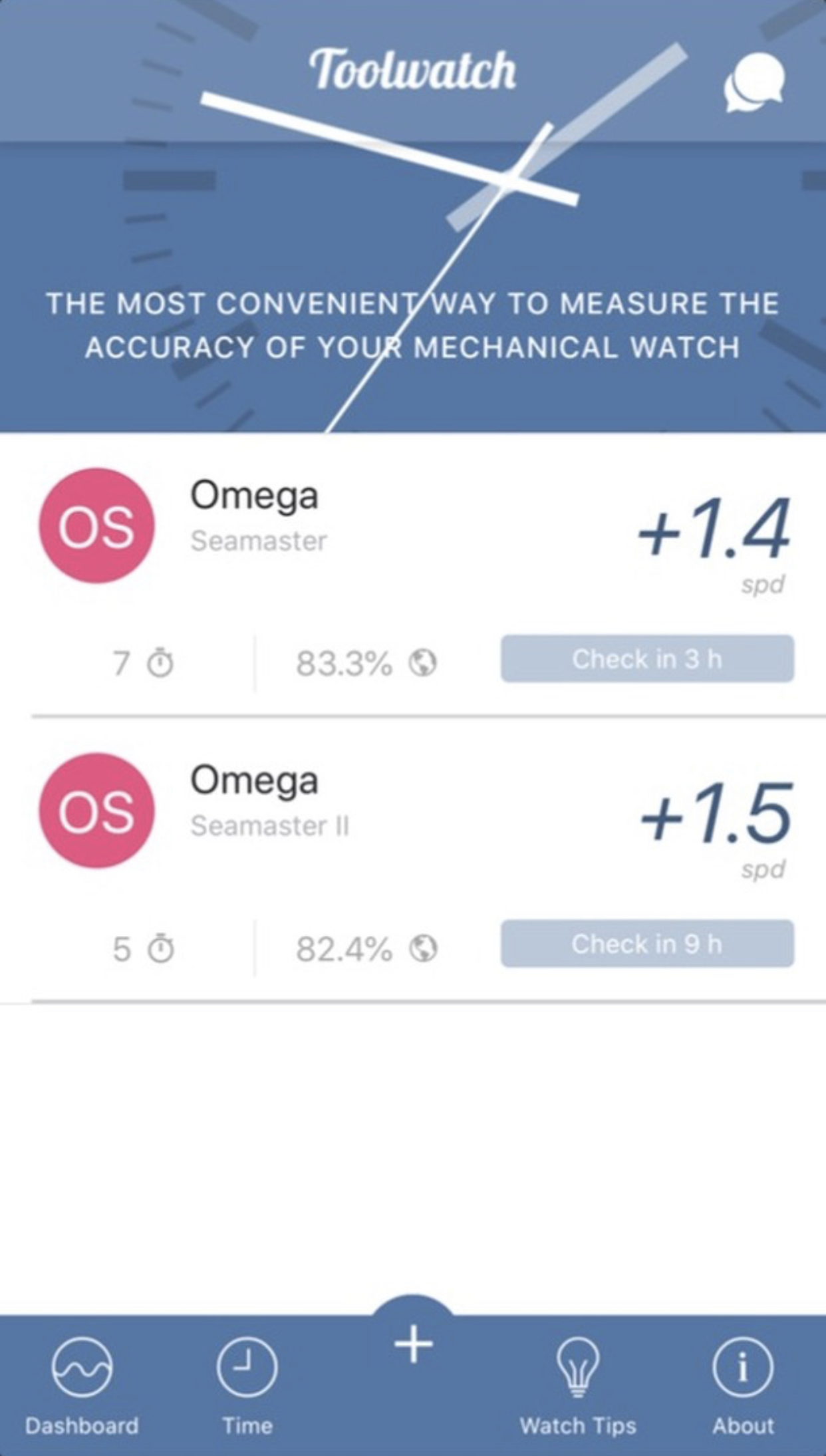

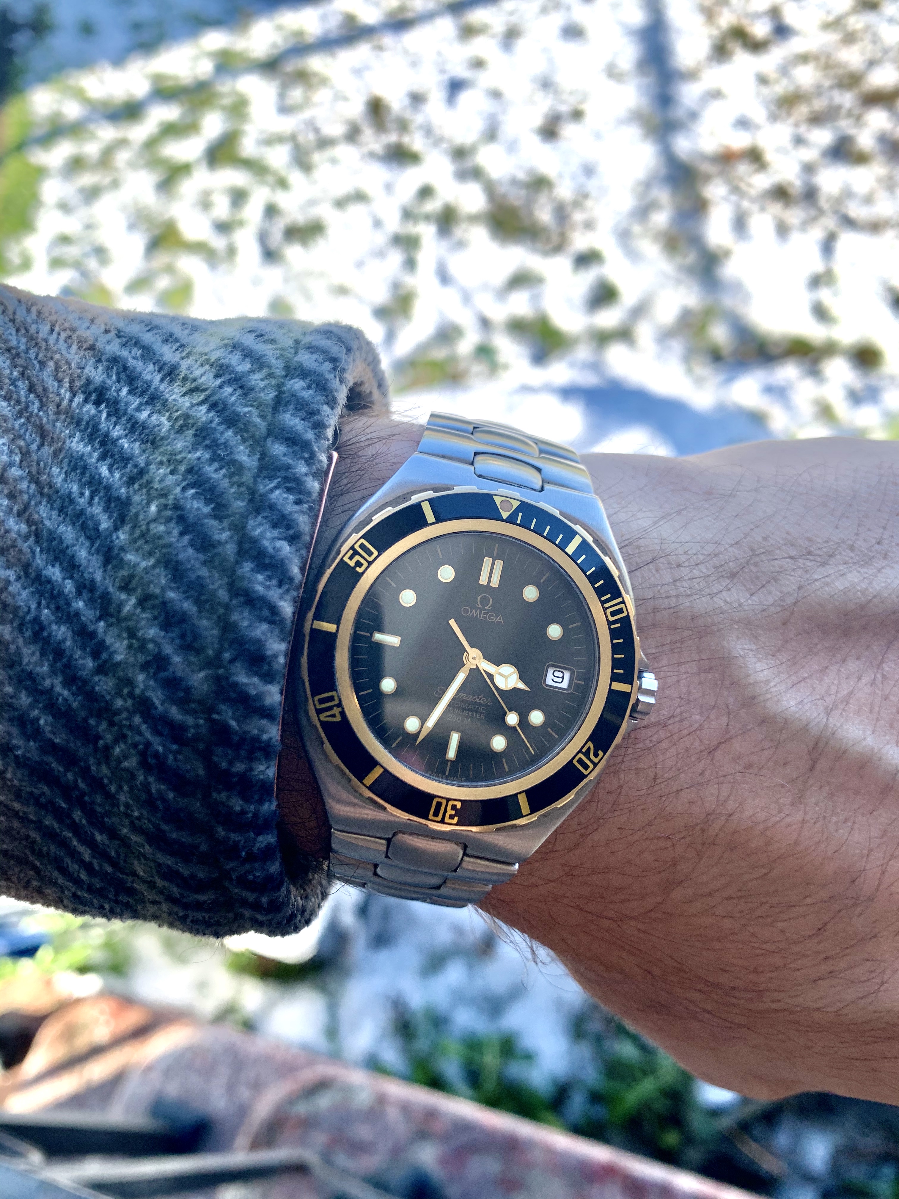

I recently came into my first Omega a few weeks ago. Picked up a ref 368.1041 Seamaster 200m from a fellow enthusiast around town. I've been wearing it religious ever since! Using the toolwatch app on my phone, I've been doing a very informal monitoring of the accuracy, testing it twice a day.

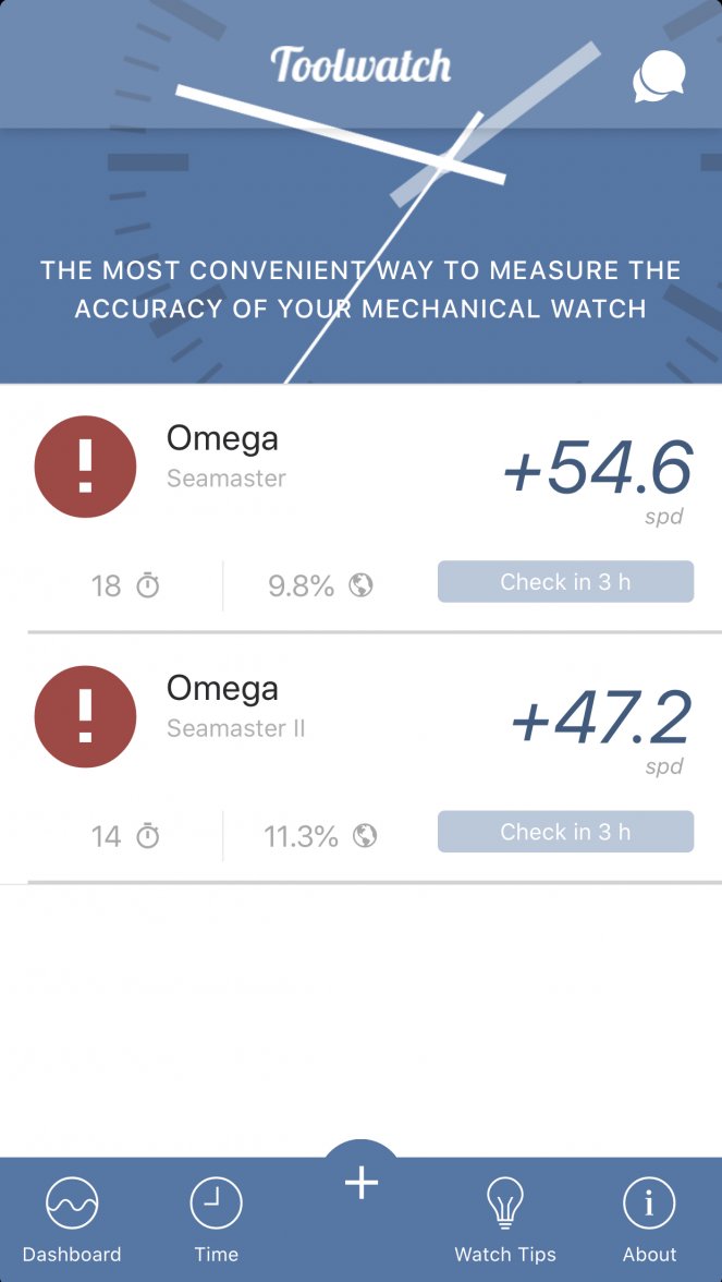

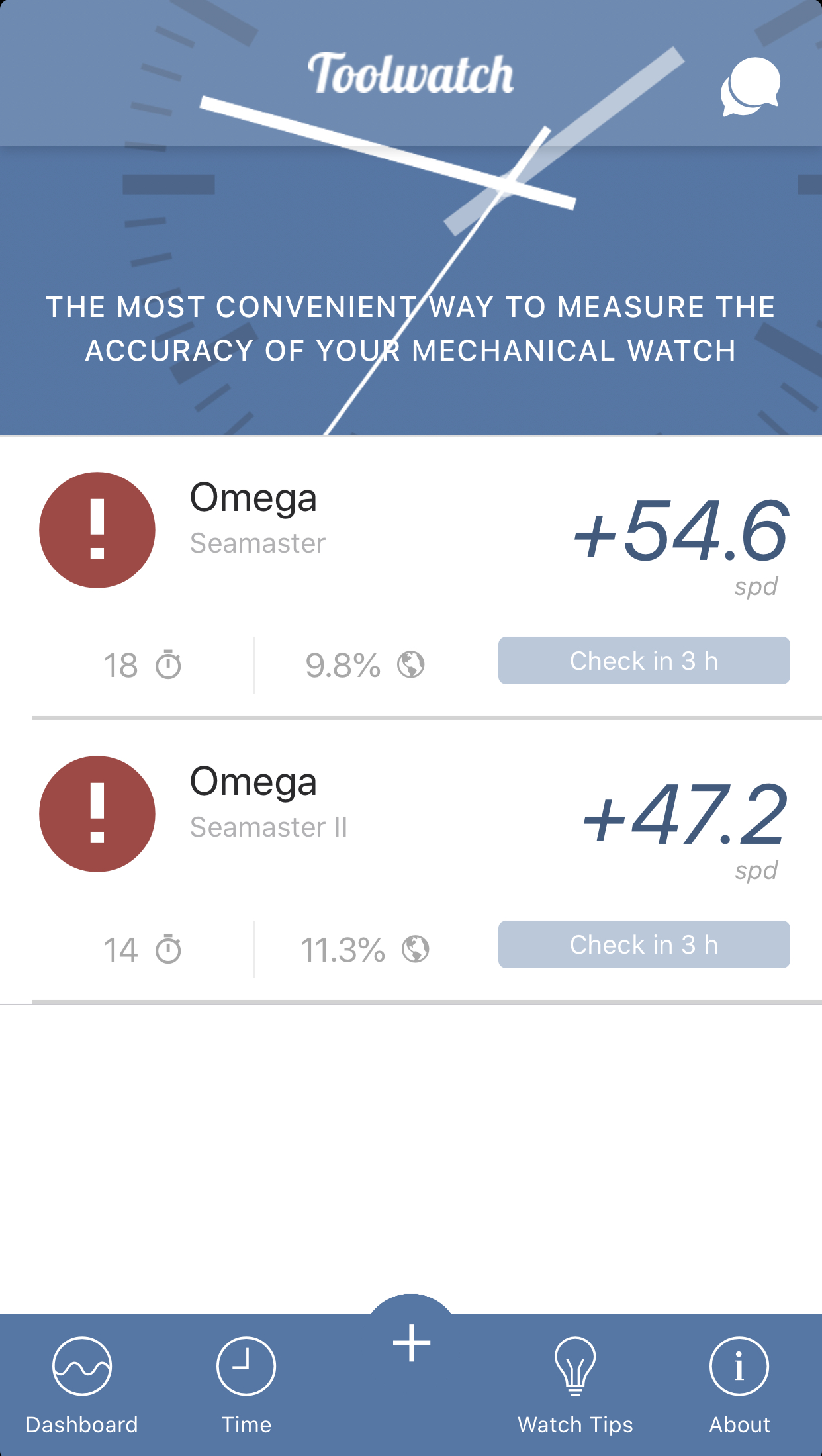

My first interesting find is that while very close to perfect, it never kept a consistent rate. For example, some measurements would be a bit slow, some would be a bit fast. It did this for a few days until it rested at around +1.5-2 for about a week. Then a few days ago it started running fast. Really fast. The first day is was +20, then +25, then +40. I just measured it again now with 2 separate apps and one shows +47.2 and the other shows +54.6.

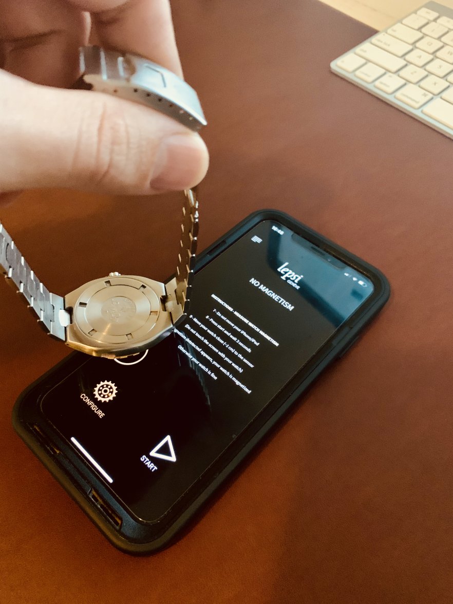

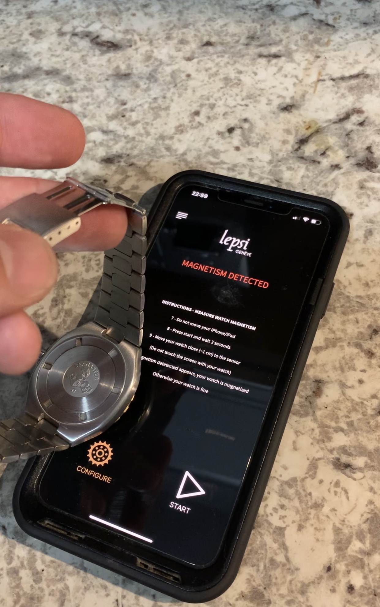

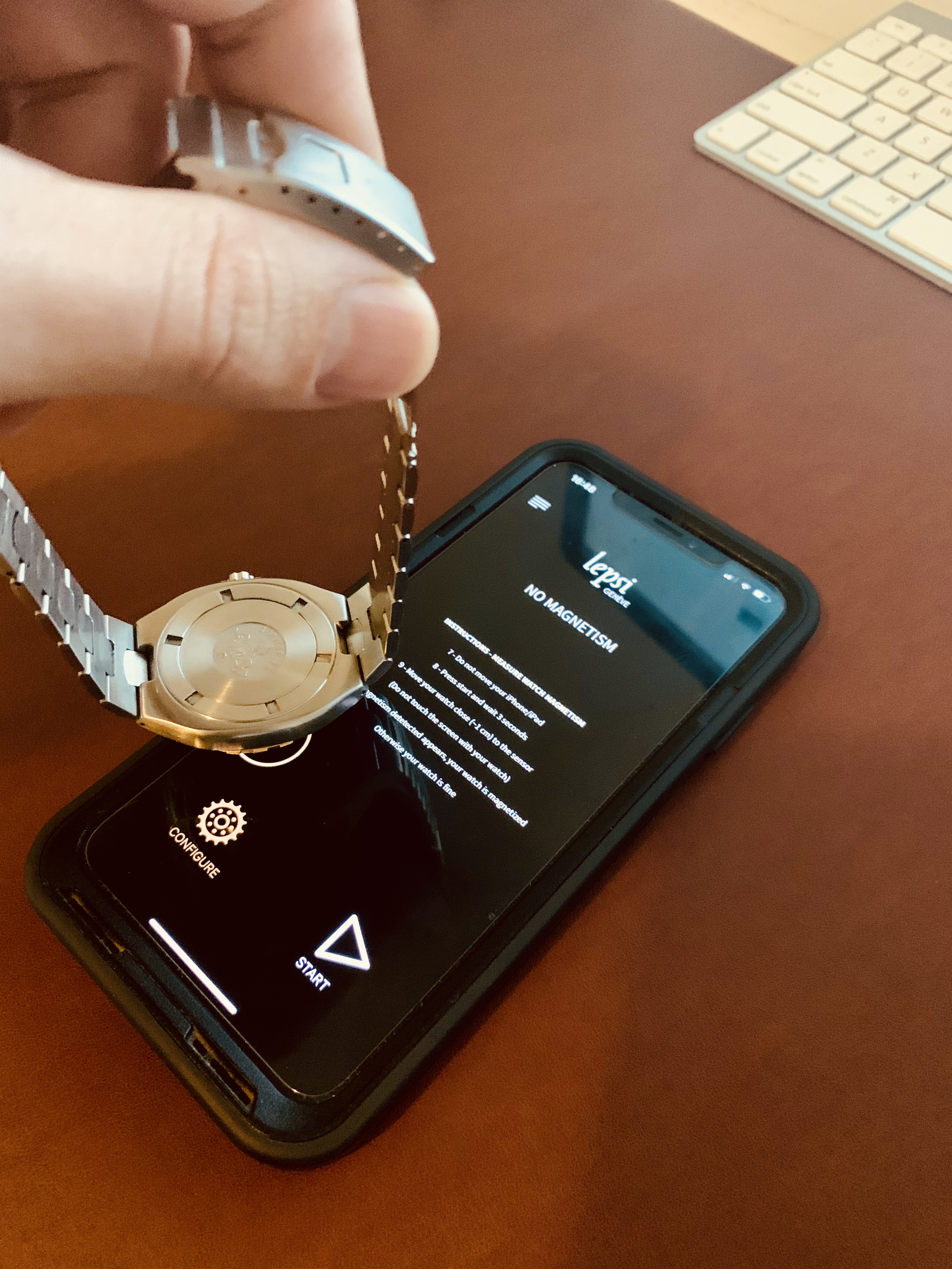

From my googling, this seems to be a symptom of magnetization. I downloaded the Lepsi app that utilizes your phones compassions to test your watch and, go figure, it says that it's magnetized. Here are my questions:

Do you have a watch that you think is not magnetized? Try it on the app and see what it says. Just curious.

Thanks for all the replies everyone! I'm going to try the Lepsi phone test with an old watch and also check this watch with a compass as some of you recommended. Mainly just for fun at this point as I've already purchased a $10 demagnetizer that should be here in a few days. I have an old and very broken Seiko 5 that's not worth the cost to service it, so maybe I'll try to magnetize that and practice demagnetizing it 😉. Either way, some locals recommended a watch repair shop and I will most likely suck it up and get it serviced there for good measure. I'll let you know how it goes!

Bad idea. The "sensor" is an inch away from a strong magnet.

It is noticeably off. Compared to a timing app and the atomic clock from 2 separate references. It's +1 min 55sec today. It seems to be getting faster and faster every day.

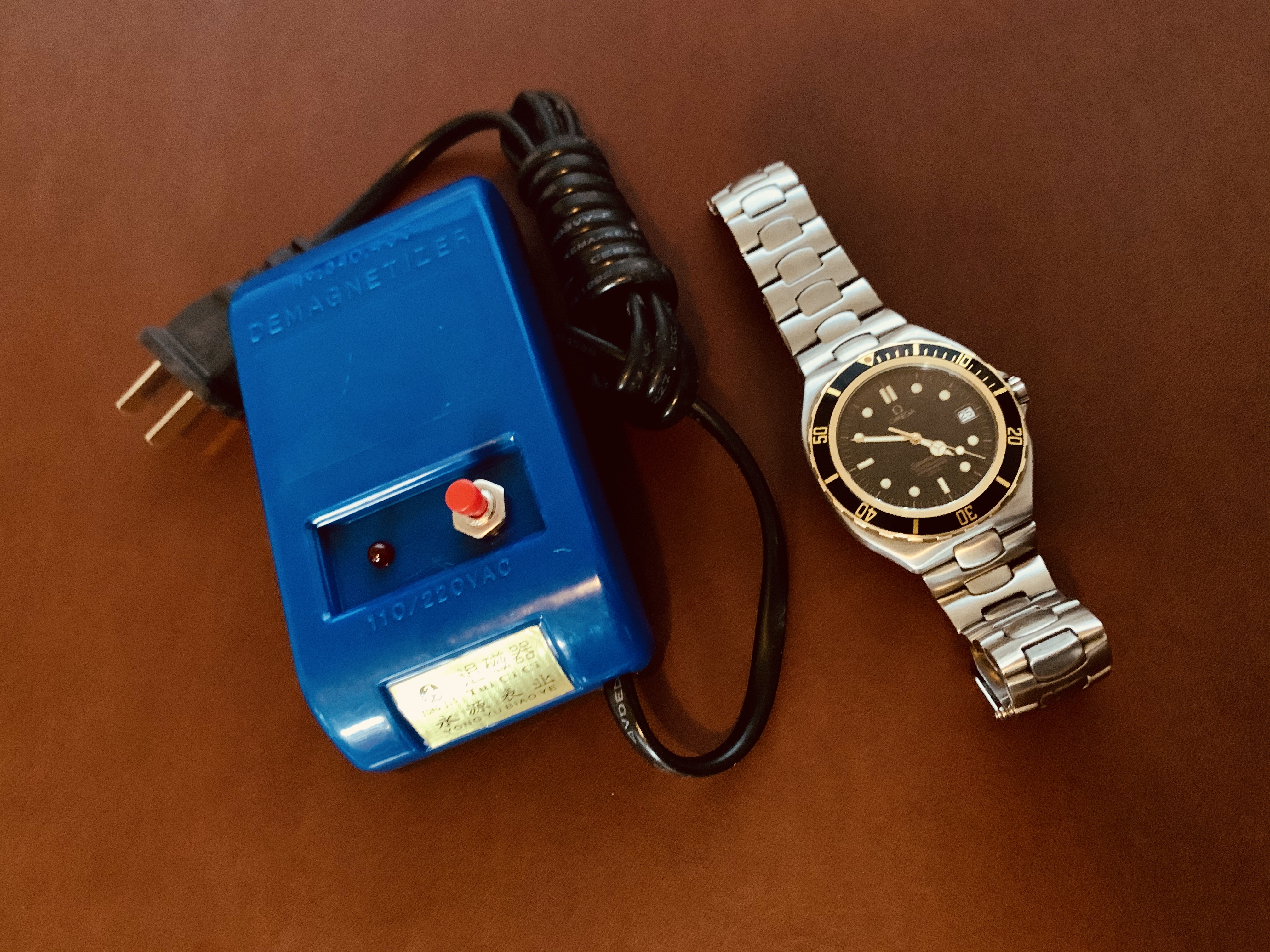

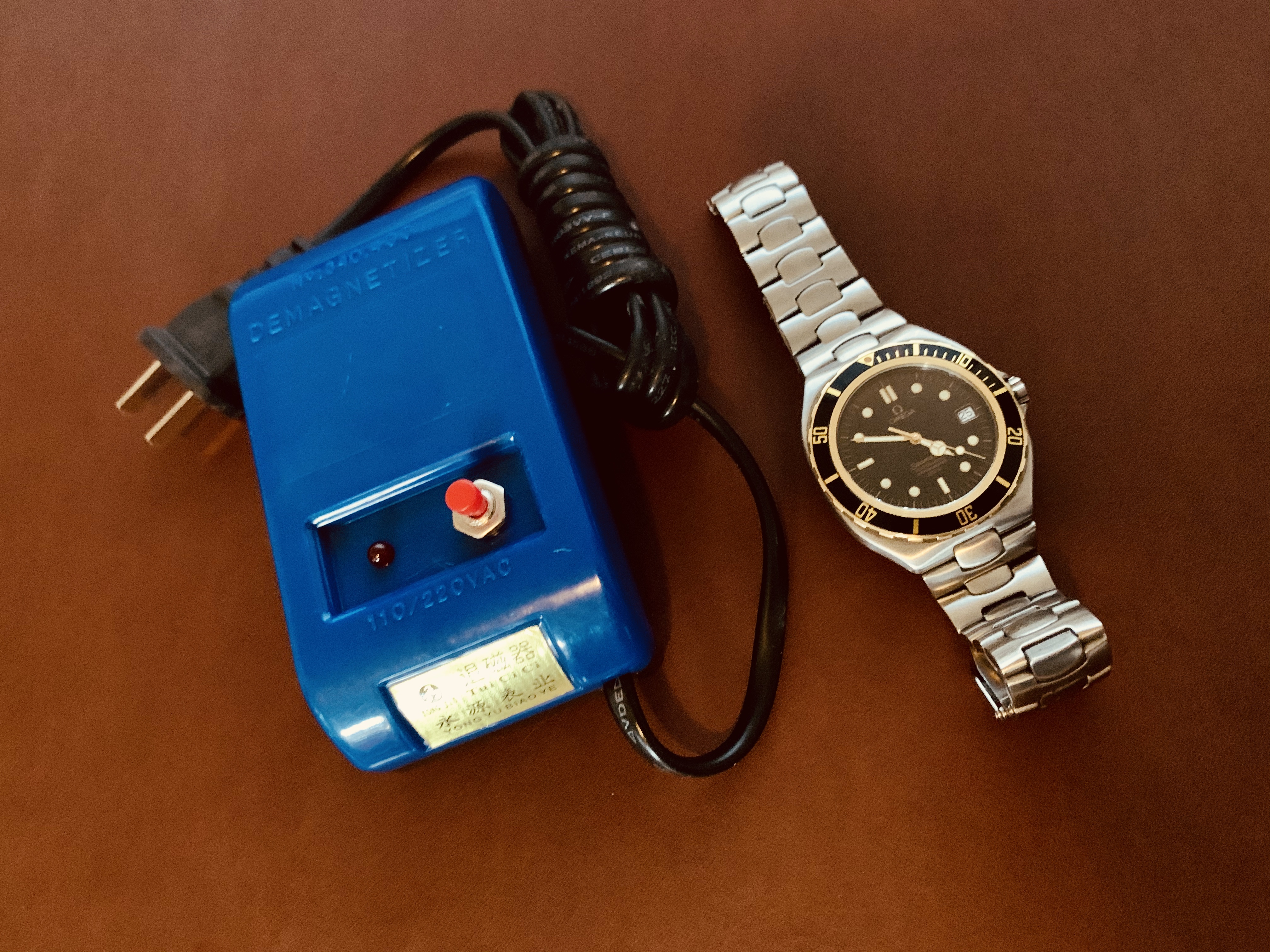

The $10 amazon demagnetizer showed up today, and it seems to have worked well. I took an old seiko 5 and sat it on a magnet for a few hours and tested it with the phone app and compass, showing significant magnetization. Using the demagnetizer, I placed it over the tool with the power on for 10 seconds on and slowly pulled away, as I saw demonstrated on a YouTube video. The watch was then negative for the compass and phone app tests. So I did it with the Seamaster and had the same results. I just synchronized it to the atomic clock and also the ToolWatch measurement app. I will track it for a bit and report back with my results!

As I understand it... I've not googled very long, this Lepsi app uses your phone's built in compass and detects it shifting when a magnetic objects comes near it.
As for the phone magnetizing your watch... it may have magnetic parts, but probably nothing that can easily effect your watch and especially near the phone's compass... otherwise you compass would not work at all. For the purposes of using the Lepsi app to check it's probably fine.
Sharing my own experience, I just tried the Lepsi app and found four of my watches were magnetized. After demagnetizing the Lepsi app stopped consistently marking those watches as magnetized.
