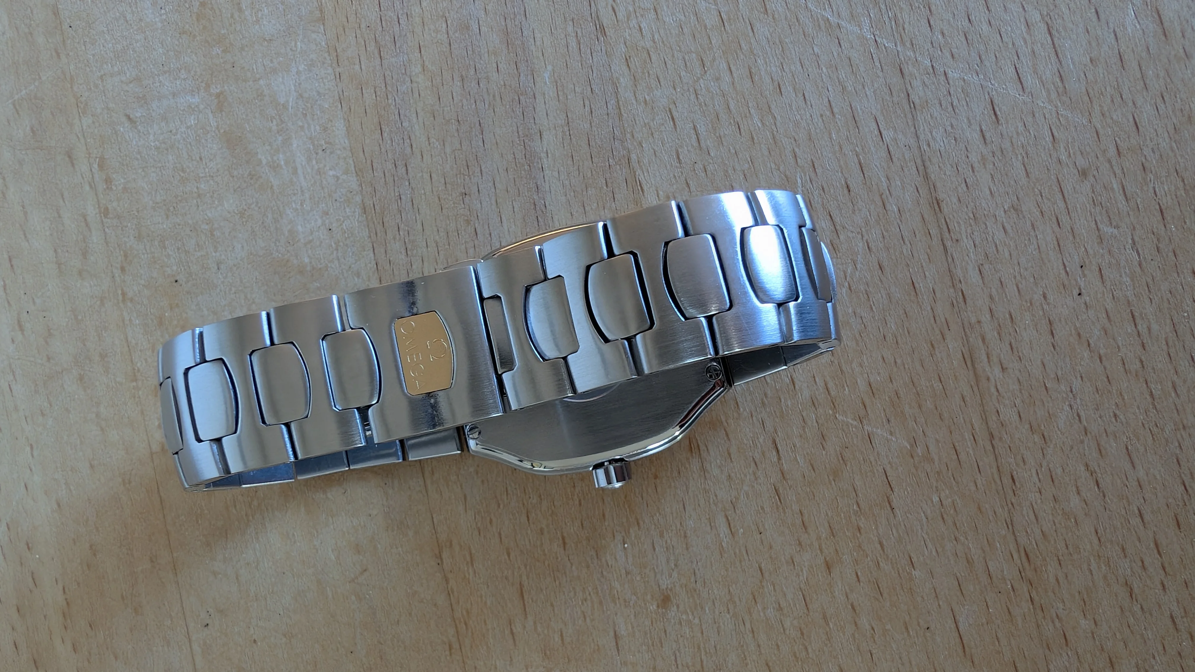

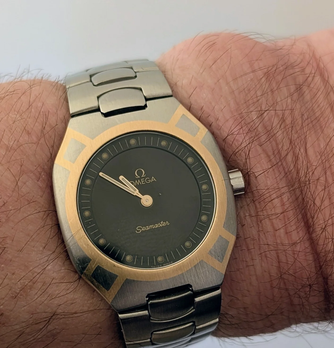

It came back a few days ago - really happy with it and the Omega service. Total cost was GBP 450 significantly less than I had expected from their price list a,d just over 10 weeks not the 18 they were quoting. So now the previosuly worthless watch is now likely to be worth a bit more then the service cost. But it never was about £££. 33 years old, a 40th birthday gift, and much better than anything I would get for that money now.
It all works, the 2 time zones, various day/date/timer/countdown/alarm/language functions work as they should and you can turn it all off and just have hands showing which I prefer. It came back nicely cleaned and a bit polished - not overdone and it always was a brushed finish. It came back in a proper Omega presentation box, I still have original but its deteriorating in the cupboard - that slightly sticky old plastic feel you get.
To put the 'multifunction' features in context, back in 1992 a few of us carried basic 1st generation analogue mobile phones mostly for work, but few people did. To have those functions in your proper smart serious looking watch was good.
My wrist is small, the polaris would't suit everyone, but I am happy with it. I've got a half link that I can pop back in the strap, looks a bit too tight as it is.
Note to self - wear it lots more. Not in the workshop perhaps (I don't wear a watch anyway when I'm cutting or turning wood) but why 'keep it for best'.

It looks terrific!
Congrats on your rejuvenated watch.
It looks like Omega freshened the case and bracelet. That is something I did to my Polaris.

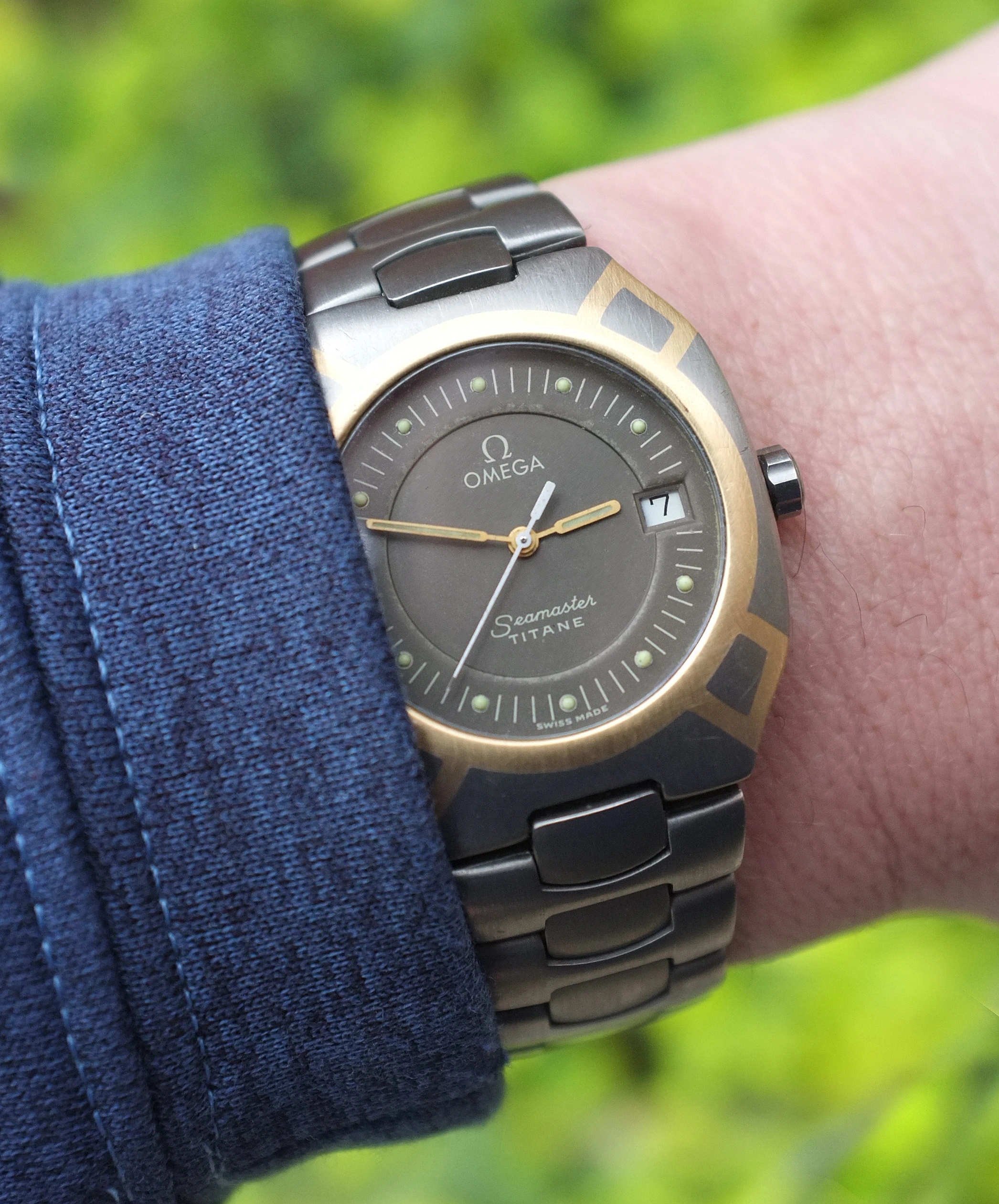

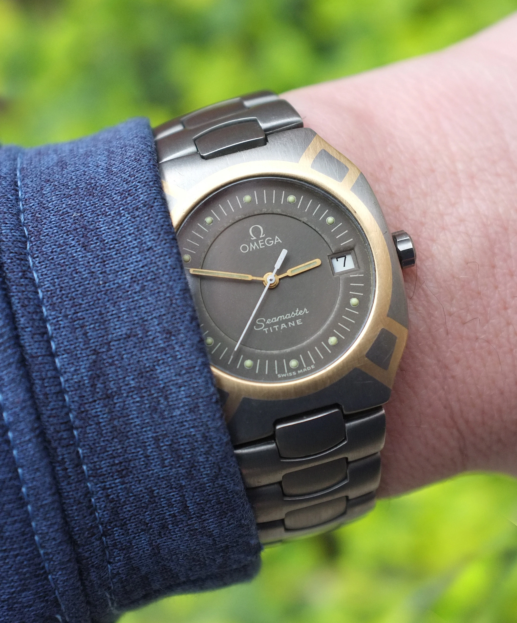

My titanium non-multifunction says hi!

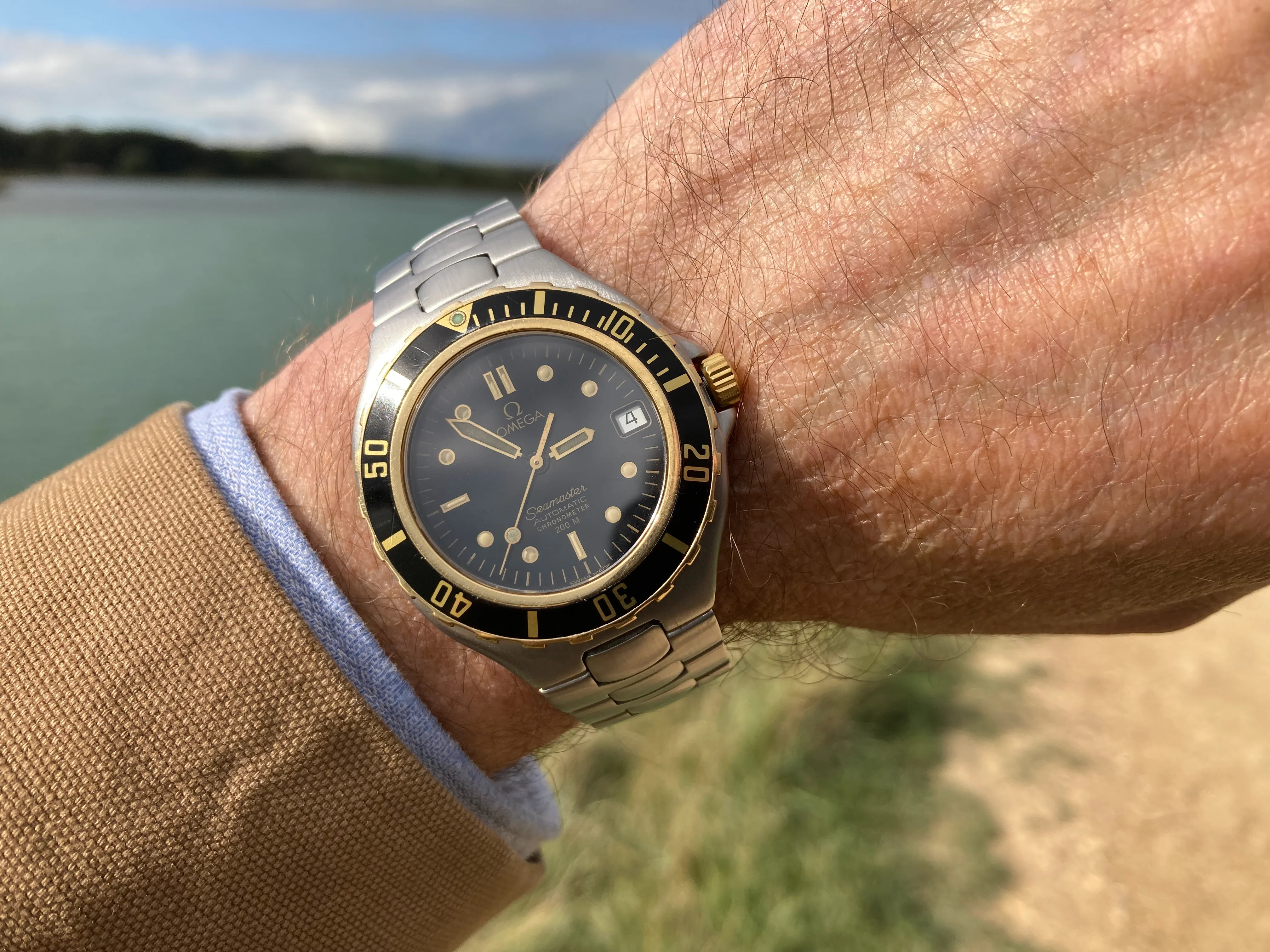

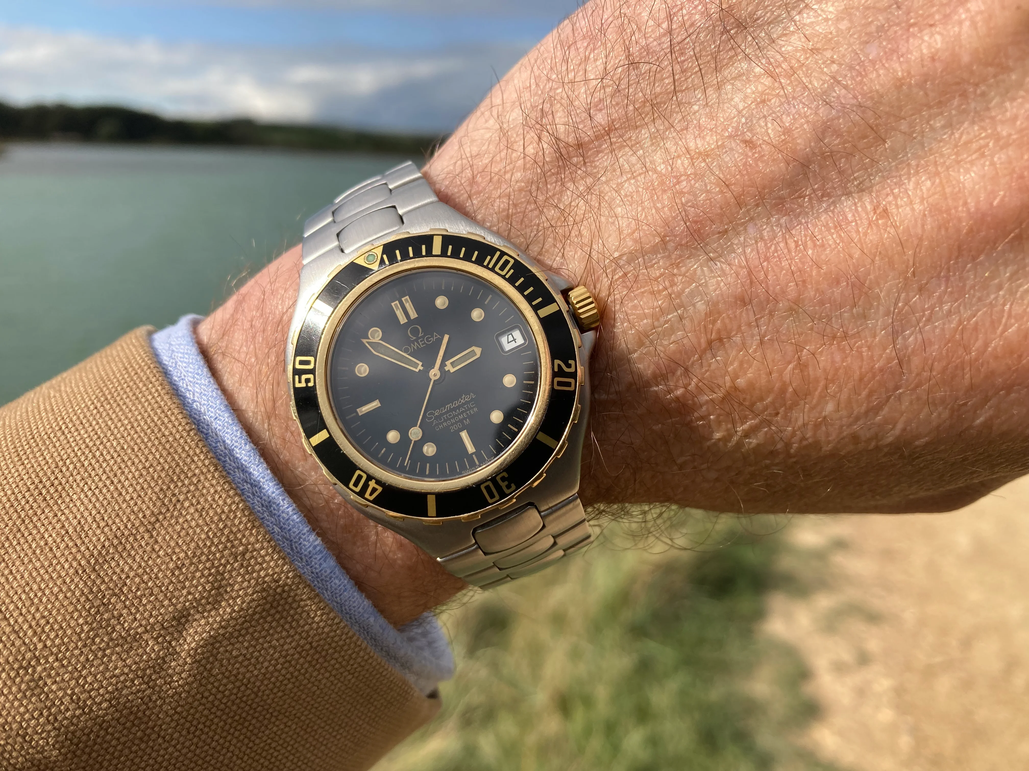

Outstanding! Glad to hear they got it back in service and it looks awesome. I recently had both of my Bond Seamasters restored (one auto and one quartz) and it was like turning the clock back to 1995-97. I have fond memories of those days so I really enjoy wearing them.

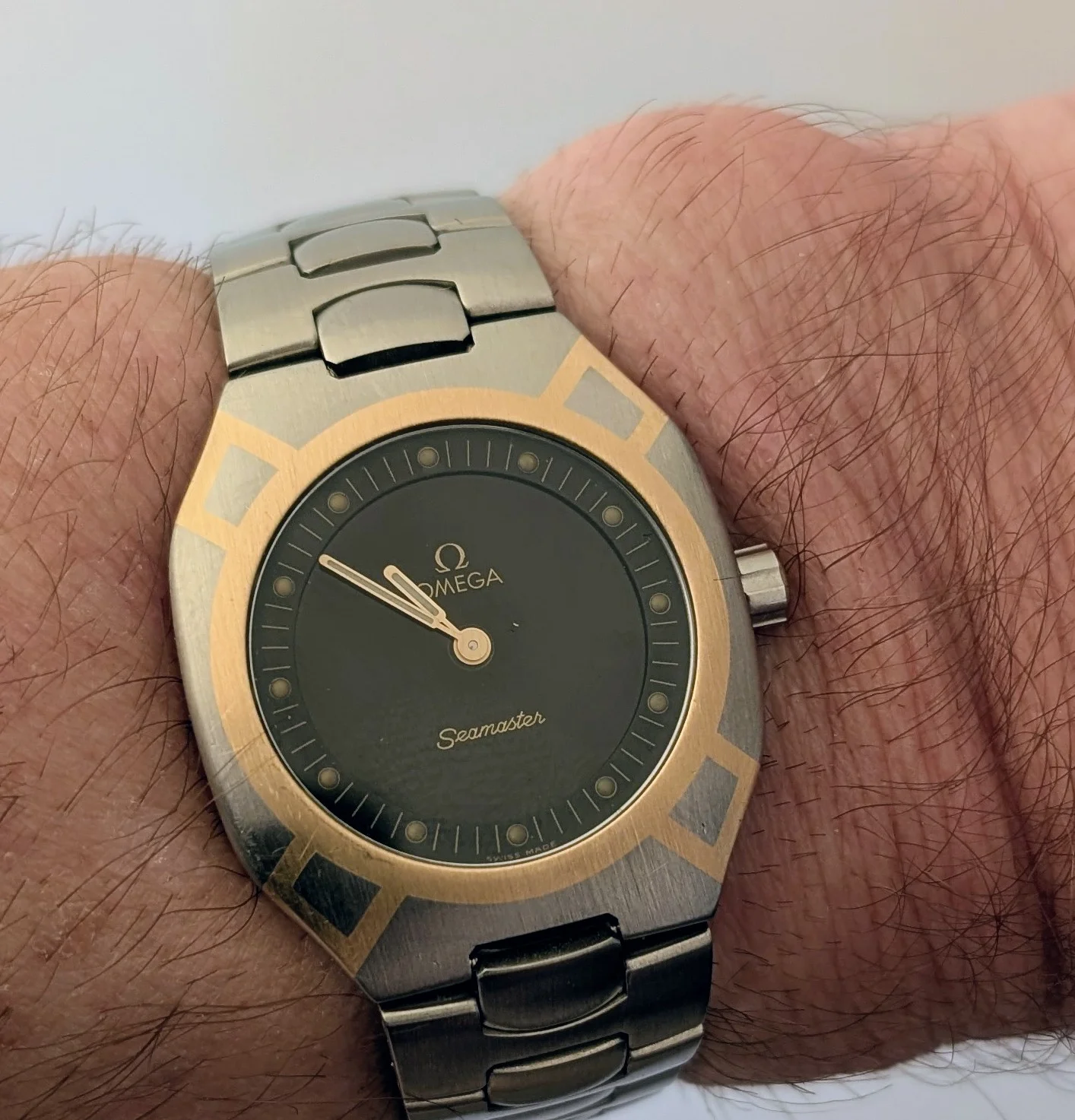

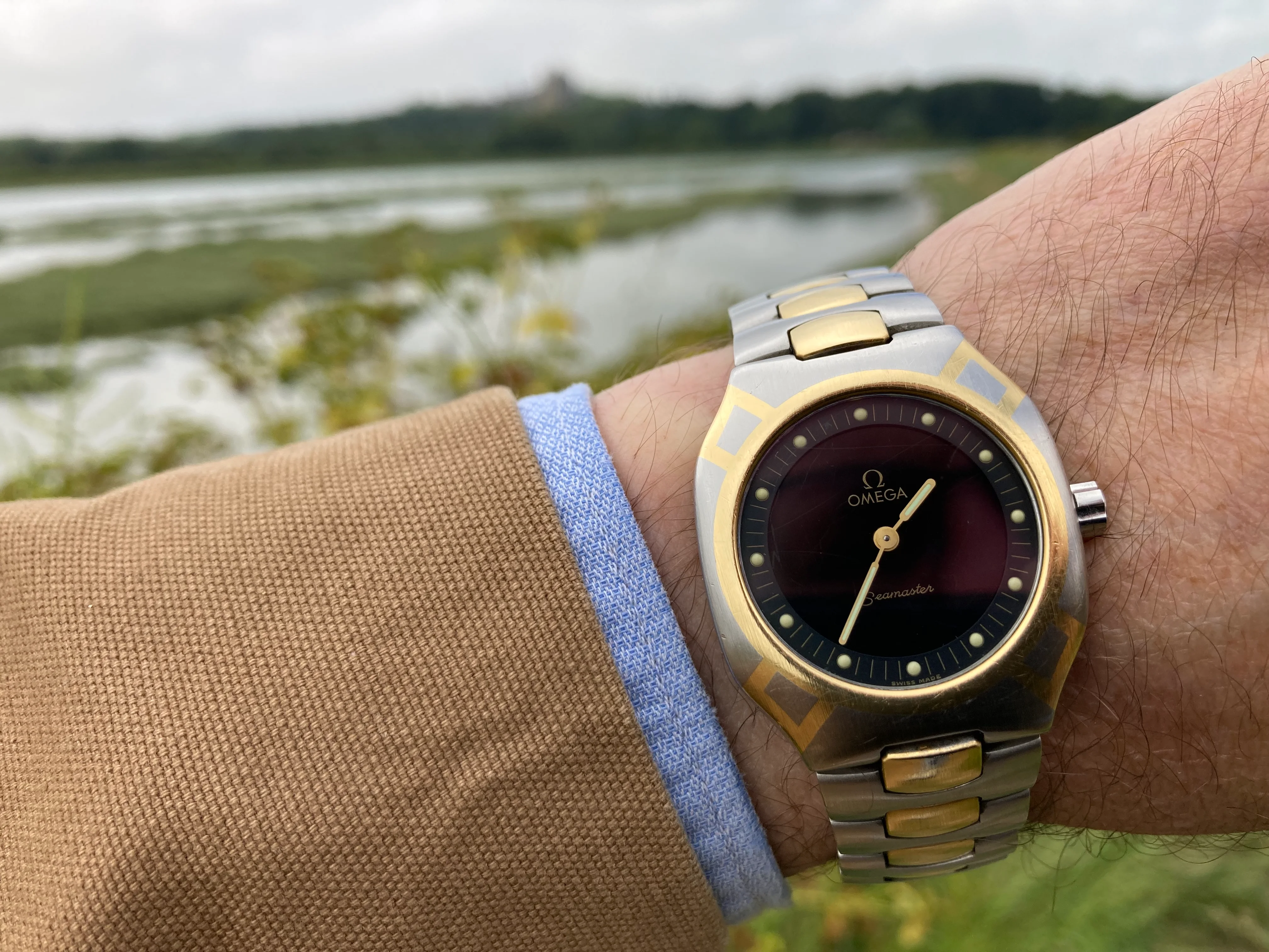

Mine says hi.
I'm a big fan of the Polaris. Nice thin and super comfy to wear.

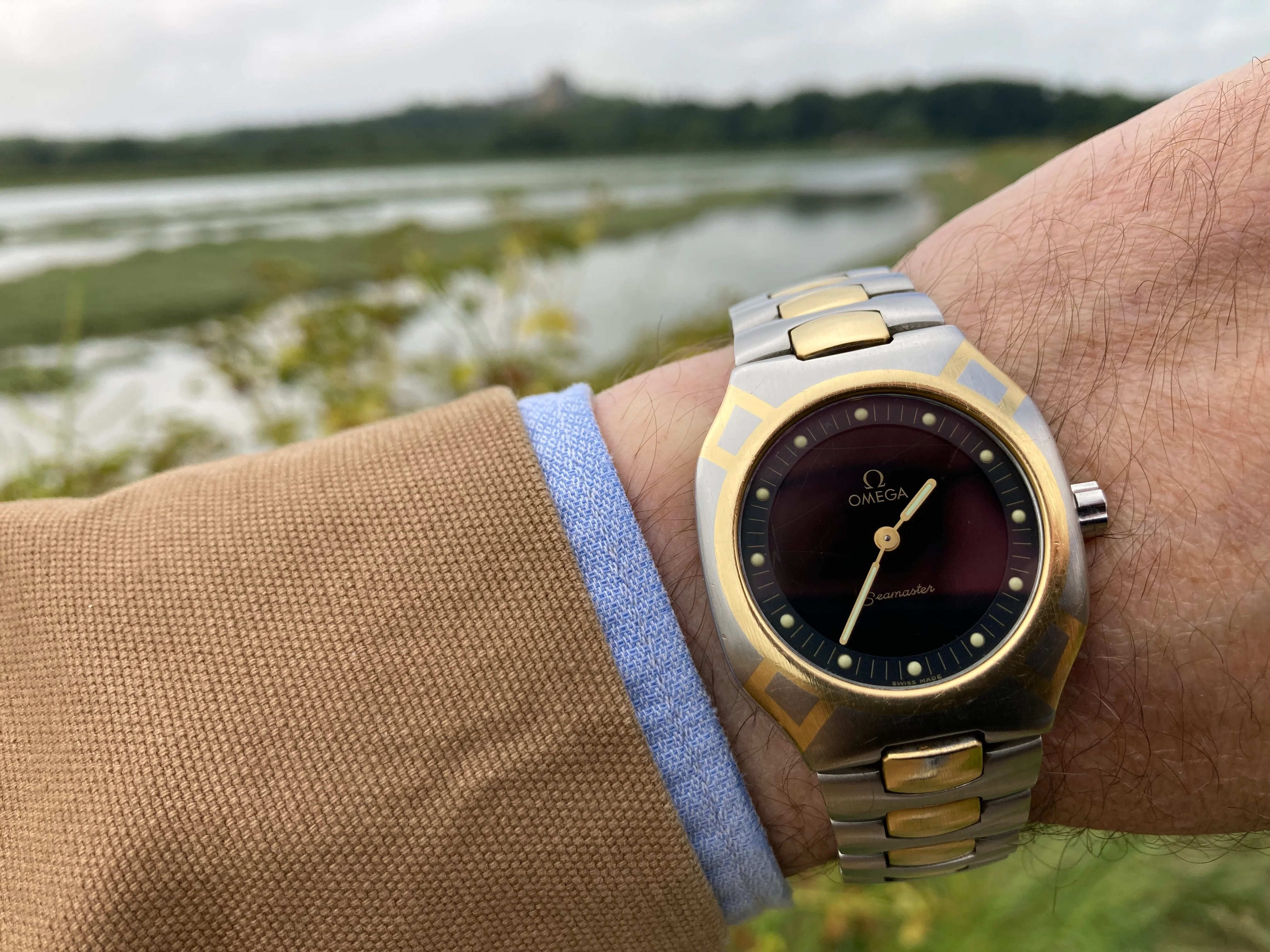

Mine has been back to Omega a couple of time over the years - they would generlly replace the whole movement/dial and give it a bit of a refinish. Last time about 15y ago they got a bit heavy on the buffing wheel and managed to put a couple of flats on the soft gold centre sections. Wish I'd complained at the time...
Anyhow I'm itching for a Titane like Deafboy's. But picked up a mid size pre-bond which oozes the same 90s vibe

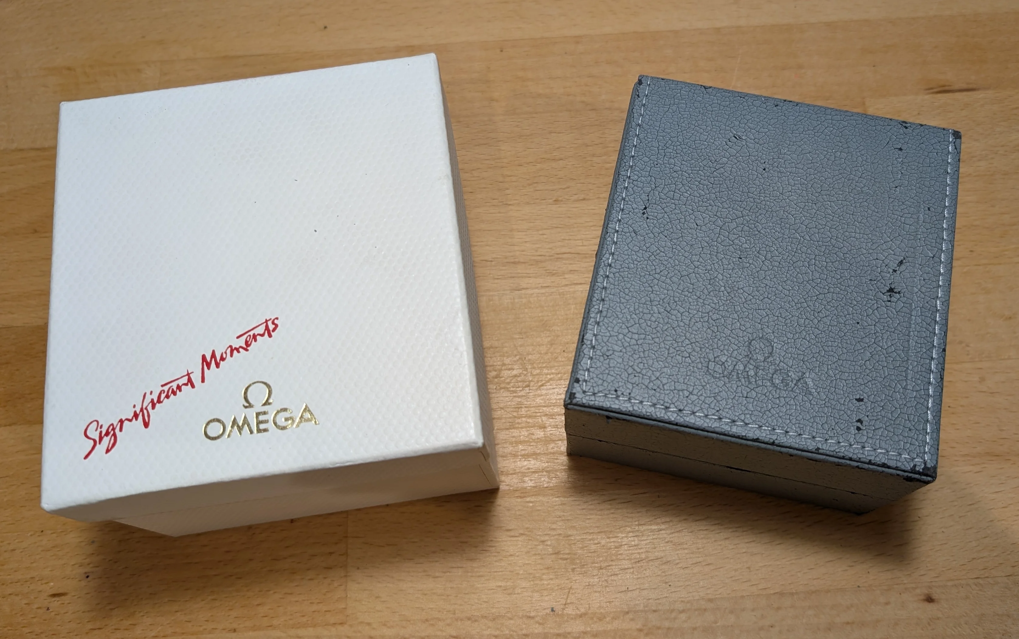

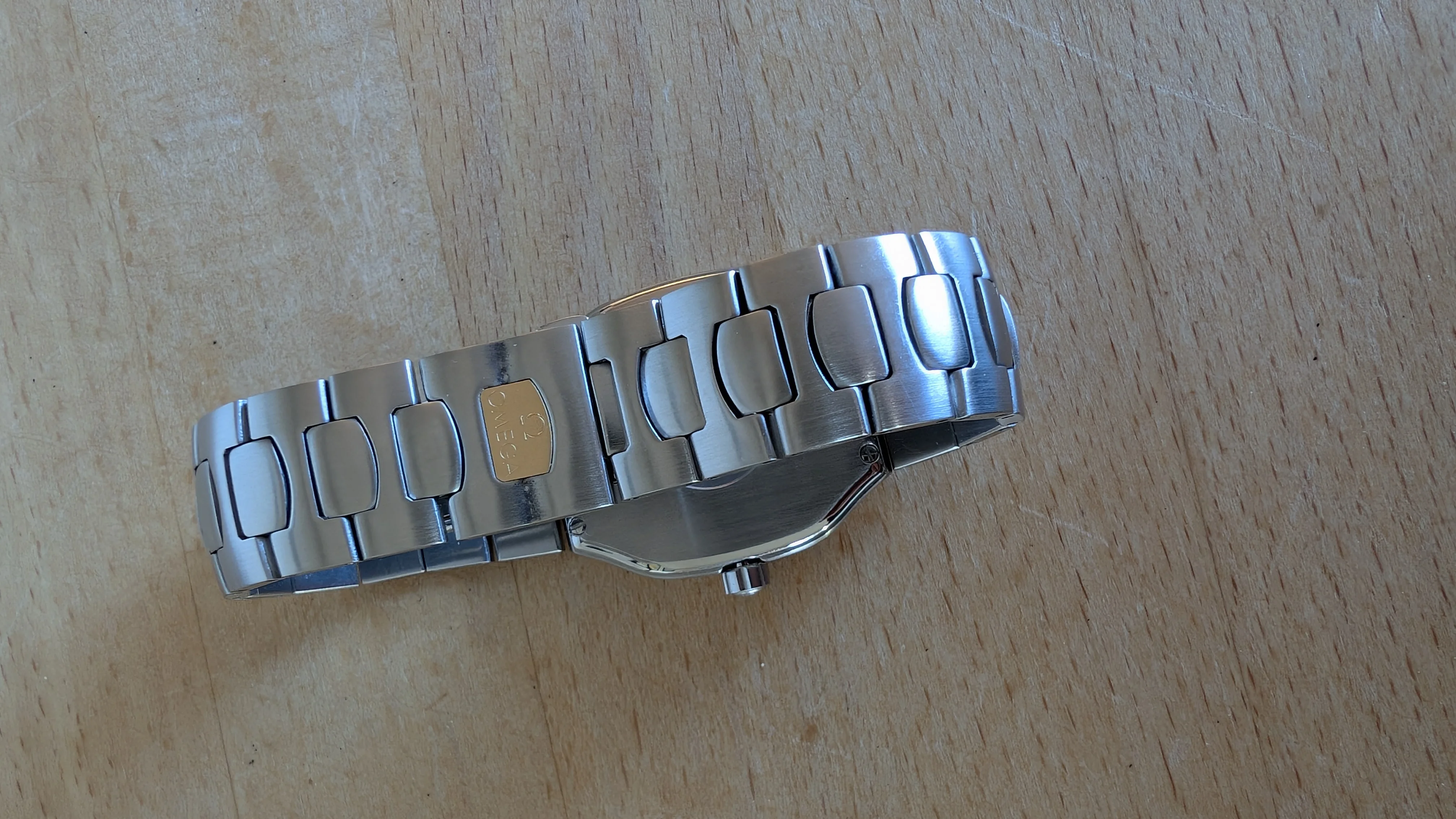

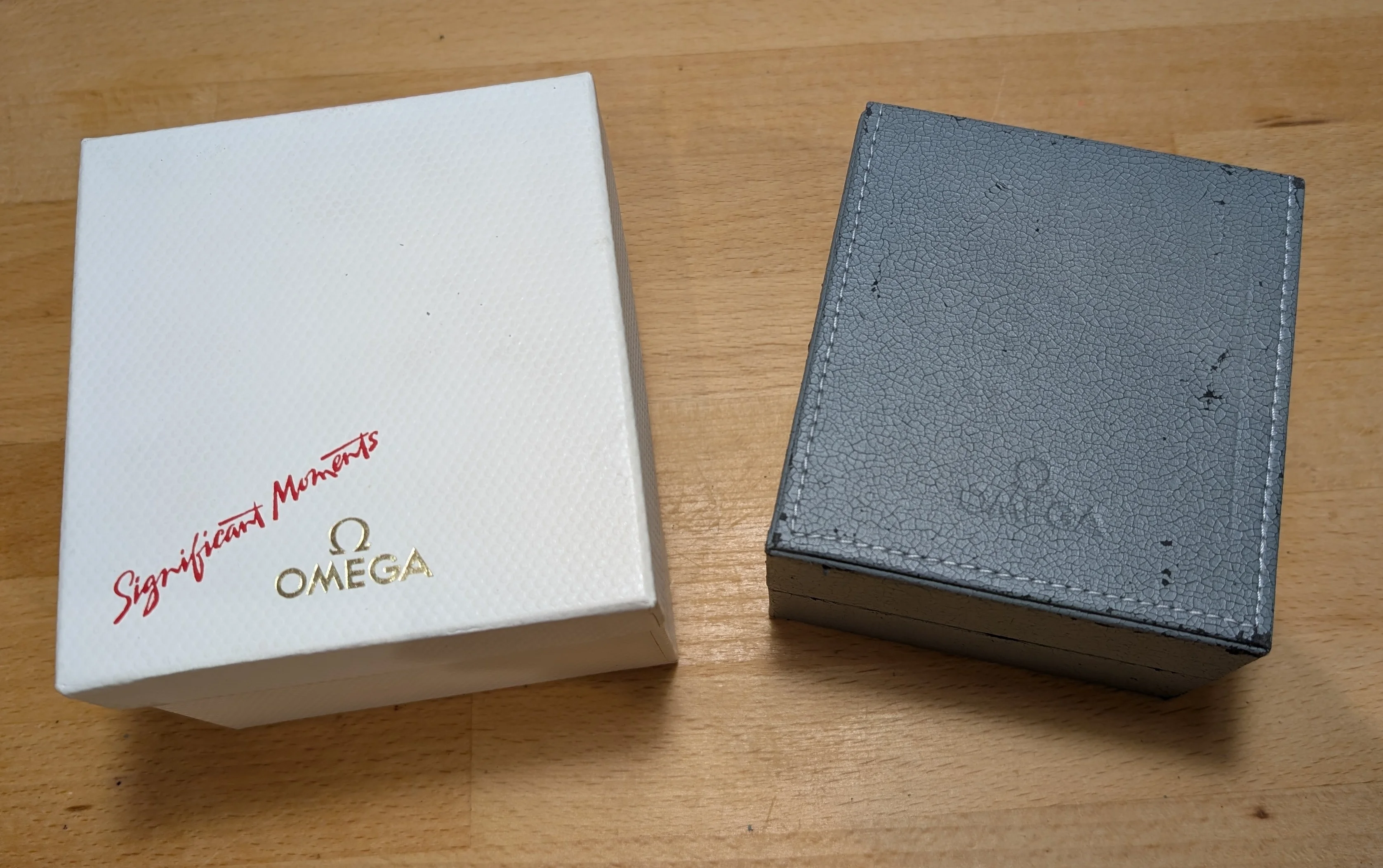

Just to round this off, to add a half link I had to go find things. I thought some might like a pictureof a 1992 Omega box. The cardboard outer looks good still, the inner plastic one is delaminating a bit as the 'mock leather' falls apart even though its been in the outer box in a dry cupboard.
