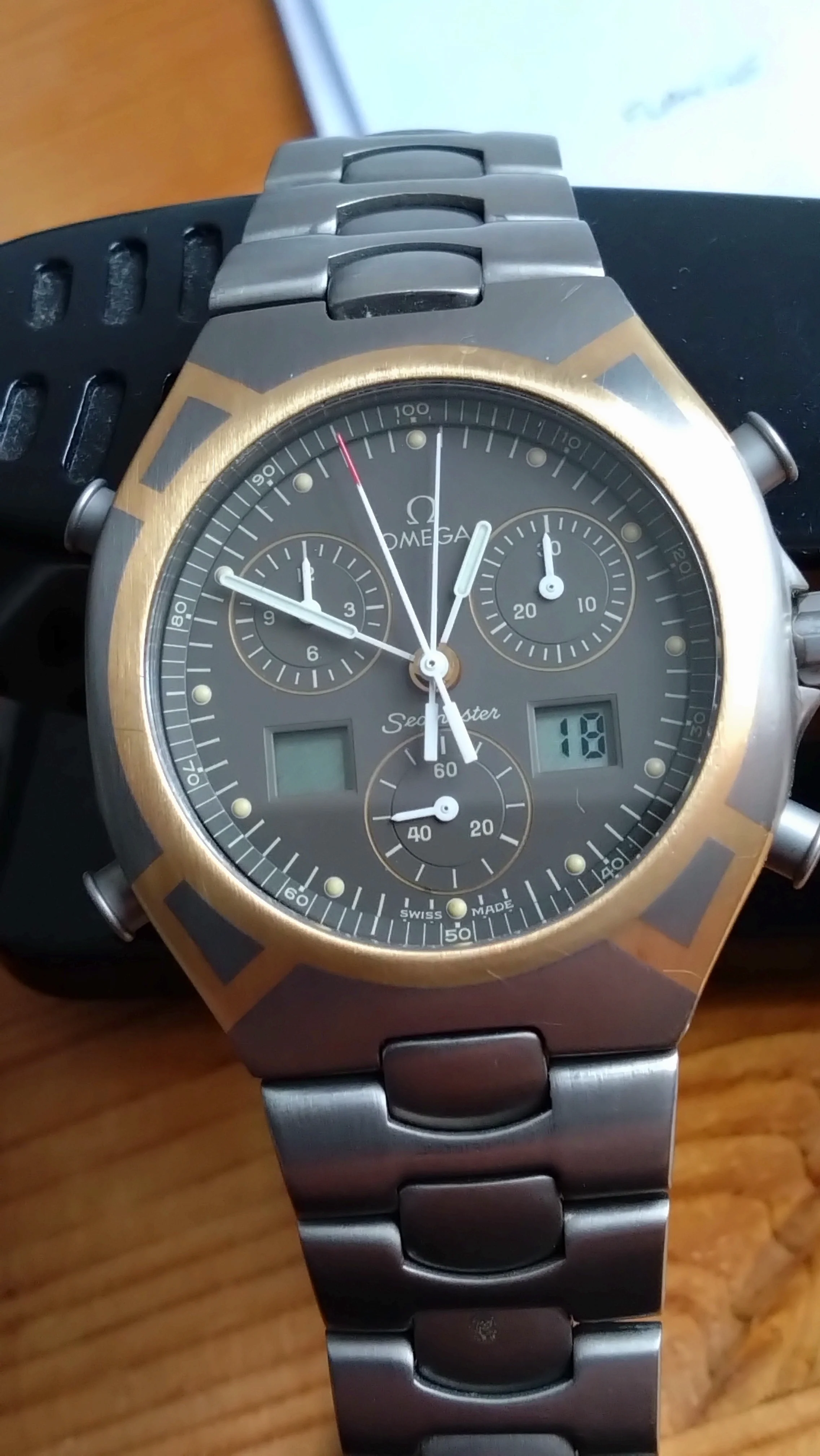

Hi All,
I have the titled watch and have just replaced the battery and have managed to reset the time, month and date but can not seem to reset both the seconds hands to zero (12 O,clock).
Is this acheivable or part of the chronograph/laptime function?
Any help would be welcome , thanks

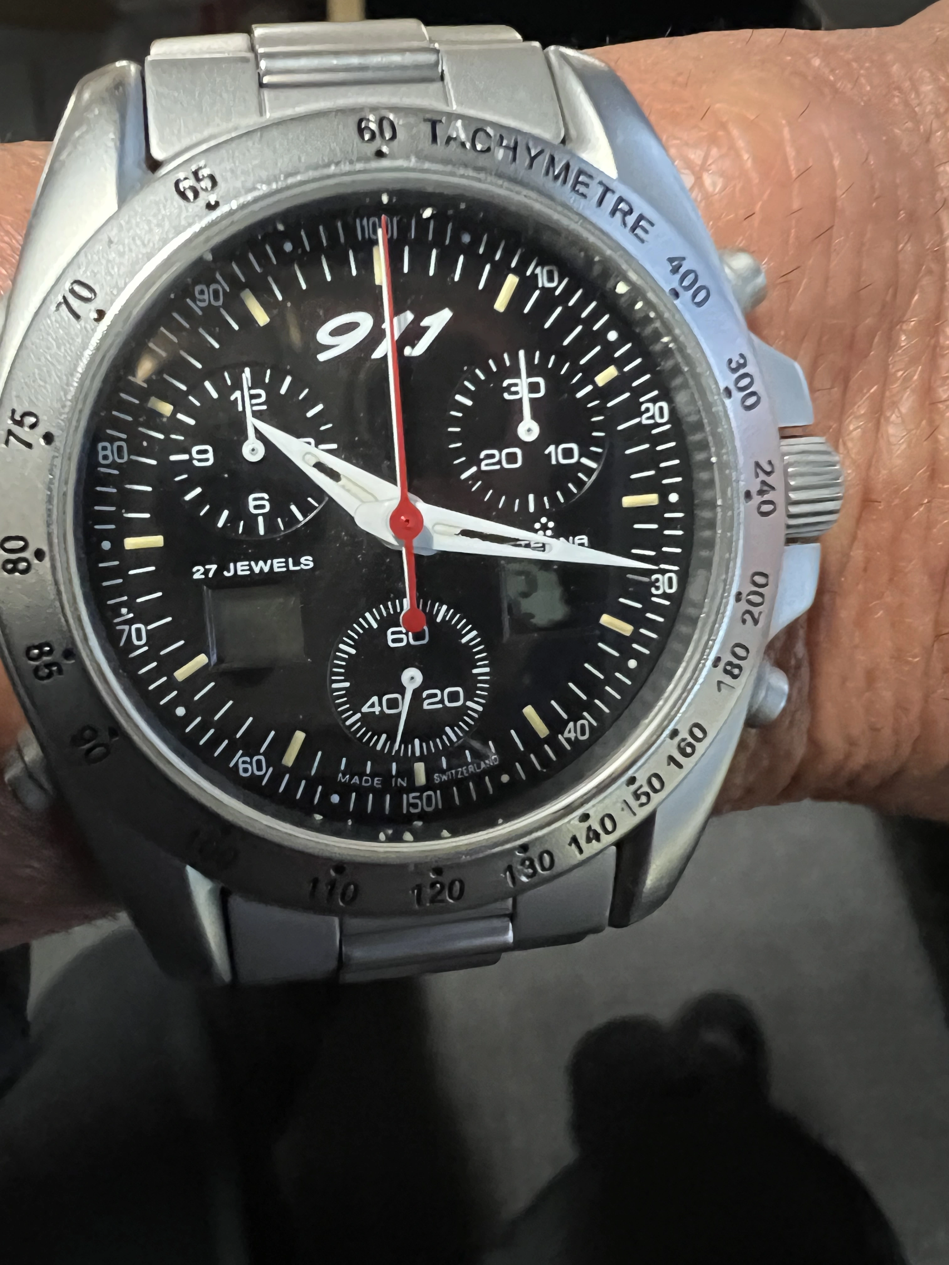

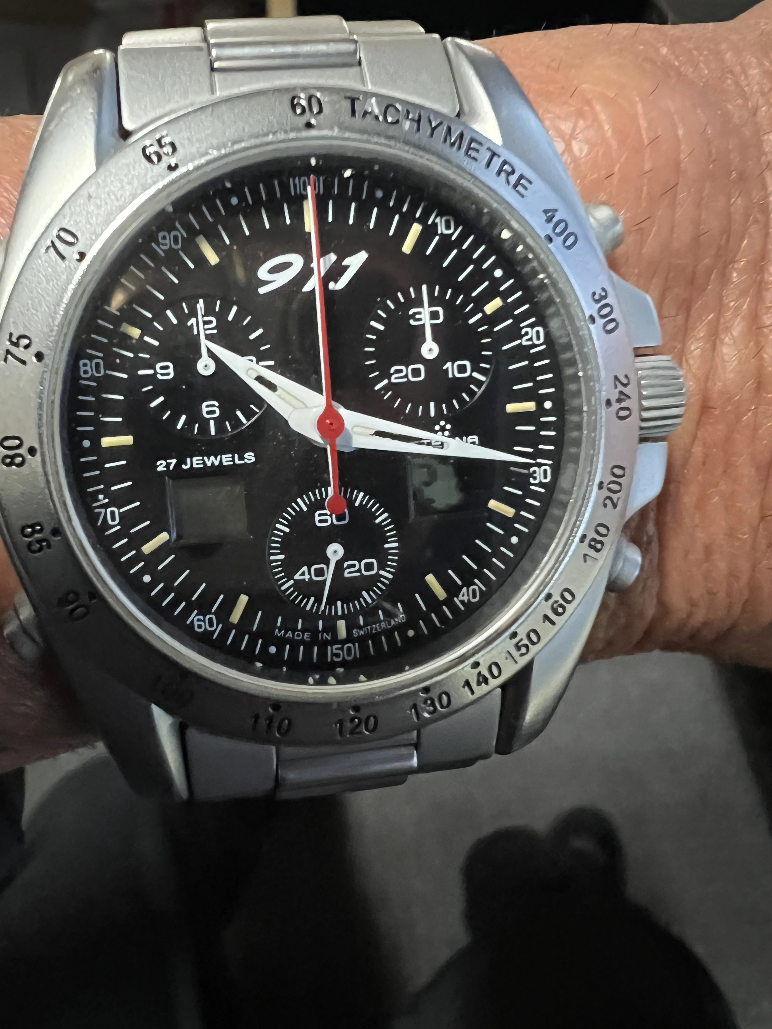

I could do it if I had it in my hands. Look up resetting chronograph on quartz watch and you should find the instructions. Interesting that the chronograph looks just like my old Porsche Eterna.

Hi Again,
thanks for assistance, just to say pull crown to second position and because my watch has four pushers each pusher controls one of the hands so holding in moves hand fast and single push advances one second at a time.
Everything now is synchronised and resets to zero (12 O'clock)

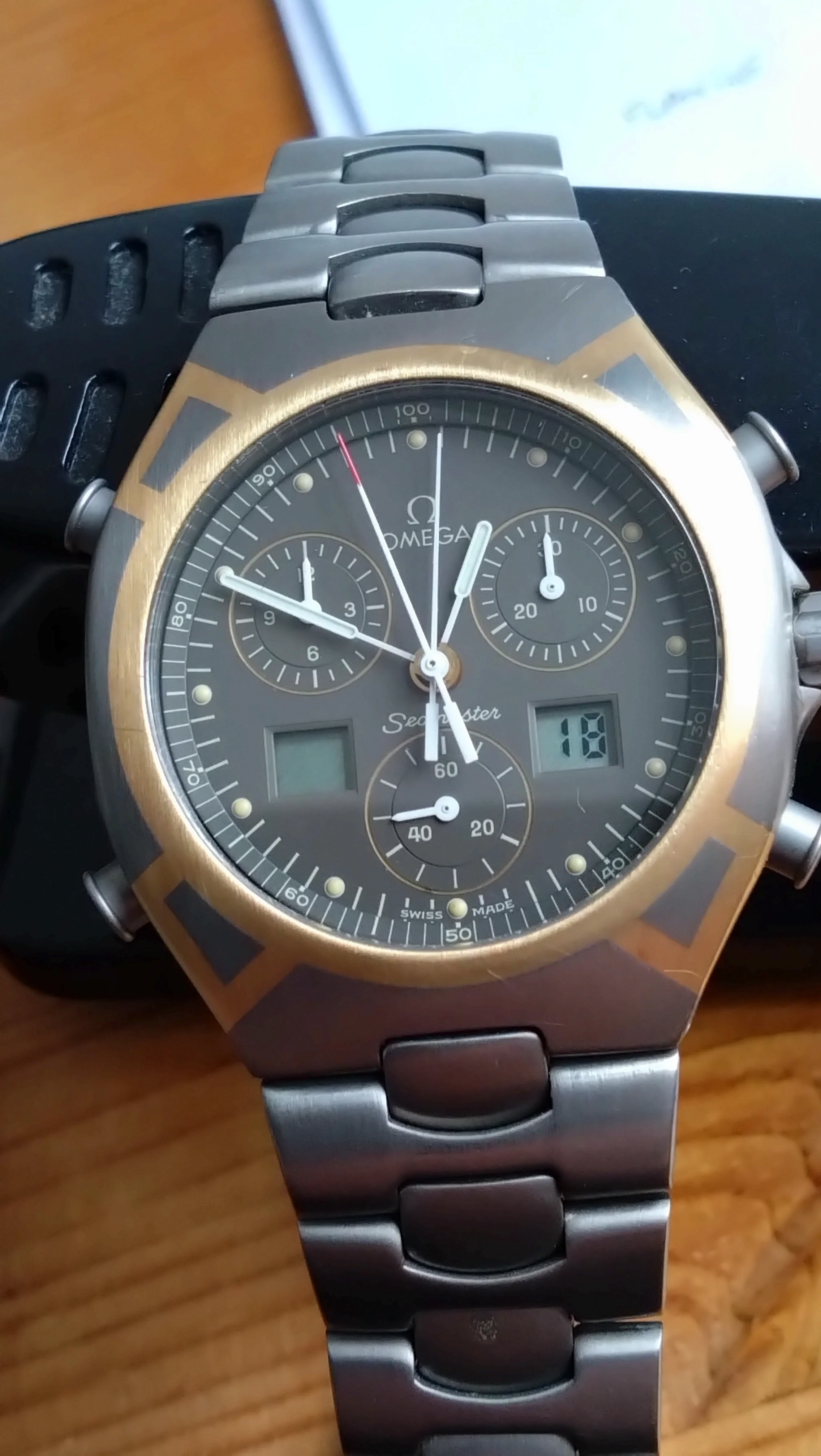

Hi All,
