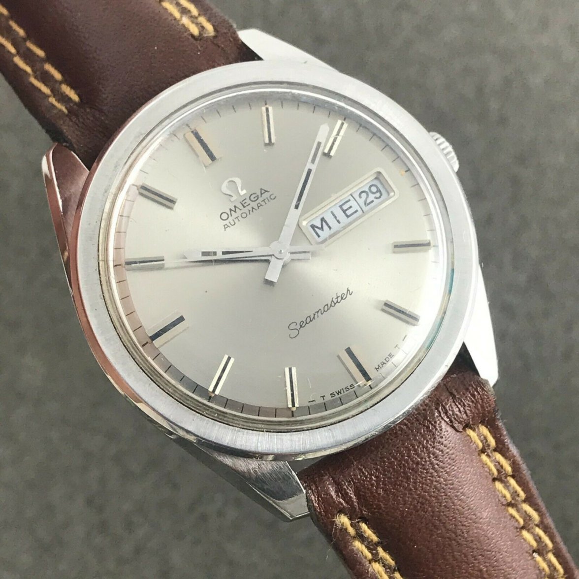

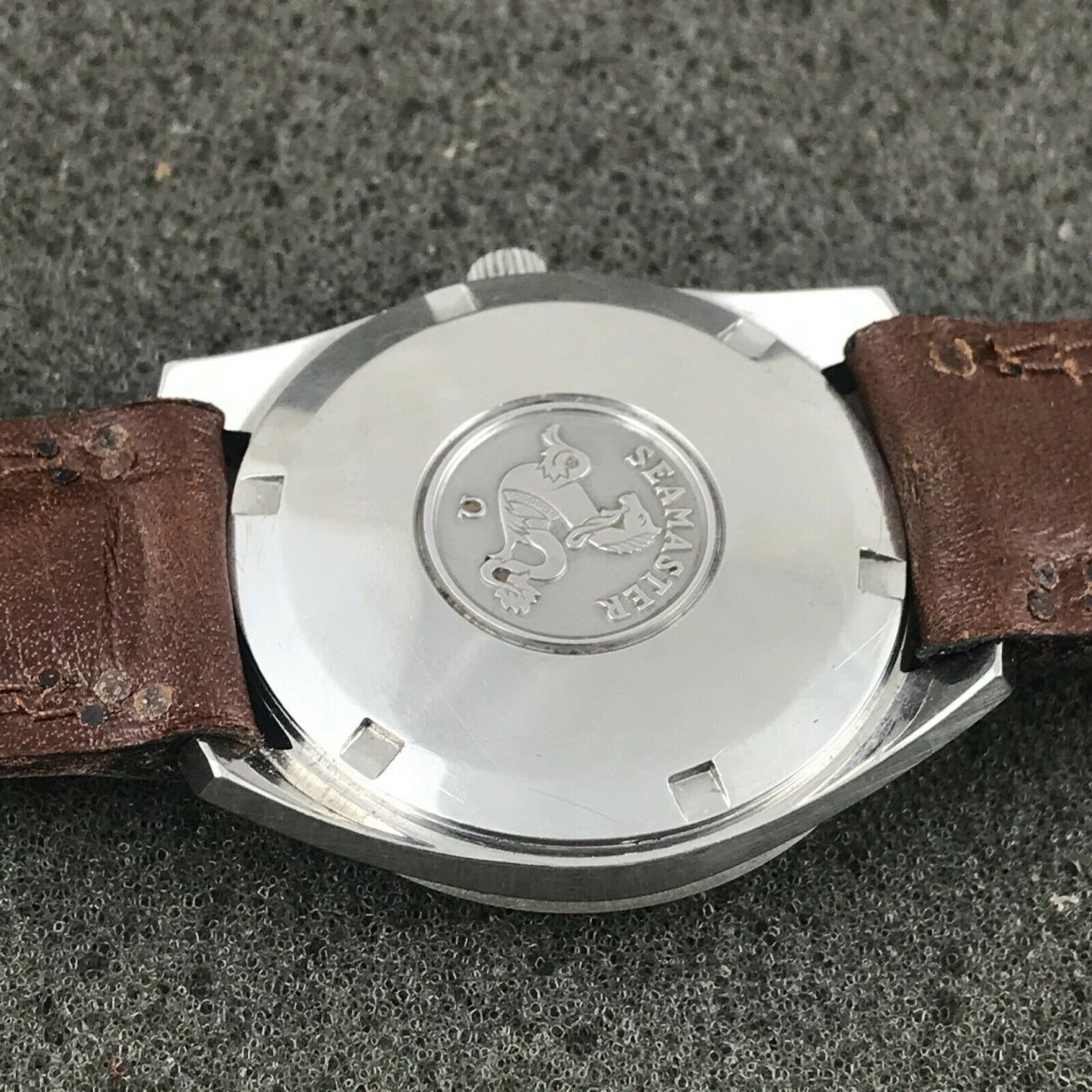

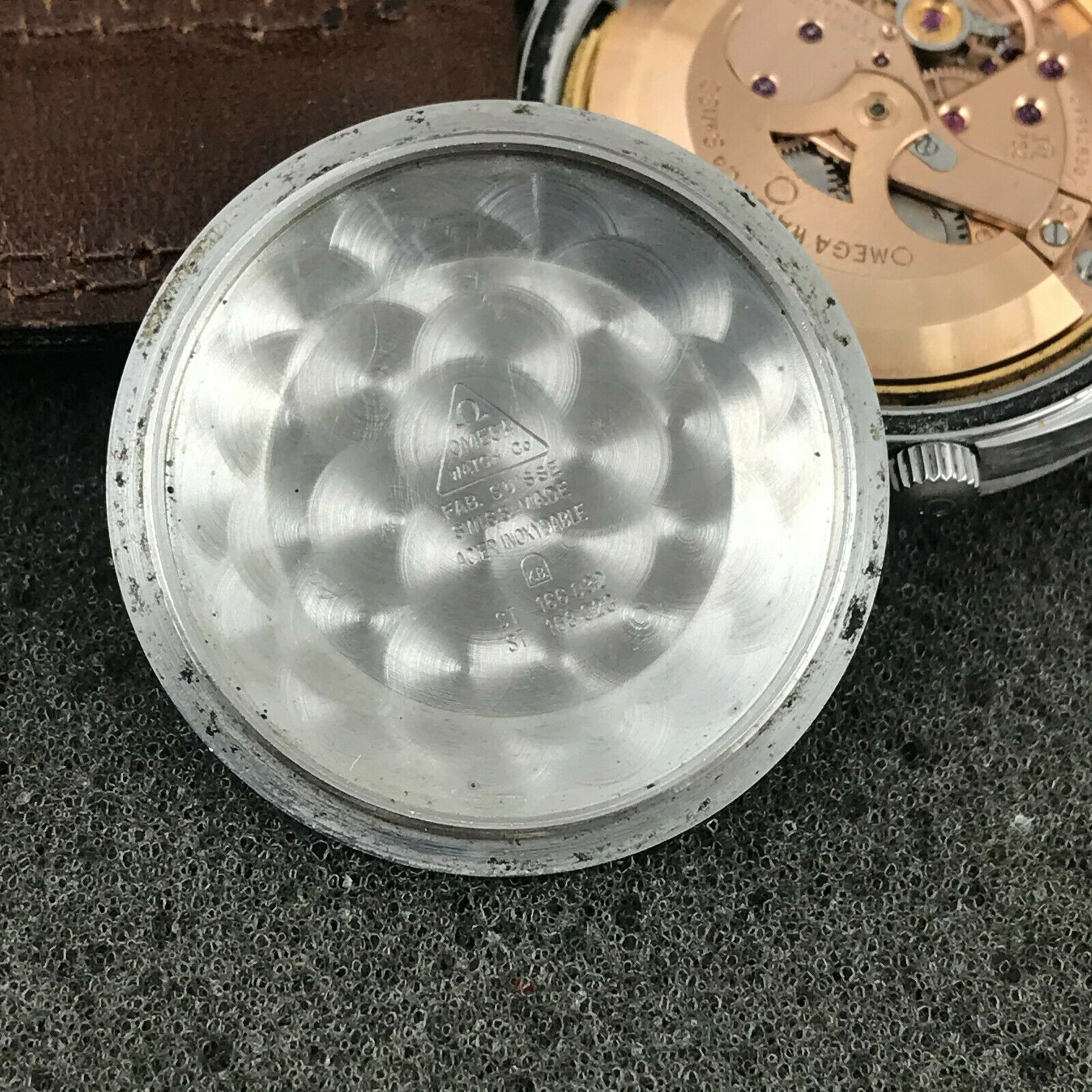

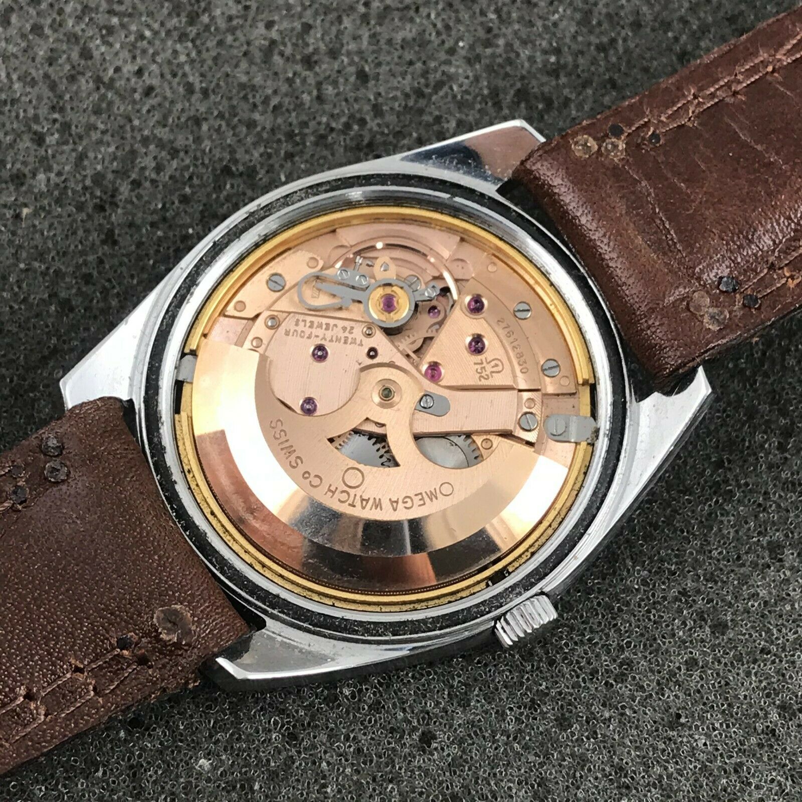

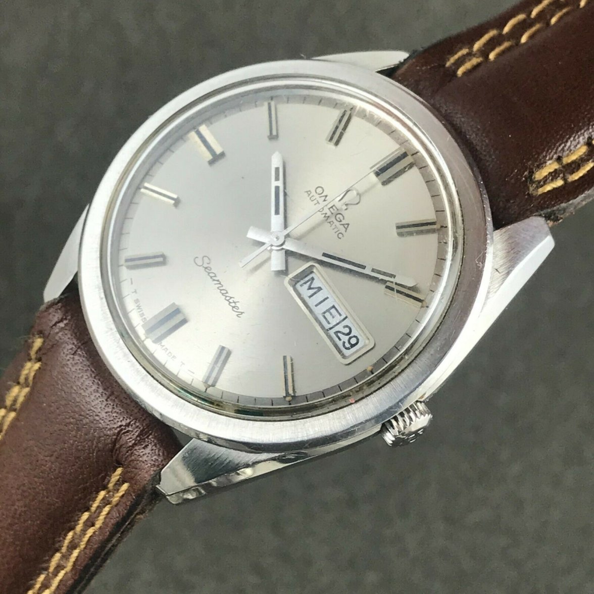

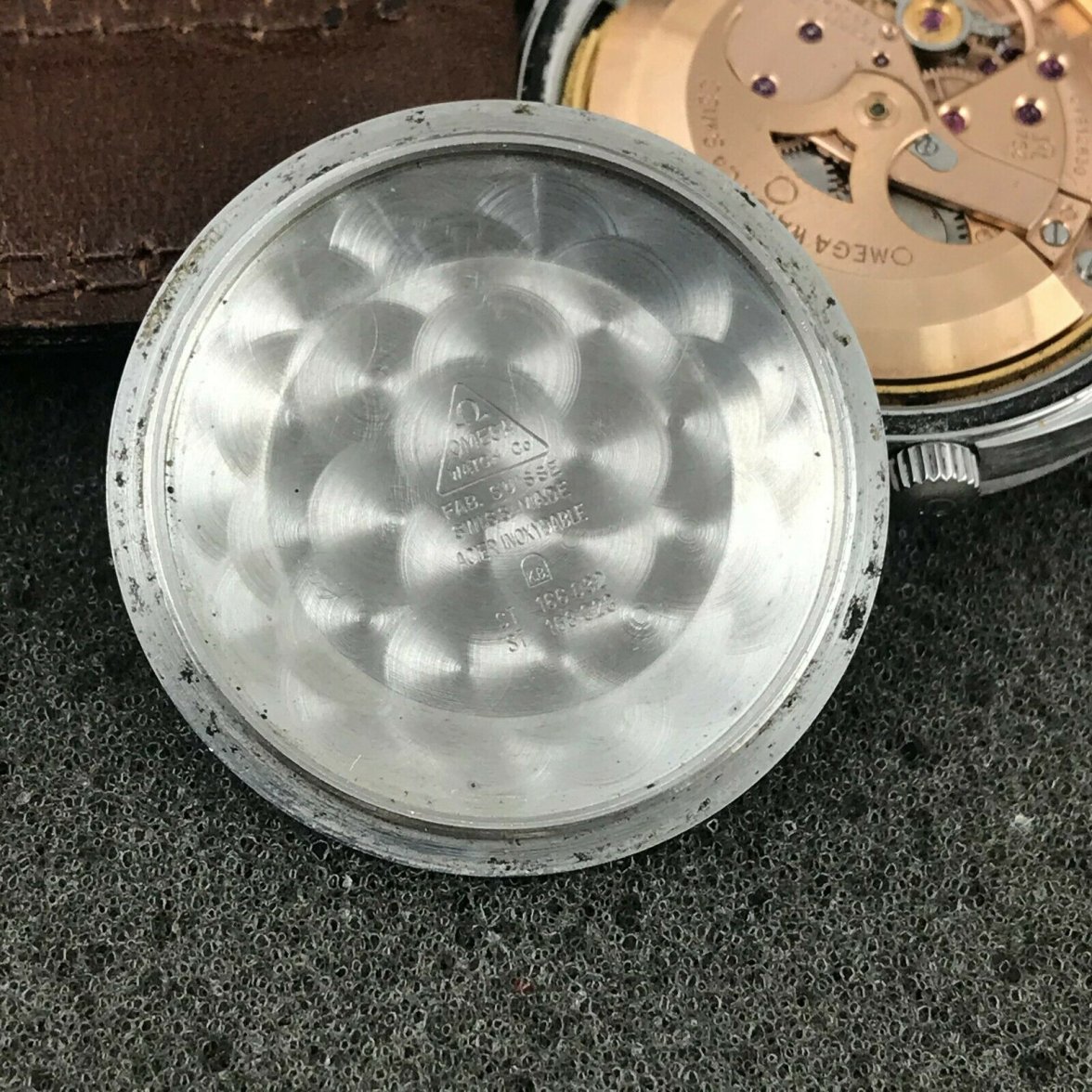

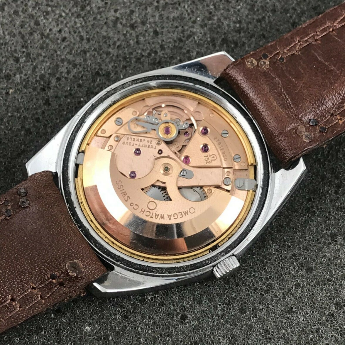

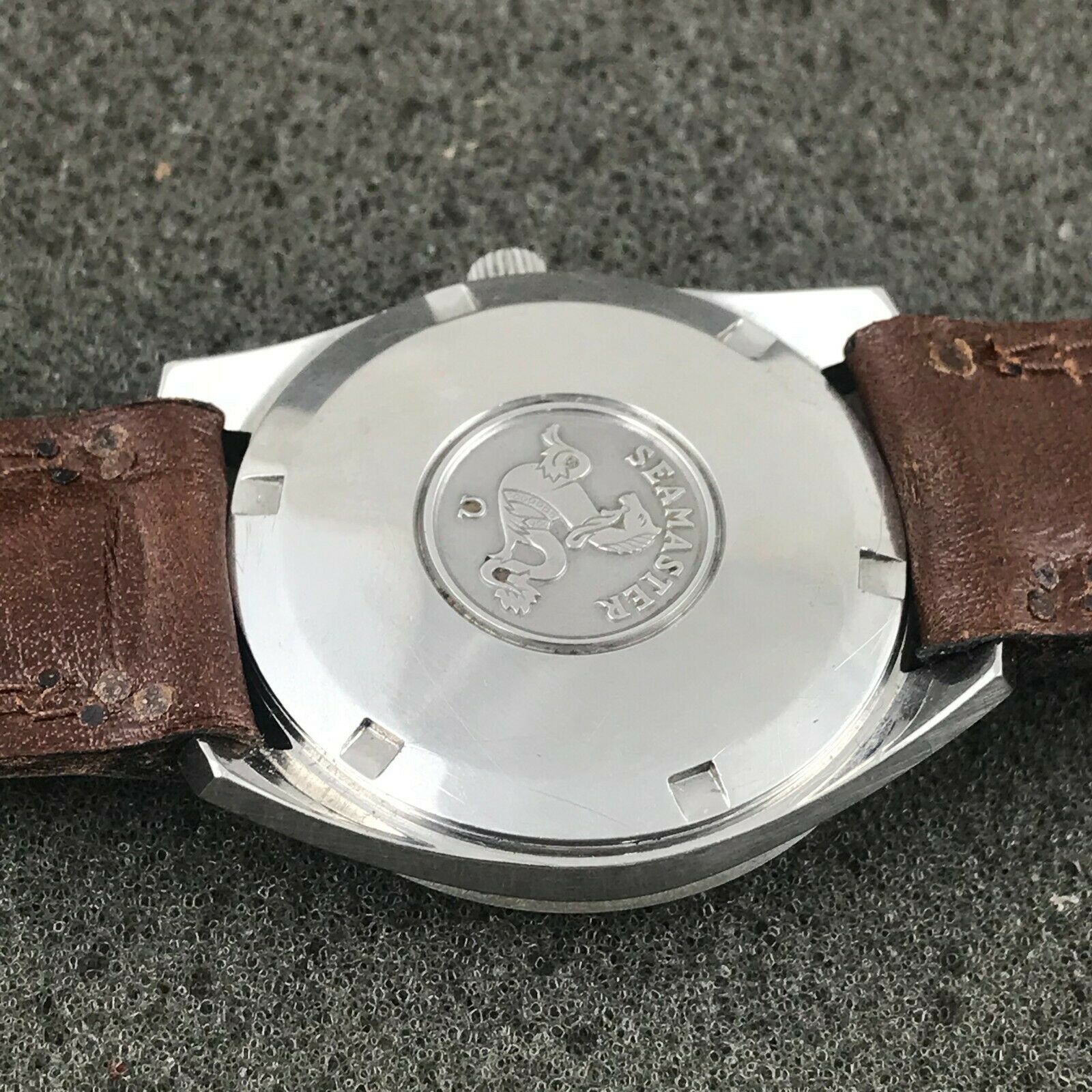

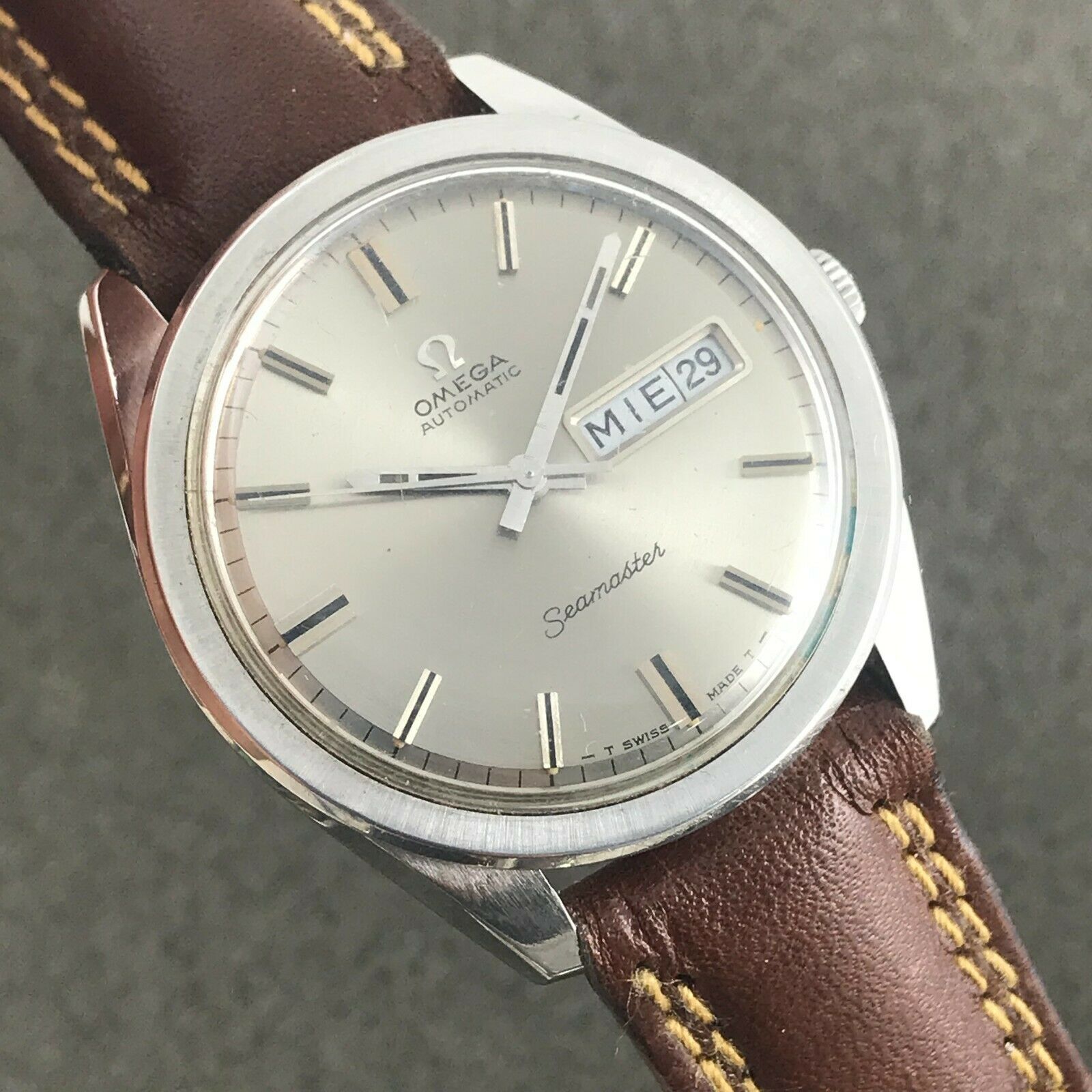

Hoping to get a few more sets of eyes on the seamaster below from the standpoint of authenticity (have 1 vote thus far for "seems alright"). Numbers seem to check out on the surface, and dial seems to be legit. Am I missing something? Would be happy to jump on this one if the OF stress test comes out clear.
327
441
Looks legit and correct to me, no red flags to my eyes. Case seems sharp. 752 movement is not as prized as 500 or 600 series, but I think this a great looking watch. I’m always a sucker for a foreign language day wheel.

I've done some digging on the history of the 5XX series, but would love to read more. Do you know of any good references that I can get into to learn more about the various calibers in detail?

This one is now mine! I'll be sure to post some pics once it arrives. Thanks to all for taking a good look and providing comments.

It does look well but the pics hide a lot of detail, hopefully not on purpose. This seems to be the flat grey dial variant, vs the sparkle? Have we not maybe discussed this very watch recently? Maybe not since I can't find it. It looks OK based on those pics

Err the 75X and 56X are the same movement but with day-date display added to the former. It is not the 55X movement people crave as such vs these, though some might understandably prefer a less cluttered dial. The 600 movements are manual wind versions of the 5XX so I am not sure people prefer those all that much vs these. Winding gets old.
I've come across a few of the threads on the sparkle (quite a few dedicated sparklers out there), but wasn't able to find much on the flat steel. Perhaps I missed them as well.

Although the 7xx watches seem to go for a bit less than the 5xx, I would have no problem getting one as it evolved from the same movement. If you are looking for value, the discount on the 7xx will give you an excellent in-house movement and leave a bit of money in your pocket.
