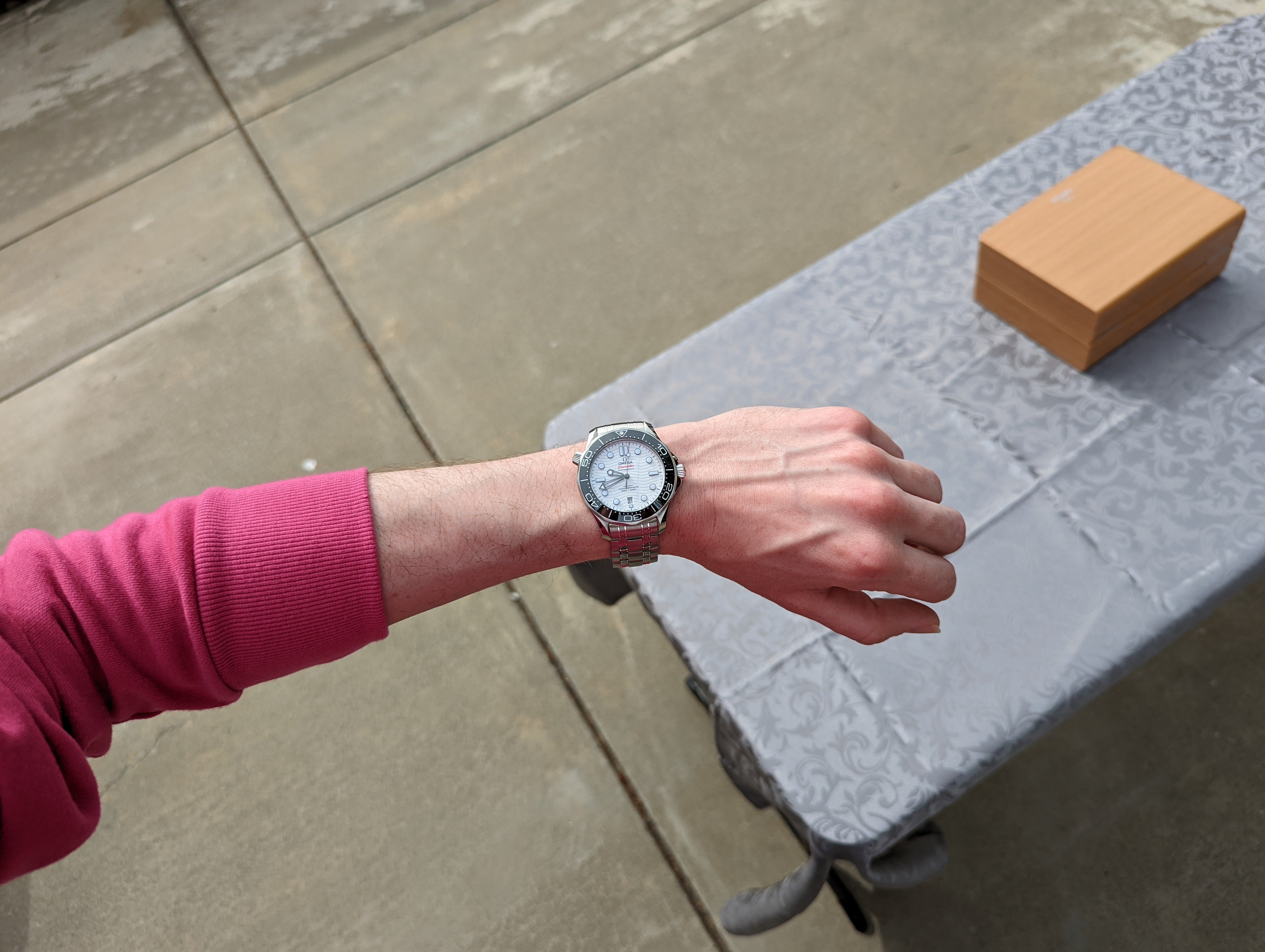

Hey All,
I searched and found results for older models but nothing with my symptoms with my generation watch.
I purchased my Diver 300M last May direct from the Omega website. It's an amazing watch and I have loved it every day since. Everything about it tingles my insides and I'm so fortunate to be able to have such an incredible time piece.
With that said . . . my watch normally runs ~2 sec fast every day. Perfectly normal, within specs and it's fine. HOWEVER, for the last 2 days now it's running 2 HOURS fast in 24 hours. I just adjusted it last night around 7pm and now at 8am it's 40min ahead. Looking online I would think the problem is it's been magnetized. I thought the current generation Diver 300M's were anti-magnetic? And I don't know how it would have gotten magnetized. Maybe I dropped it?
Does anyone know what would make a watch run this fast out of the blue? I'm going to take it to my local Omega boutique when I get a chance because the watch is basically useless at telling time at this point.

Confused....Sounds like you're fairly confident you didn't magnetize it, but you're not sure if you dropped it? Sounds like it would be the other way around. Hope you get it sorted out.

If you dropped it, the hairspring could have been twisted or distorted, which would also cause it to run so fast. Be honest - did you drop it or not. If so, that’s more likely the cause than magnetism.

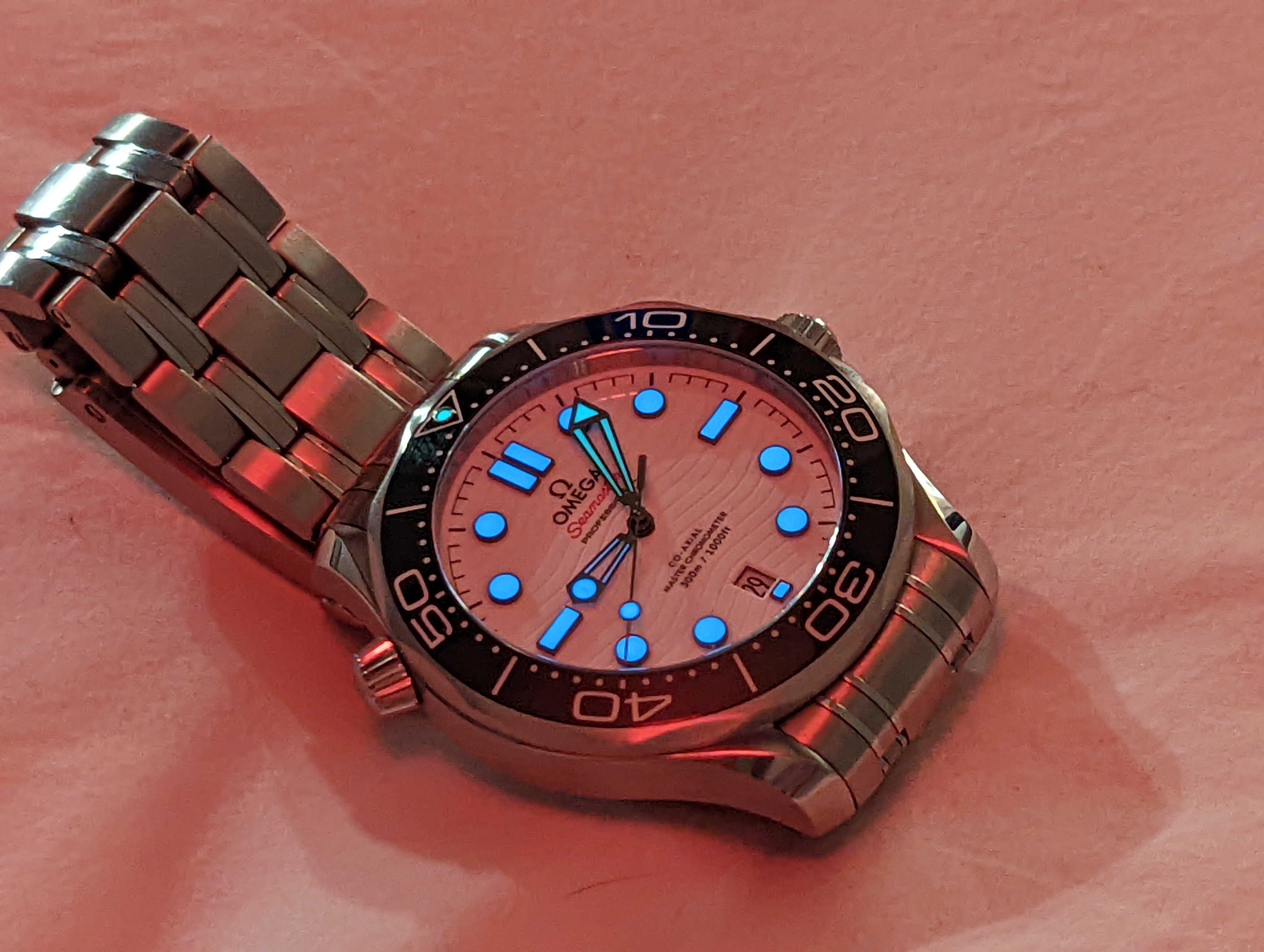

I appreciate the responses!
Two nights ago was a bit of an emotional night for my fiance and I and there was some drinking involved lol so I can't honestly say if I dropped it or not. I woke up and the watch was on the dining table but the bezel had been turned a few degrees which seemed suspicious. I have dropped it once or twice in the past(never a bad drop onto concrete, only short falls from the couch onto laminate flooring) and the watch handled it fine.
Really just curious what could cause it to run so fast. I'm going to take it to the boutique next wednesday and see what they say. I'm leaving for vacation to Italy next Friday and it would be a bummer if I didn't have my watch for the trip.

I’d prepare yourself, emotionally, not to have your watch on the trip. If it’s a magnetization issue, that’s a 5-second fix. But these watches are so antimagnetic, that’s unlikely to the point of almost impossible. Far more likely that it’s an issue requiring a proper service intervention, which is not something the boutique is going to be able to do while you wait. Sorry to bum you out, but it’s likely the watch will be out of your hands for a couple months…

It's possible that a tiny bit of oil stuck one coil of the hairspring to an adjacent coil temporarily. That essentially makes a much shorter pendulum/oscillator with a correspondingly shorter period. When the coils become separated again the watch resumes It's former rate.

Assuming the picture and watch are authentic, that MASTER CHRONOMETER cannot be magnetized. One of its many selling points. Even the steel alloy case will not adhere to a magnet. Try it. Won't happen.

Agree with Donn's statement here. Highly, highly unlikely it's magnetized

There are some older threads about drops or other shocks causing the hairspring to get temporarily "hung up" and causing similar issues gaining time until the issue is resolved.
