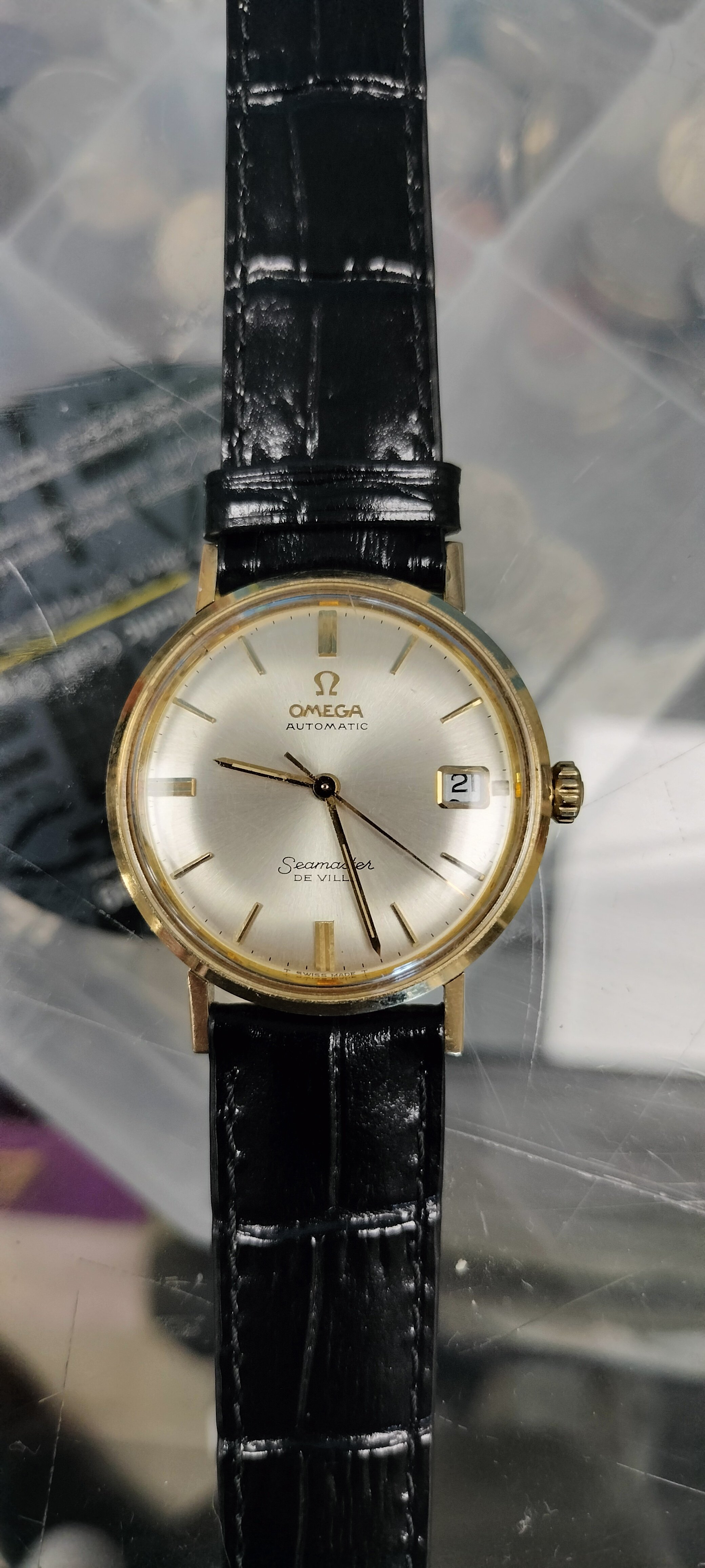

Hi All,
I'm still learning about vintage Omega. It looks like I may have found a good Seamaster DeVille solid 14k Gold locally at a good price.
Everything looks good to me clean dial, hands look correct, crown looks original (and signed Omega), and case has good corners so it hasn't been over polished.
Am I missing anything? Is there anything else I should look at closer before trying to make a deal?

I’m new to this game but will give it a go: The position of the date within the date window relative to the time would perhaps imply that they aren’t calibrated correctly. Also the lumed hands but unlumed indices could be an issue… but I would ignore my apprentice level understanding and wait for more expert opinions.

Do you have any better pictures of the front. It looks ok at a glance but the resolution on the photos is poor.
@Makesbelieve makes a valid point about the hands possibly being replaced but this type of dial does sometimes have very small lume got at the tips of the hour markers so they hands could be correct.

click on picture!
now you can see the dial has T’s and small lume wells at the ends of the markers so it’s likely the hands are original

Since no one is screaming fake, redial, wrong hand, etc I'm assuming that's a passive thumbs up. Is that correct?
Just looking for reassurance since.i know it's easy to make a mistake with vintage.

Definitely not a fake. Condition pretty good for a gold case. Dial ok and hands probably original. Not a big deal but cannot see the crystal is signed in the middle so may be a replacement.
Always allow for cost of a service on top of the asking price and especially given the off-centre date and no movement pictures.

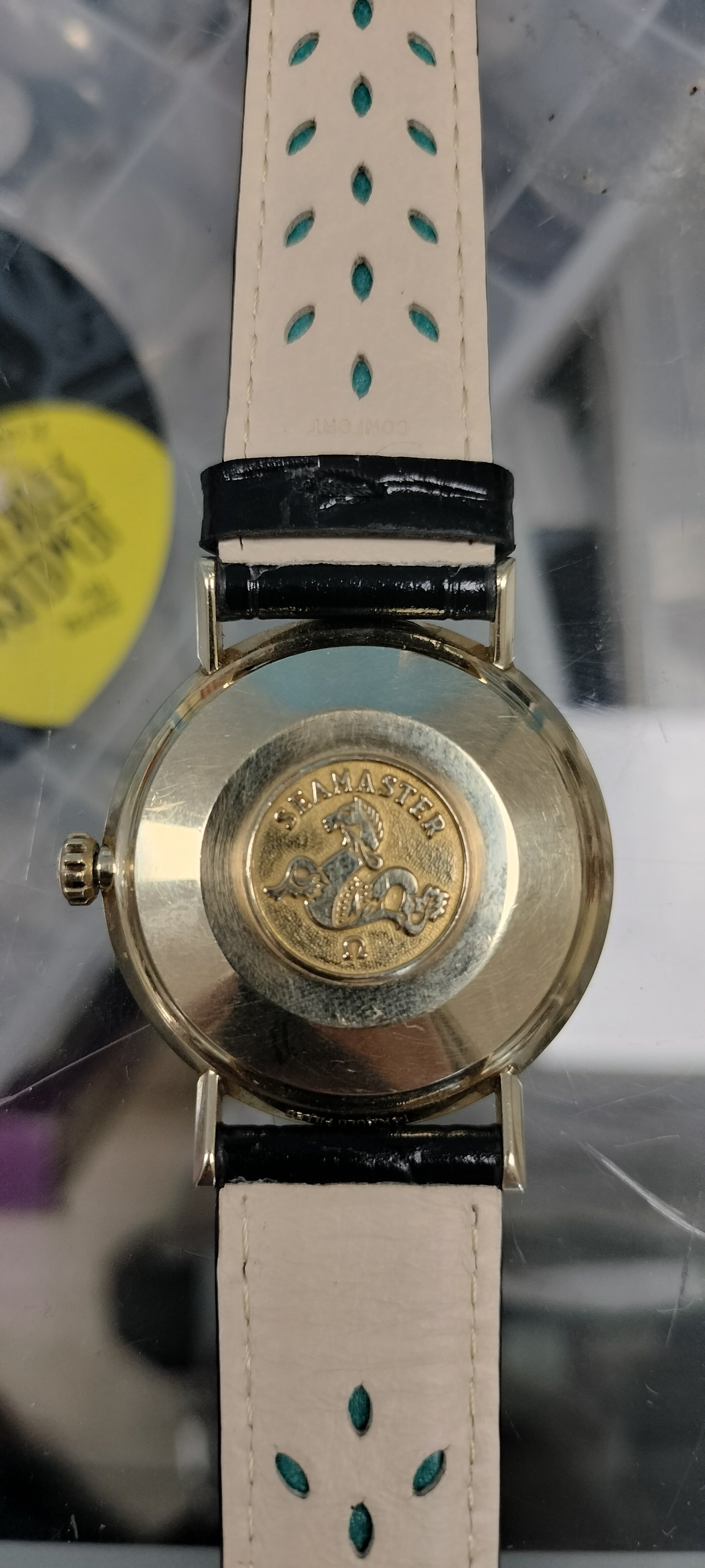

The caseback looks like stainless on the photo outside of the medalion- unless its just the light?
Edit: Actually I think its a 1 piece case so it must just be the lighting....
