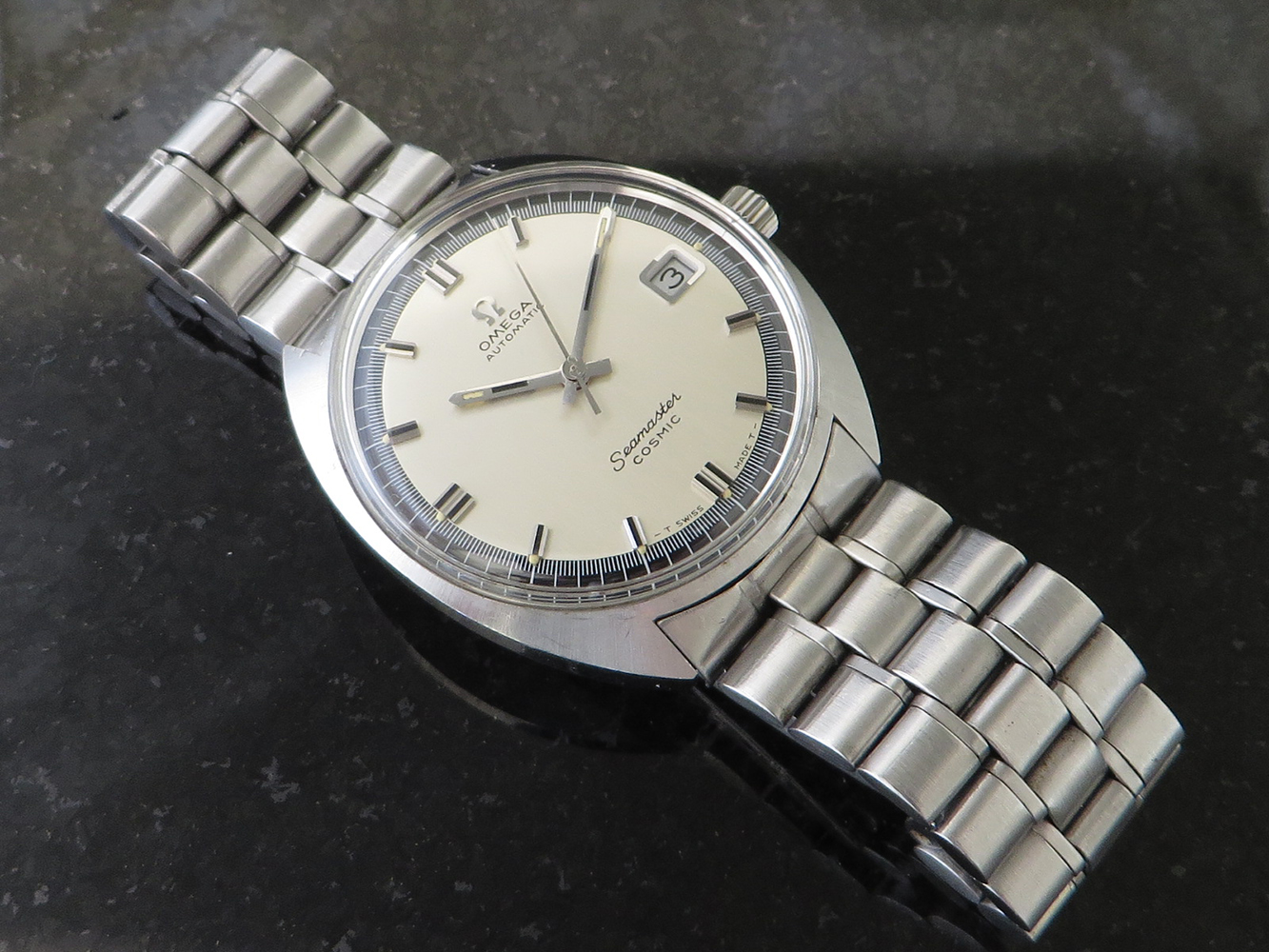

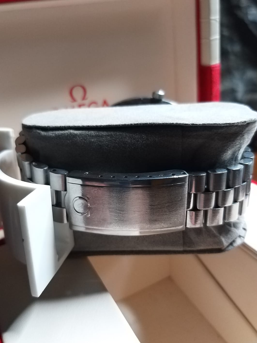

hi guys, i m spending much time to find my third Omega s watch.
I d like to have a your impression and value for this Seamaster Cosmic offered me by a watchmaker.
-Bracelet After market (no code, is it possible original?)
- Crystal original with logo
- Moviment 752 automatic (24 months warrenty by the seller)
- Aftermarket box
It seems in a good general state (have 50 years)
I ll have internal photos next week.
What is its value for you?
Thanks and have a nice Sunday
804
897
I will let others chime in who are more experienced.
- I don't think the band is correct for that watch. Look at the end links. Do your own research to see if the band is correct (ask the seller for the band model and endlink numbers and reference those with what is appropriate for that watch - Google is your friend)
- Factor in a service of $250-500 USD in the next few years. Forget what the seller says about the watch "running strong" etc....
- Do you trust the seller to be around in 24 months/honor the warranty?
- I'd want to see better pictures of the band
- IF everything checked out, I'd say $400-1000 USD would be fair

- yes, as I said, bracelet is not correct, but aftermarket (with no code omega, but sellers said me that it s original, strange...)
- the seller is a watchmaker, so he give me 24 warranty months becouse he service it and the moviment.
- he have a physical shop, so I think he should be a serious seller
He ll send me other photos about bracelet and moviment.
I ll post there as soon as possible.
Thanks for your support

The Bracelet is probably an original Omega Bracelet which doesn't mean it's the correct one for this Reference. The correct Endlinks would be 529 for a 7 links BOR Bracelet

But it s normal that it haven’t the code under claps? Could it be original at the same?

It isn't unheard of for clasps to miss any ref. marking. This one doesn't look like any Omega bracelet I have seen before...
Compare it to the one @X350 XJR shows above; it looks like the end links are the same, but the one in your post is narrower and doesn't have the same width as the end link.

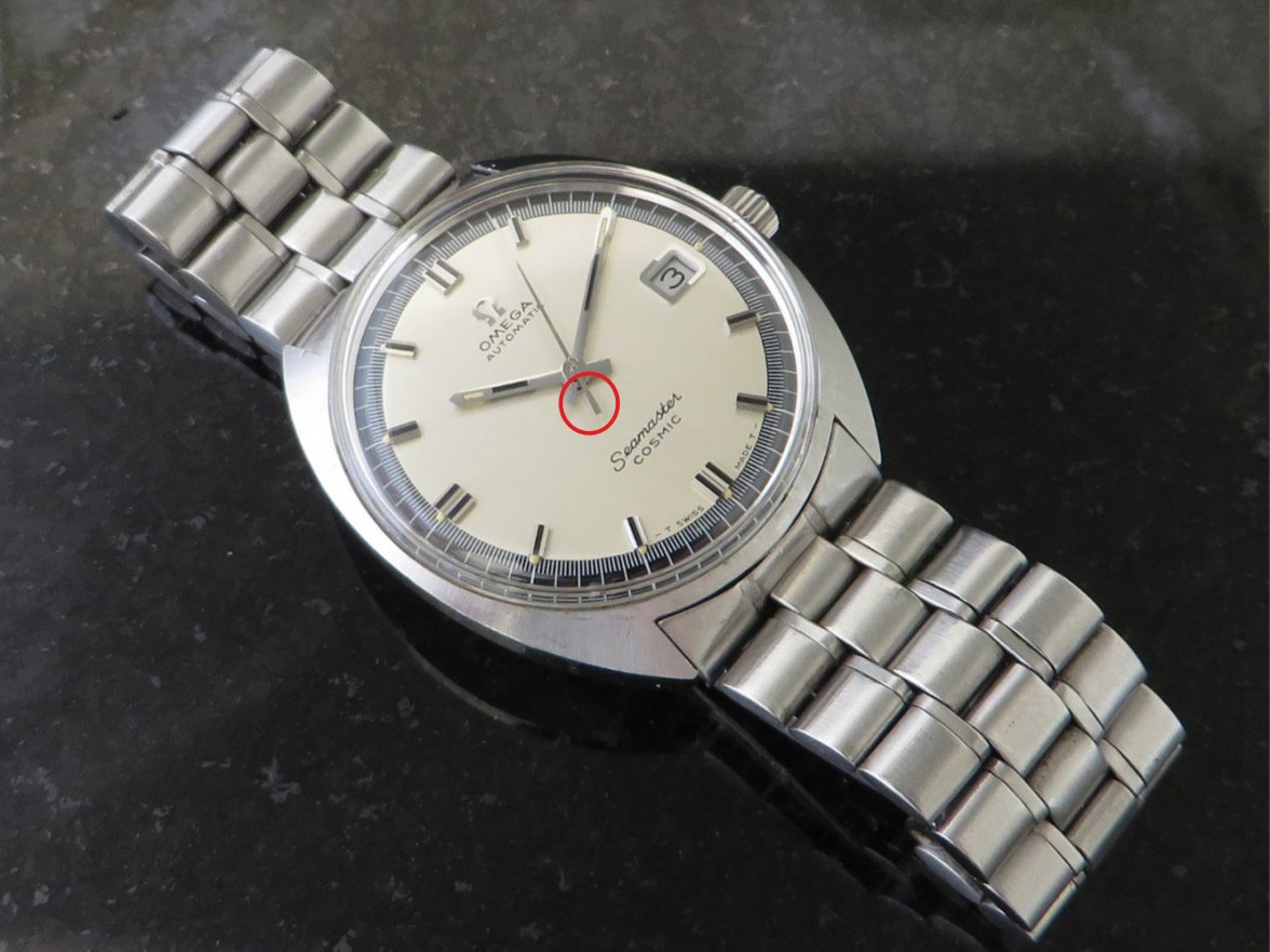

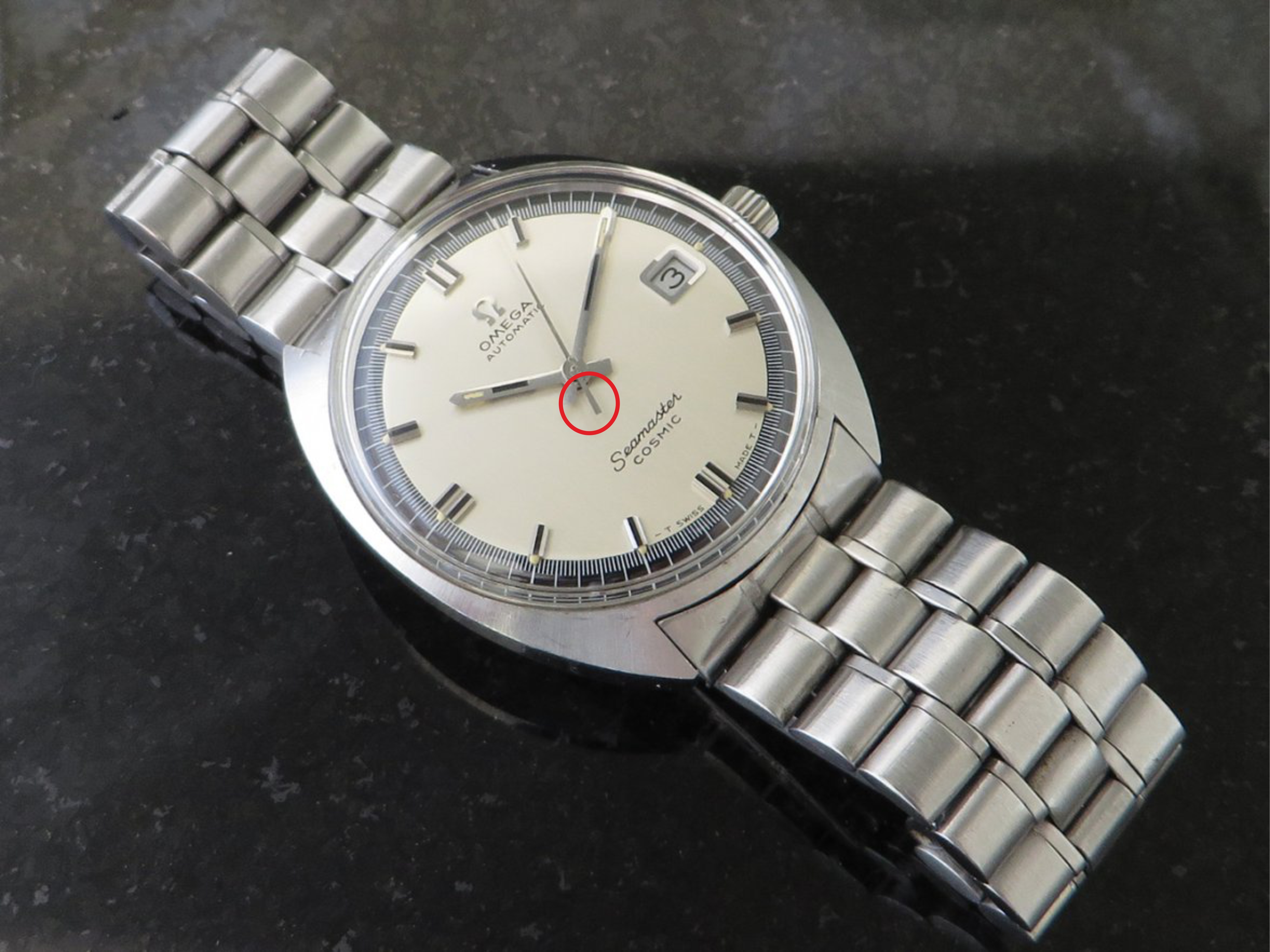

The watch looks really tired to me and I wonder what happened to the tail of the second hand (is it there?). The bracelet questions don't improve my personal impression about the watch...

Hi, what do u mean about the tail of the second hand?
I m a beginner, every observation that could Help me, it a good lesson.
Do you talk about your personal opinion when you say tired?

I can't see this in your pictures (marked it in the picture @X350 XJR posted above:
"Tired" is my personal impression when I look at the watch, yes. The case looks pretty worn, the dial is a bit dirty and the tritium lume on dial and hands has faded to dark grey.

Very nice observation.
That watch seems have many issues, so I starting to know becouse the price is lower than similar models.
I ll wait the other photos, ll ask to the seller my dubts and ll value at the final to I d buy it too.
I update the thread as soon as possible.
Thanks to help me, you are very special passionate
