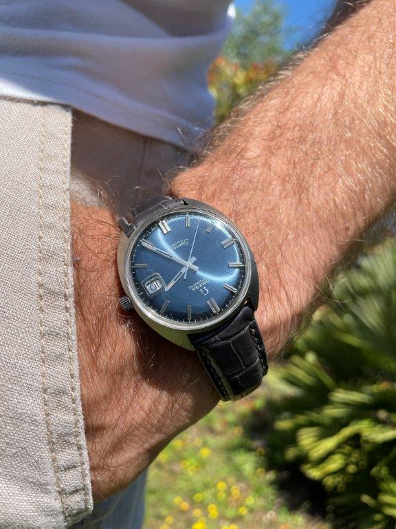

i have a Seamaster Cosmic 166026 and the date setting is a bit special compared to my other watches.
I was wondering if there was a user guide at the time for this watch?

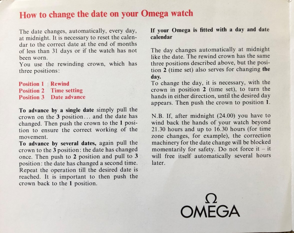

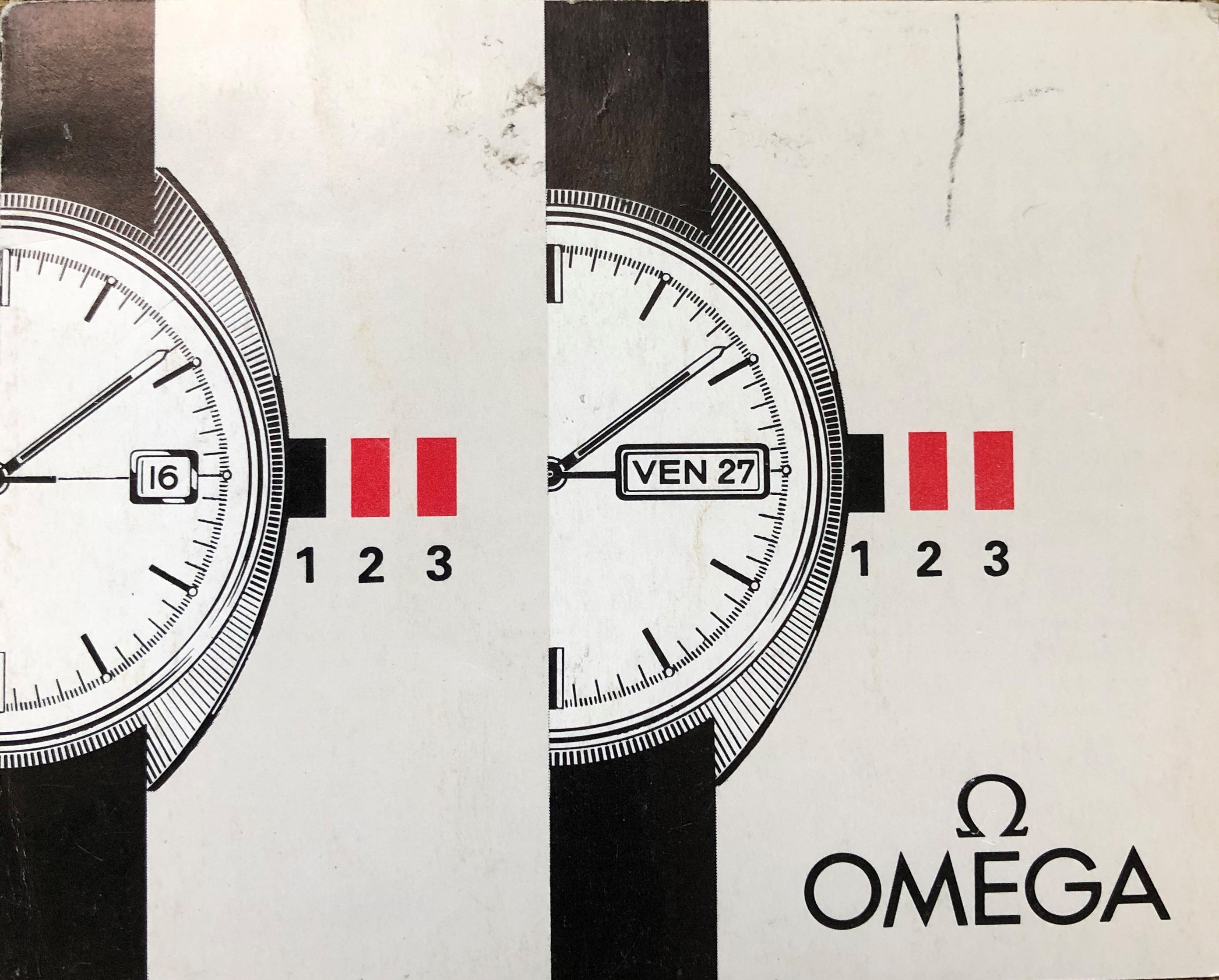

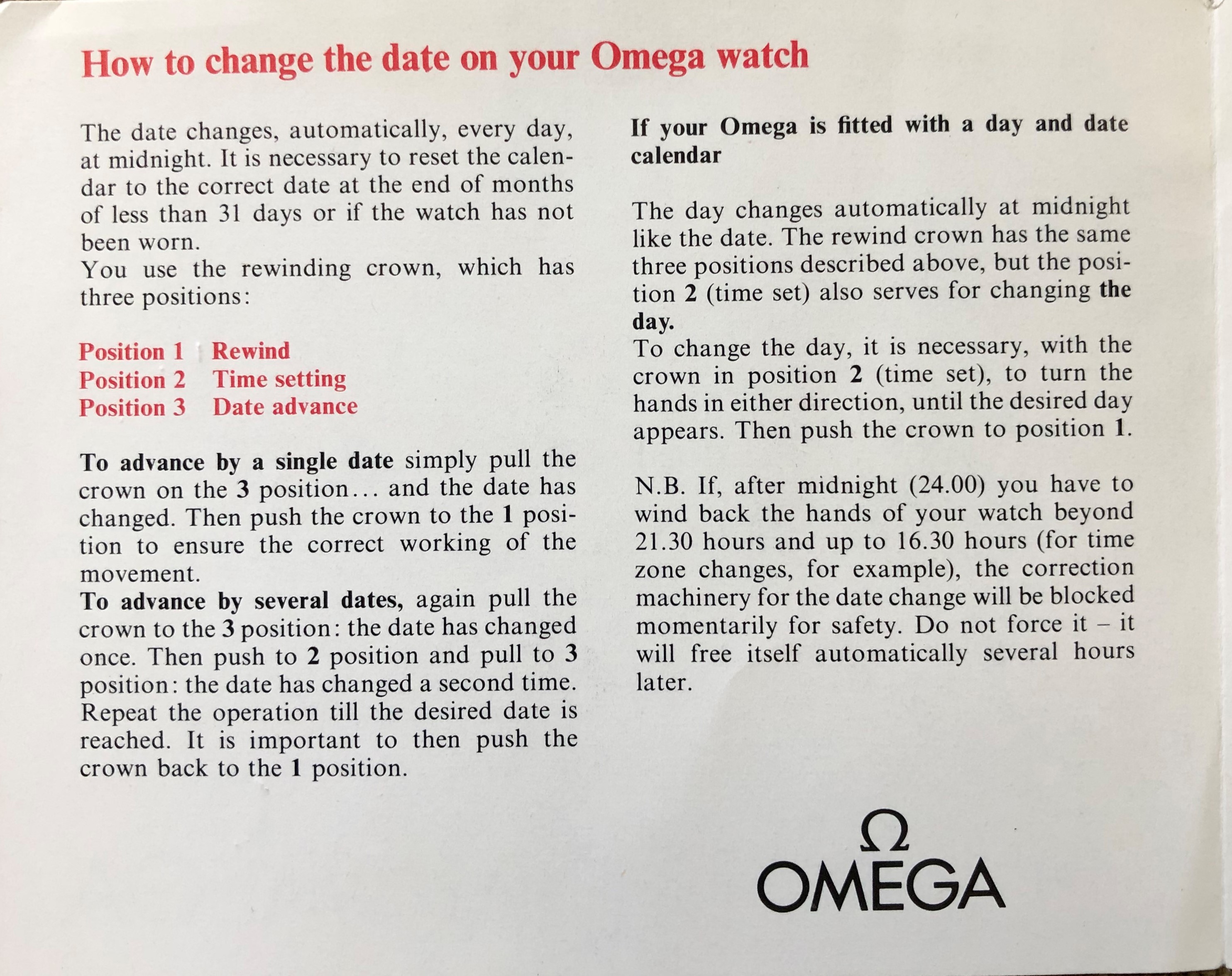

Here's a photo of a vintage user guide that describes the quickset date for these. My Omega with this feature was recently serviced, and the date setting takes very little effort, so I haven't worried about it, other than making sure I'm not updating the date anywhere near midnight.

It can be, depending on a few things. The original design of this could cause damage to the date indicator if the quick set was used when the date change was already in progress. Later, changes were made to make this damage less likely, and the change to those parts is a mandatory upgrade by Omega.
Many local watchmakers don’t do this upgrade and may not be aware of it even, as I still do this upgrade quite frequently on watches that come to me.
The safest way is to set the hands to a known safe time, like 6:30, and then quick set the date to the day before the one you want, then advance the hands to the correct date and time.
