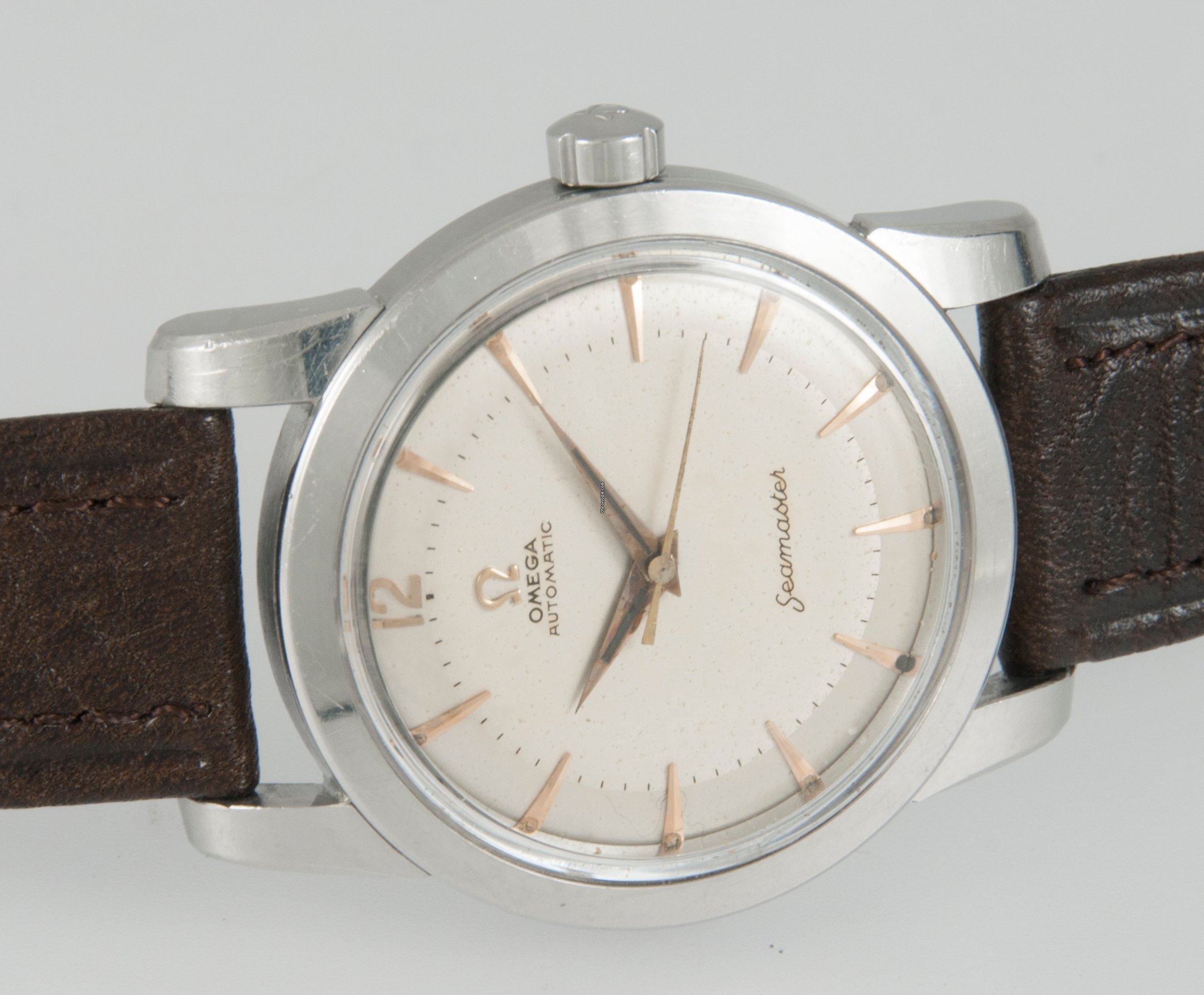

So I am looking through some seamasters and found this.
The dial looks good. Patinated, and the text looked original. then i noticed there is no swiss or swiss made on the dial.
Is this a redial? Or is it just to old for the swiss to be present?
Thanks for any insight.

I'd say it's likely there but hidden by the reflector ring which seems overly close to the hour figures.

Mine isn’t a redial and, interestingly from my perspective, it only has a '12' numeral, like the watch in your post. I’ve seen very few with just a '12’. I don’t think it makes these any more valuable, just a bit rarer.

What is the ref your watch?
