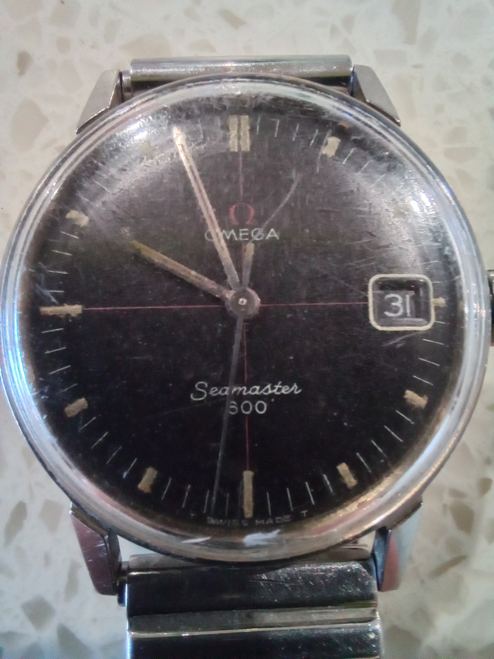

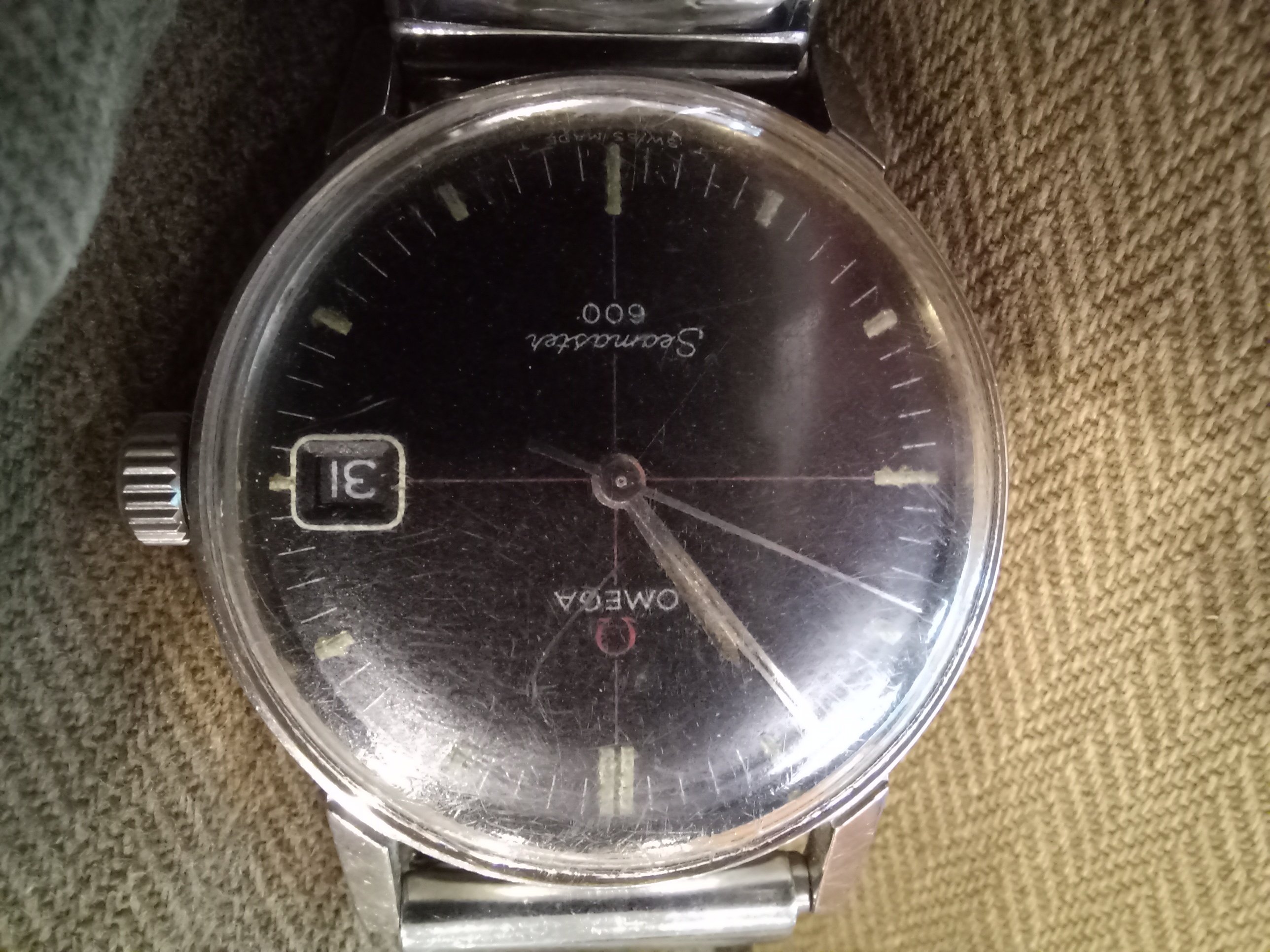

Hello everyone,
This is my first post on any watch forum.
I'm hoping to find information about my late fathers watch.
It is a manual wind with date at 3 o clock. Red cross-hairs and nice raised back. The pics were taken with my phone.

Do a search for "Omega Seamaster technical dial".
Cool watch, should clean up nicely.
16,305
45,025
Welcome @Exurbia
Sorry about the loss of your father- that watch is a nice keepsake. It’s one of the rarer variants of its time, as @X350 XJR mentioned, it is of a series of watches that were referred to as “technical dials”. As for information about it- it dates to the mid- late 60’s, probably has a 600 series movement and is a nice daily wear once you get it serviced by an independent watchmaker who knows vintage Omegas. They aren’t difficult to service, but parts are only available to watchmakers who have an Omega parts account.

Thank you JW And XJR,
When I get home this arvo I'll ask the nice "Mr Google" to help me find the technical dials.
When serviced should I have the glass replaced?
Cheers,
Peter.
384
593

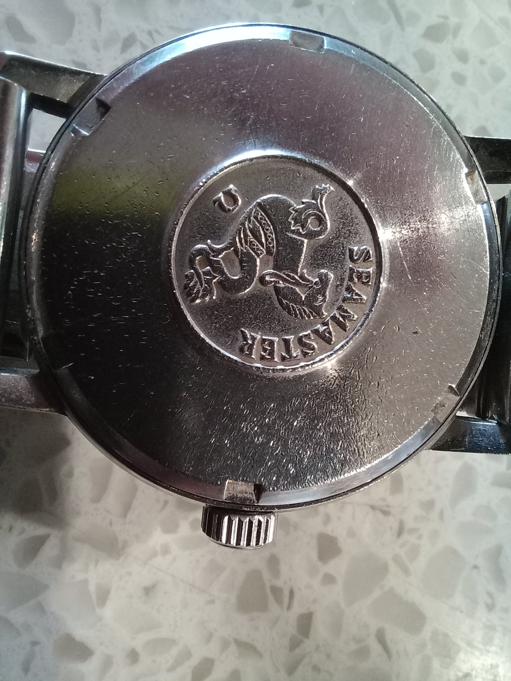

If it hasn't been serviced in a while then it will need cleaning and oiling BUT do not let them polish the case or mess with the dial and hands. Originality is important! If you do get it looked at then ask them to write down the serial number (it's on the movement). You can date it from that.
To be honest it's a great watch and will look immeasurably better for simply fitting a new crystal (the plastic lens over the dial).

Lovely example from the 600 series.
Only two things wrong with it.
It's a date model (I like the no-date)
and
It's not mine 😁
Basic instructions for your watchmaker.
Carefully disassemble.
Clean case and caseback in ultrasonic after removing crystal.
Clean, inspect, assemble/lubricate/regulate/adjust movement.
Fit new crystal if the original can't be polished or if it displays sub-surface crazing.
Pretty basic requirements.
It's important that you try to keep as much originality as possible so no buffing/polishing unless the watchmaker is highly skilled at this art.

hi and welcome to OF, it looks like a really nice watch you inherited - always a good way to remember your dad.
I would recommend a service and a new crystal and then just listen to all the other comments they know what they are talking about
1,126
1,731
That is a nice 136.011. The glass can be polished and does not need to be replaced!

welcome to OF. i saw one before like the one you have. if you notice the dial esp the indices and the sword/batton hands are patterned/designed after the speedmaster. being a 600m sm too makes it more desirable. enjoy.

Looks ok to me. There are two versions of this dial, one with the older style ‘flat foot’ logo and one with the modern logo like you have.
