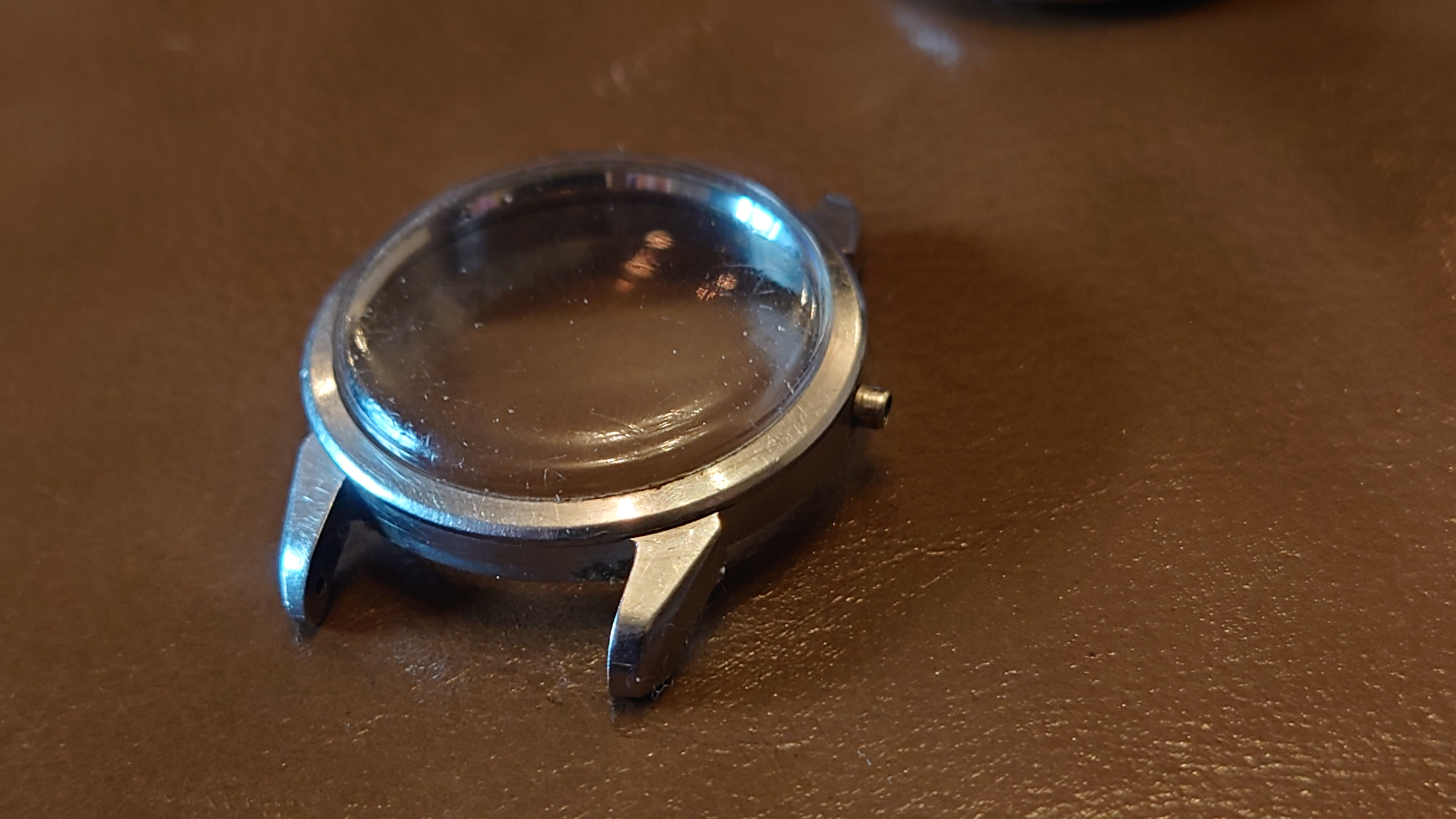

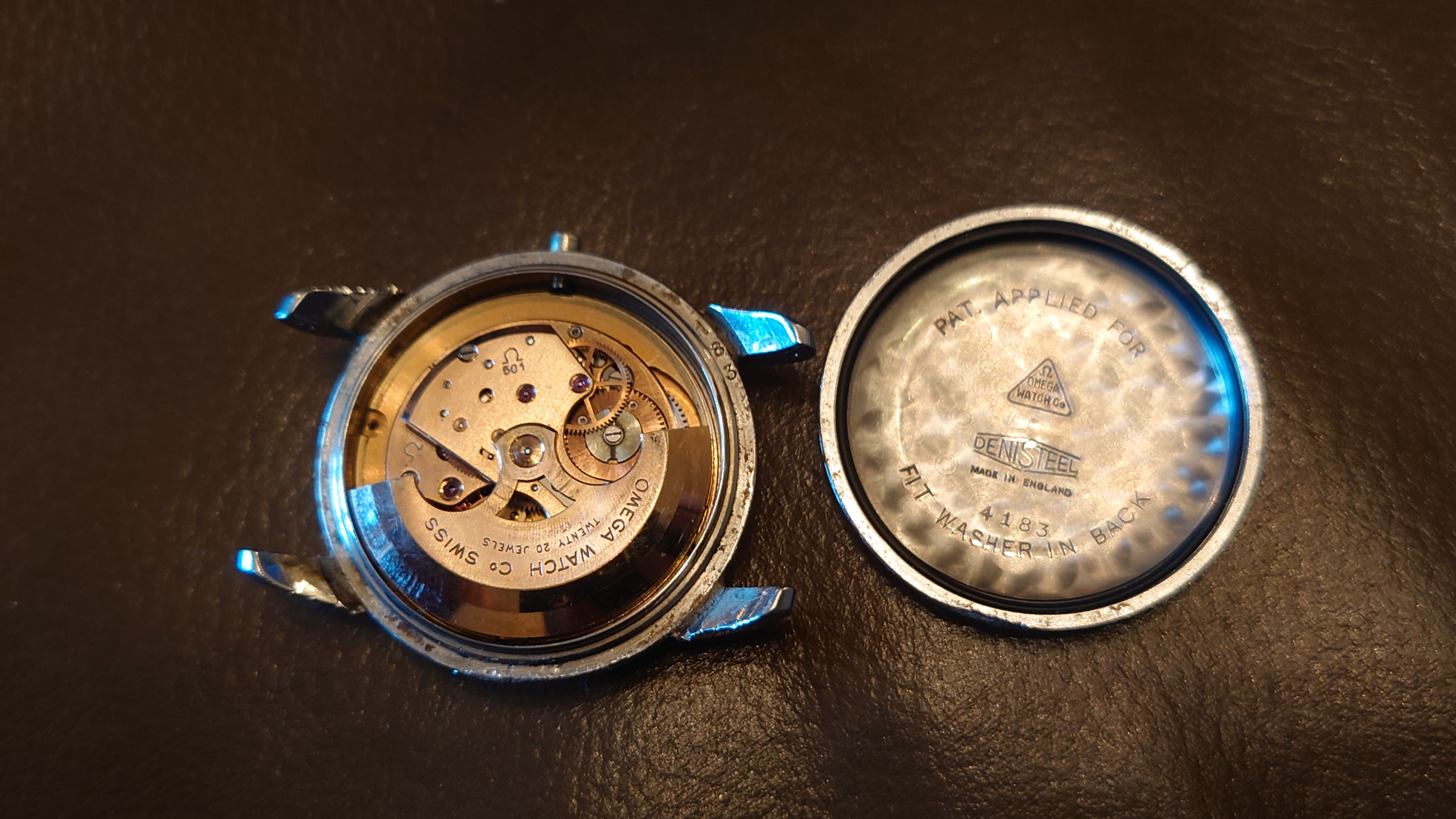

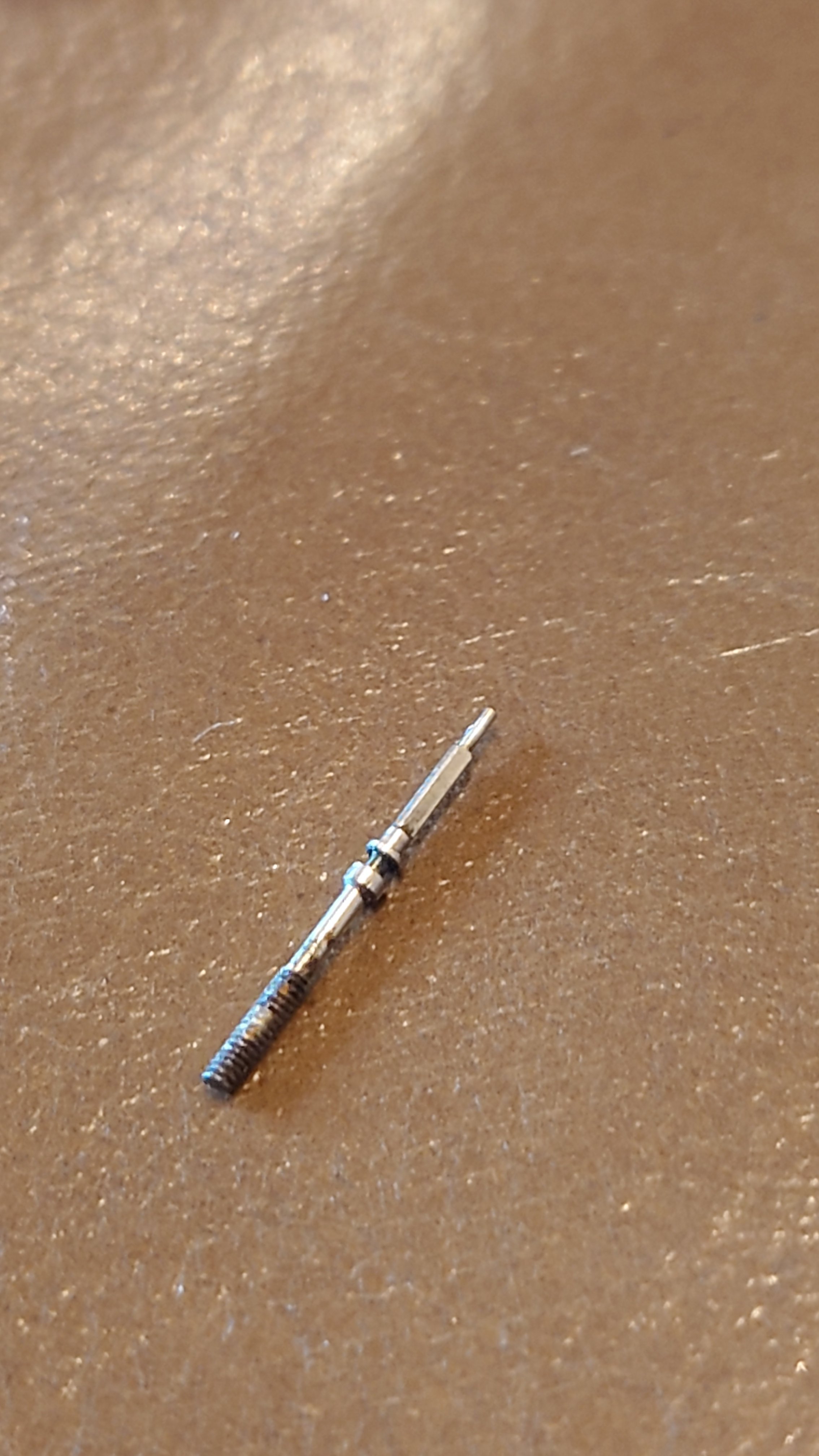

Looking for a little help. I'm looking for a replacement crown and stem for a omega denisteel case 4183. 501 cal 1958. If something alternative that would fit from a different model?? Any help is much better thanks.

Do you have a photo of the case?
I’m not familiar with the case, but 501 uses “500 1106” for the stem.
What does the current crown look like if you still have it? Have you measured the crown tube outer diameter?

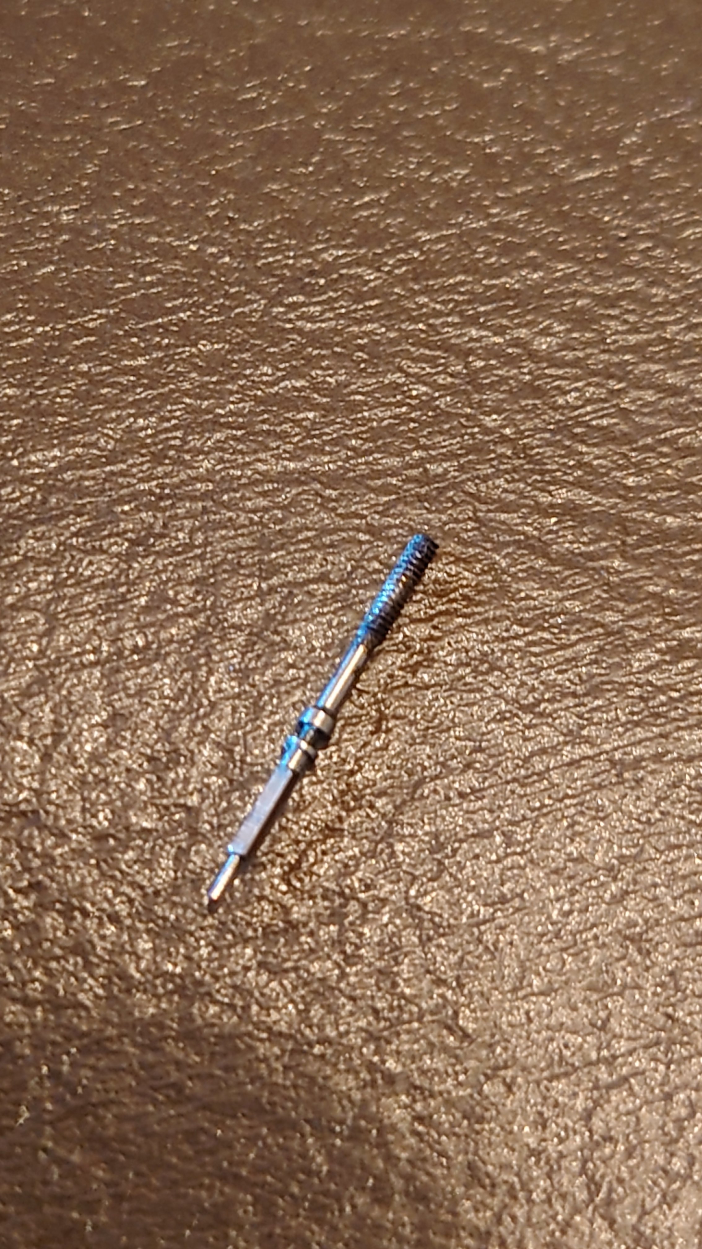

Yea I still have it. I don't own anything to measure properly unfortunately

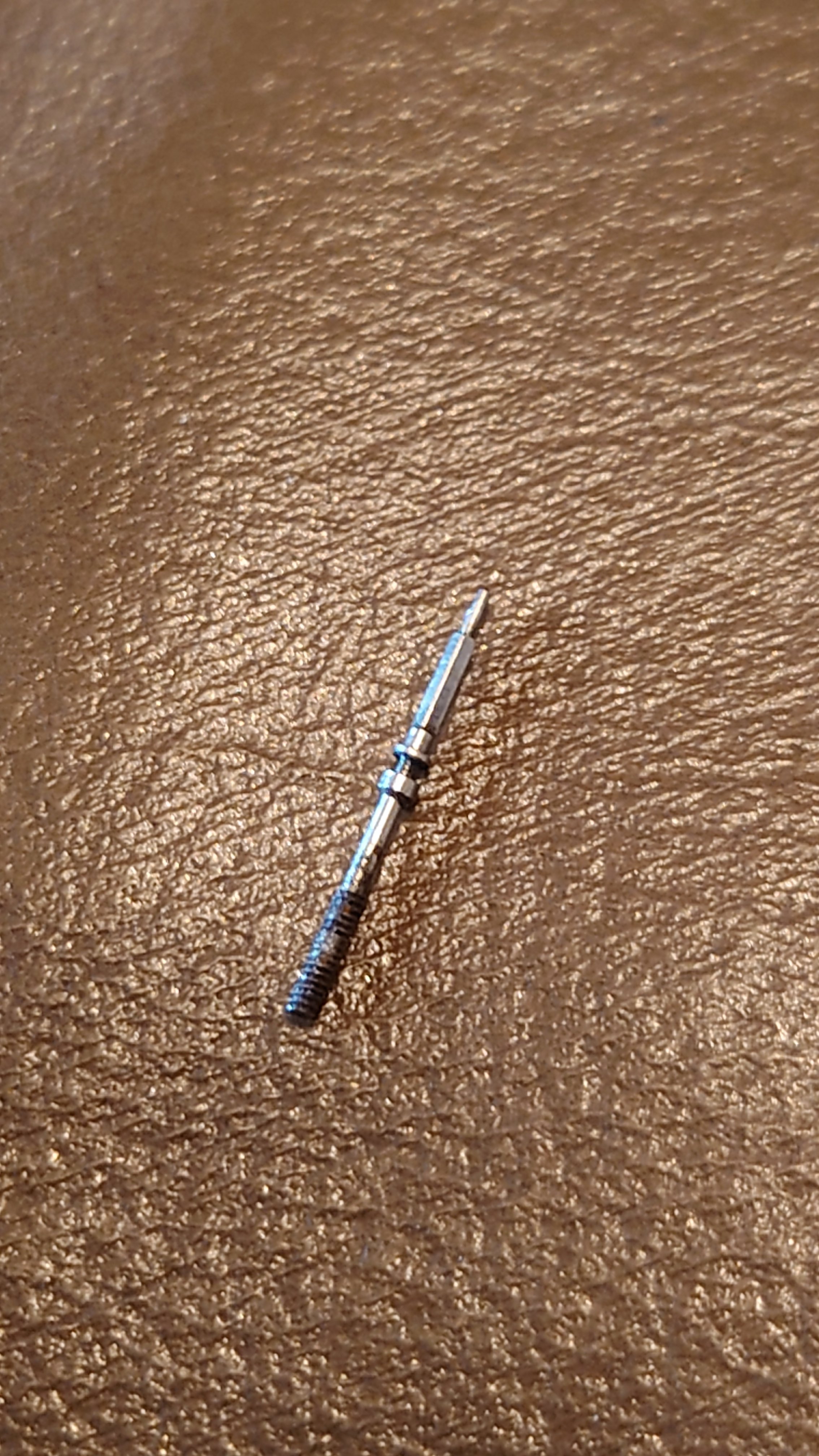

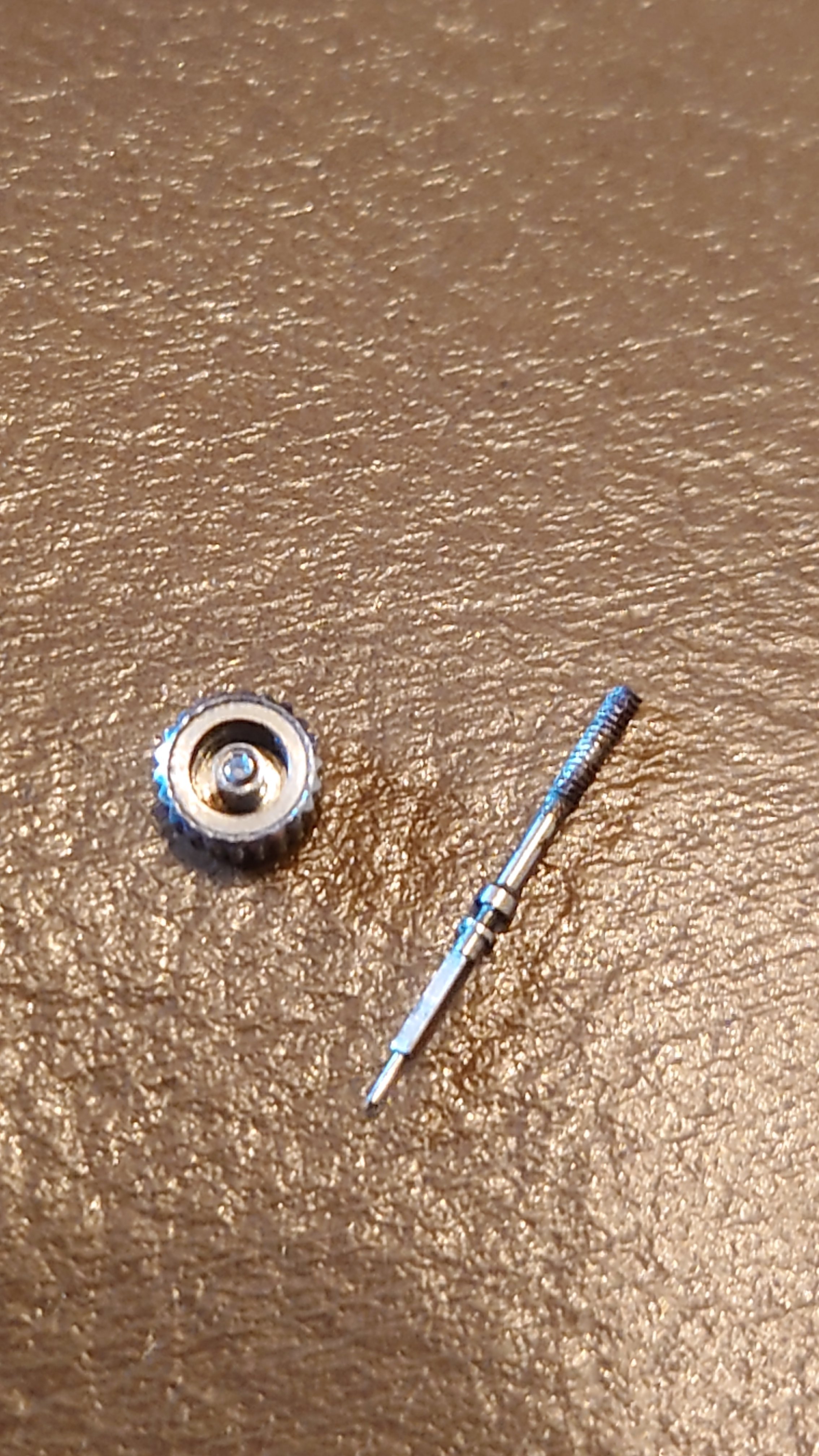

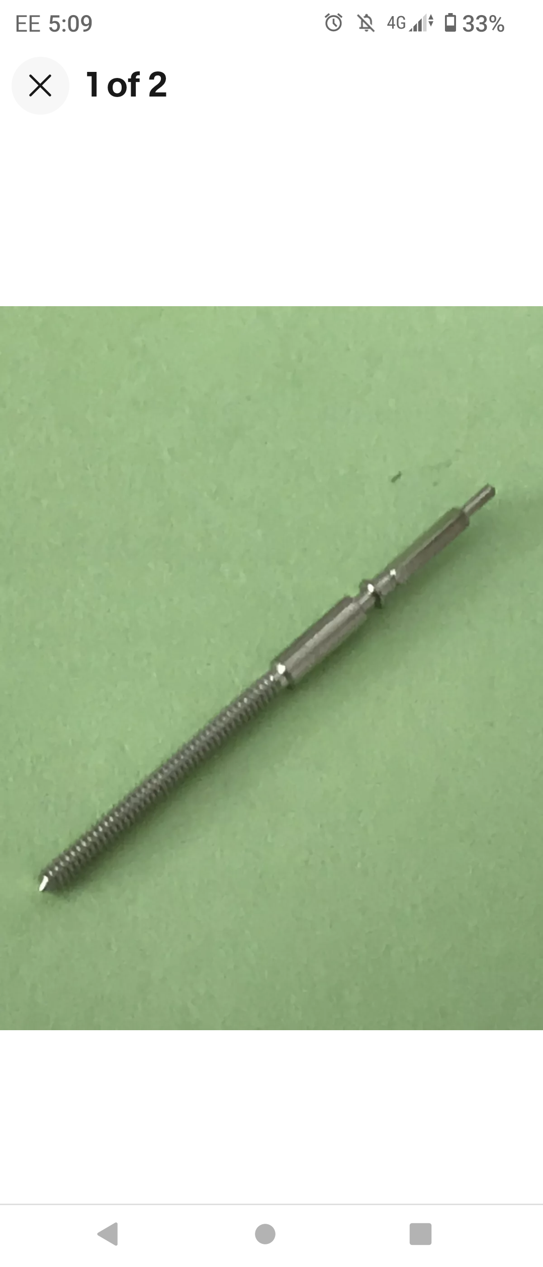

Just bumping this thread again sorry I'm trying to find a crown for this case I have the steam 0.9mm I'm a proper amateur and I don't know why I decided to buy broken omegas with no stems or crown lol but never again lol. Is there a crown number I can look up ?? Or if anyone can help the size of the case tube is rough 2.48mm wide and 1.75mm length and the old damaged crown is
4.35mm diameter
2.10mm thick
1.34mm what stem screws in
Would be much appreciated thankyou

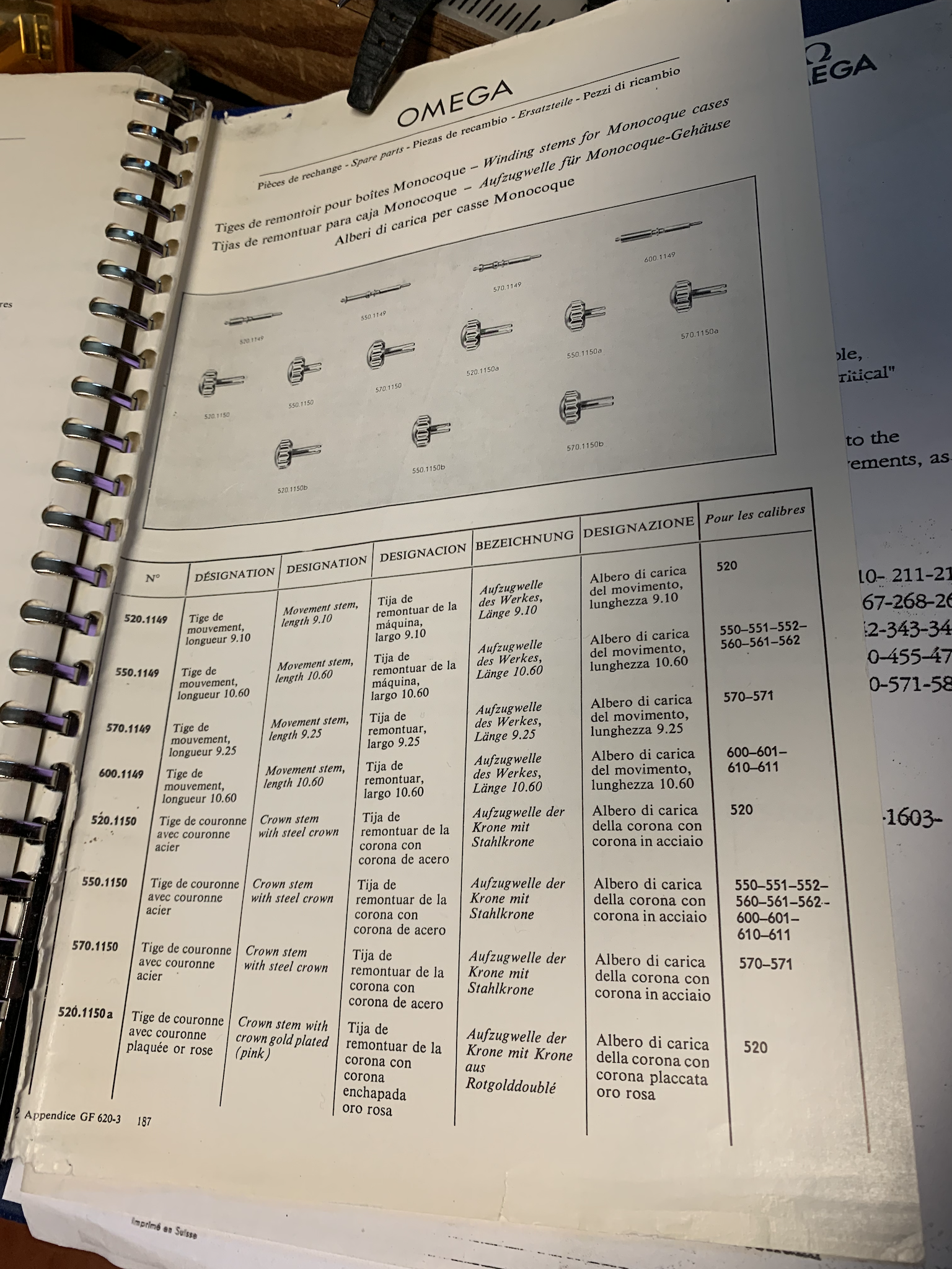

That said I also have publication GF 620-3 which has a lot of appendices and other tables. Some of these are in the archives here.
This table is more for the 550 monocoque case:
There is no similar table for the 500 movements
Other tables detail case and clamps. Stems and crowns are a much case parts as anything else.
These tables have been in circulation for decades. The problem is that there becomes a sort of dogma about them.
Most of these 1950s and early 1960s watches are based on the 470 caliber which is based on the 330 caliber.
So it becomes a challenge to figure out which parts are swappable and which are not.

I did purchase a stem for my 501 with was 500 1106. 0.9mm. It does fit and lock in snugly I'm just now trying to find a crown to fit that stem / case.

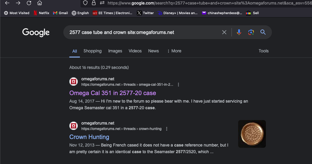

If you use the :site tag in giggle, it helps. Here is one I keep in my cache. I only got these parts a few weeks back.
I can not post this as a link or else I get an 😲 emoji.
