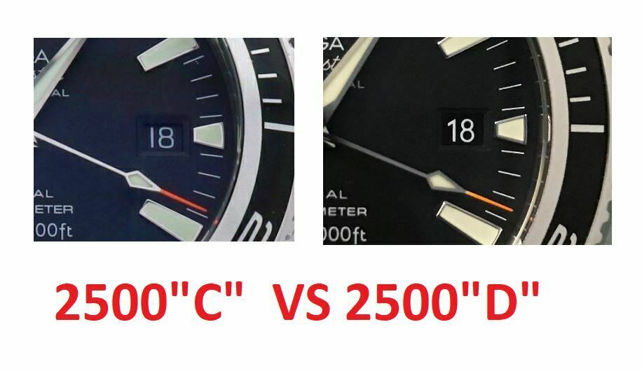

With the PO there is a tell with the date wheel font showing which version of 2500 is fitted. I believe there is carry over with this to the SMP also ie you don't need to open the watch. One other thing is that there was a serial cut off around 2011 after which only the D version was fitted. Again that info is out there somewhere. Note this means the SMP only had the D spec for about a year before being replaced by the SMPc.

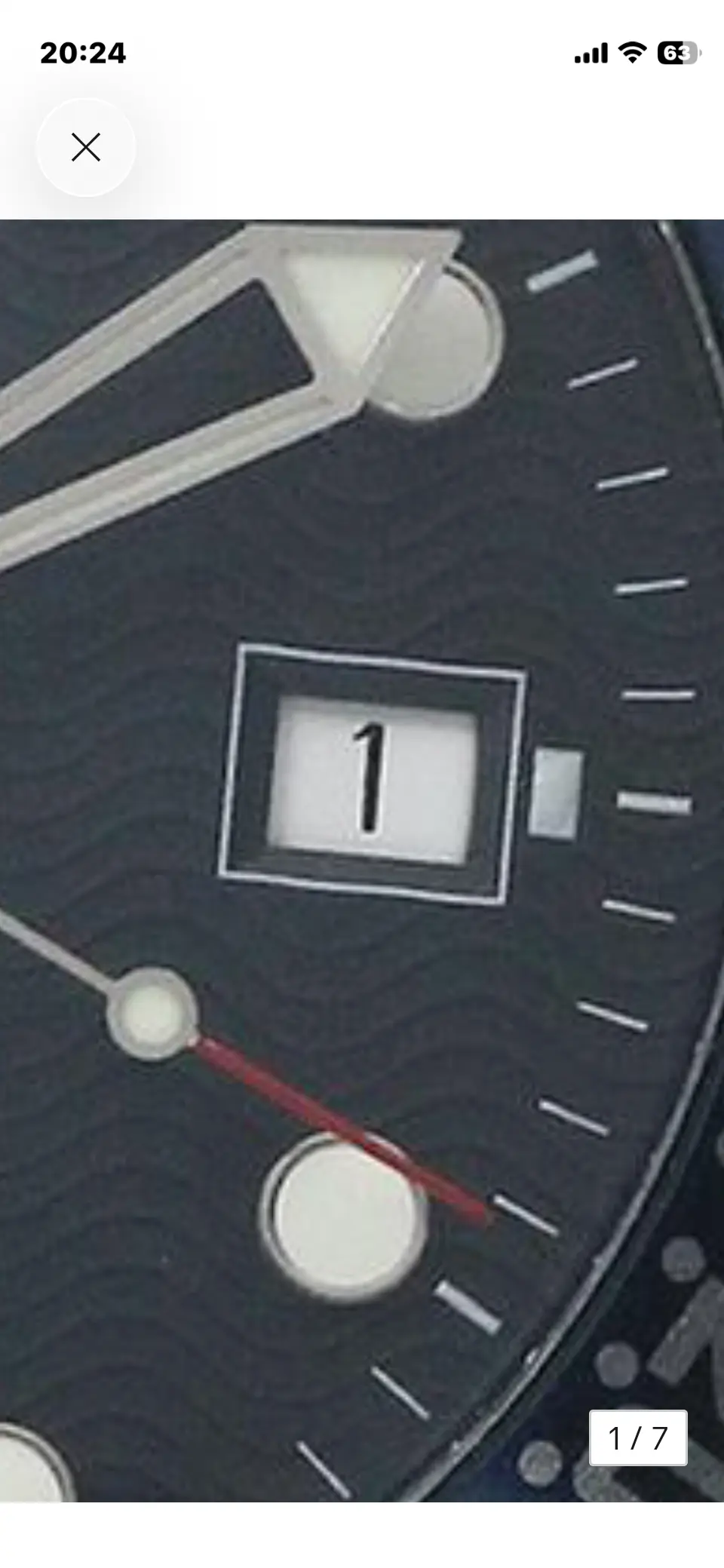

Just resurrecting this thread as I’ve got my eye on 2220.80 from the Japanese seller Closer.
I didn’t realise this was issue in these although had heard that 2500d was the better movement.
The watch I’ve picked out has a reference starting 81745 which I believe dates it around 2011 although the warranty card states 2018 so may have been old stock
1,216
1,239
The font on the date wheel will tell you if it's a D. That assumes the date wheel hasn't been changed--but that's not common.
1,216
1,239
Yeah that makes sense reading through that post. Given the ref number and date wheel font I’m assuming it’s a D
I'm not so sure. 1's look similar on both. That's the one (no pun intended!) number you don't want to use to determine a C from a D.
1,216
1,239
Look for pics of the first ceramic bezel generation of SMP's to tell what each number should look like for the 2500D. The one with no wave. Those are all D models.
Go on Chrono24 and search Omega 212.30.41.20.03.001--those are all D's. Lot's of numbers to compare. If I recall correctly, the numbers for the 2531.80 (Brosnan era SMP with the 1120 movement) and the 2500C models are the same. So you can review those to see what the C numbers look like. Again, 1's on the C and D are very similar. But all other numbers and very distinct.
