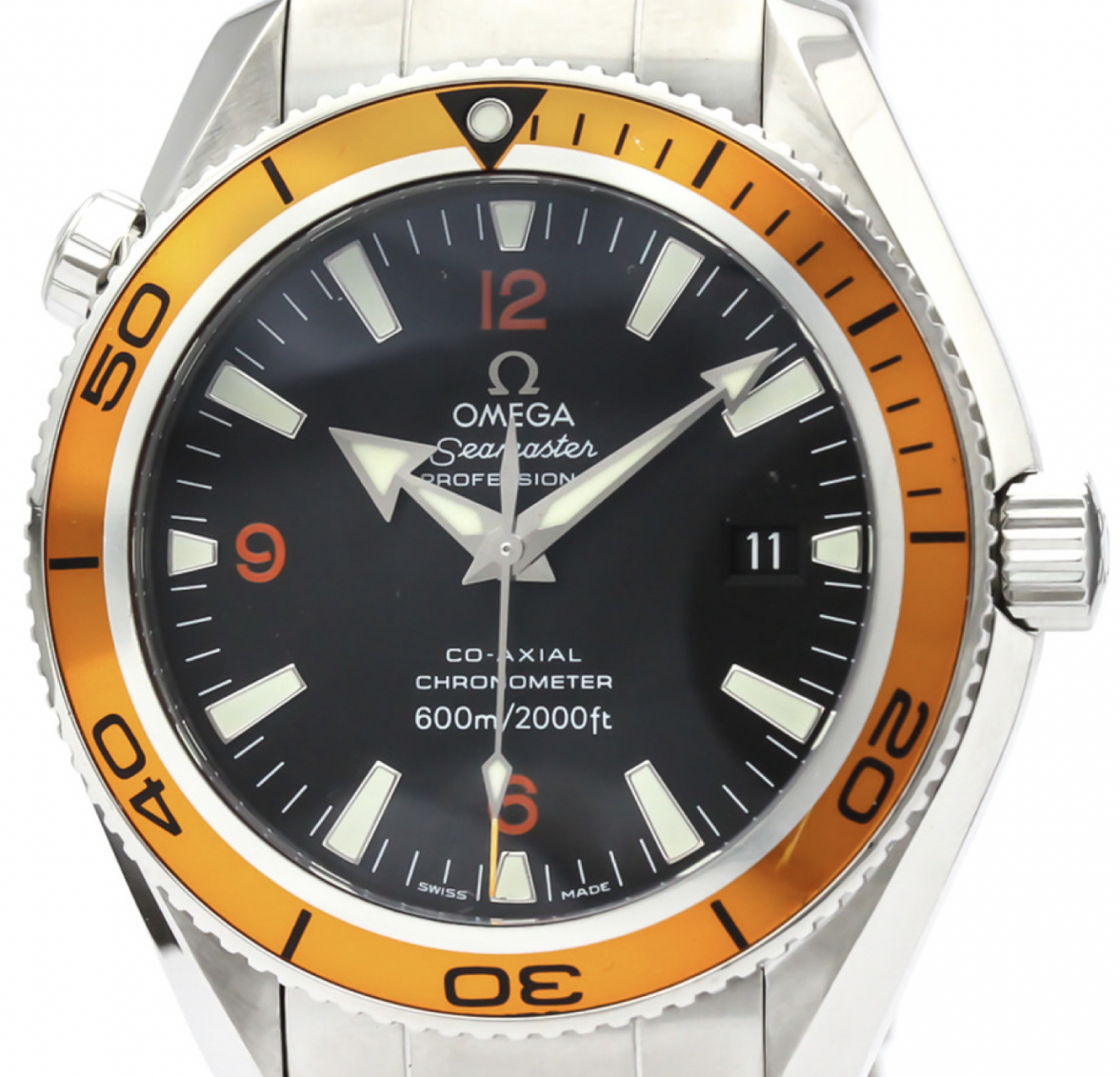

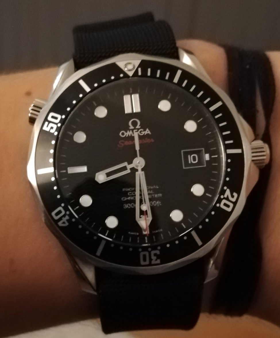

I came across a late 84 million 2209.50 (846895XX) that has a font on the number one somewhat similar to the one on the right above:
Could it be a 2500D ? Or perhaps late 2500C watches used that "similar" date wheel on a transition phase? The serif of the "1" is similar to the one of the computer so definitely not like the one on the left above, which lacks the tip, but not sure if the same as the one in the right.

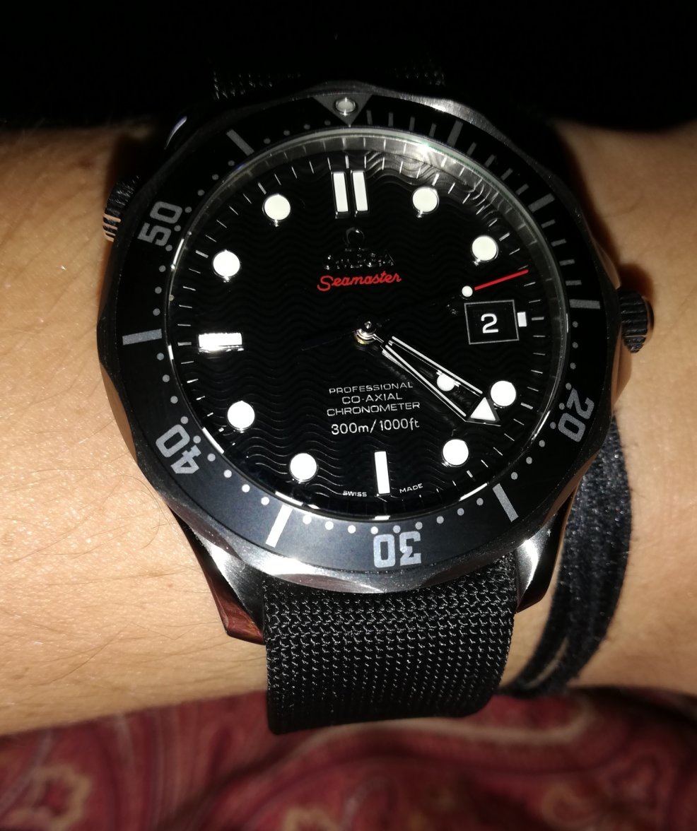

I had a 2500C Seamaster 300m.
The serif on number "1" and "11" is different than on "10", "12",..,"18", and so on..
So thats normal for a 2500C.

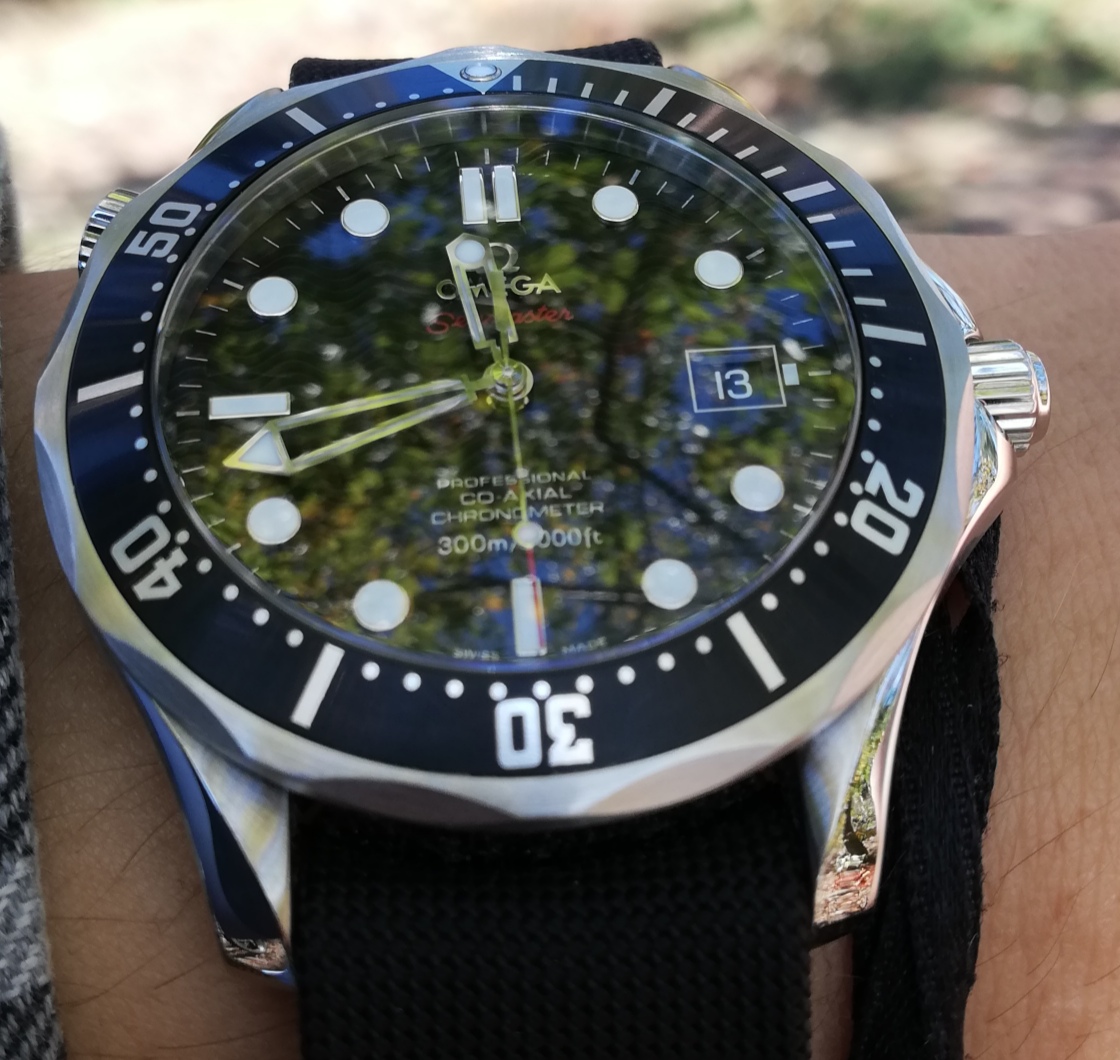

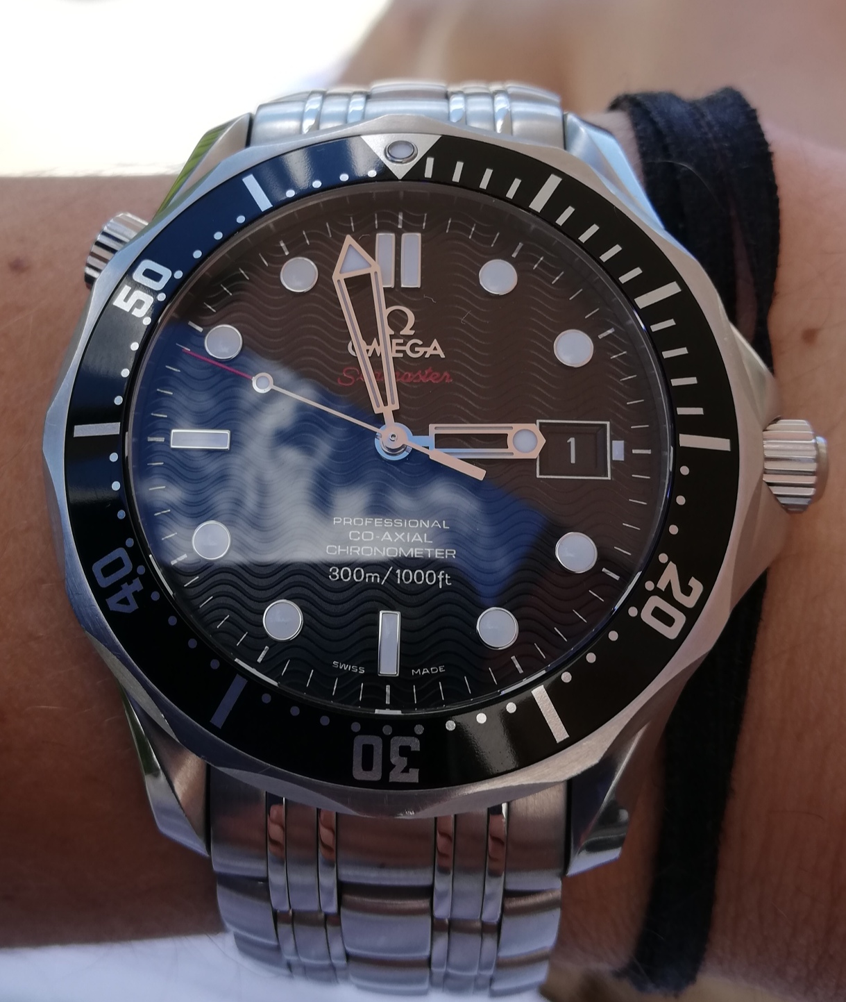

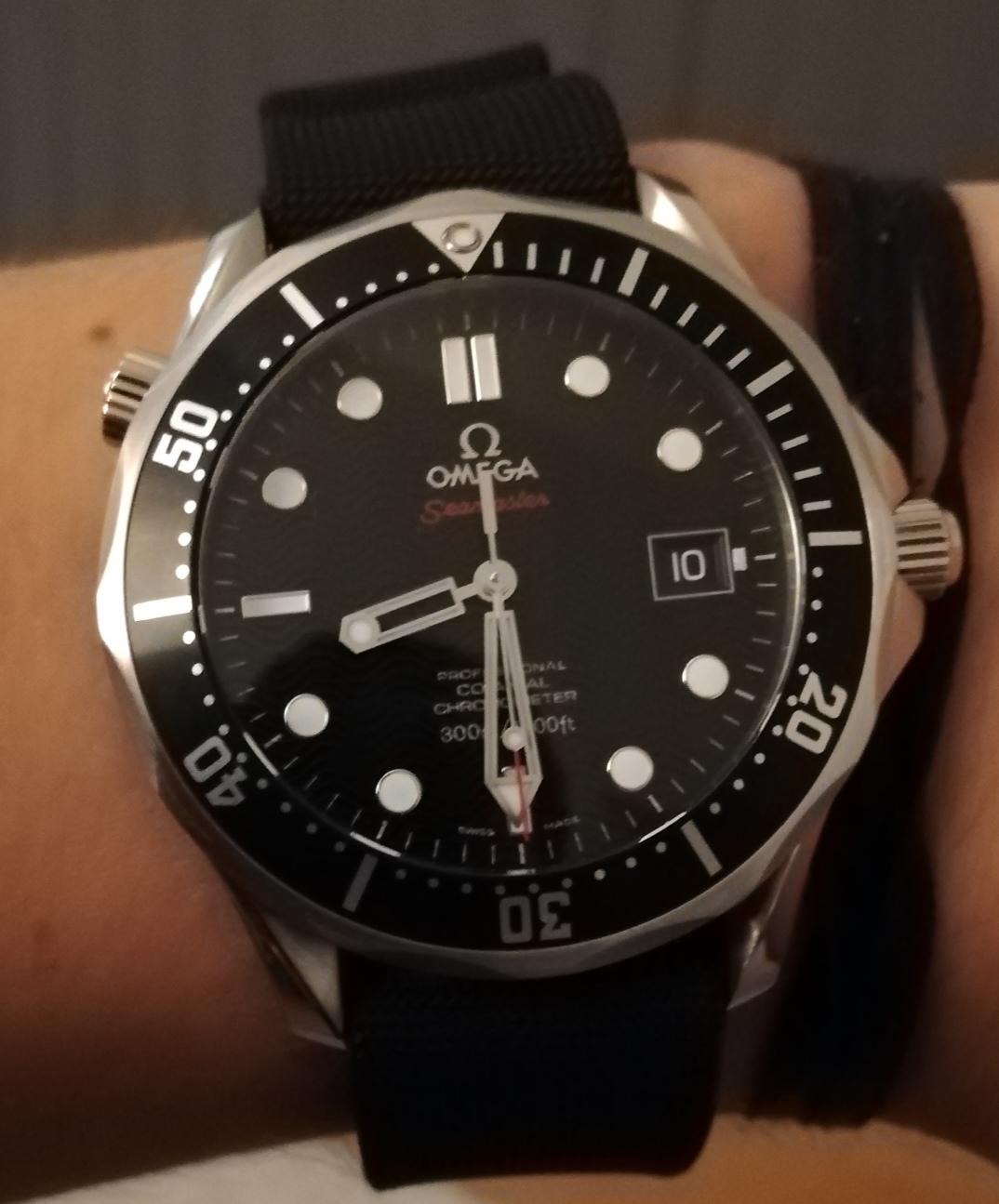

Mate, it looks like a regular 2500C.

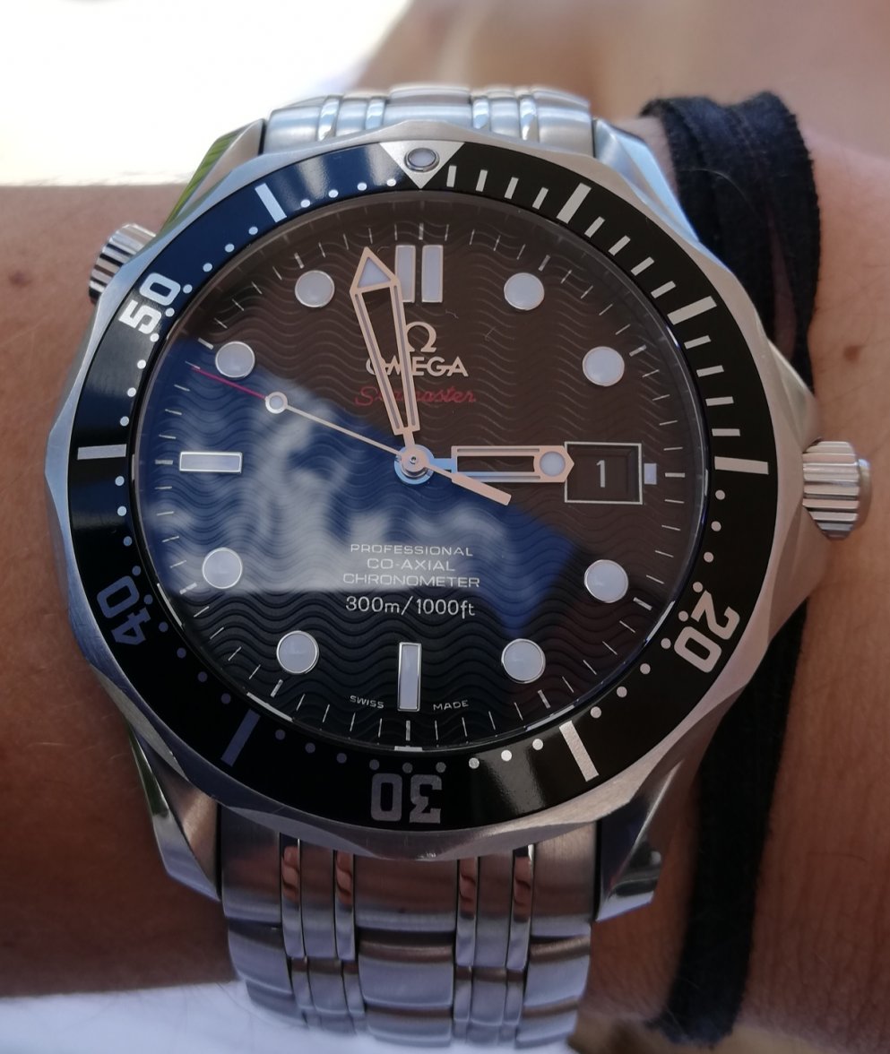

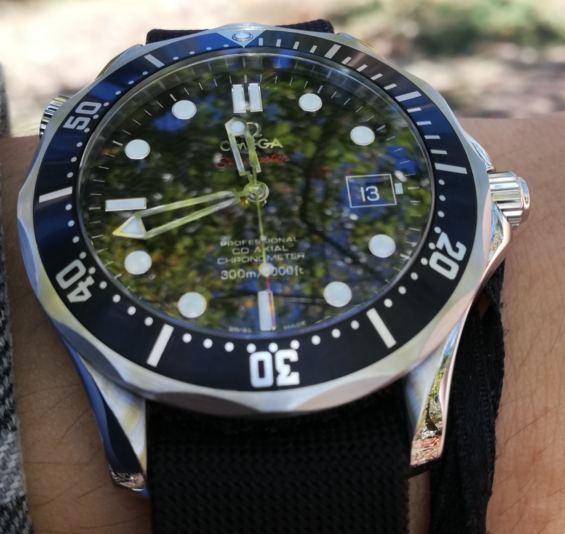

Here is "11" at my 81xxx serial/ 2007 watch

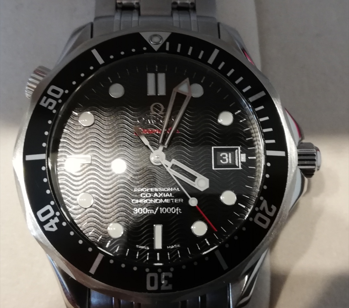

I do not have PO with 2500D, but here is "11" at my SMPc with 2500D

Thanks! @Archer helped me in checking it and indeed it is a 2500C 😉

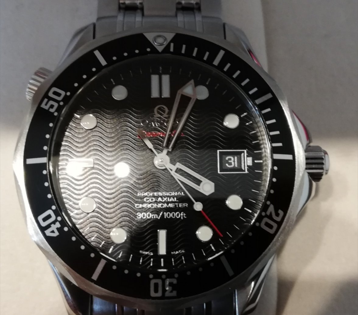

the "one" and "eleven" on the C series vs the D series is that the head of the "one"s on the C series is flat whereas on the D series it is pointy sharp.
