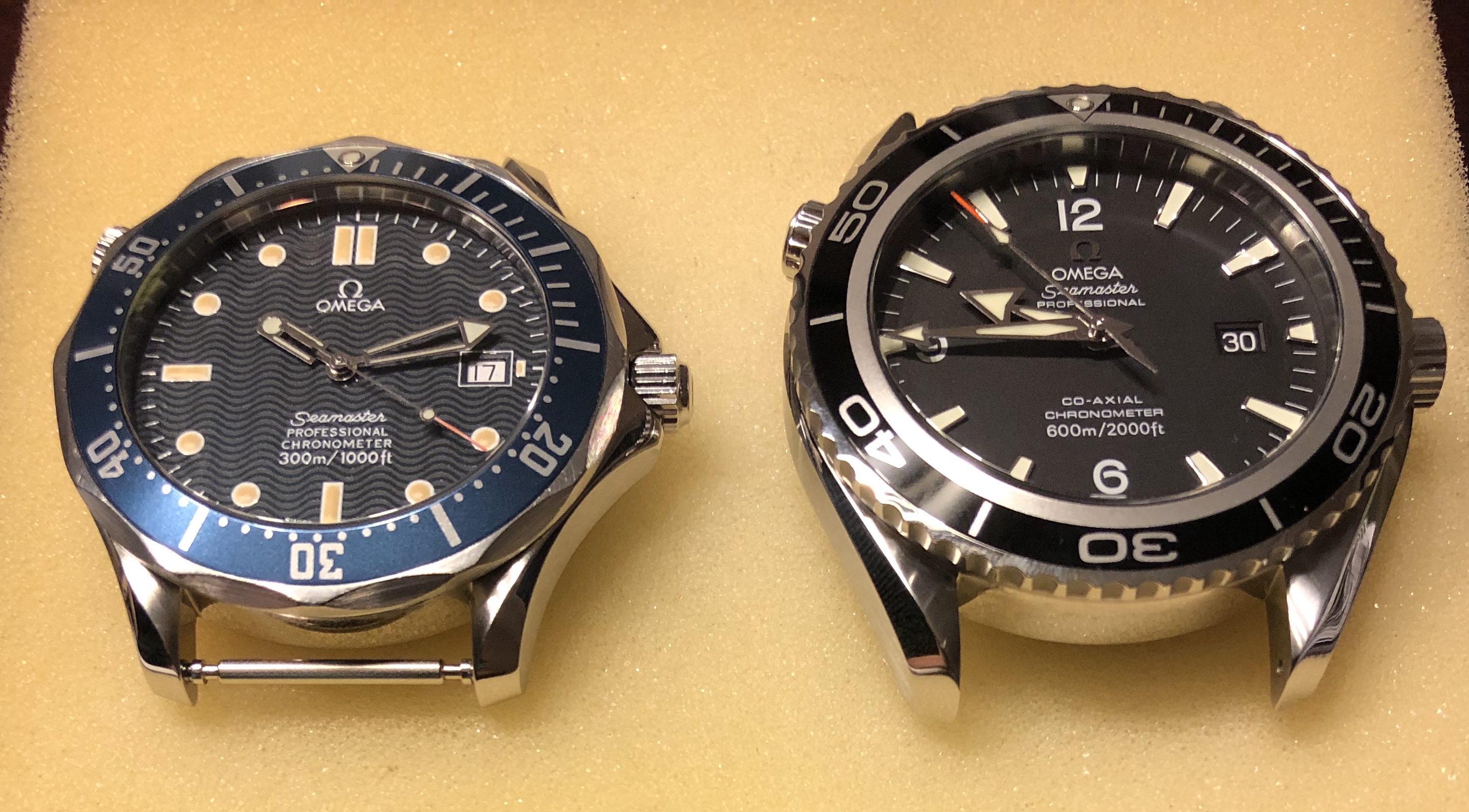

It's happening...part of a collection I serviced earlier this year included several of the 25318000's, and yes a number of them were 1109 variants, and a couple had the slightly different original bracelet (bracelets not shown here). Also a couple of Speedy's thrown in the mix:
The top right one had a lovely faded bezel too...
Cheers, Al
259
232
Cheers, Al
The top right looks great.

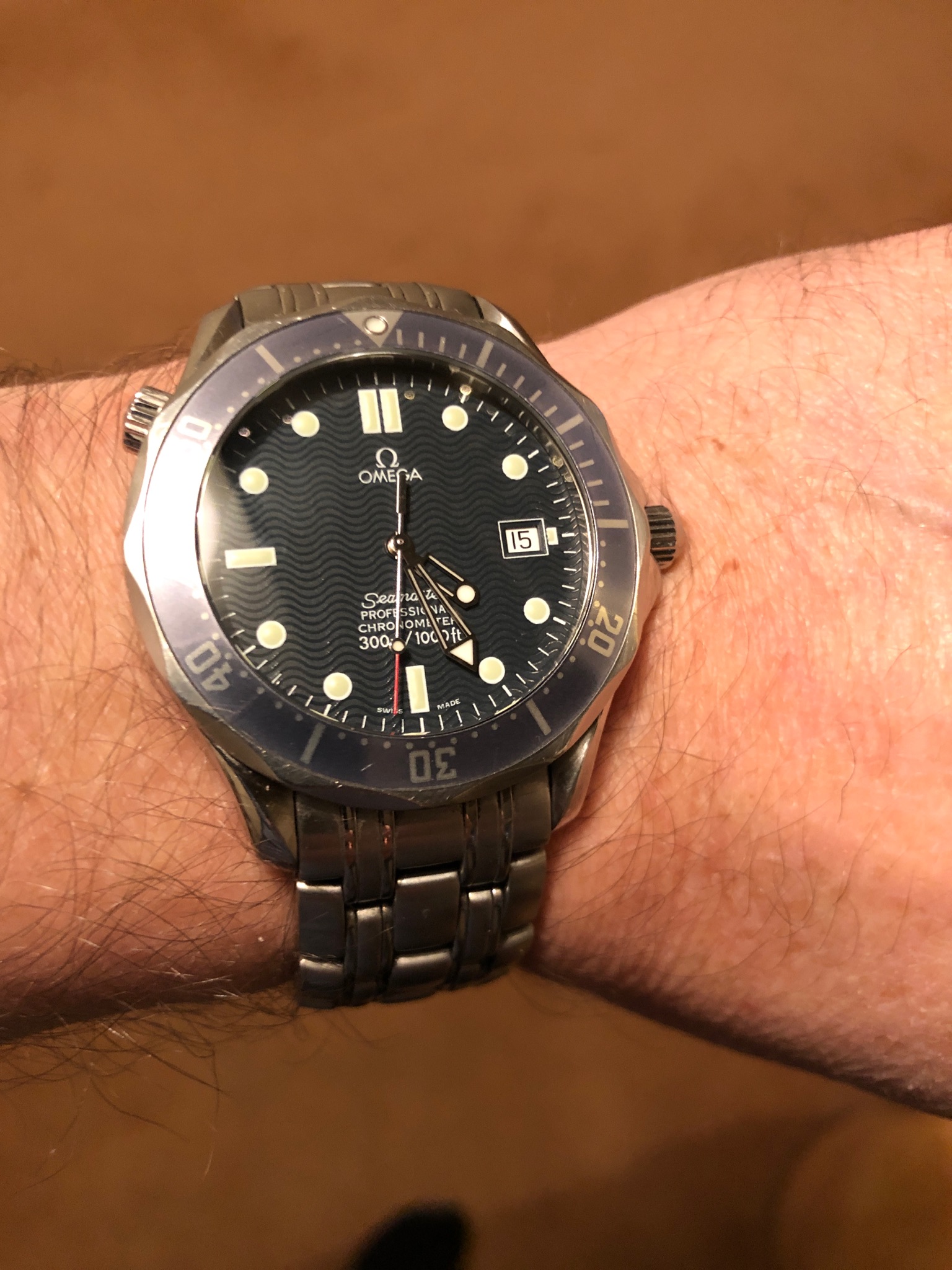

My 300 has had a fair bit of exposure to sunlight and has quite a nice faded bezel. This photo does not do it justice.
