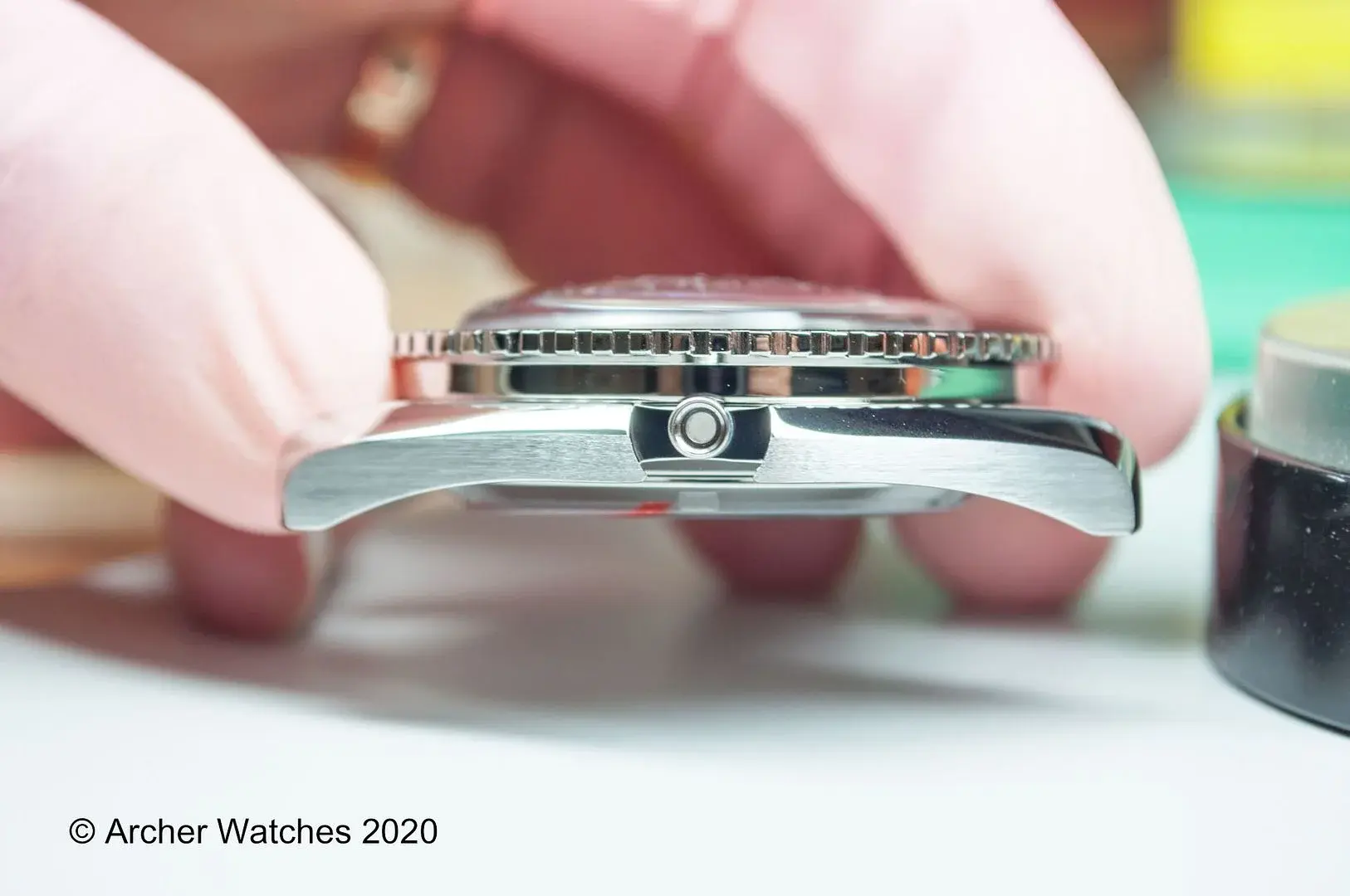

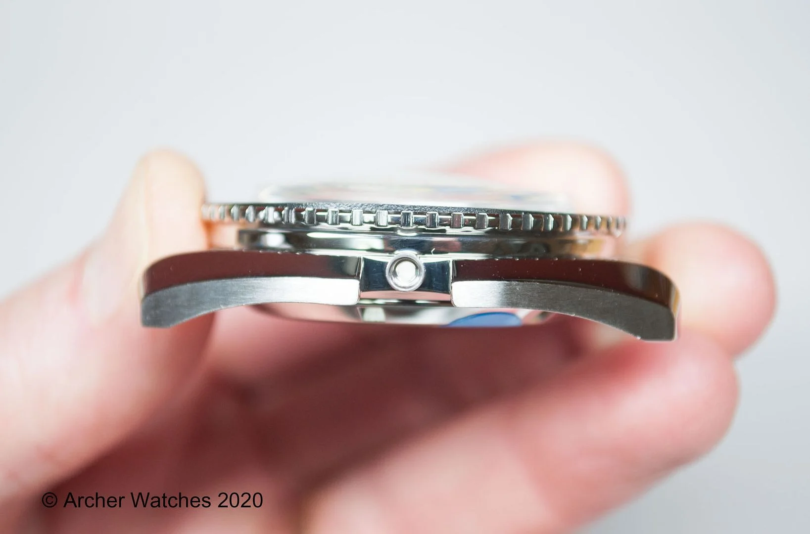

I mean, not sure it really matters whether it was put together by WatchCo. There are a ton of these builds out there—mostly in the hands of collectors/enthusiasts. It really just comes down to the authenticity of the build and whether they used the right parts. These days people seem to use the term “watchco” for any built/rebuilt SM300 with modern service parts.
You are referring to the one that was on eBay? If so, the photos would have made this easy.
It looked like all modern service parts to me except the movement. It seems like the caseback matches the midcase and somebody acquired a complete case from Omega. The modern case only comes with a screw down crown. That crystal is modern (as would be expected with the service case) and is good for both a 165 and 166.
Movement serial as you stated is very early. As the seller noted, it was acquired from a non SM300.

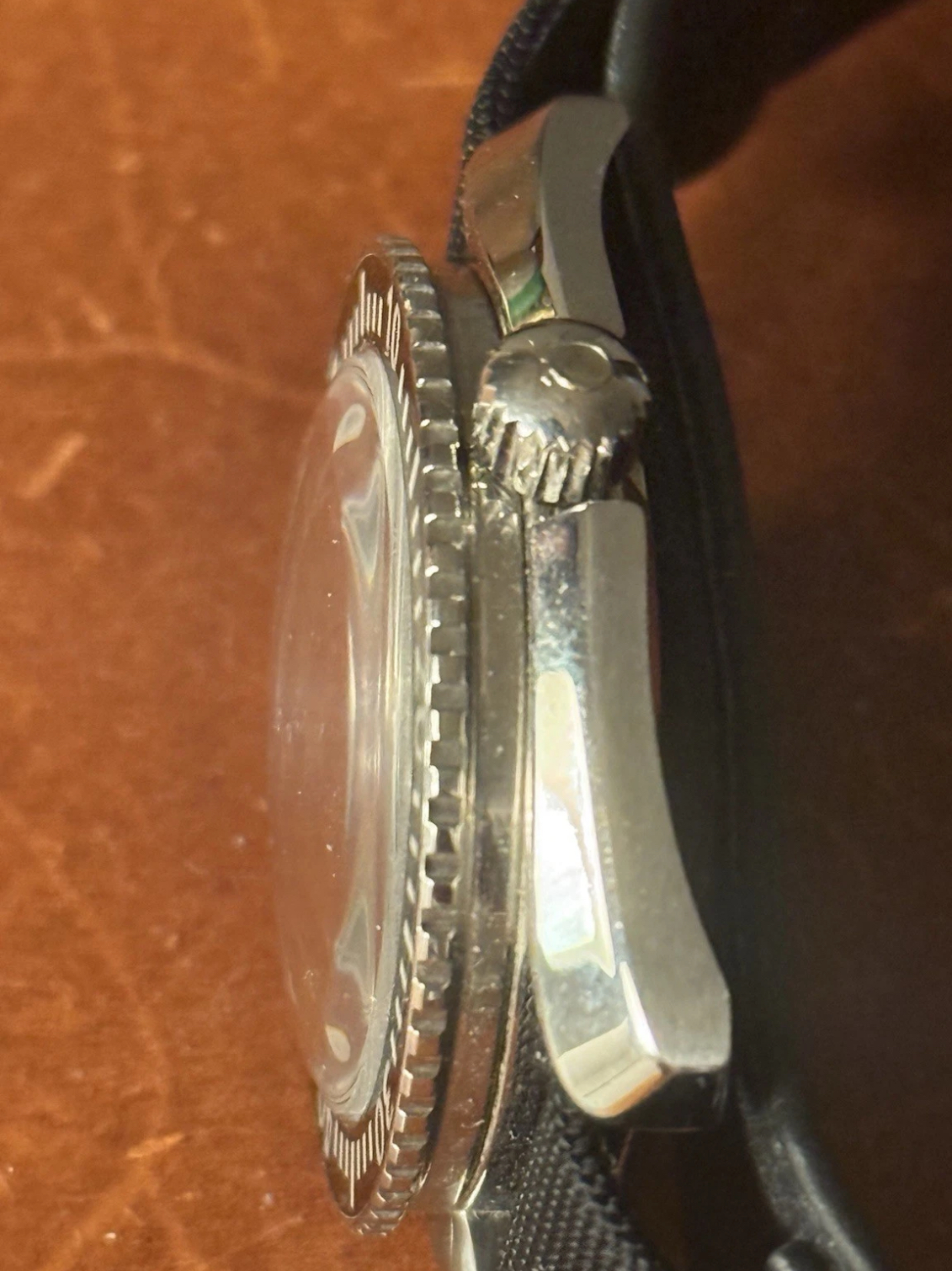

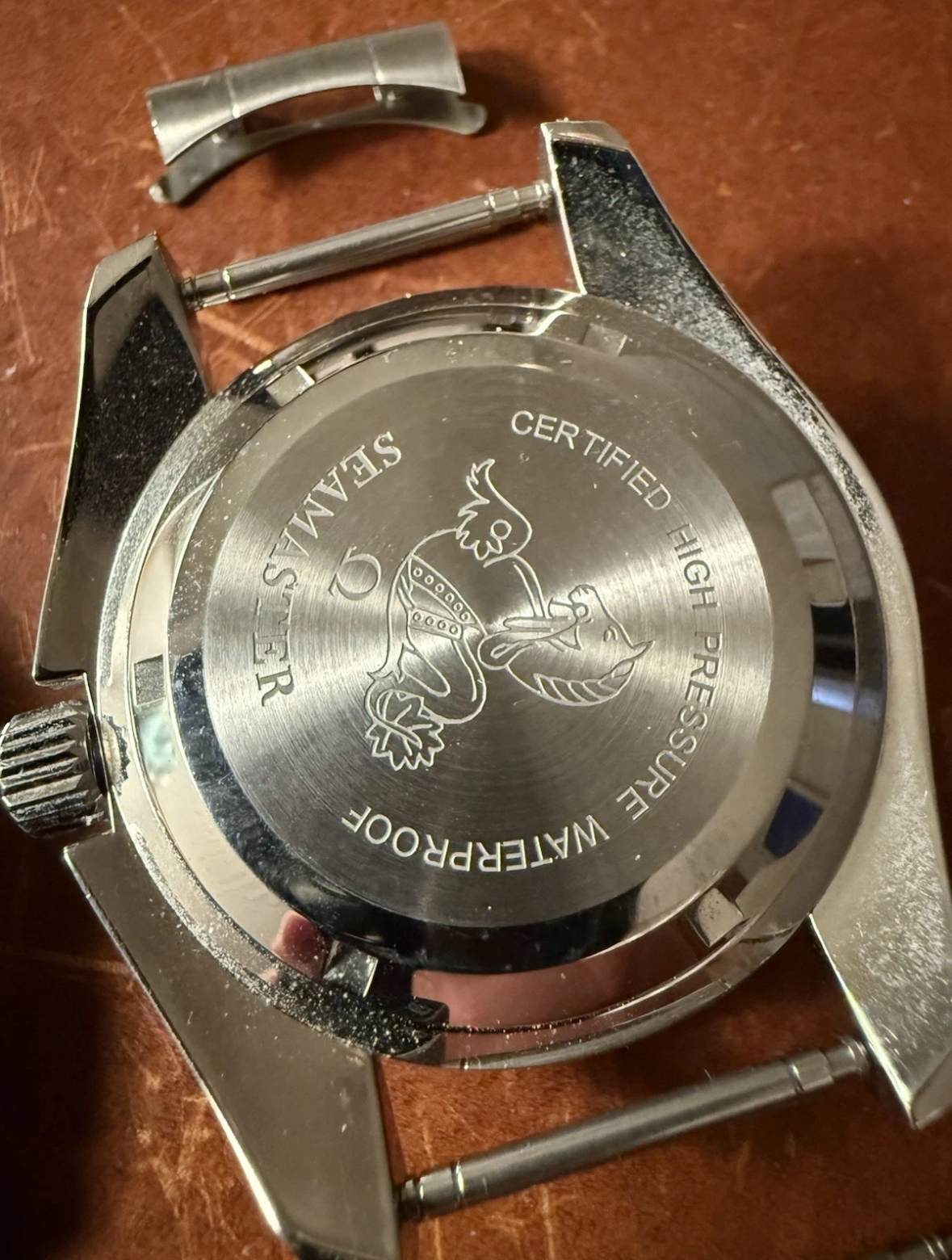

Thanks for your response and although I saw the eBay listing for the one you referenced, I did not go that route due to the location of the seller being in Ecuador and not wanting to incur tariffs.
Here are a couple of photos of the case

That’s the one I was referring to. I tried to copy the link to it but it redirected to the other one.

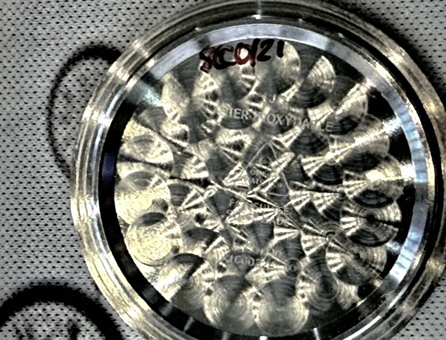

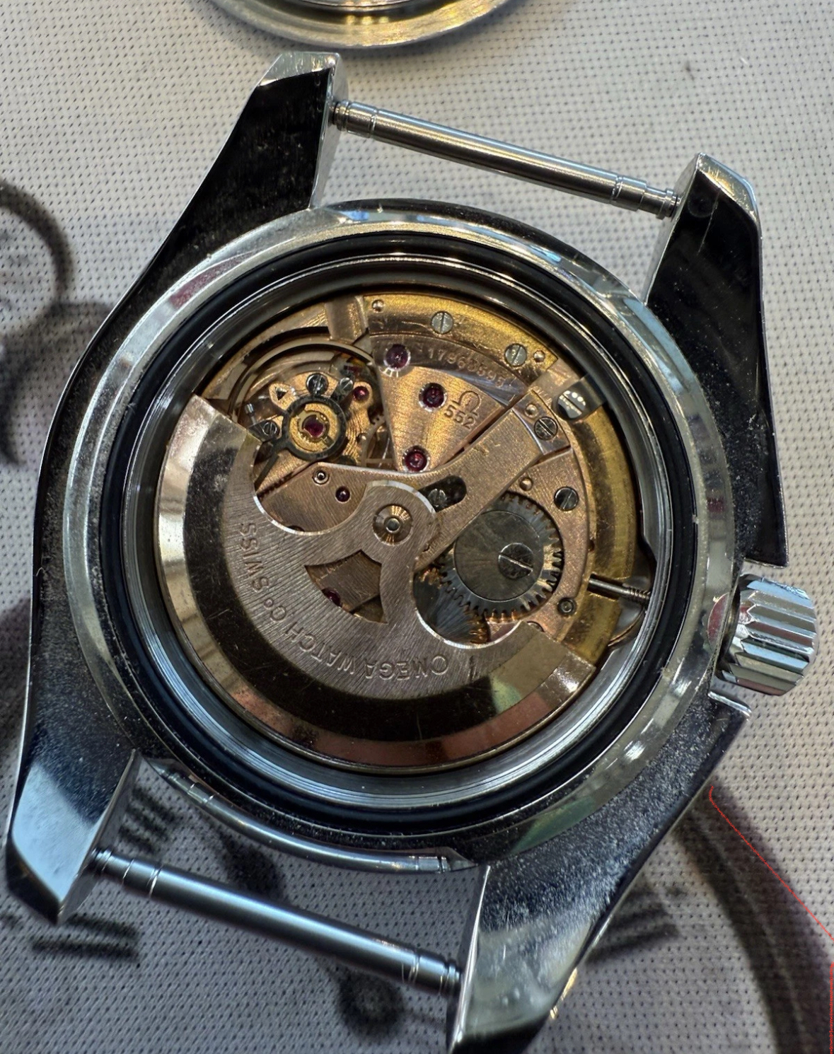

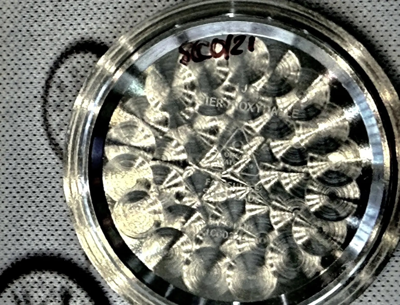

FWIW here are a couple of more pics of inside. The case back pic is really low quality but the engraving can be somewhat visible
Interesting, that’s weird.
298
221
This is the latest version of Omega service case (straight crown cut), the only vintage part of this build is the movement, but17mil serial is too early for 165.024... so here you have fresh build "Watchco"...
