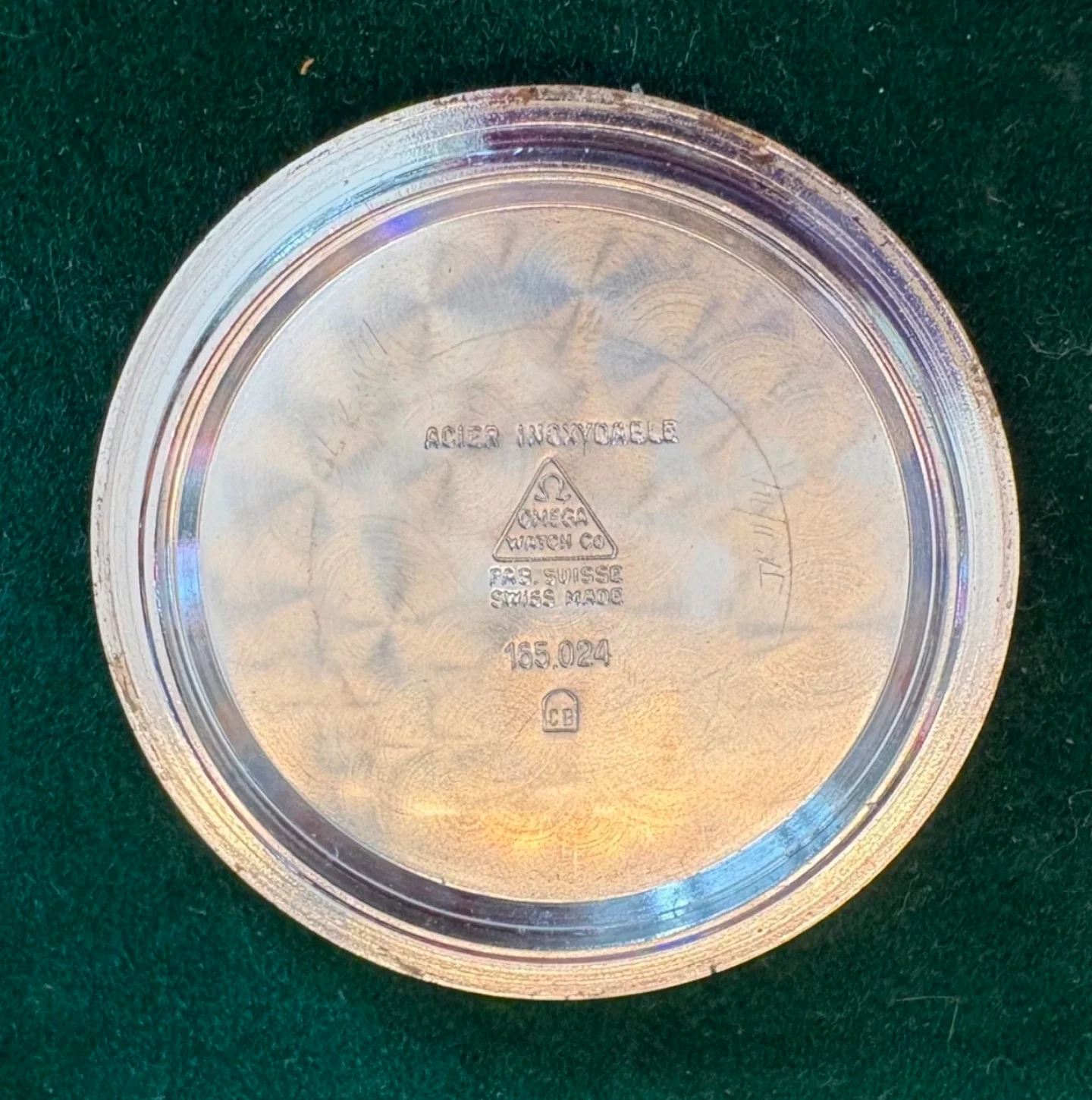

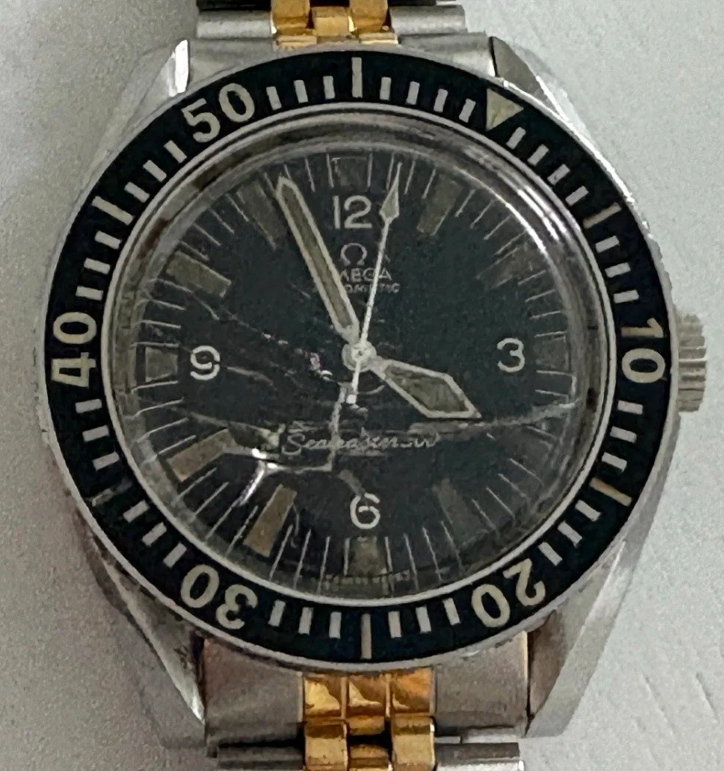

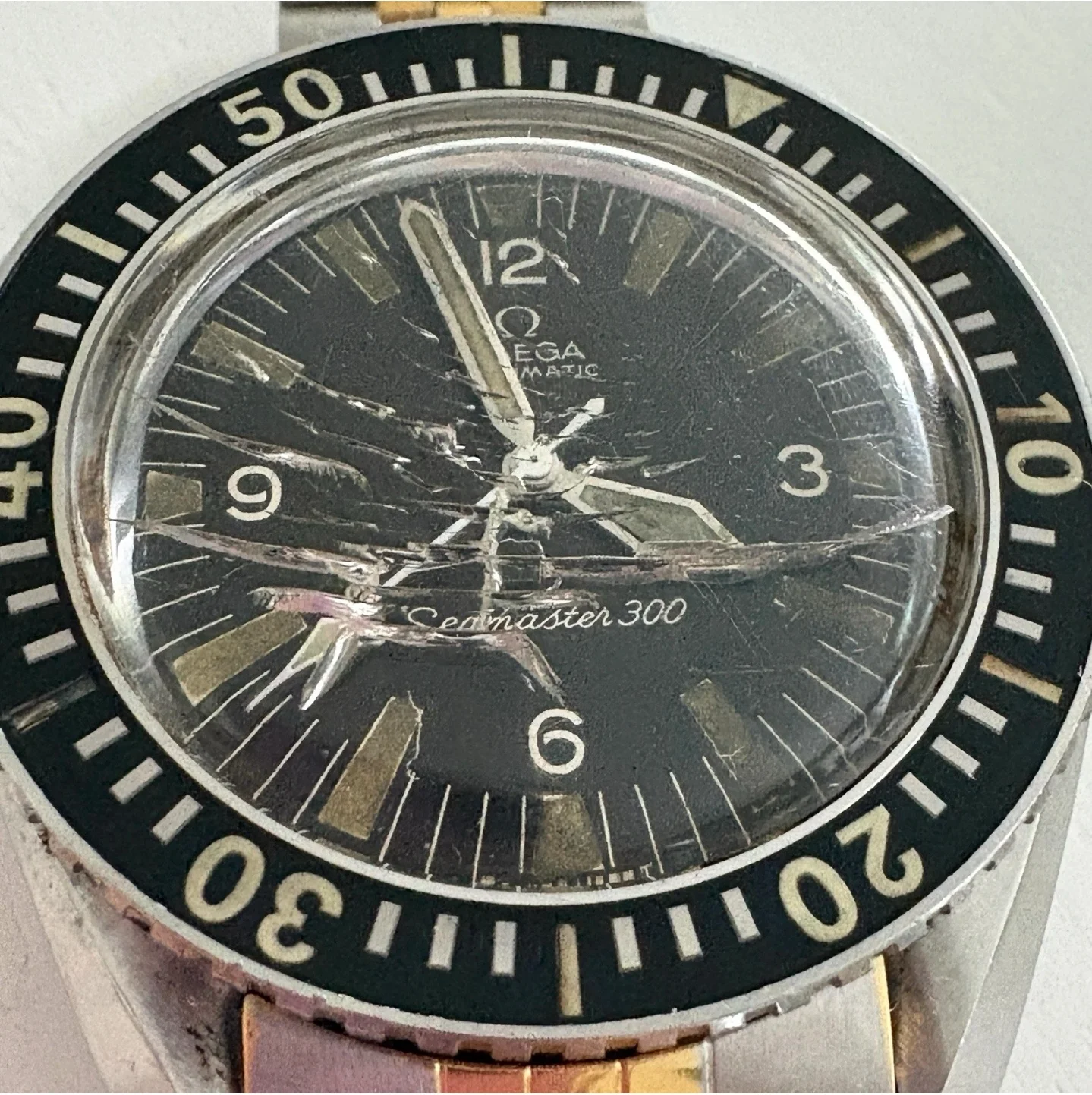

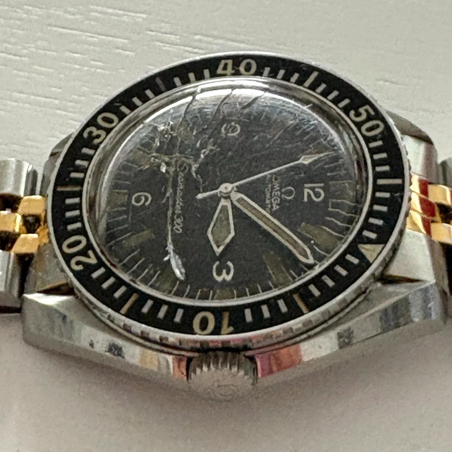

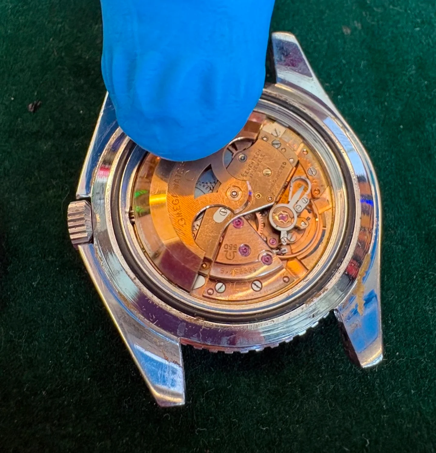

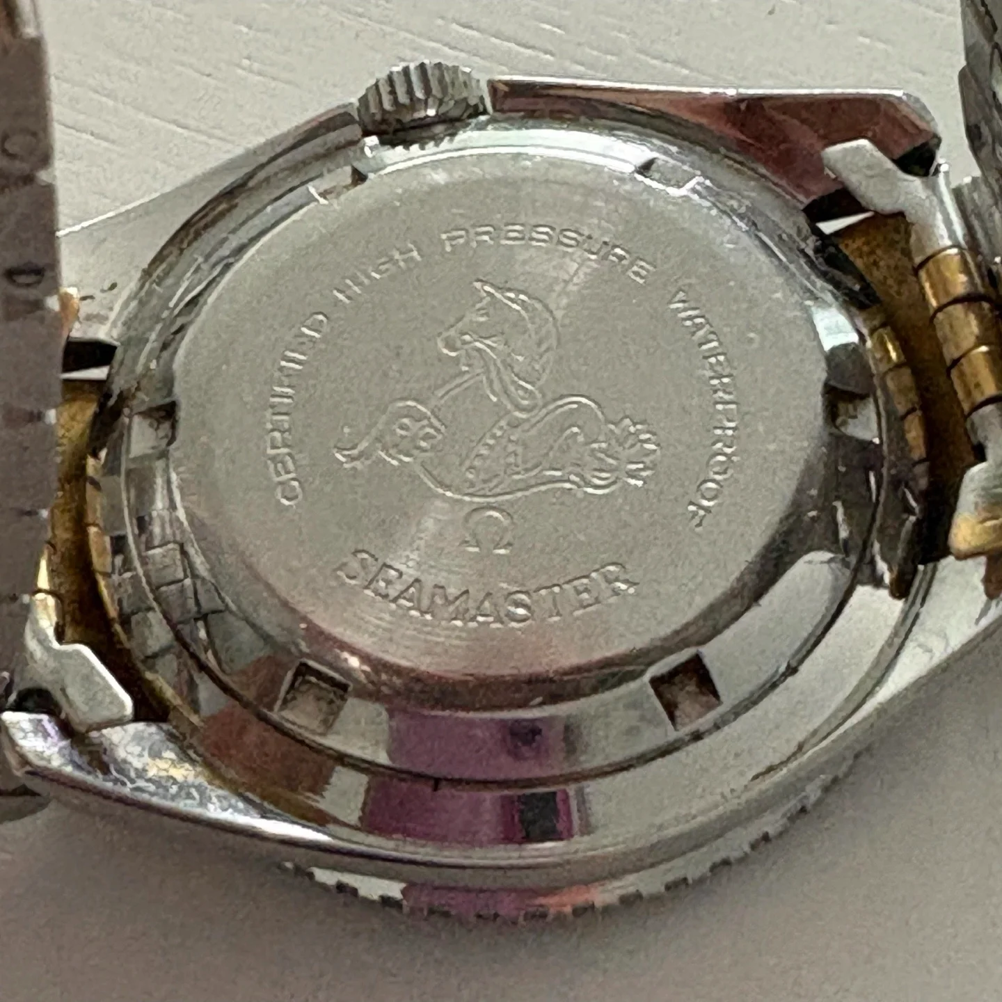

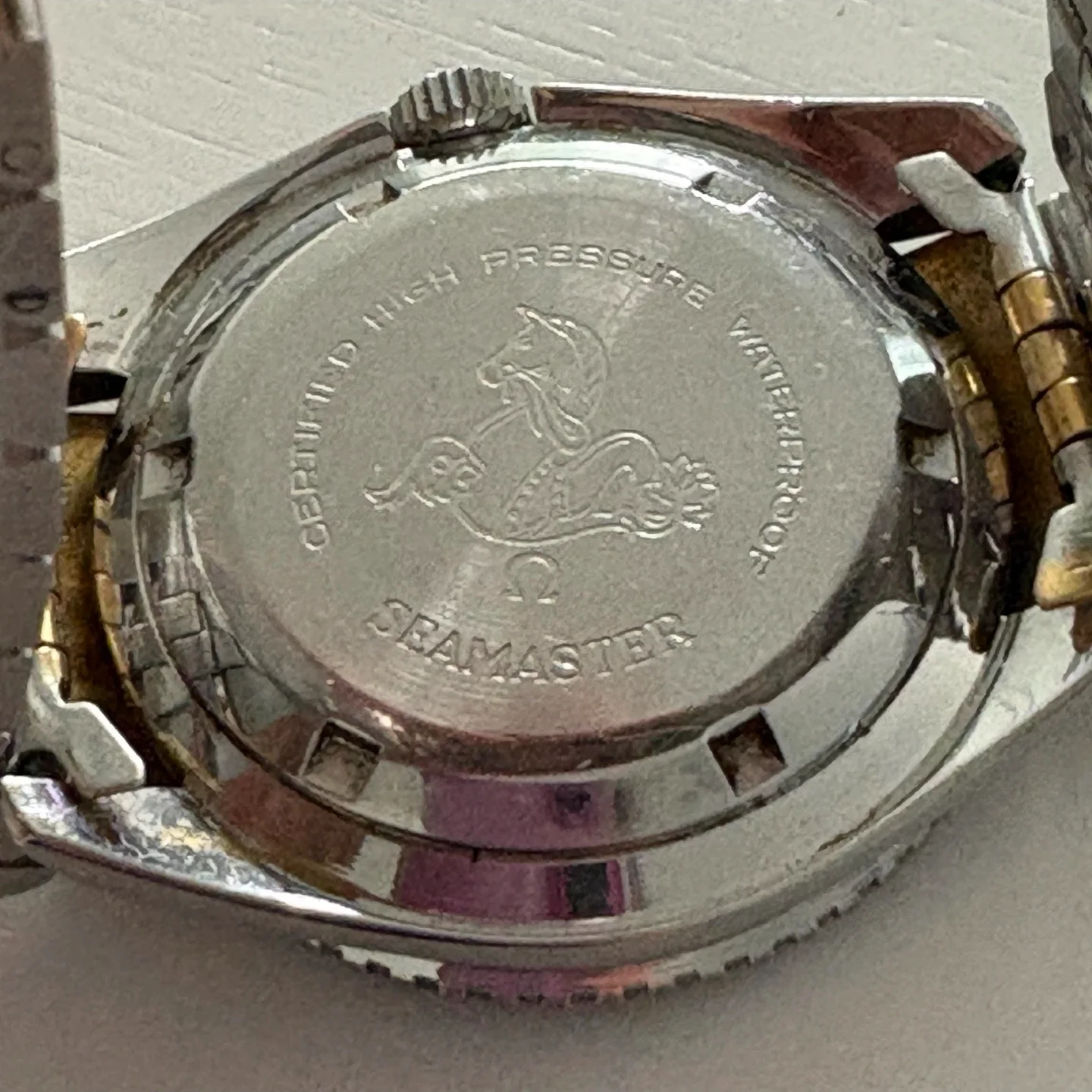

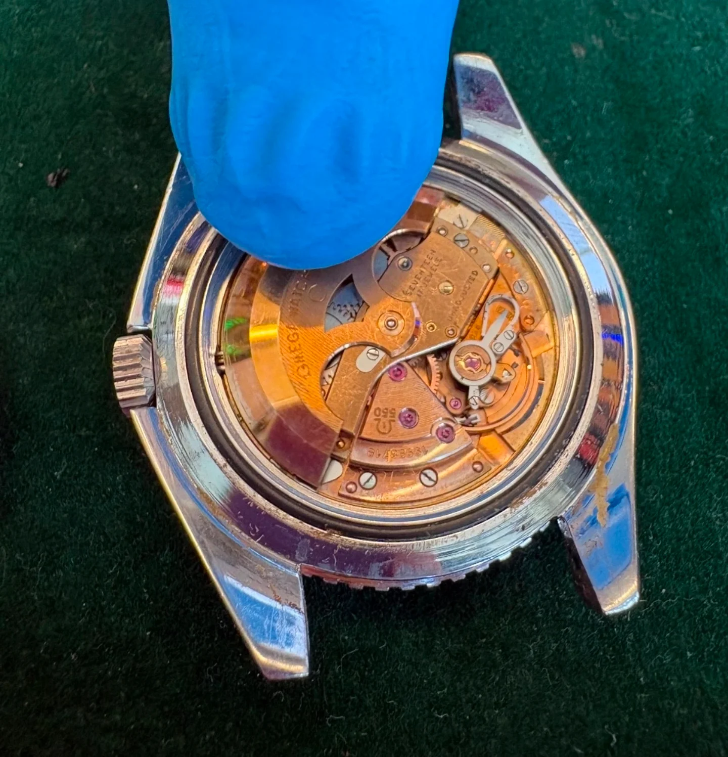

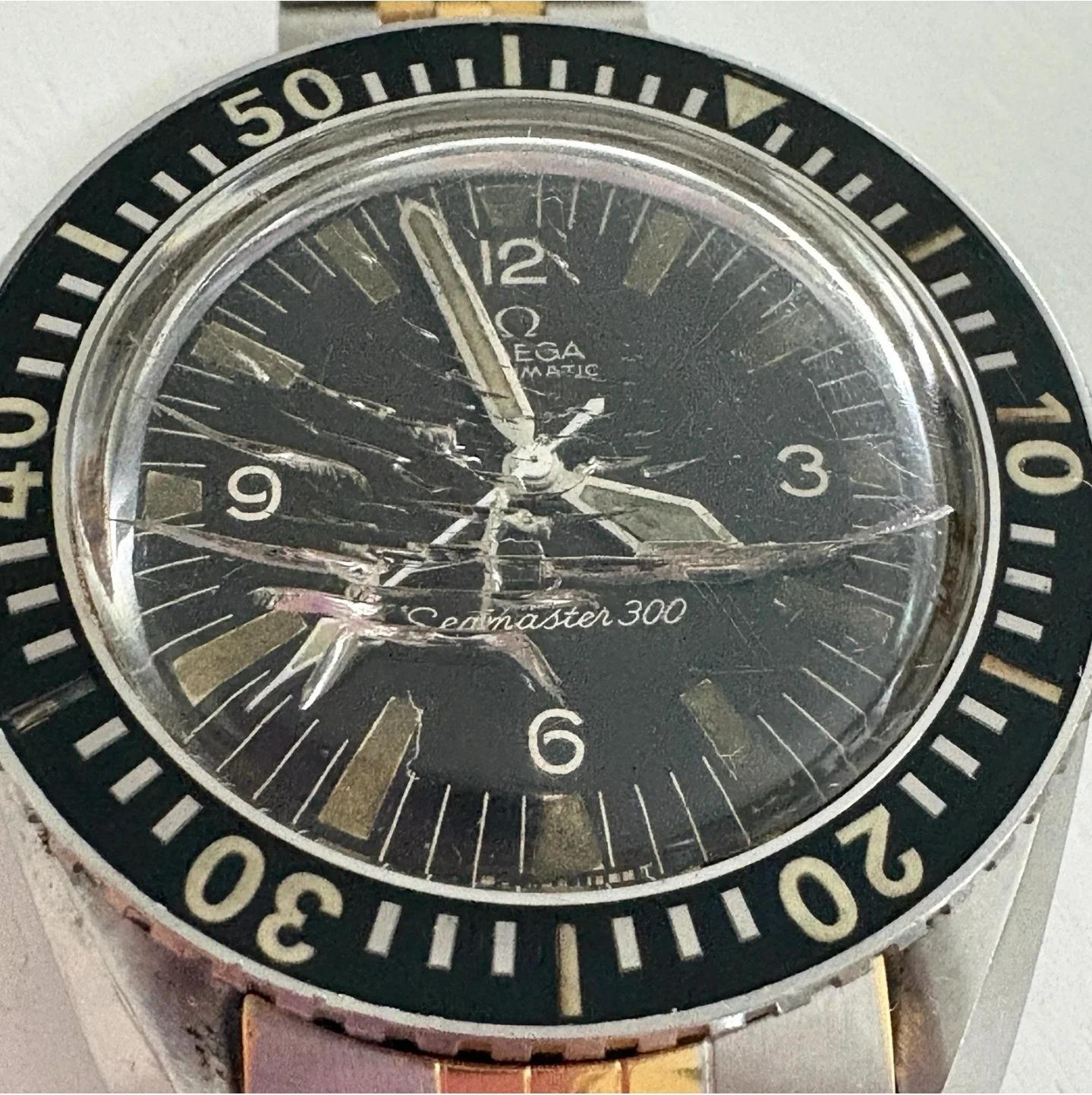

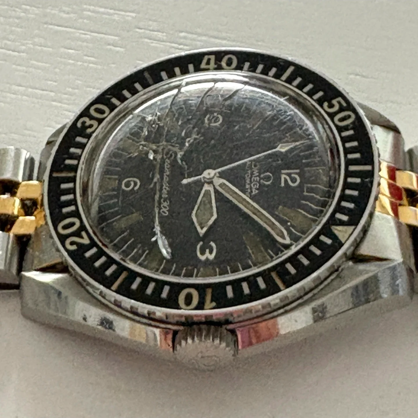

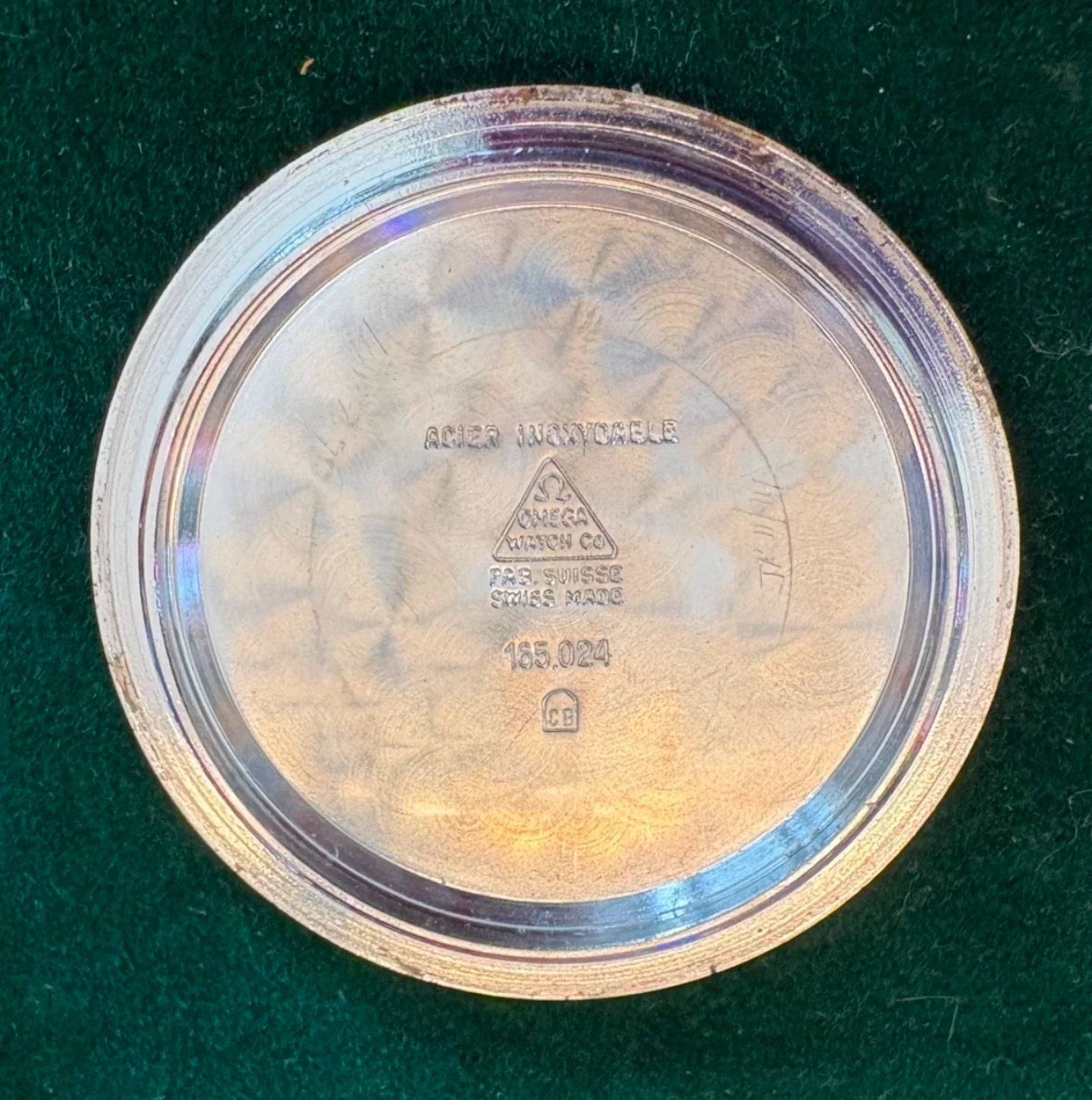

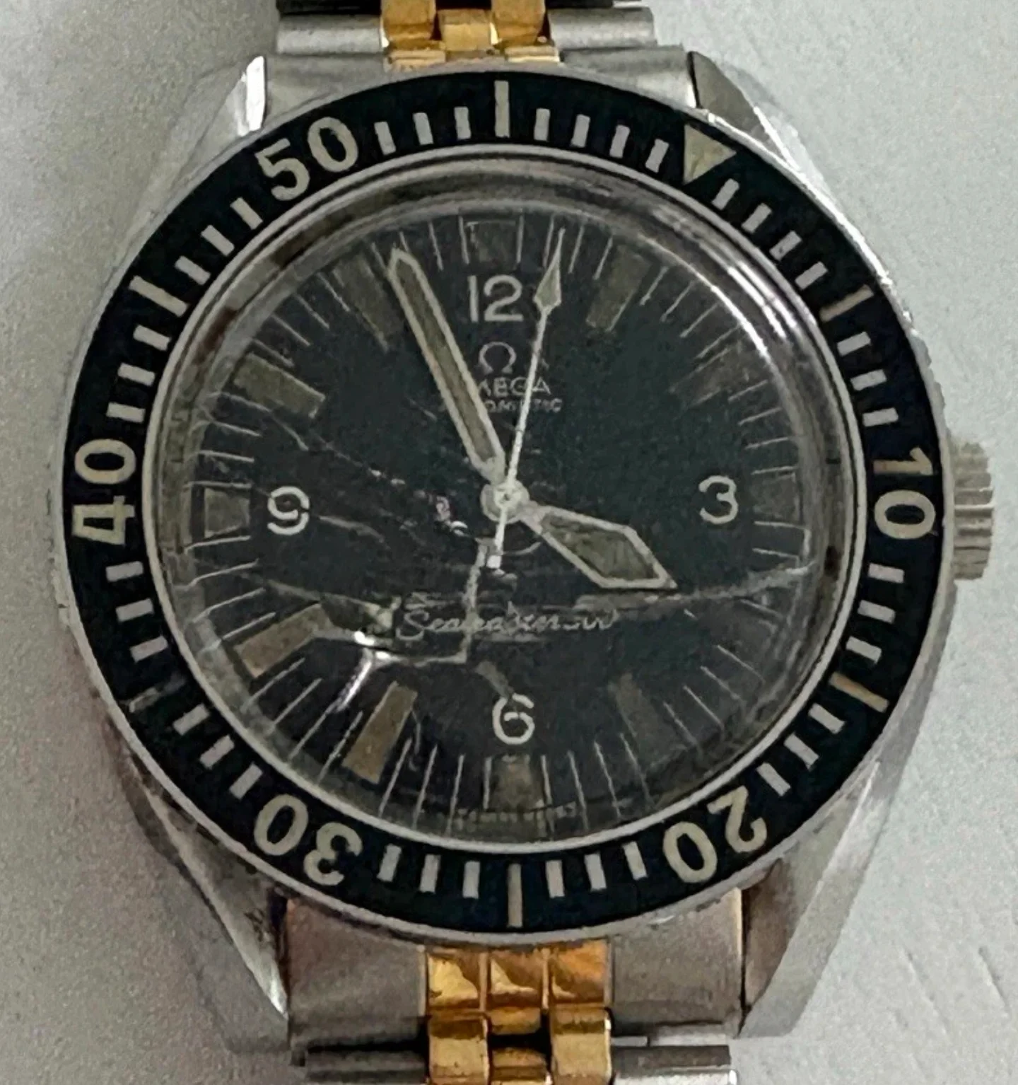

Hi,
Do you think this is fake (forget the bracelet) ?
I didn't find clear red flags, but I have been wrong before, especially when it comes to the Seamaster 300.
Thanks
308
231
There is one big problem from my point of view, movement serial starting 199 can`t be original to this model of watch, was made few years before 165.024 was introduced.
