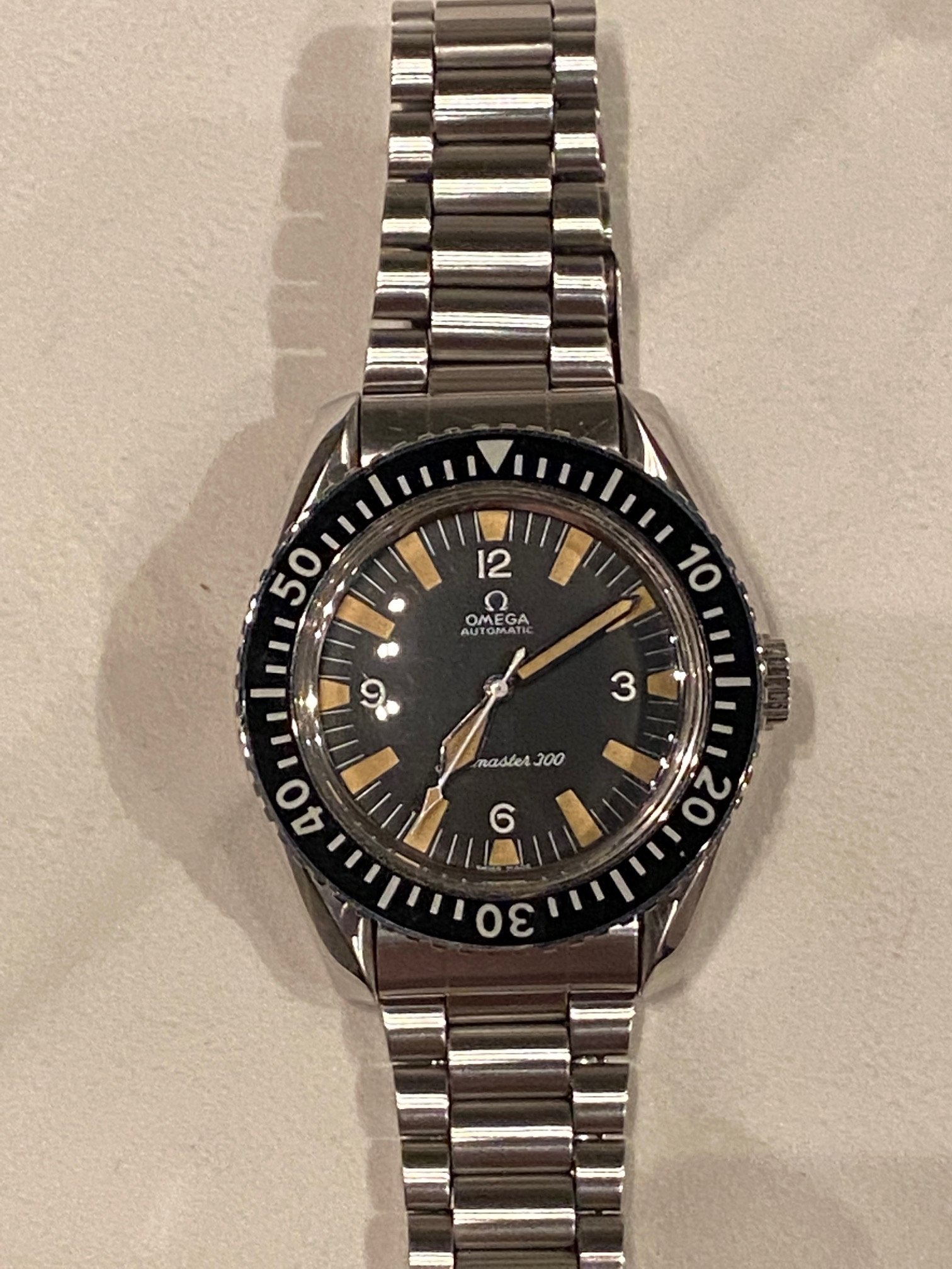

Thanks again for your collective advice. Unsurprisingly, my local Omega Boutique refused to fit the bracelet, but my local jewellers were able to carry out the work. For a very reasonable £30.
Pictured here with my 2254.50.
What is the source of that mesh bracelet? Looks great.
Thanks!
In addition to bags1971's reply, these are also available from Omega (ref. 1380/237). I think you'd pay less from a boutique than from that eBay supplier.
Mine came attached to the 166.0324 pictured above.
