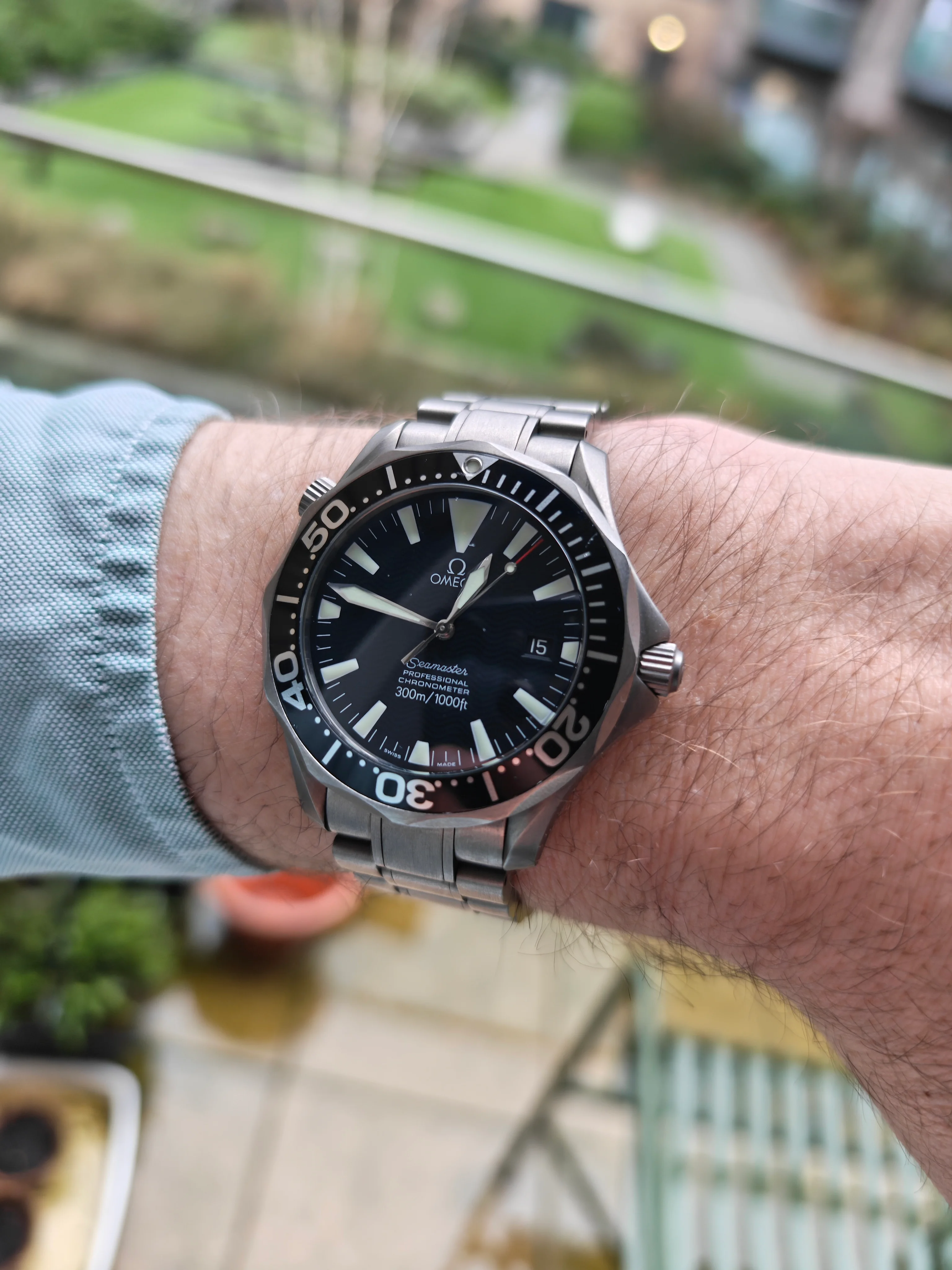

When I bought the watch I removed the original titanium bezel insert and fitted a black aluminium insert instead (pressed in easily, looks great). Now I’ve tried to swap back to the stock titanium insert… and it simply will not go in.

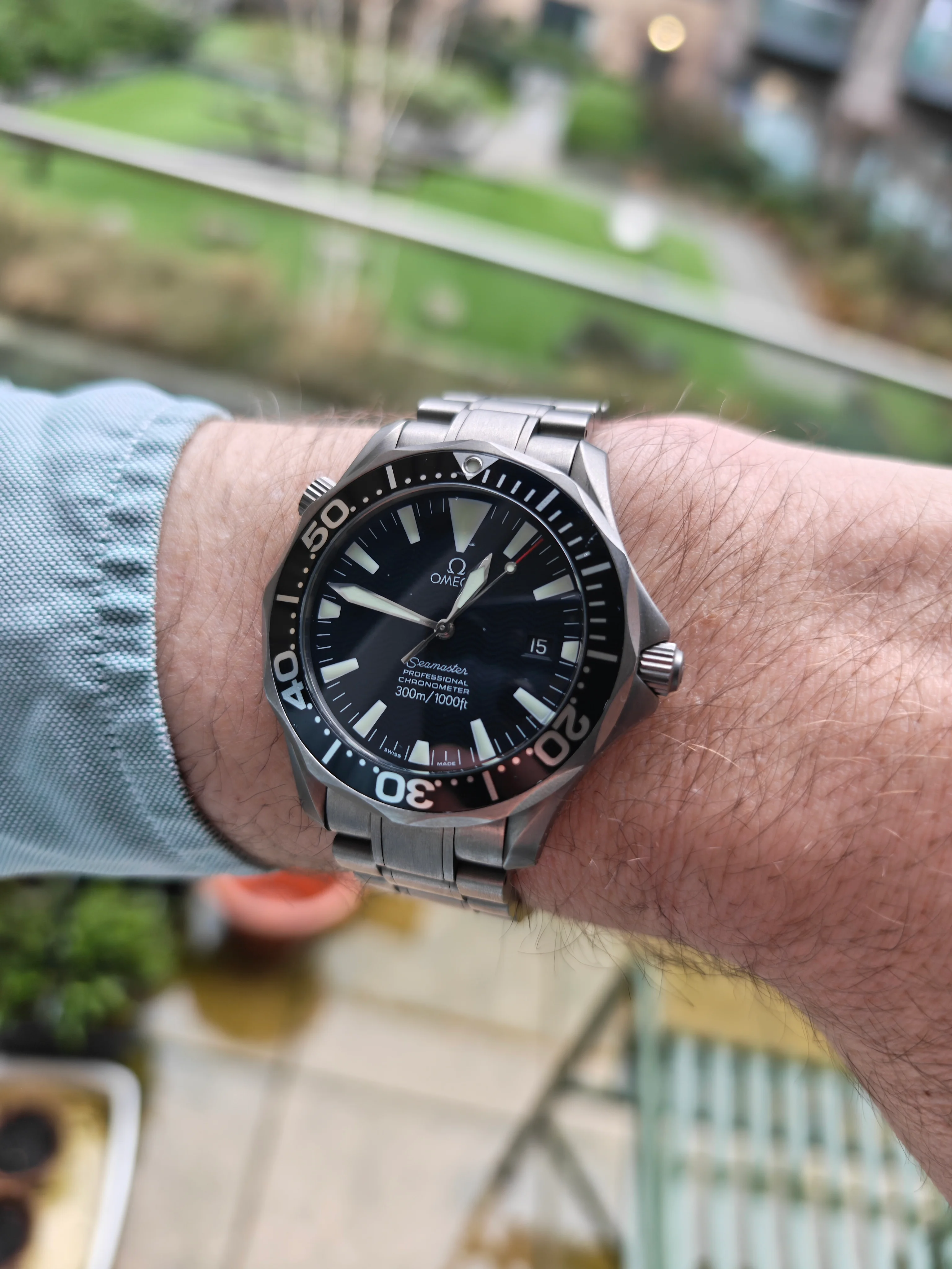

Pic with the black insert below:

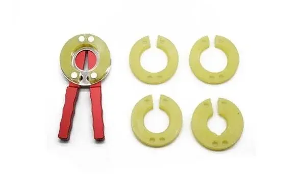

*This advice is not for the OP since you've already removed the bezel assembly. This advice is for anyone who sees this in future. Do NOT use a case knife to remove the Omega bezel assembly. If you actually get it to remove the bezel you will bend and likely ruin the bezel frame. You need to use a pliers like the one below. A case knife works for Rolex and many other watches. It does NOT work for Omega. Nor does it work for a TAG Heuer.

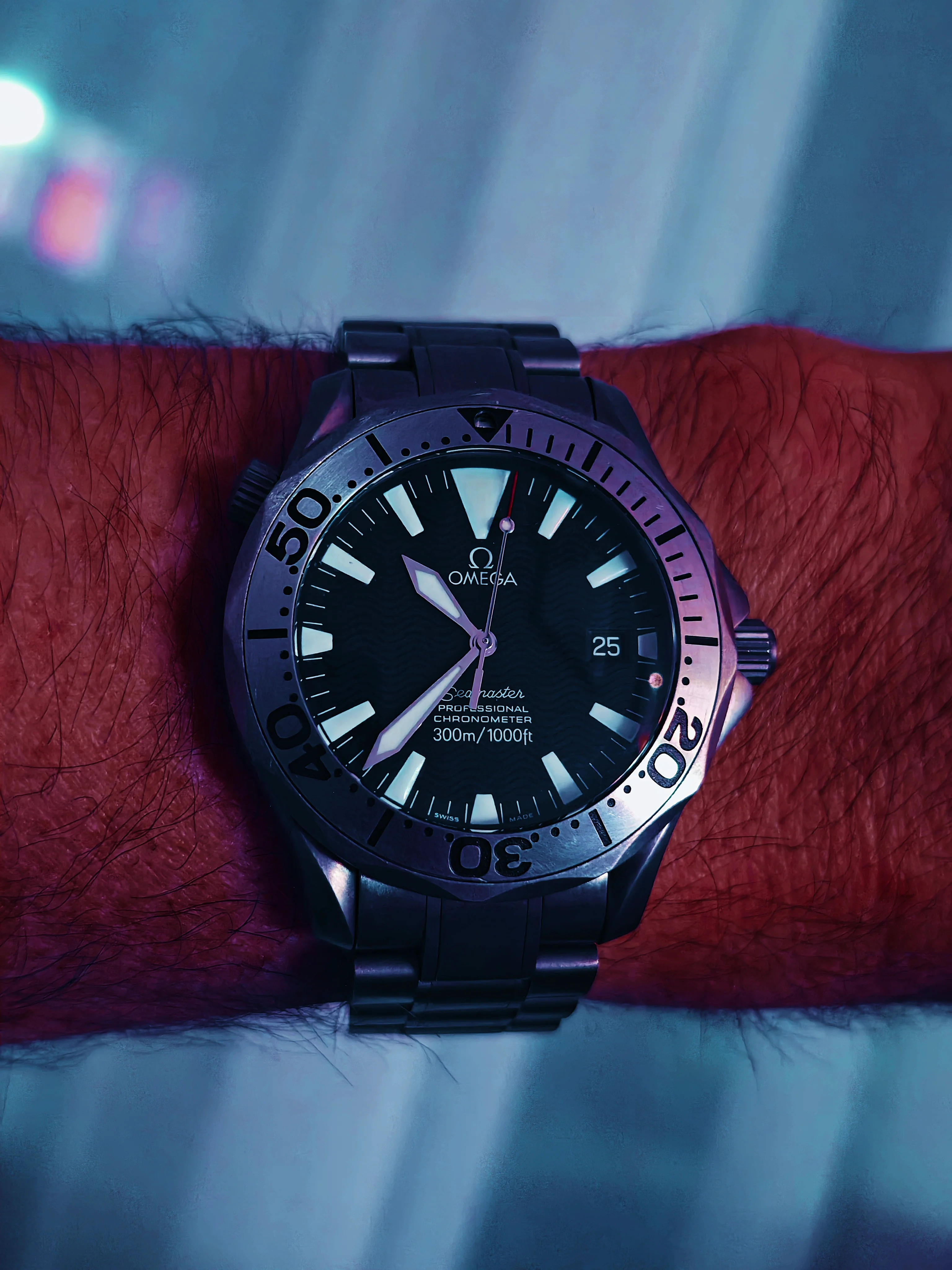

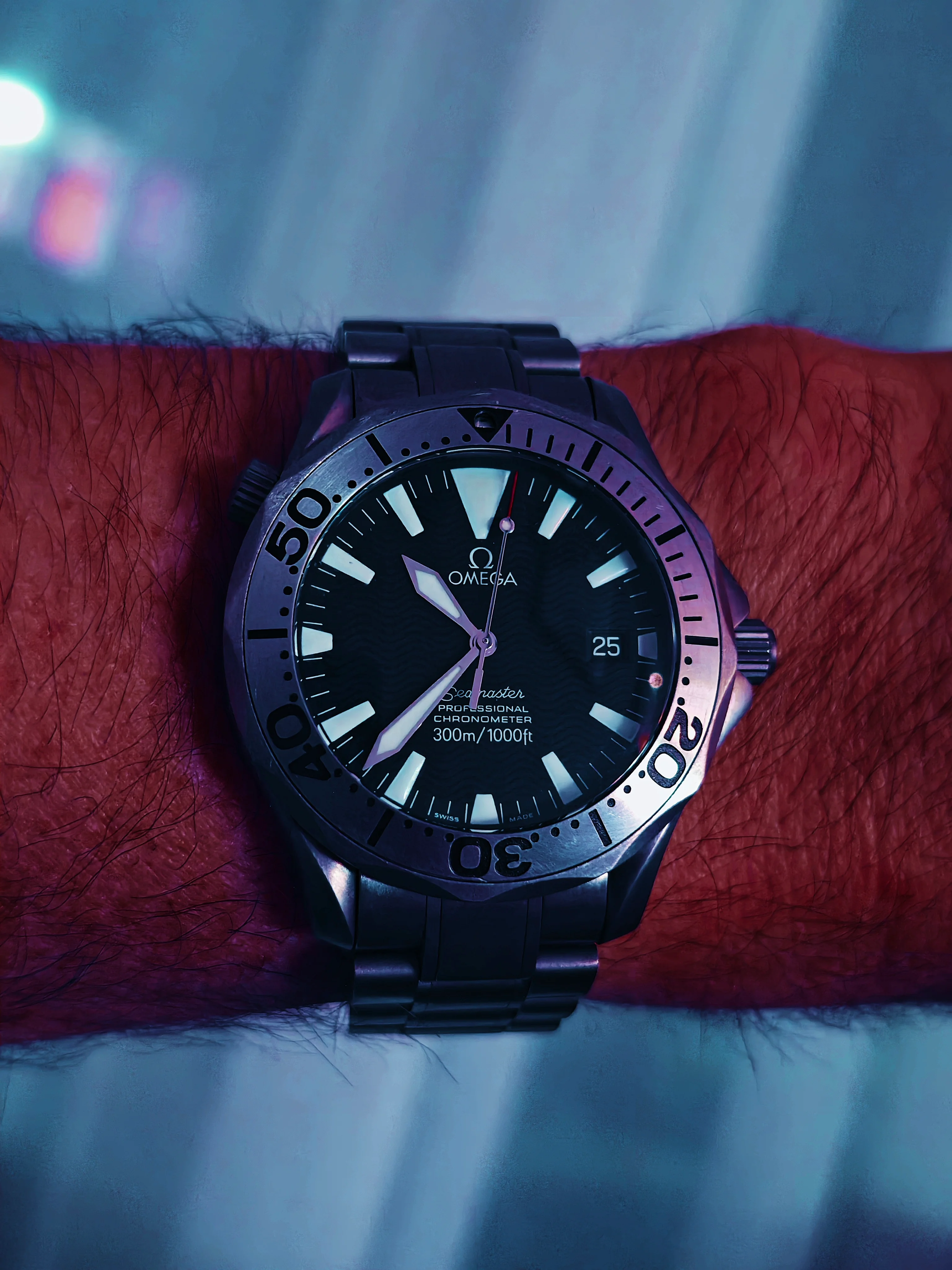

Ok, I finally got the f*cking thing in there. You know when you can't fix a problem and you spend all day thinking about it obsessively? For me, that was today. I thought and thought and after trying everything I could think of I finally realised that the insert had been slightly flattened the first time I tried to press it into the bezel ring as i used a dye that was slightly too small and it must have pushed the lip of the bezel down and made it less conical and more flat. There fore the diameter was larger and it was every slightly too large to fit into the bezel ring. I must have made it more and more flat each time I tried to press it in. The solution was to flip the insert over and press it from the inside out with a small dye to bend it back to its original shape. This worked a treat first time and I was able to snap it in perfectly to the bezel ring.
I need to put the lume pip back in but here she is! I'm thrilled. Thanks guys
