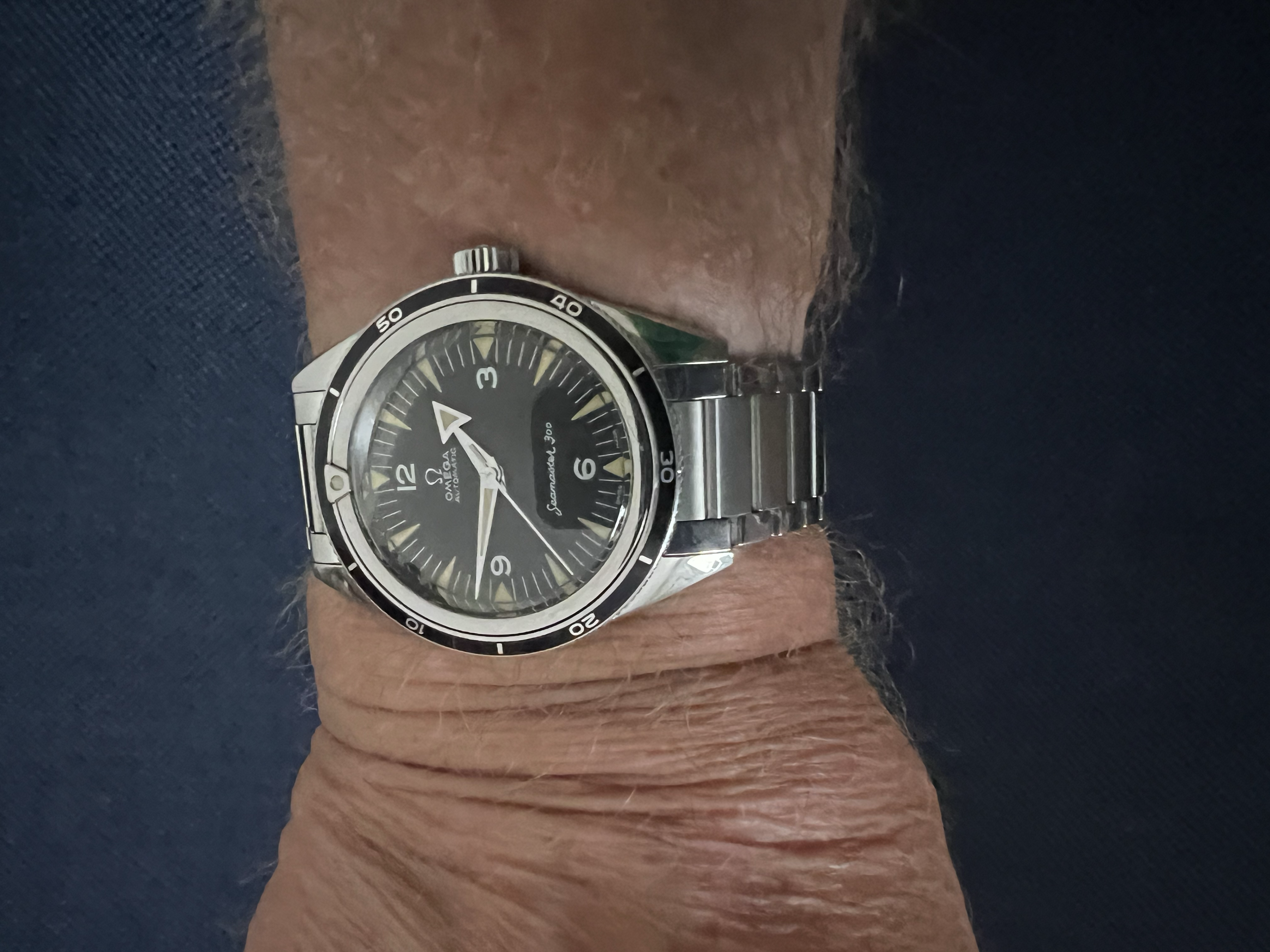

Hello all, I requesting some assistance from you with more experience than my self.
I received as a gift the above watch. I need to remove one bracelet link to get a snug fit. I spent some time on the web and searched here but, all I'm finding is a method that pushes out a pin to remove the link. These links appear to have screw slots on the ends so I'm a bit confused. Any help would be appreciated. Thank you in advance for any replies.

An update, after some close looking I could see where 4 of the screw heads had been removed before I received the watch, my SO purchased it used. I decided to give the bracelet fix, removing two links, myself using the bench vice with a box under for screw catching as recommended. All proceeded well and now the bracelet fits as I want.
Again, thank you for all the advice and encouragement.
