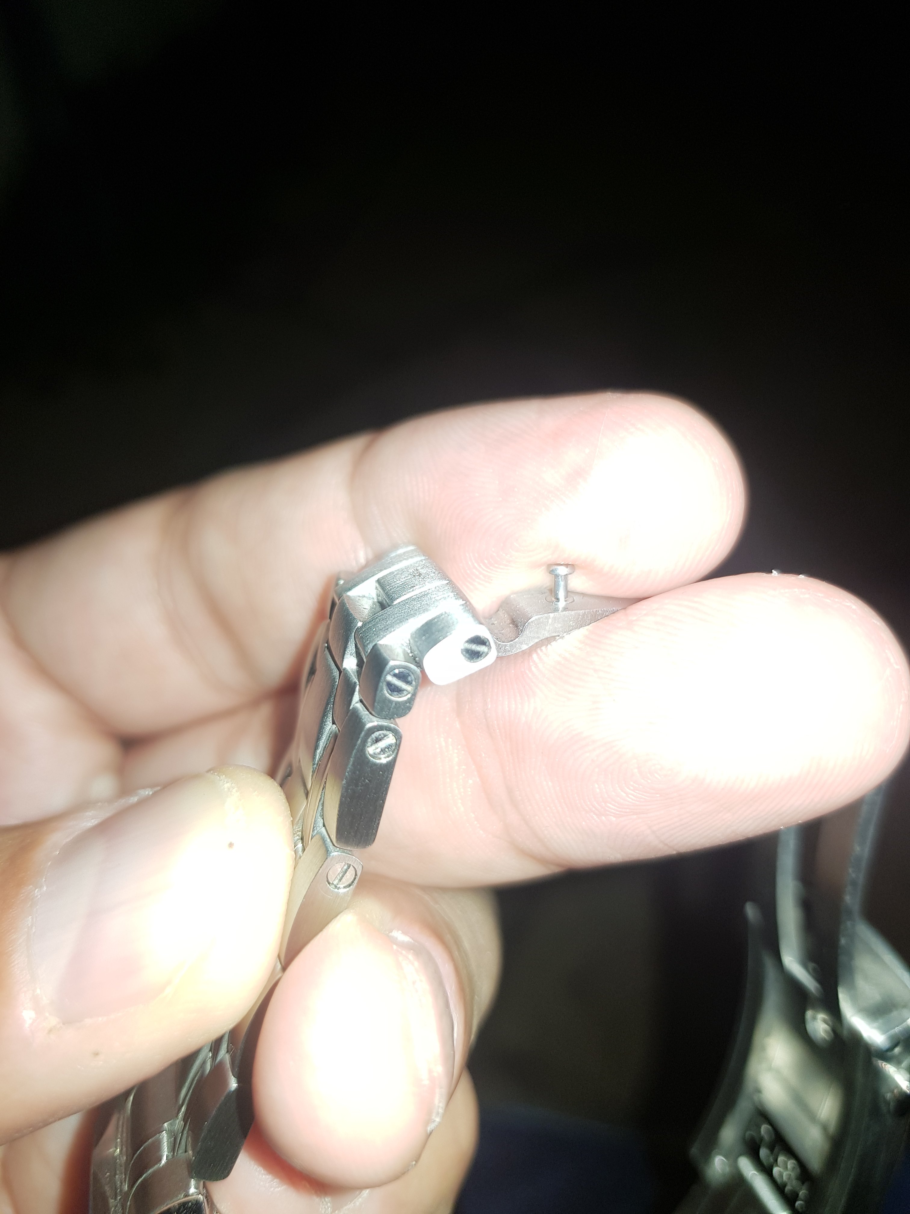

Hello, forum
Just a small enquiry regarding the bracelet links removal: are the little links by the clasp removable? And also, anywhere I can buy a screwdriver to remove myself the screws on my Omega Seamaster 300-2018. The ones I bought are scratching the screws.

Be aware that the screws are only cap screws at each side of the bracelet holding a pin in the centre.
They are tiny so make sure your workplace is clean and well lit.

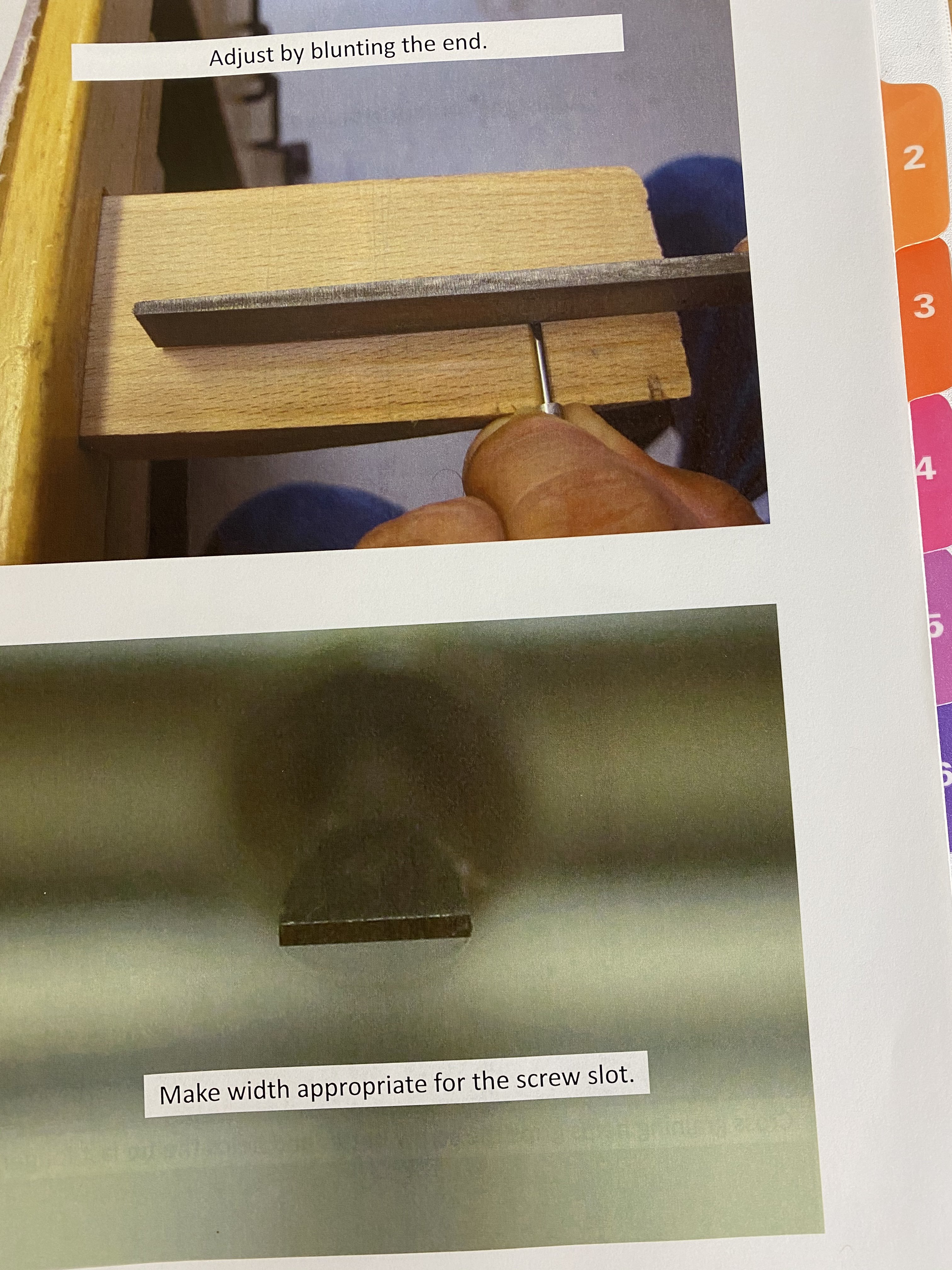

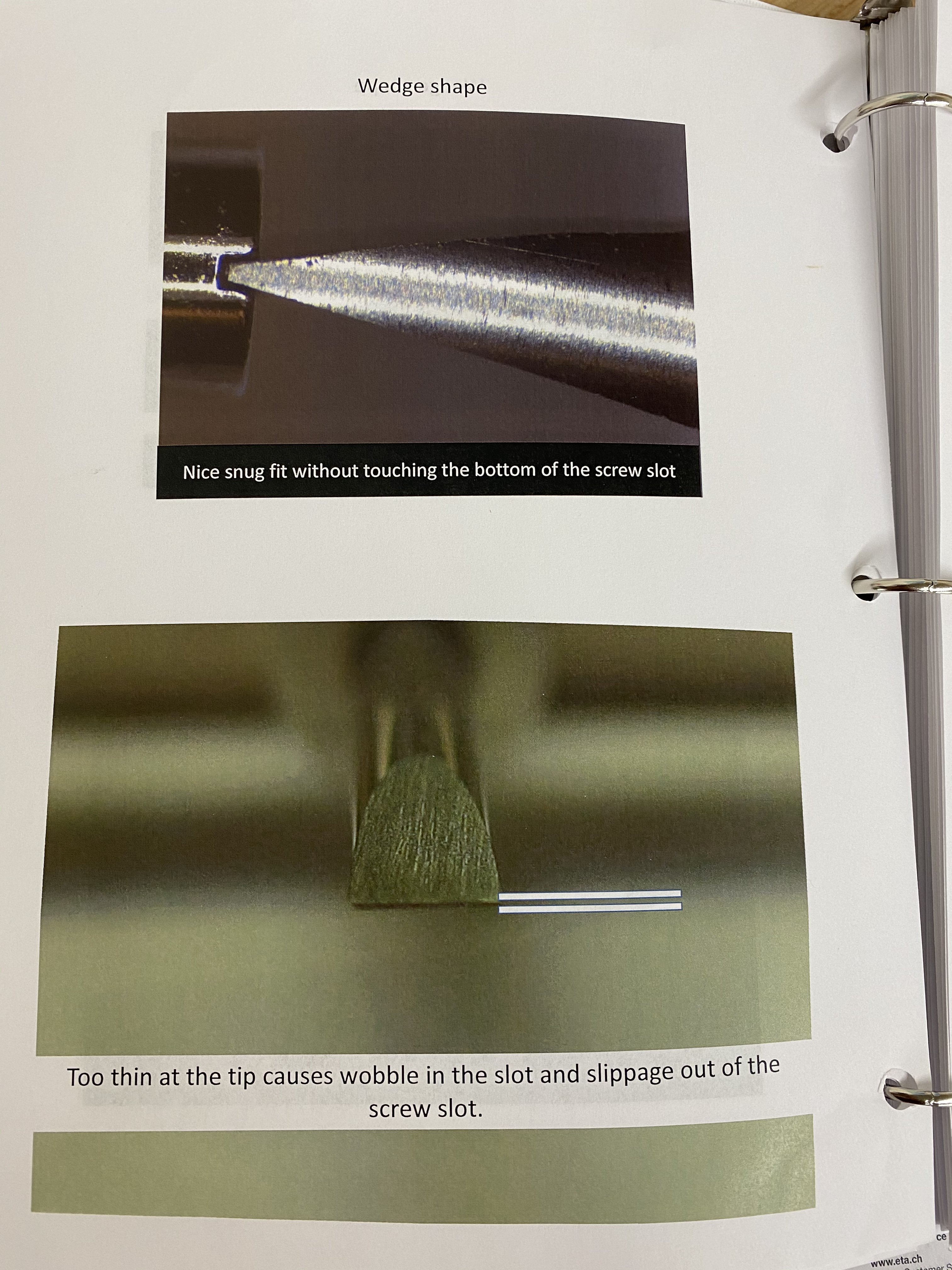

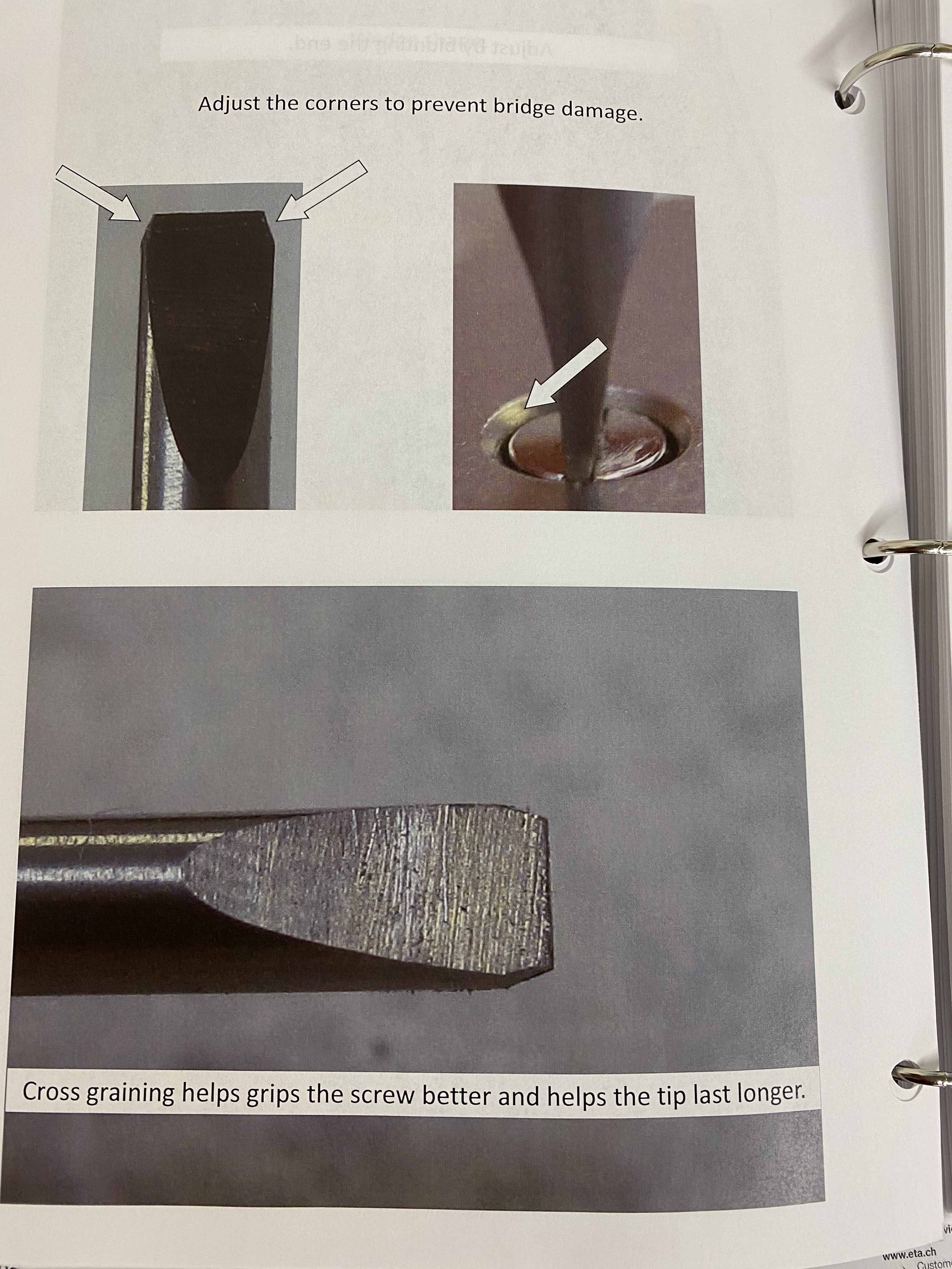

No matter what blade profile you buy, the blade of the screwdriver must be properly fitted to the slot. This means a snug fit in the slot, and not bottoming out in the slot, as that will lead to cam out.
What is "cam out"?
7,326
23,744
No matter what blade profile you buy, the blade of the screwdriver must be properly fitted to the slot. This means a snug fit in the slot, and not bottoming out in the slot, as that will lead to cam out.Al
Okay, so are you saying a screwdriver should be snug in the slot, but the tip not hit the bottom? How would one manage that with tiny screw? Press the tip into the bottom, and back it out?
And ideally, since the walls of a screw are parallel, should a properly dressed screwdriver be cut to have parallel walls too, as it would seem that a wedge shape would tend to exert more force on the top edge of the screw slot, leading to a greater chance of deformation there.
30,201
77,970

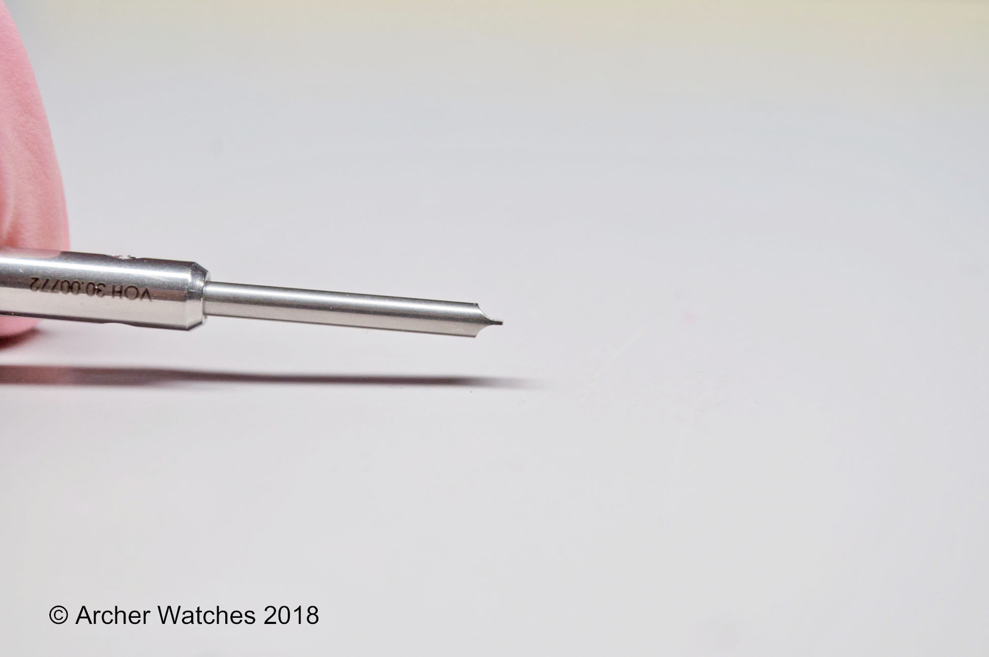

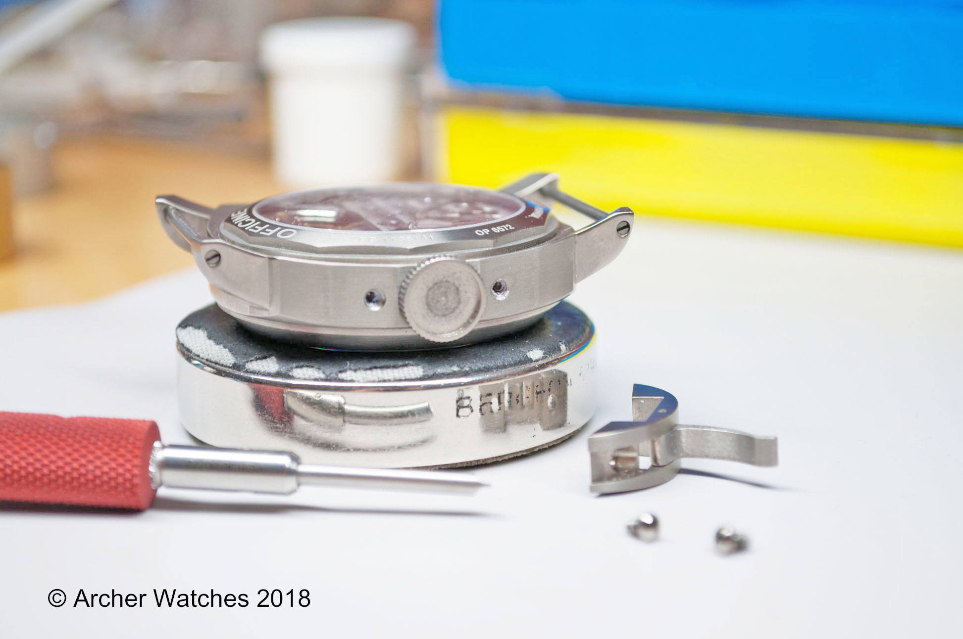

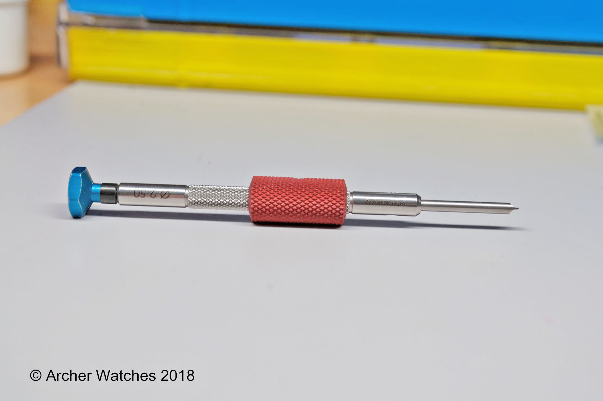

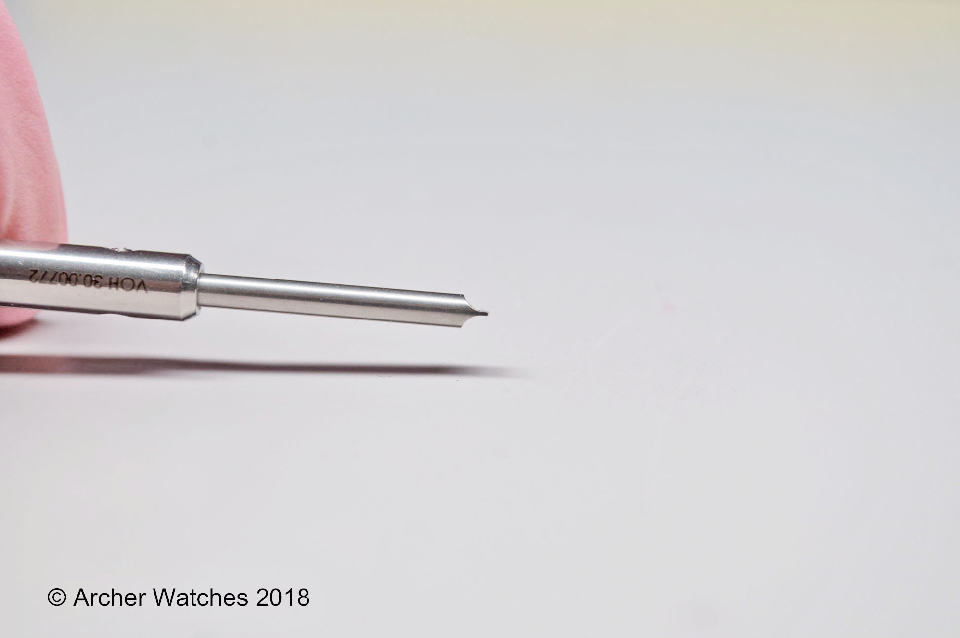

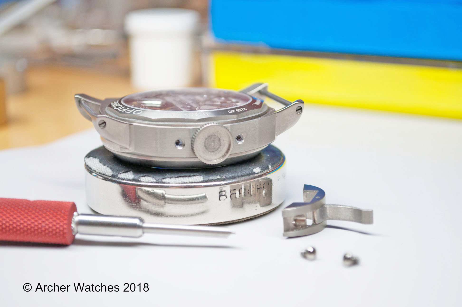

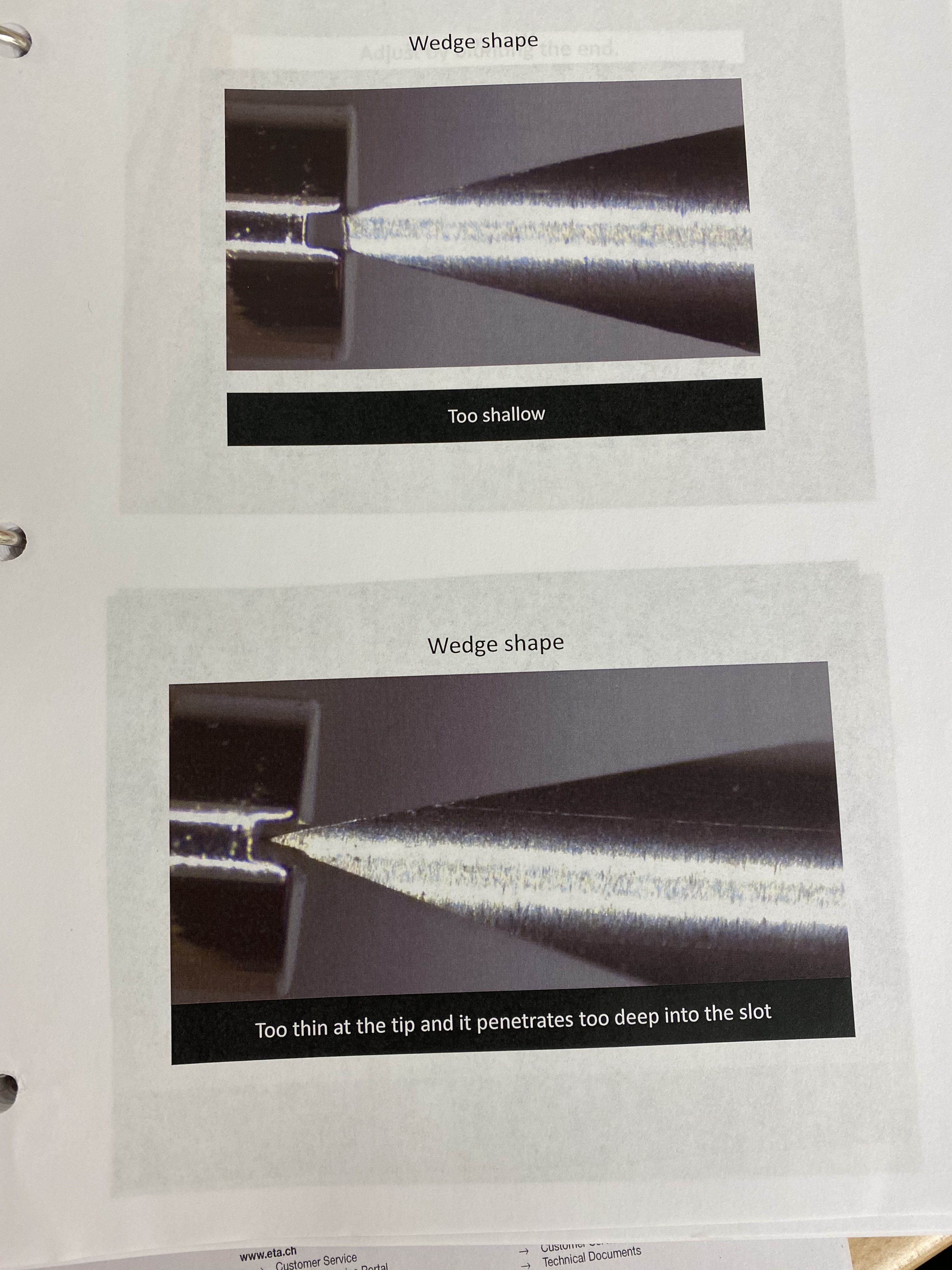

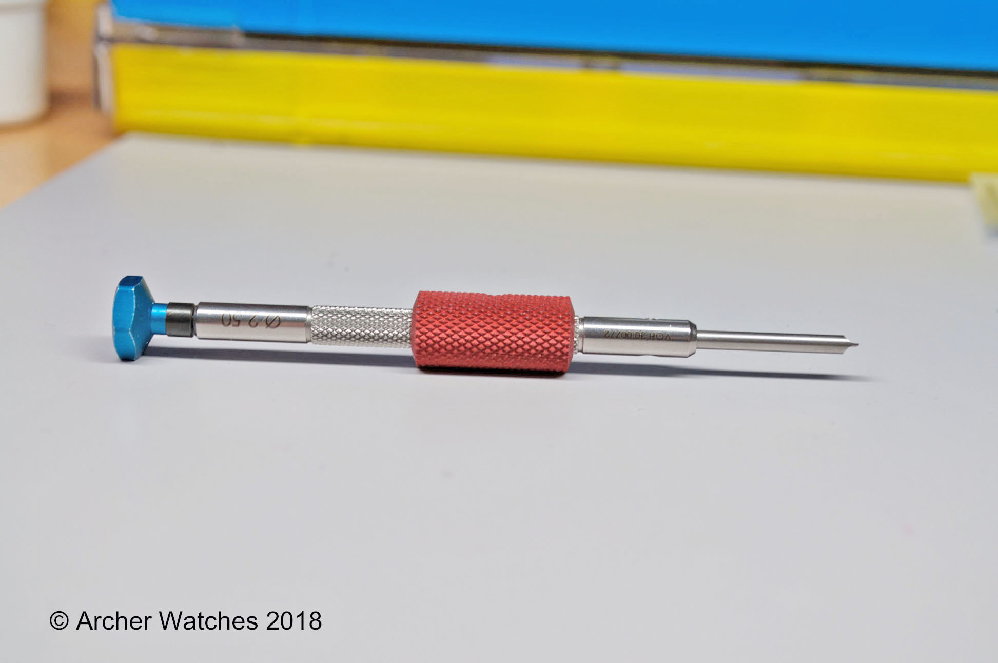

There are two types of screwdriver blades - V-shaped and hollow ground blades. I only use hollow ground blades for rounded screw heads, so for example on Panerai crown lock device screws:
Since these are installed using thread locker, and heat would damage seals, I use a torque sleeve on the screwdriver barrel, and the hollow ground blades are made of HSS (tool steel).

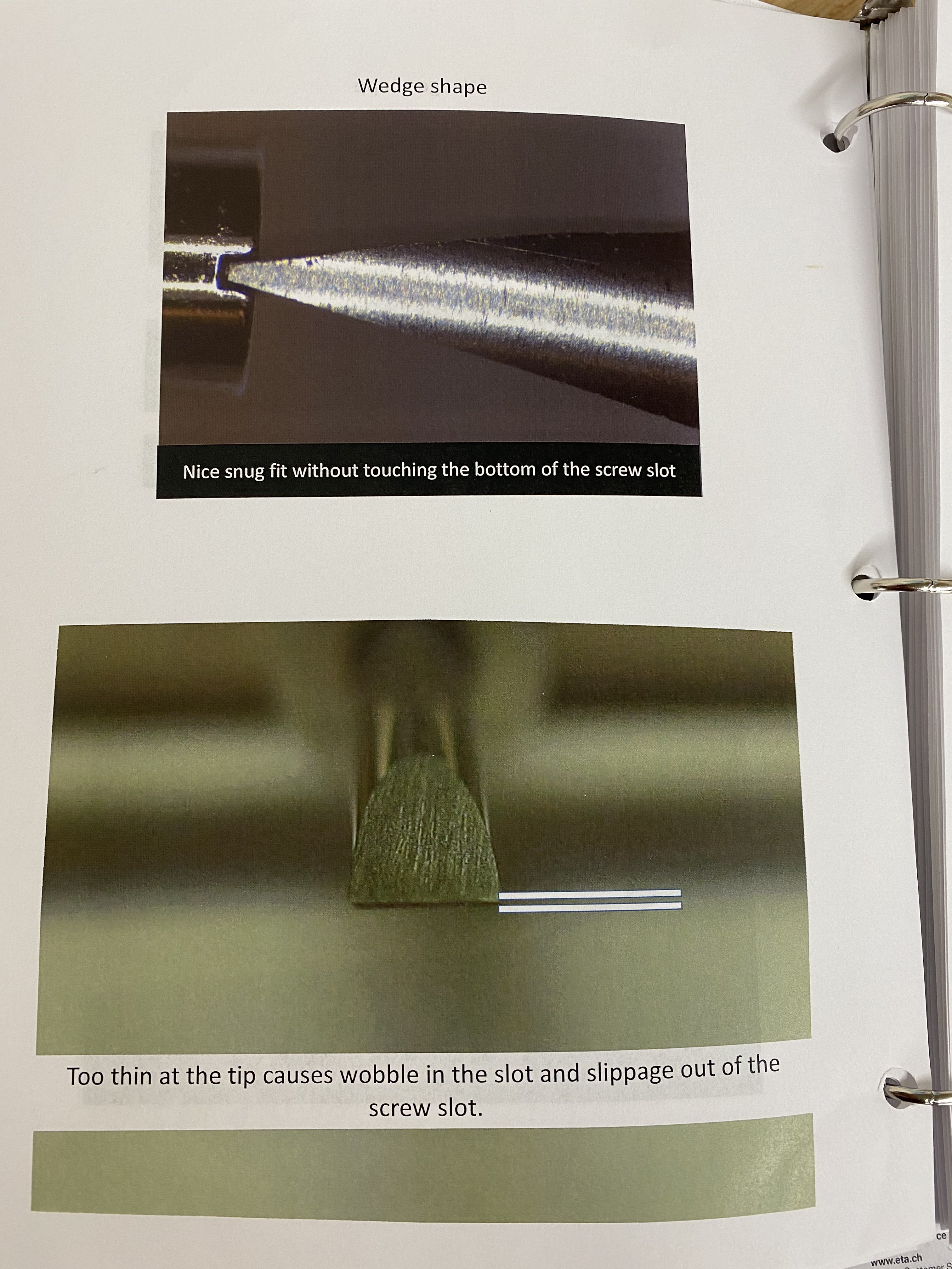

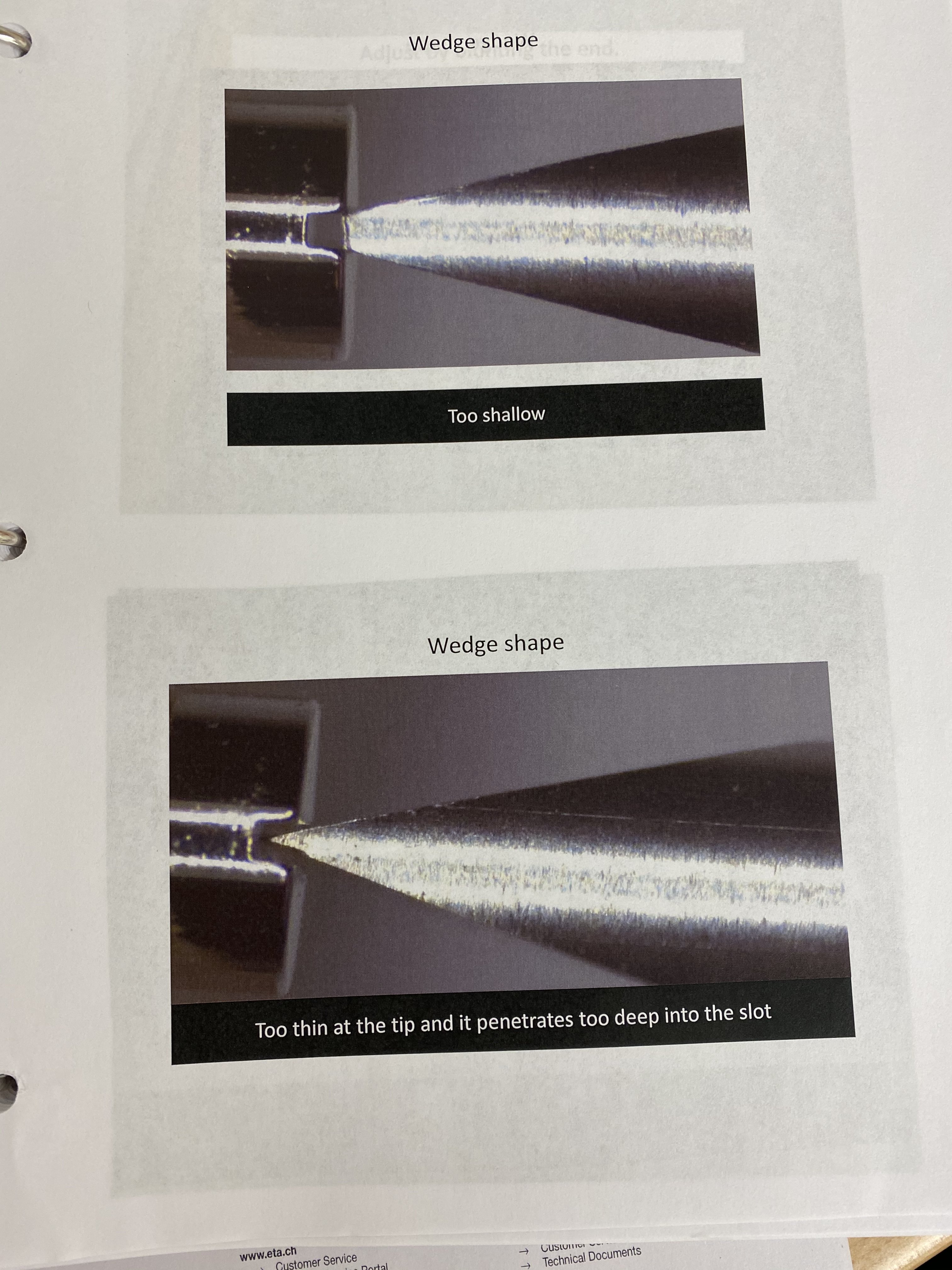

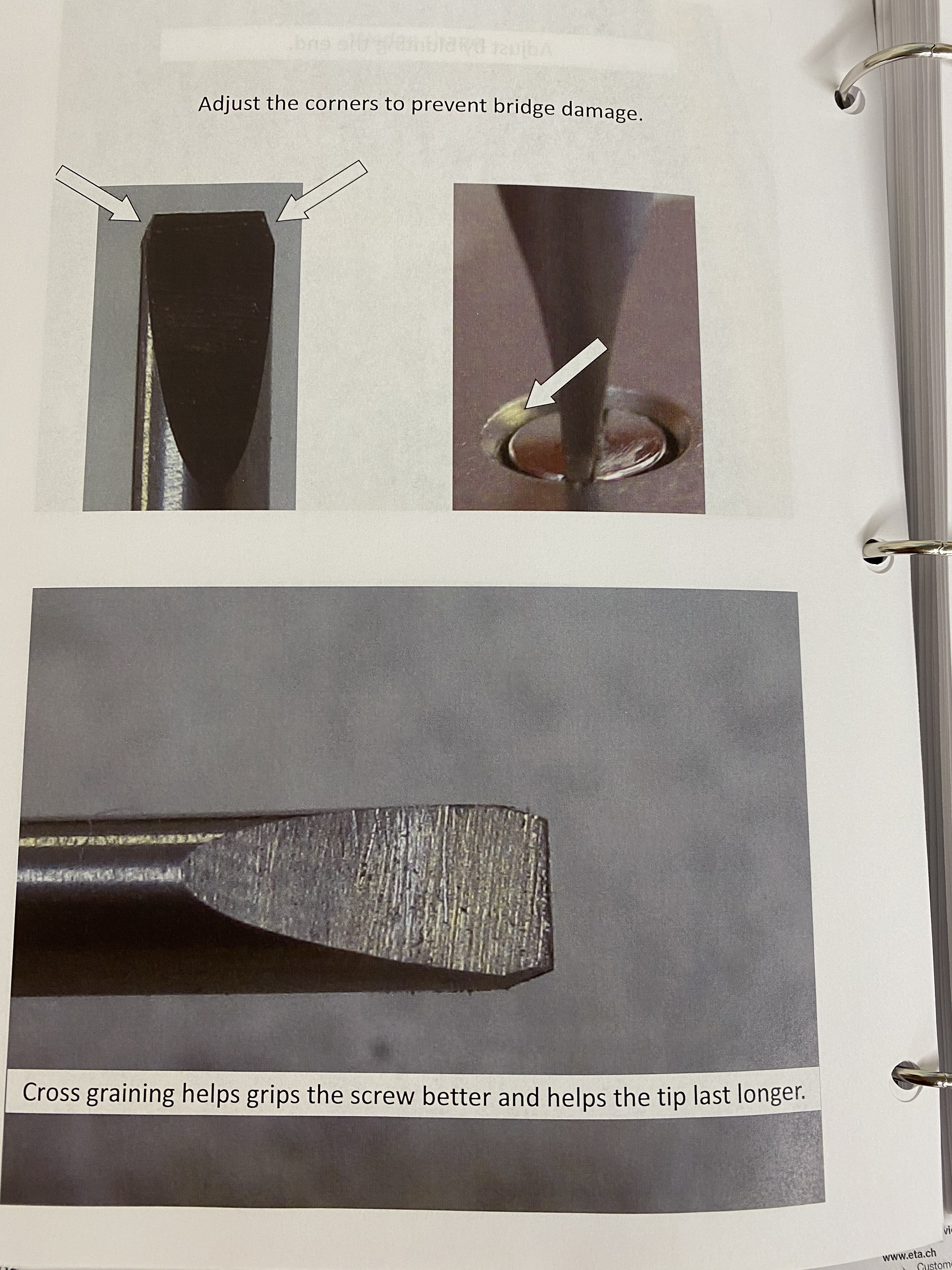

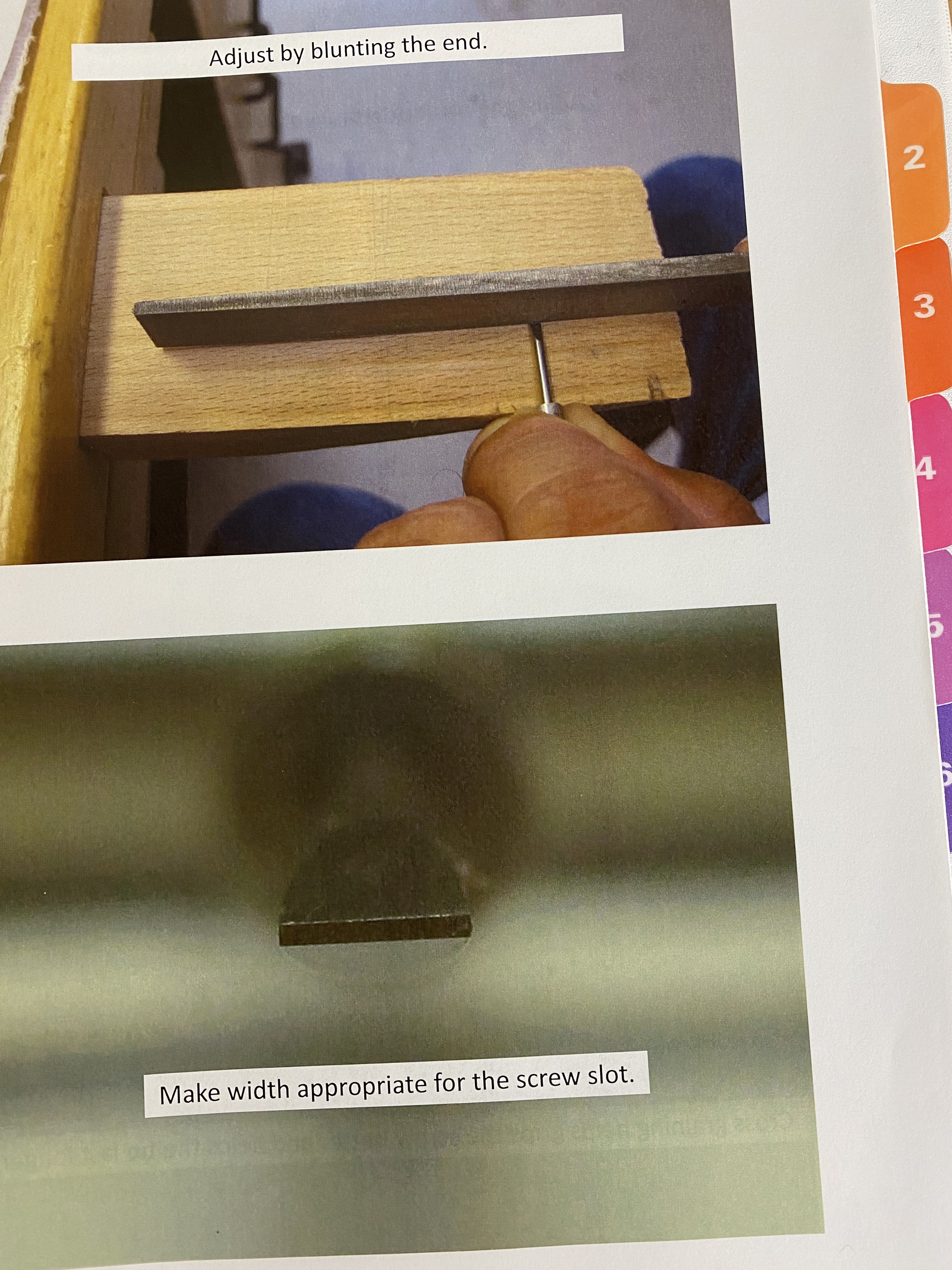

For flat head screws, I use the traditional V-shaped, or wedge profile. In order to fit the blade to the screw, you file it or use a stone to shape it. So if the blade goes in the slot far enough to touch the bottom of the slot, you file off the very tip of the blade. If the blade goes into the slot but doesn't go in far enough, you file off the sides of the blade.
Every screw is different, so for example modern screws in watch movements tend to have wider and shallower slots than screw in vintage watches. So I have more than one set of screwdrivers, so one set is dressed to fit more modern screws, and one more for vintage. They all need frequent dressing to fit specific screws. This is daily work for watchmakers, so if you do it enough it only takes a short time to properly dress the blade to fit the screw.
Ideally you would want the blade to nearly touch the bottom of the slot, but not quite, so maybe a 0.05 mm gap.
Cheers, Al
