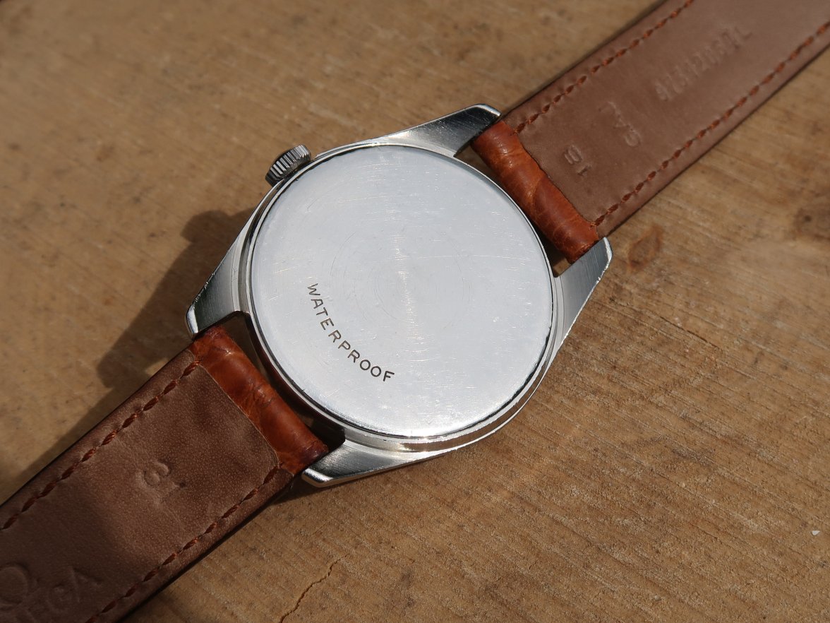

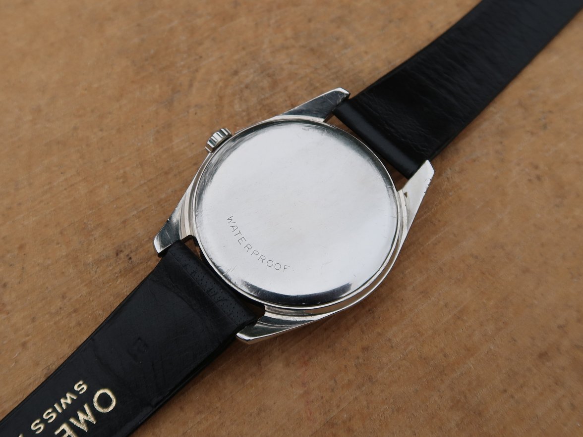

The midcase is the same i think, but different casebacks shape.
The center second movement is higher so the 2996 back is not flat as the 2990 caseback but curved.
2996:
2990:
2996:
2990:
2996:
2990:

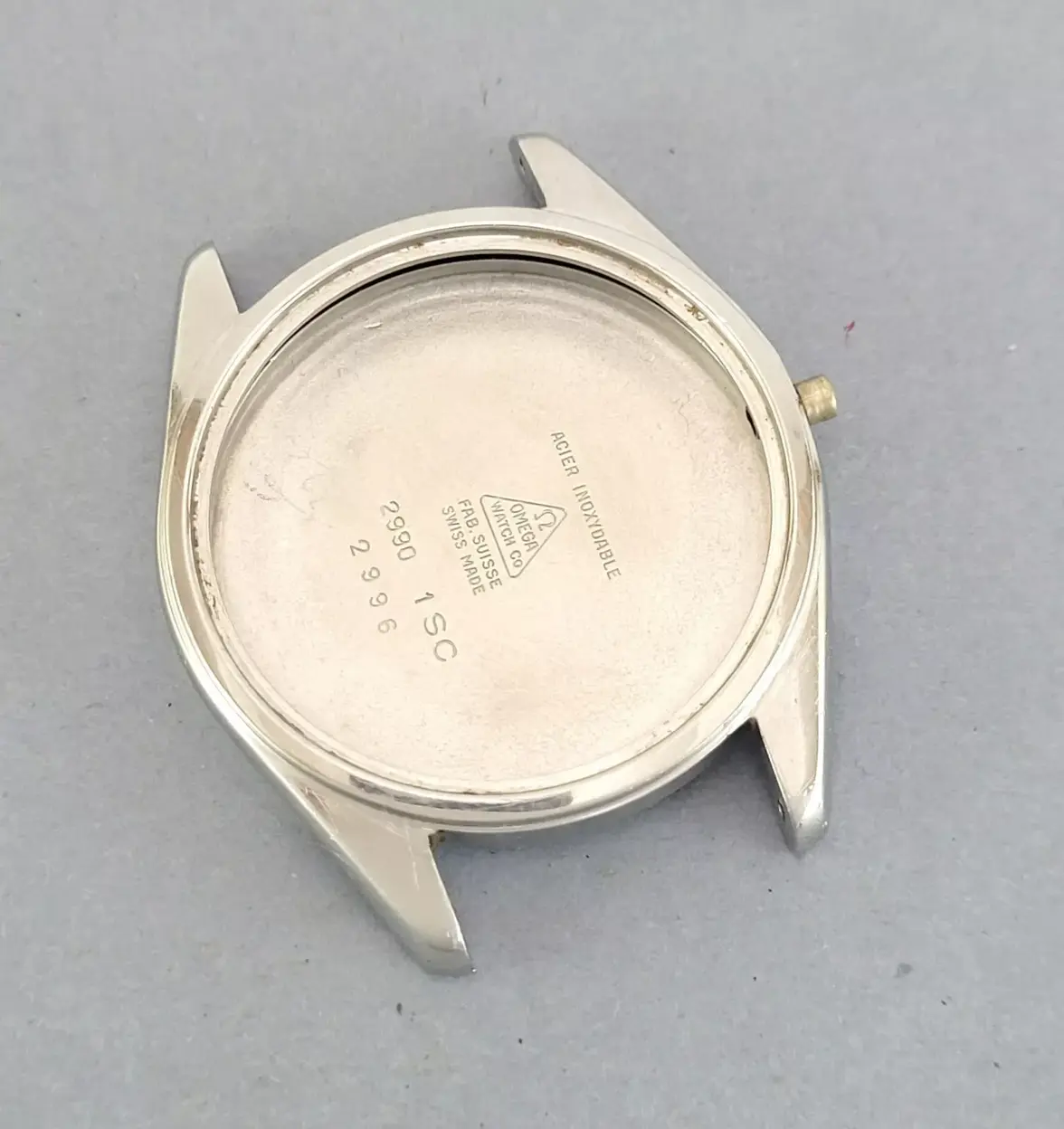

I wonder, if there are differences, why did they mark one cap with two reference numbers? (photo from the Internet)
But for example 2996-1, in my opinion even the shape of the ears is different. The lid is also significantly different.
