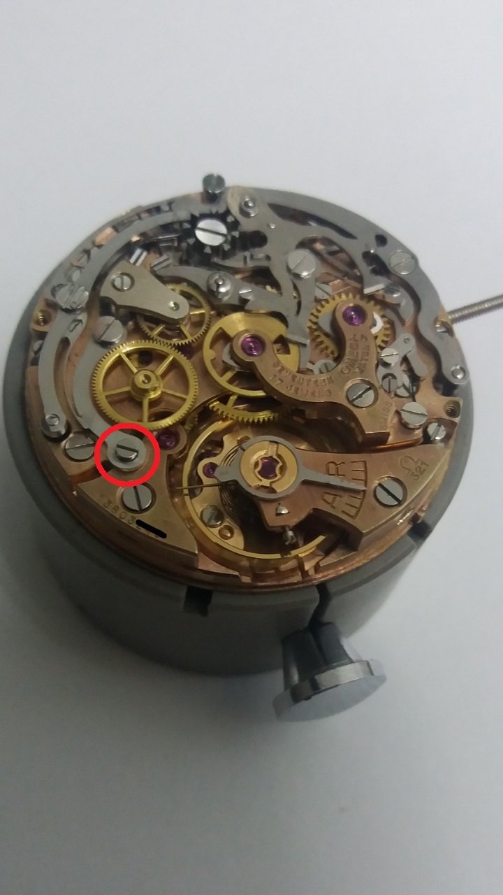

Can anyone help me with the part number for the below screw that holds down the end of the coupling clutch?

Neither of those number Don gave you are what you are after. That is not a screw, it's an eccentric used to adjust the depth of engagement of the teeth between the chronograph drive wheel, and the coupling clutch wheel.
The part is 320-1702 - Eccentric for pivoting of coupling clutch.
Thats why I said to email to be sure. Number is not listed on the parts page unless I somehow missed it
This part was listed for both 321 and 320 - COUPLING CLUTCH PIVOT ECCENTR 1702/OME 27

Not sure what parts page you are referring to, but it's clearly listed on the Omega parts list from 1958 that is freely available all over the internet - that's where I found it.
I always check out Jules Borel's pages.
I found some PDF files on Cousins site

Thanks @Archer for yet another education on my Speedies!! No wonder that screw is a little lose, because it's NOT a screw!! Lol
Yes, to replace it, it will be a press fitted item, that is removed from the underside of the bridge. If it's loose in the hole now and that is the problem, you may need to close the hole up to make it fit tighter.
